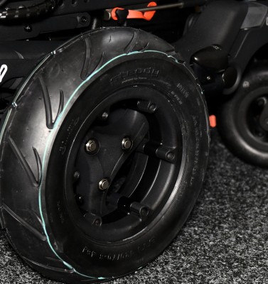

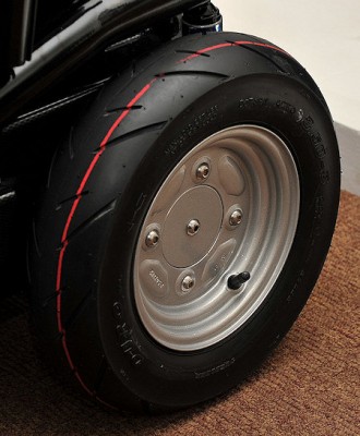

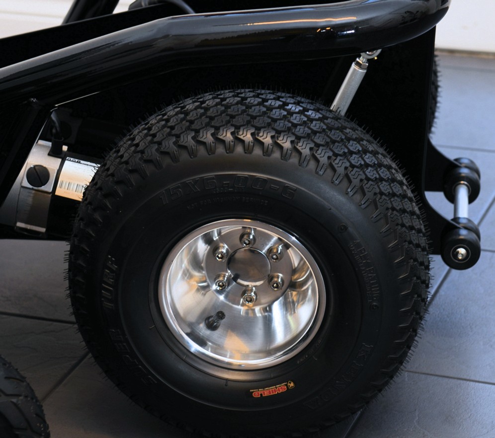

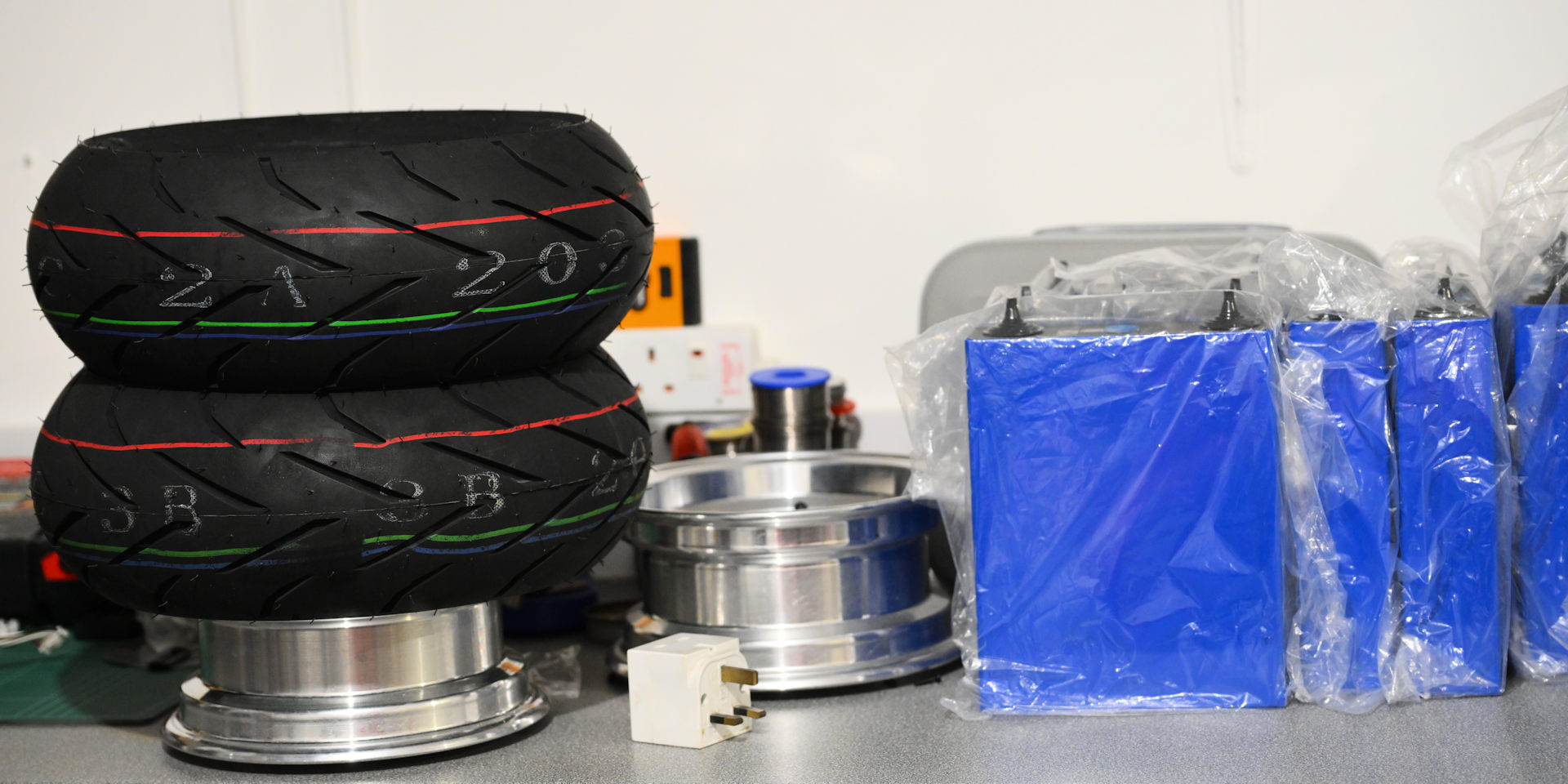

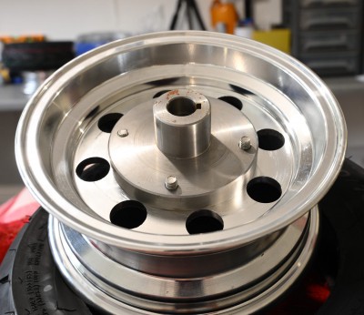

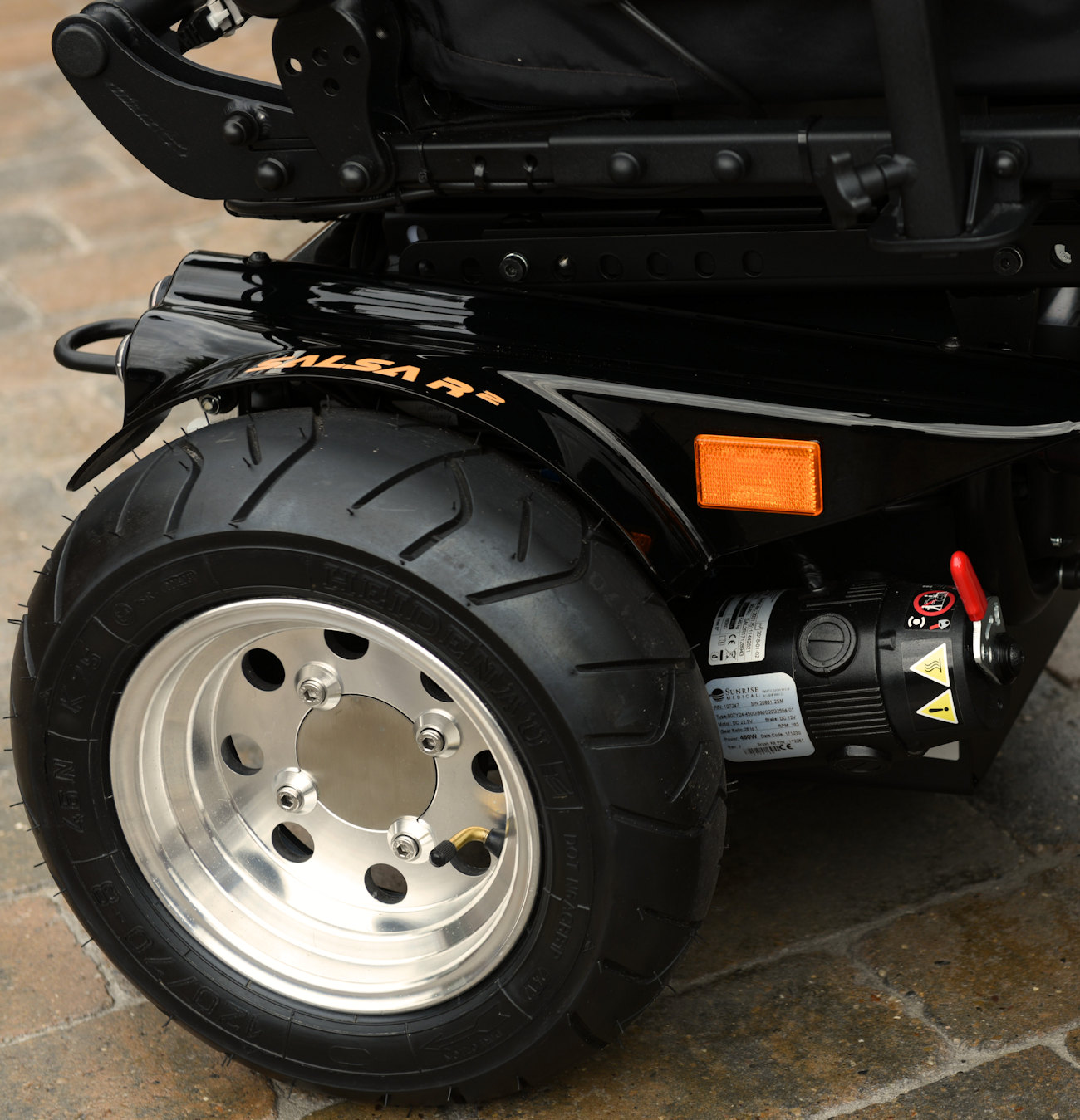

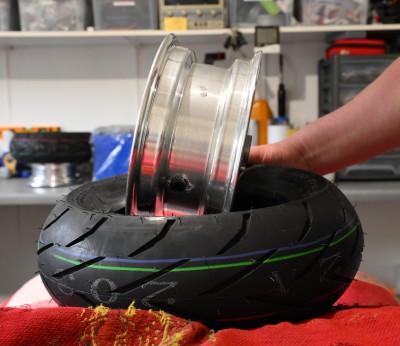

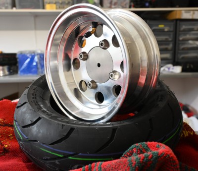

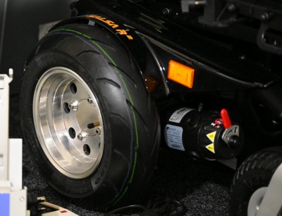

Postby Burgerman » 13 Apr 2025, 02:21

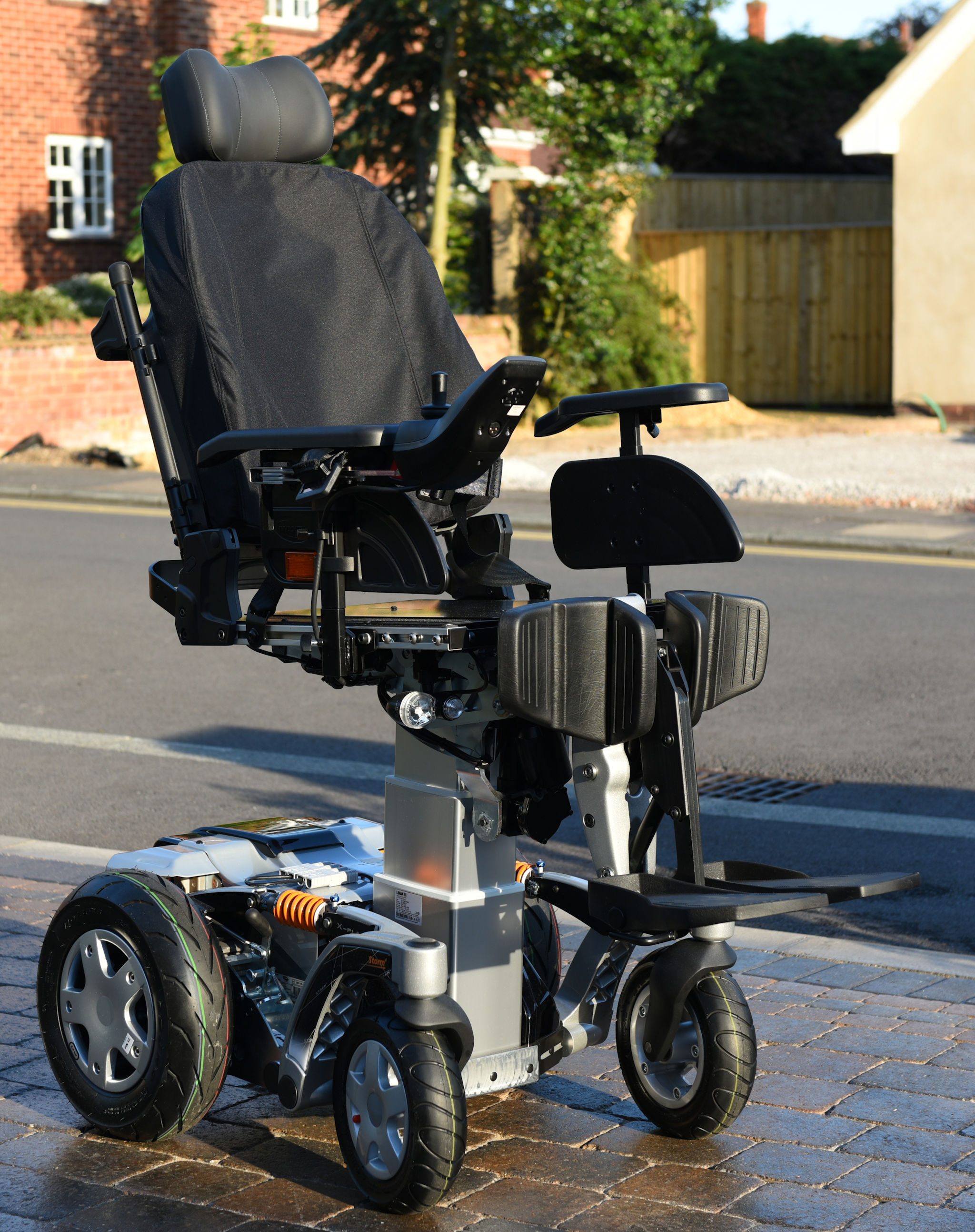

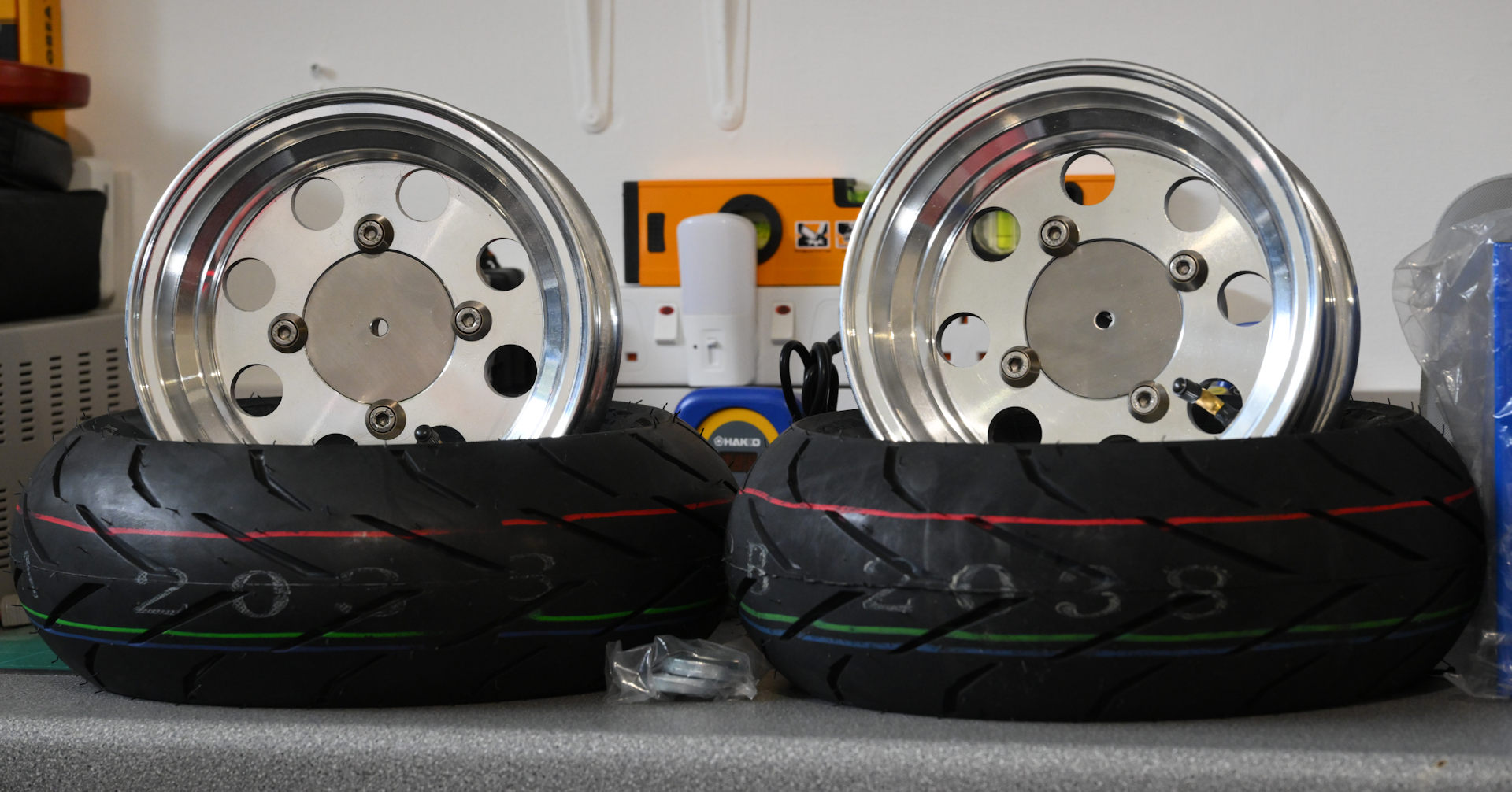

Heres a pic of my bench.
Left... And middle.
2x 120/70-8 Diro Kitaco tubeless tyres.
2x 3.5J x 8 inch tubeless alloy wheel rims awaiting tyre fitting... Look CAREFULLY at the rims you can just see the "bump" that tubeless rims must have. Near the beads.
On the right...
8x 230Ah (244Ah actual) LiFePO4 from Amy Zheng!
This is a basic kit needed to convert any half decent but simple powerchair from a "pram" to a real powerchair... That has 100 mile range and fatterbetter stronger tubeless tyres that are more comfortable!
But you wont want the added 3 inches of width. I dont care because thats still the same width as across the arms. So narrower tyres wouldnt help in a doorway for e.g. In other words they dont actually make my chair wider.
Posts: 71091

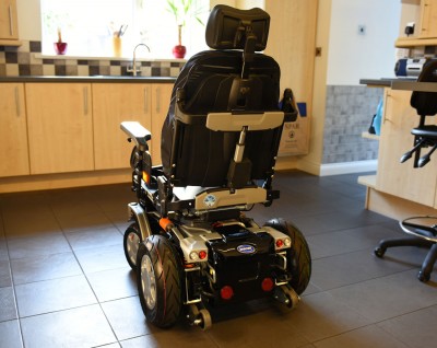

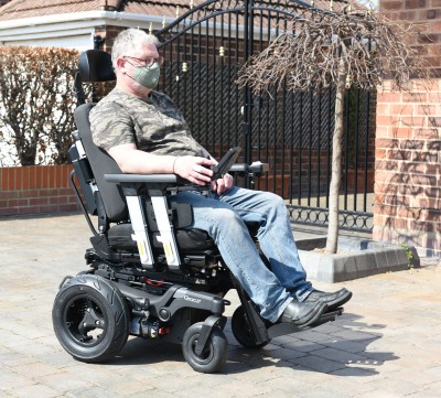

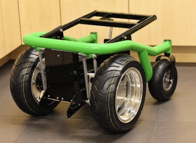

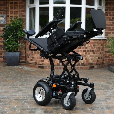

Postby Burgerman » 13 Apr 2025, 11:54

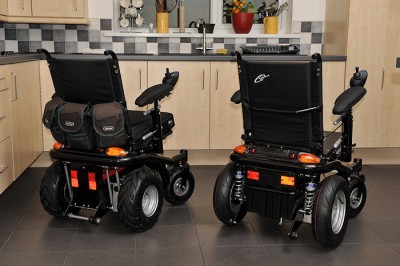

All these are tubeless too!

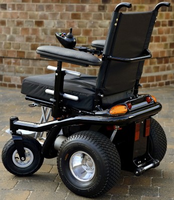

Posts: 71091

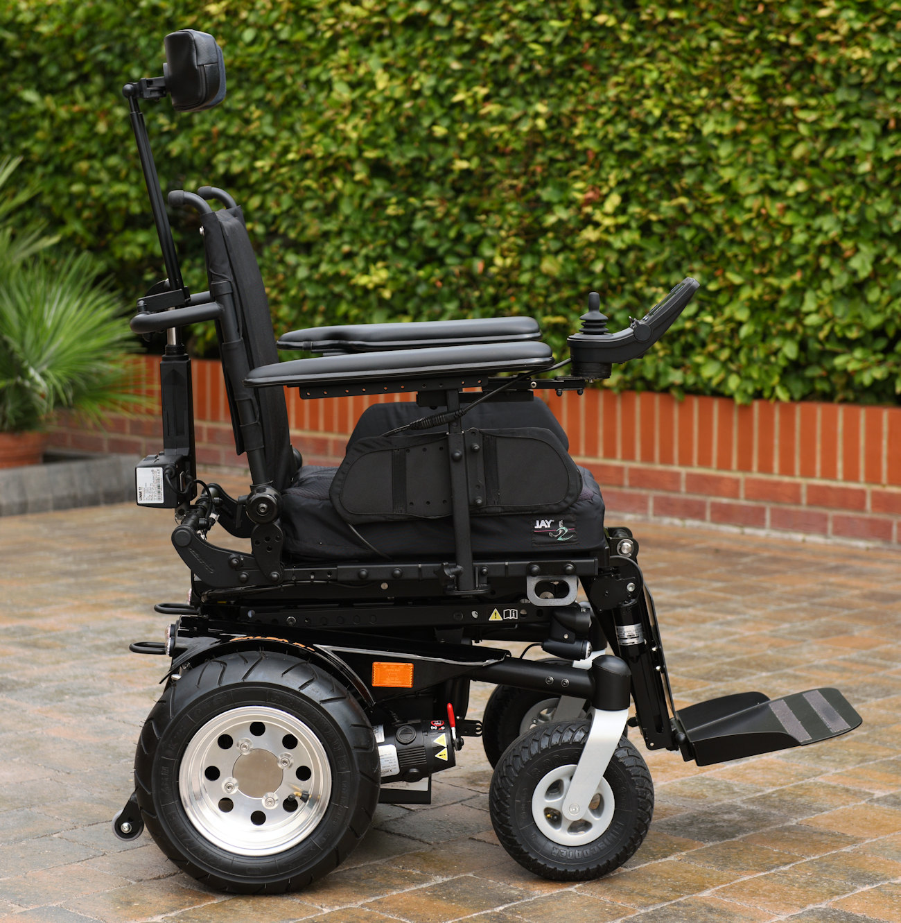

Re: Help with tyres

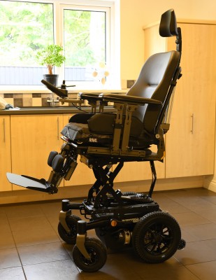

Postby Burgerman » 13 Apr 2025, 12:00
And not one has a stock wheel...
Posts: 71091

These are tubeless, and going on a Dietz chair!

The Q700 had 2 part rims. I added a 3rd part. to make the rims wider. It is an extra bead rim from some Sunrise Jive wheels. With the lip (edge) cut off. So it adds an extra inch in the middle.
See martin my carer sat in it here:
Posts: 71091
Re: Help with tyres
Postby Burgerman » 13 Apr 2025, 13:31
Or his brushless one, widened with sheet metal and rivets!
Where theres a will theres a way... Even on brushless hub motors.
This was a 4 inch wide rim. Up from 1.75...
And a 110/80-8 tyres. With TUBE!!! I never give up!

I took a couple of pics to show whay a tubeless rim is tubeless.
And to show the rims I use, and the adapters that shirley made for these rims. To fit the Dietz chair in this case.
Rims are solid alloy, electroplated, tubeless 3.5J (width between beads) x 8 inches diameter. Meant for honda monkeybikes, X50 etc.
These rims come in many sizes.
Tyres are the DURO tubeless 120/70 - 8 size and not cheap! Superb quality.
Pic of the rim. NOTE the two raised bumps. Those keep the tyre in place and initial inflation causes the tyre to jump with a pop oer these. Needs a tyre fitting machine to remove them. Ignore the goo near the valve it is silicone grease. Aids in sealing and fitting the valve.
Heres a pair ready to fit on the bench. These have an as yet unpolished stainless centre disk. And this has a hole in it. That hole is for a bolt and load spread washer (same as the 4 already fitted) and it goes into the motor shaft. Its M8.
1.
2.
This is an adapter that shirley made to fit the Dietz chair. Its 20mm I think?
This is the tyre... (no shit sherlock)
