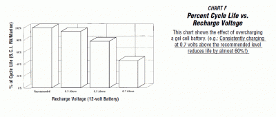

And this is what MK say happens if thats ignored...

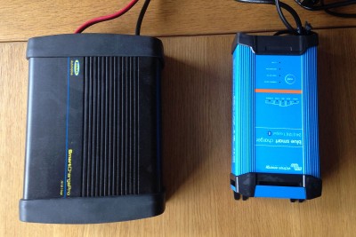

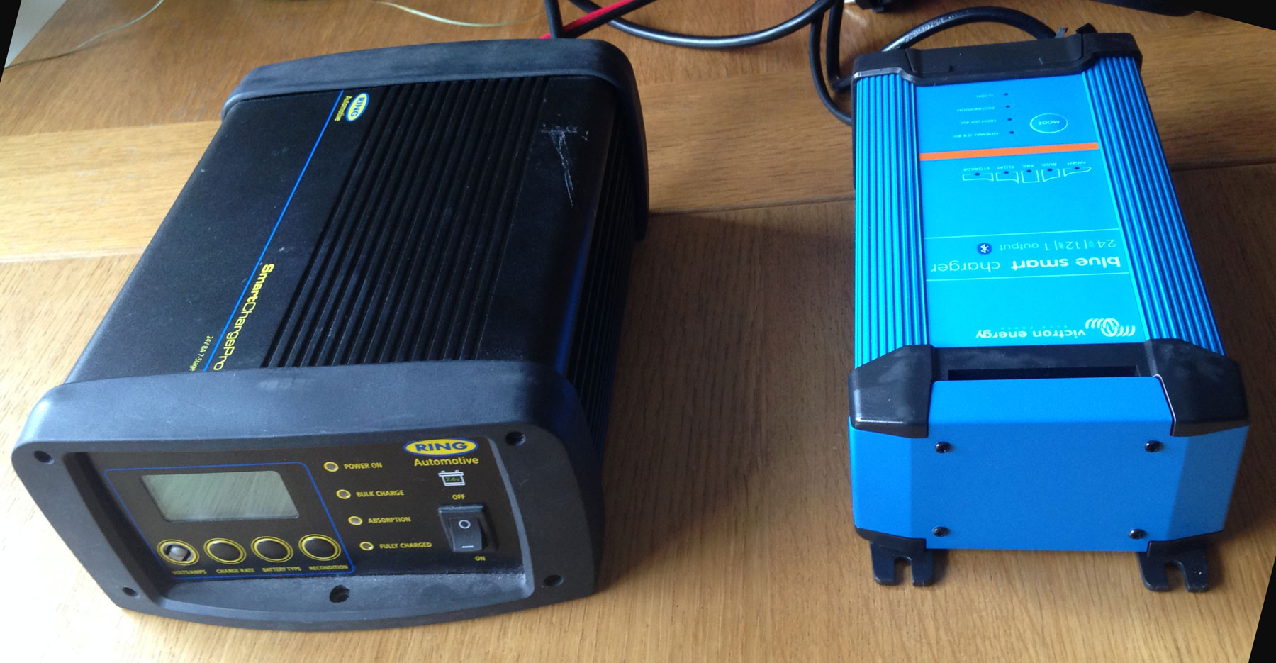

I thought I'd post a few photos of the Victron IP22 Charger 12 amp 24 volt charger with Bluetooth to compare to the Ring Automotive 8 amp 24 volt charger. It's smaller than the Ring and weighs a bit less. The Ring is 1.8kg (4 lbs) and the Victron is 1.3kg (3 lbs).

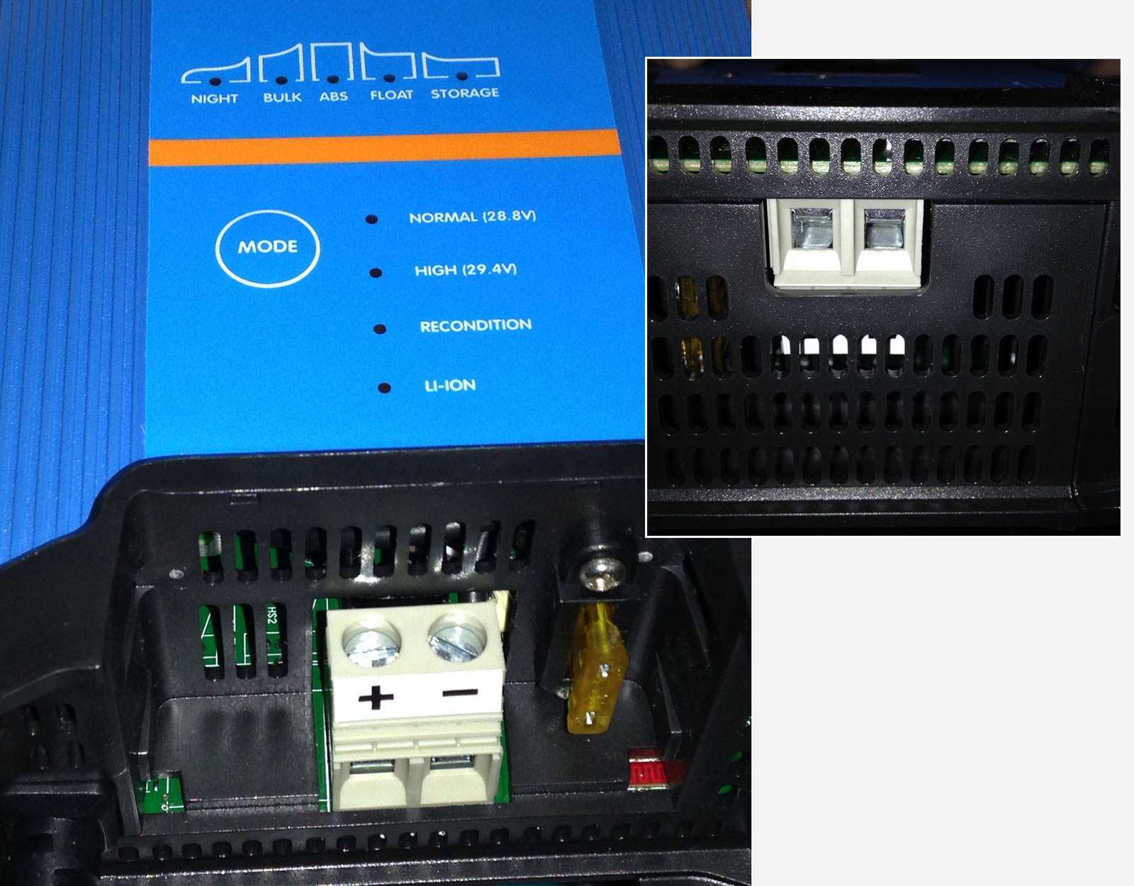

I'll include some photos of the screw down terminals, and the little flap that covers them.
It doesn't come with a cable, so you have to make your own.
If only they had a 28.2v setting it would be great.
