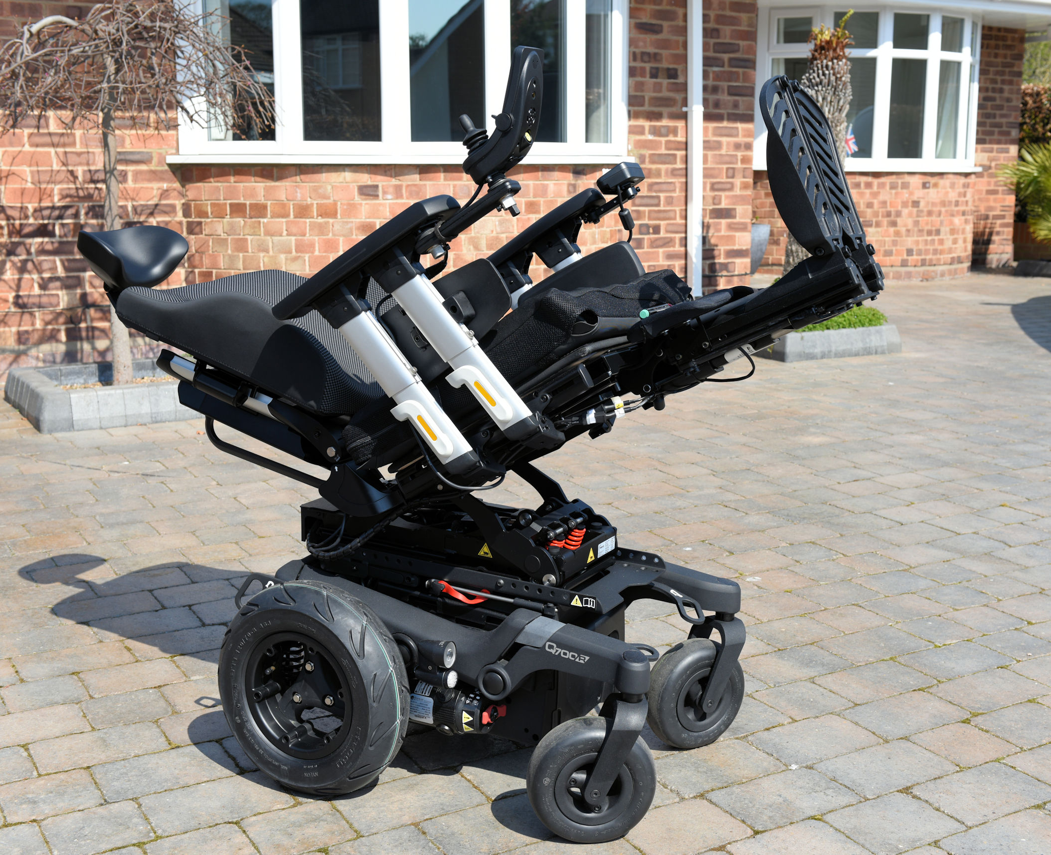

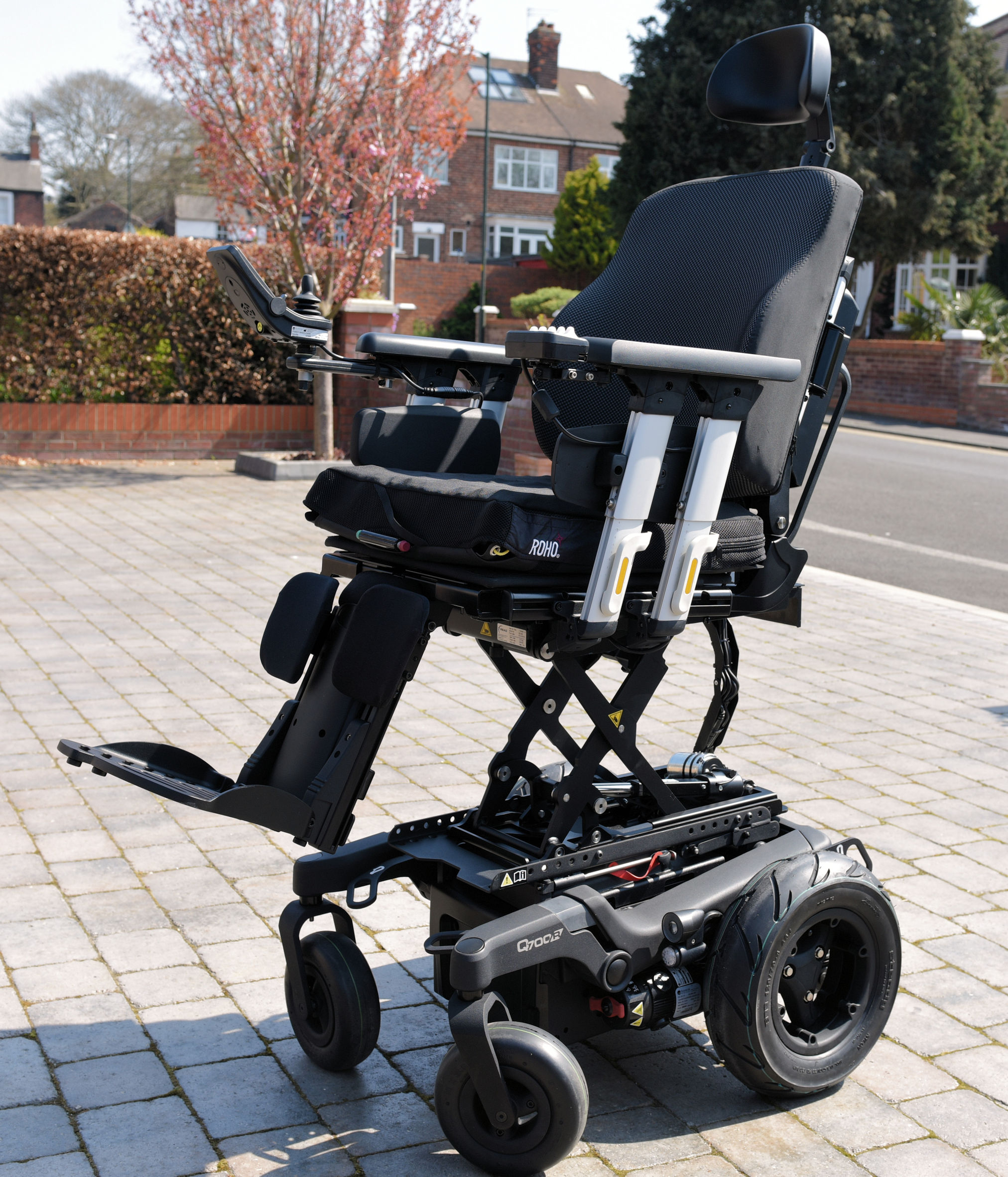

Took some pics in harsh horrid light. Should anyone be interested. Its covered in dust. The chair it replaces, that is better in many ways, is the Salsa here: viewtopic.php?f=2&t=7455&start=600#p122818 Read and scroll to compare!
Q700R

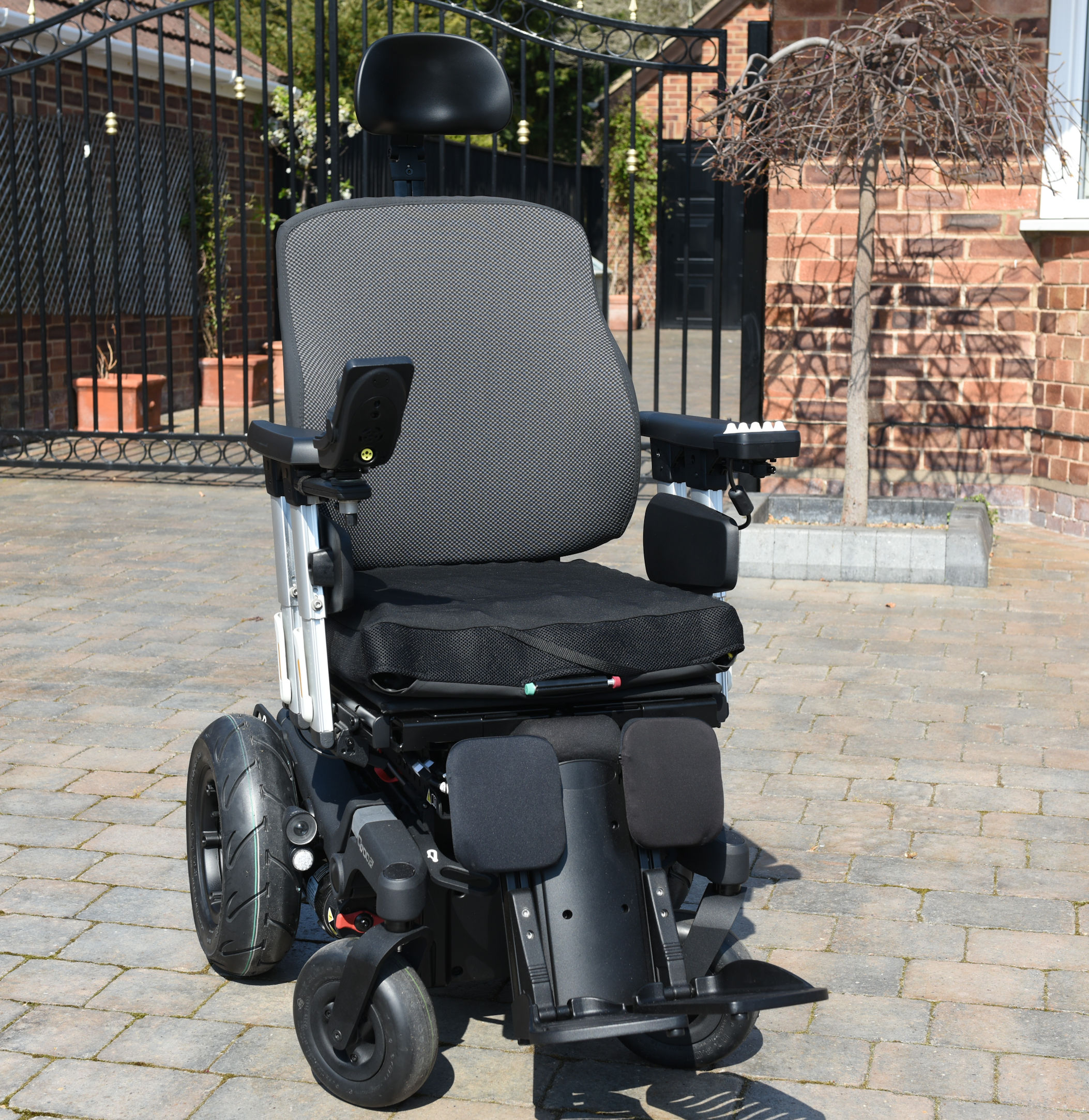

Stock chair has default options:
4 pole 6mph motors (8mph has less torque and I dont like that). 120A R-net, lights, advanced colour joystick CJSM2, gyro (not needed or wanted - why fit that to a rear drive? So is disabled in programming).
Also has user options: Seat lift, tilt, recline, and importantly power centre mount footplate in place of seperate swing away ones. As it allows the seat to move back a couple of extra inches for good CG position and shorter chair with better steering control. And narrower front end for easy access to doorways etc.
And the switches on the left arm Switch it CTRL+5. Not sure if I will retain those or not yet they get in the way and dont unplug at the arm. Meaning the removable arm cannot be removed! Single post arms specified in place of the seat back mounted ones as they wobble and are weak. Doubled up now, because the single post ones are also too flimsy... The Salsa was much better here.
Mods, inc nothing major. Details! Details REALLY matter!
- Wider rear wheels, with stronger 120/70-8 tyres. Smaller diameter 8 inch 3.00-4 caster tyres on stock rims because the caster forks are closer together on this chair than the older salsa. Meaning you need to gain any advantage you can to prevent the caster wheel/centre footplate collision. So as to be able to move the seat and CG rearwards for steer/traction/length/manoeverability and to shorten chair by 5 inches or more.
- Headrest mount has one link removed.
- Seat dump increased by 6 degrees on spacers under seat pan to keep lift at same angle. Because the larger rear and smaller front tyres tilt the chair forwards a couple of degrees. So now the lift moves you forwards as it rises for stability while keeping 4 degrees of seat "dump" when fully forwards.
- Arm uprights doubled up for strength/stability.
- Control pod too loose on that swingaway so stiffened up with rubber washers externally and excess metal sawn off... So nothing sticking down. Still 1/2 inch needs cutting off.
- CTRL+5 Switches on left arm modified mounting (cut and bolted) so they do not sit outside of arm to be wiped out...
- Programmed so it drives PROPERLY with all the usual turn acceleration and deceleration removed and compensation increased to 50mOhms etc and Gyro disabled in every profile except on whereI am experimenting to see if it can be made to help...

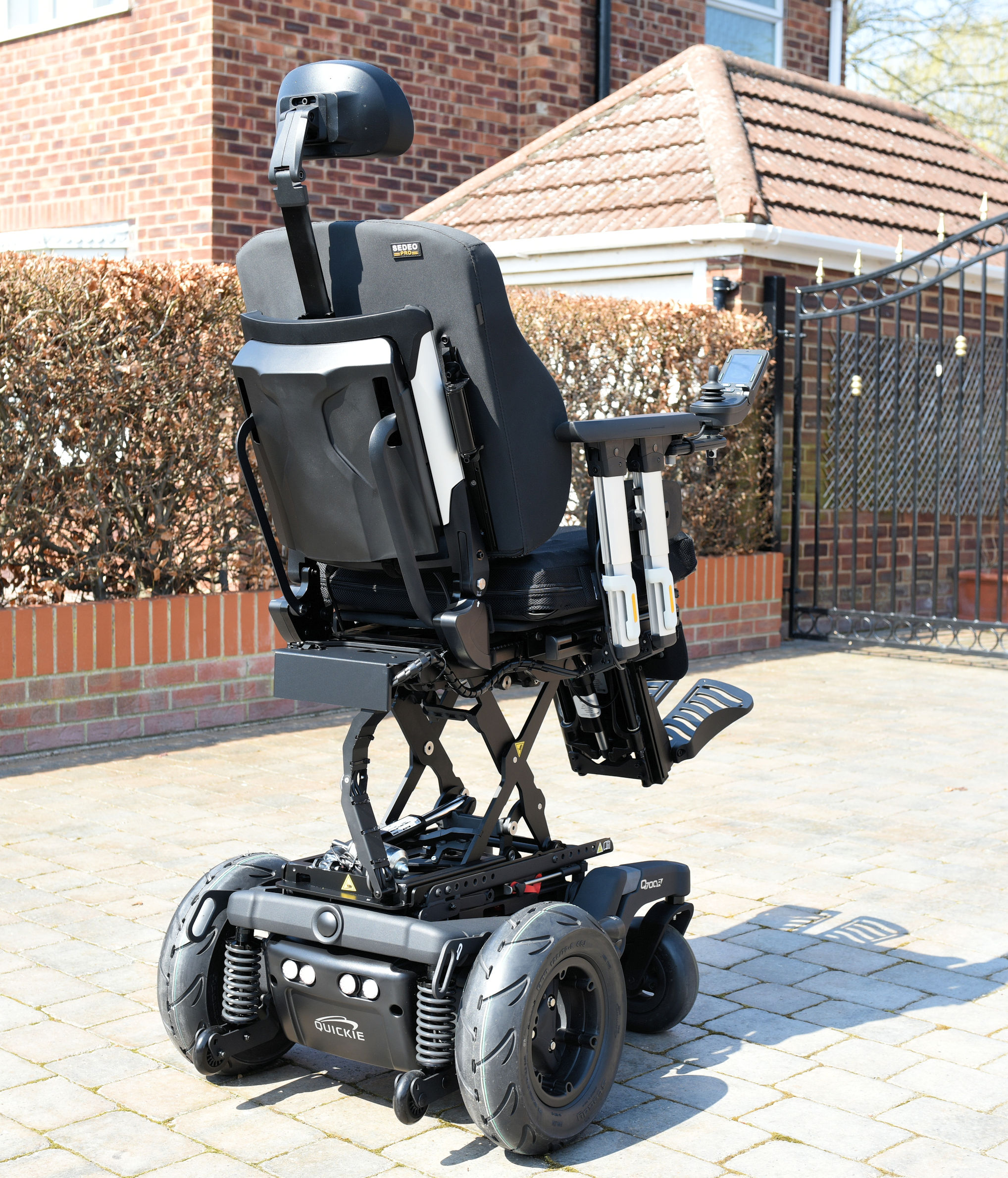

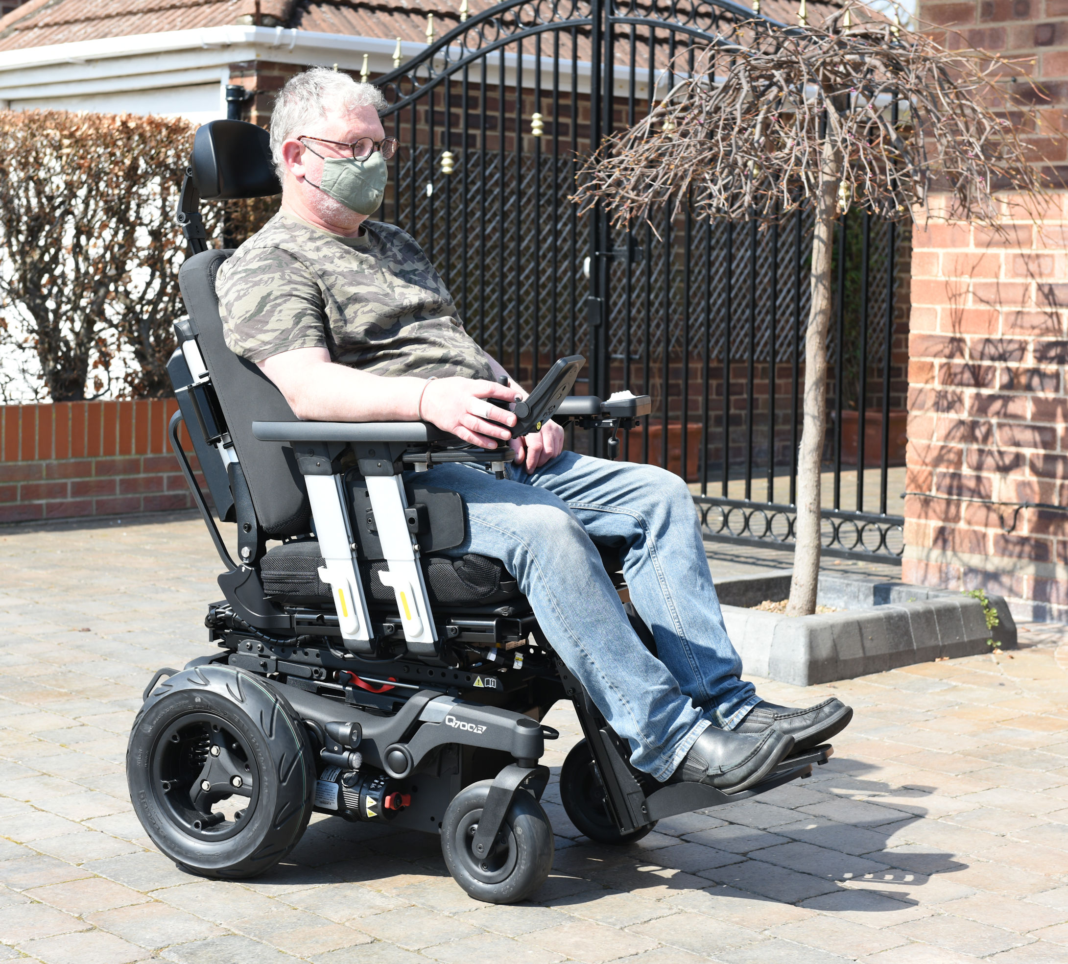

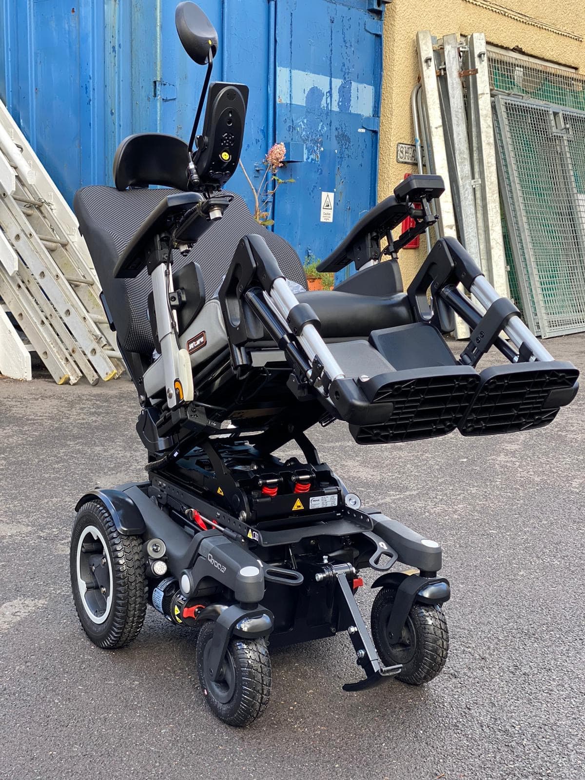

So... Excuse the dust! Although not sure you see it in pics.
My carer who helps me driving - has short legs that dont reach the long 20 inch cushion or footrest. And so looks uncomfortable, sort of like he is sliding off... . Also harsh direct sun makes for horrible pics.

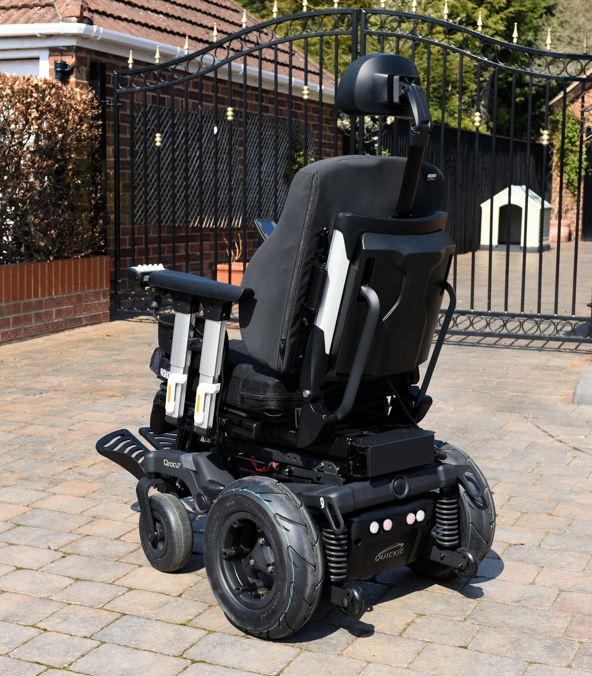

Postby Burgerman » 20 Apr 2021, 01:26

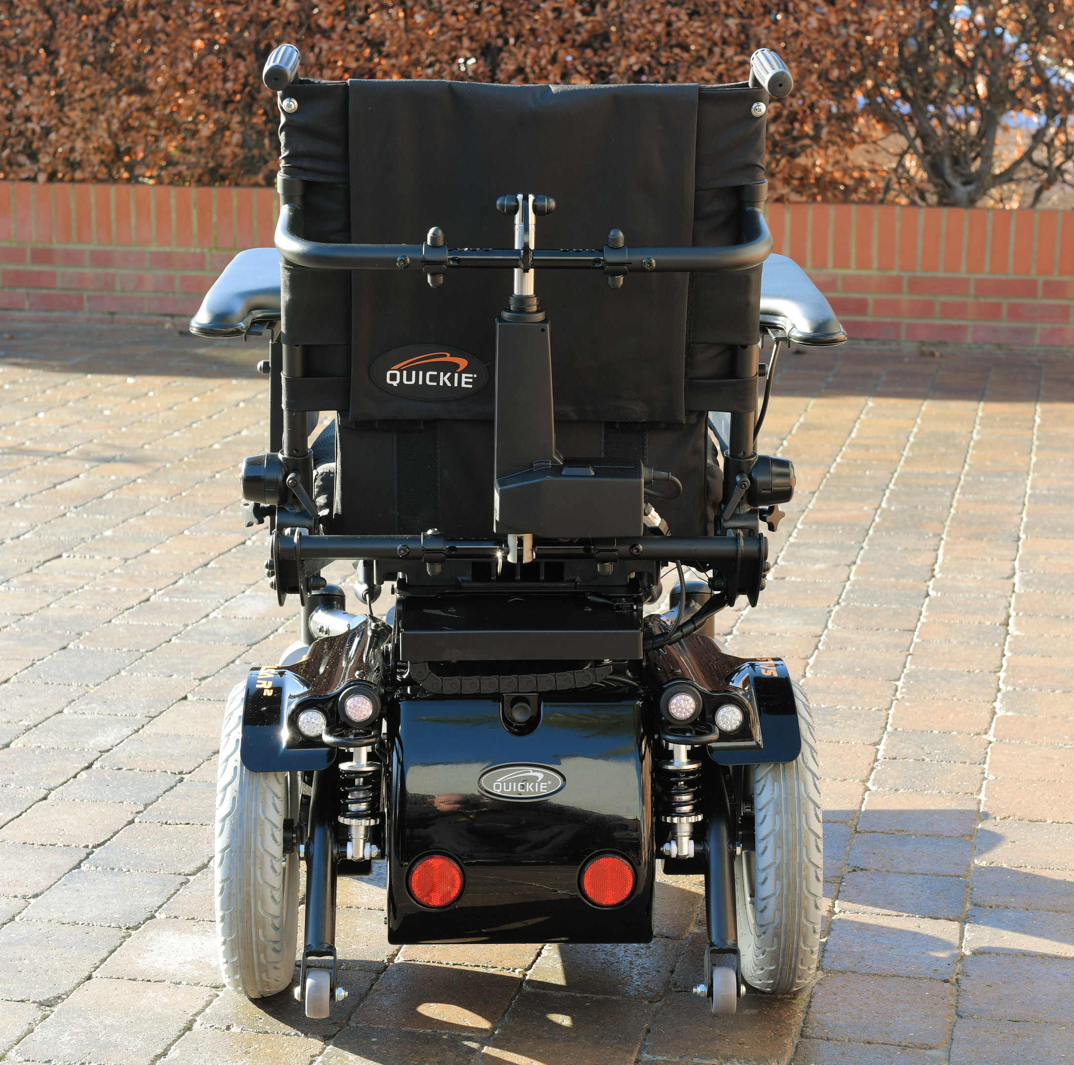

More

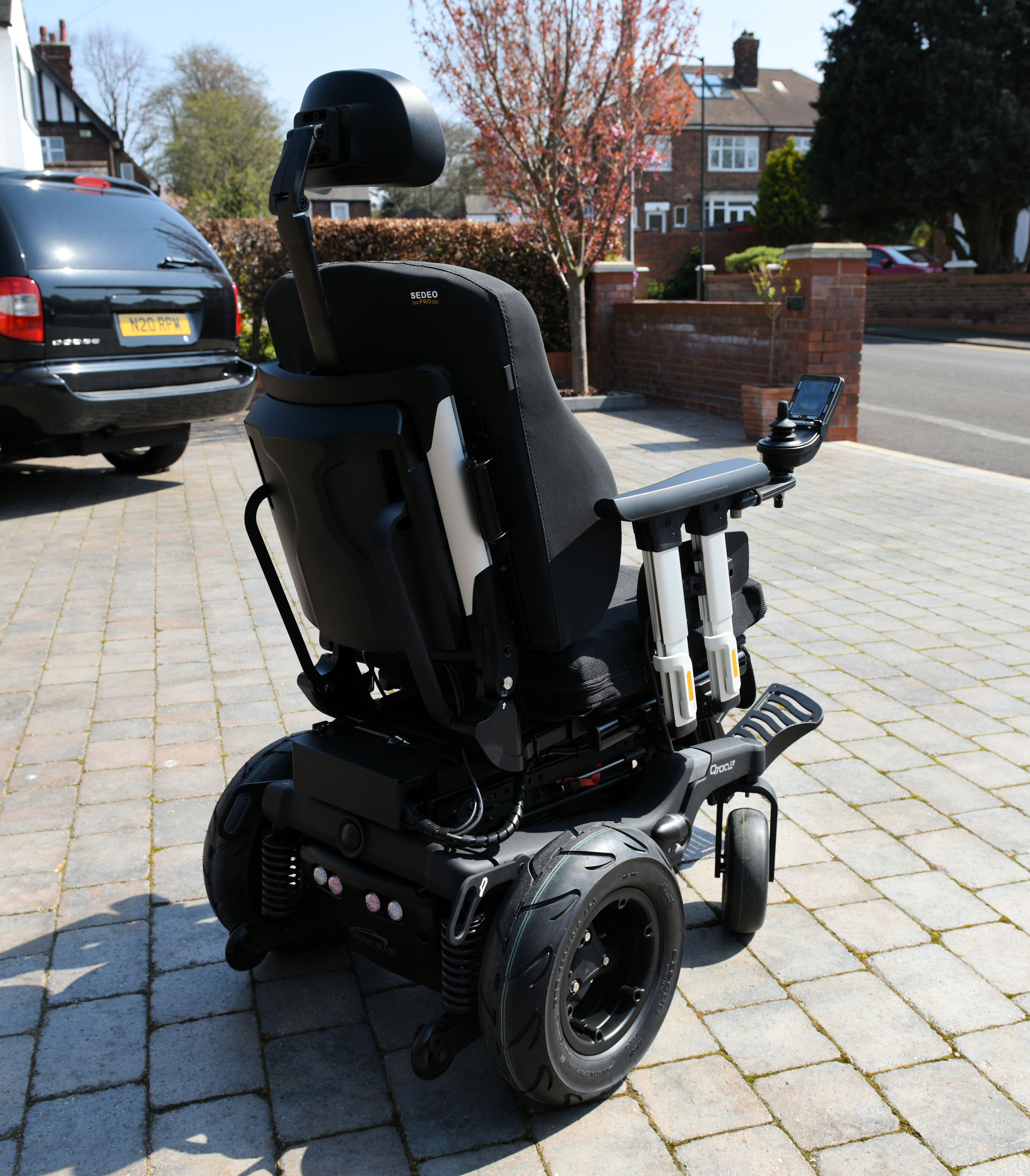

Postby Burgerman » 20 Apr 2021, 01:36

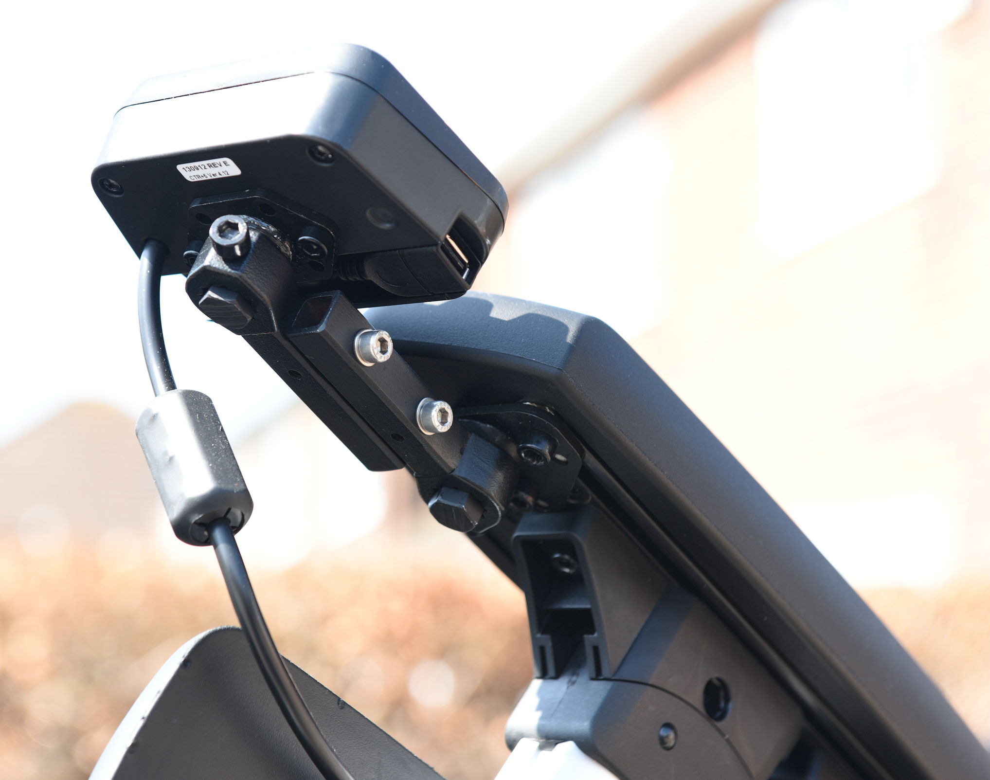

Shortened and spaced to the right mounting bracket. CTRL+5 Switch box. To stop it sticking out wider than the arm and hitting doorways and making the chair wider. And all the long vertical parts chopped off with a hacksaw.
Posts: 71082

Swing away brackets shortened, and a stack of rubber washers at both ends that turn. That stiffen its position up so it doesent move around as you try to drive!
Still has 20mm to be chopped off the joystick mount that hangs down... So it looks like the above posts mounting. These things are around 5 inches long normally! :fencing

And is your carer not vaccinated yet...noticed the mask

Vaccinated? Yes. He likes the mask. Its a wild west thing I think!

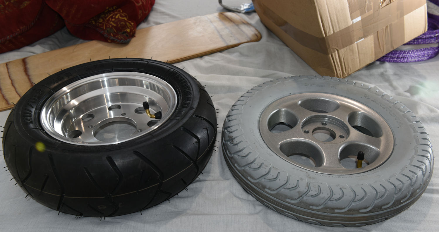

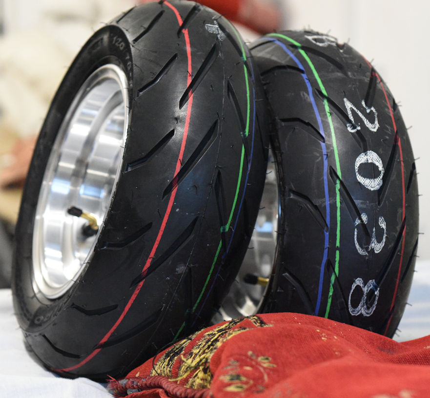

Change tyres? The 110/80 is a better fit for the 3" rims. Perfect in fact. The 120/70 tyres really need a 3.5 inch rim like the salsa viewtopic.php?f=2&t=7455&start=600#p122818
has or they are too pointed and squeezed. They look OK, see pics, but the 110/80 is a better match. Look at these, same sized 120 tyres, on the 3.5 inch rims.
Second set of arm uprights and other hardware? ££££££ myself.
120 tyre 3.5 rim
Salsa 120 tyre 3.5 rim
Q700R 120 tyre narrower 3 inch rim

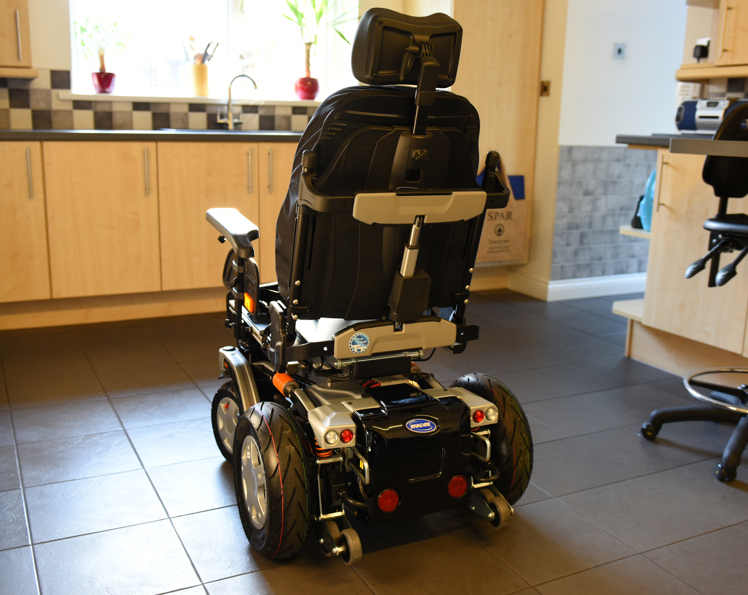

For completeness... Storm 4 Exlore with fat tyres too.
These are the 110/80 tyres on rims that I widened to 3 inches.
110 tyres look better than 120 tyres do on a 3 inch rim. And they actually appear wider! And, they present much more rubber to the road. So wear, grip, better too. These are the tyres I am going to fit to the 3 inch rims on the R700R if I dont fit the complete rims/120 tyres above!

Q700 stock before centre footplate, with grey coloured bits, etc - At least they were black... And skinny and rock hard ride.
With wider rims/tyres mudguards removed. centre footplate, etc.

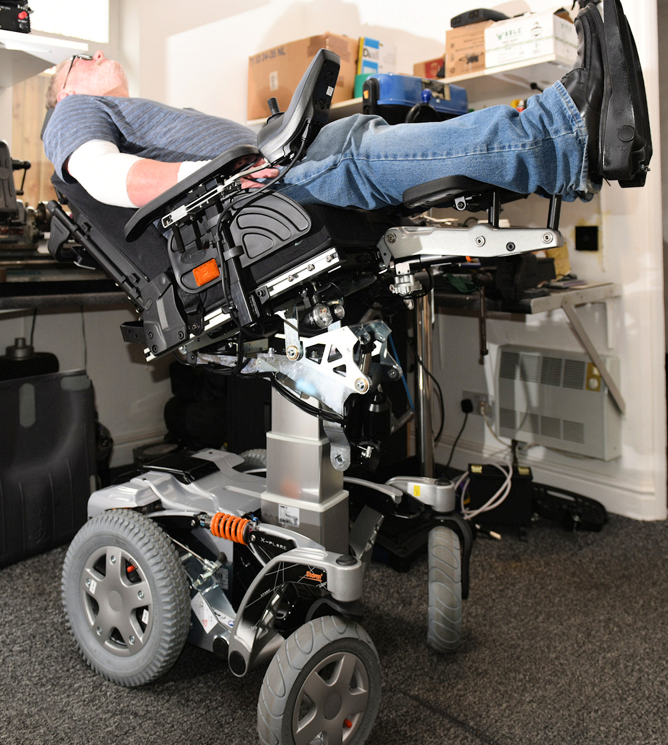

When you go tilt back on the salsa and the q700 now and not elevated, does it tip backwards... I mean now that you positioned the sitting position back further for better c/g?
Toro
Posts: 147
Joined: 15 Sep 2020, 13:32
Re: Q700R took pics and details
Postby Burgerman » 22 Apr 2021, 17:48
Tilt alone on both is OK.

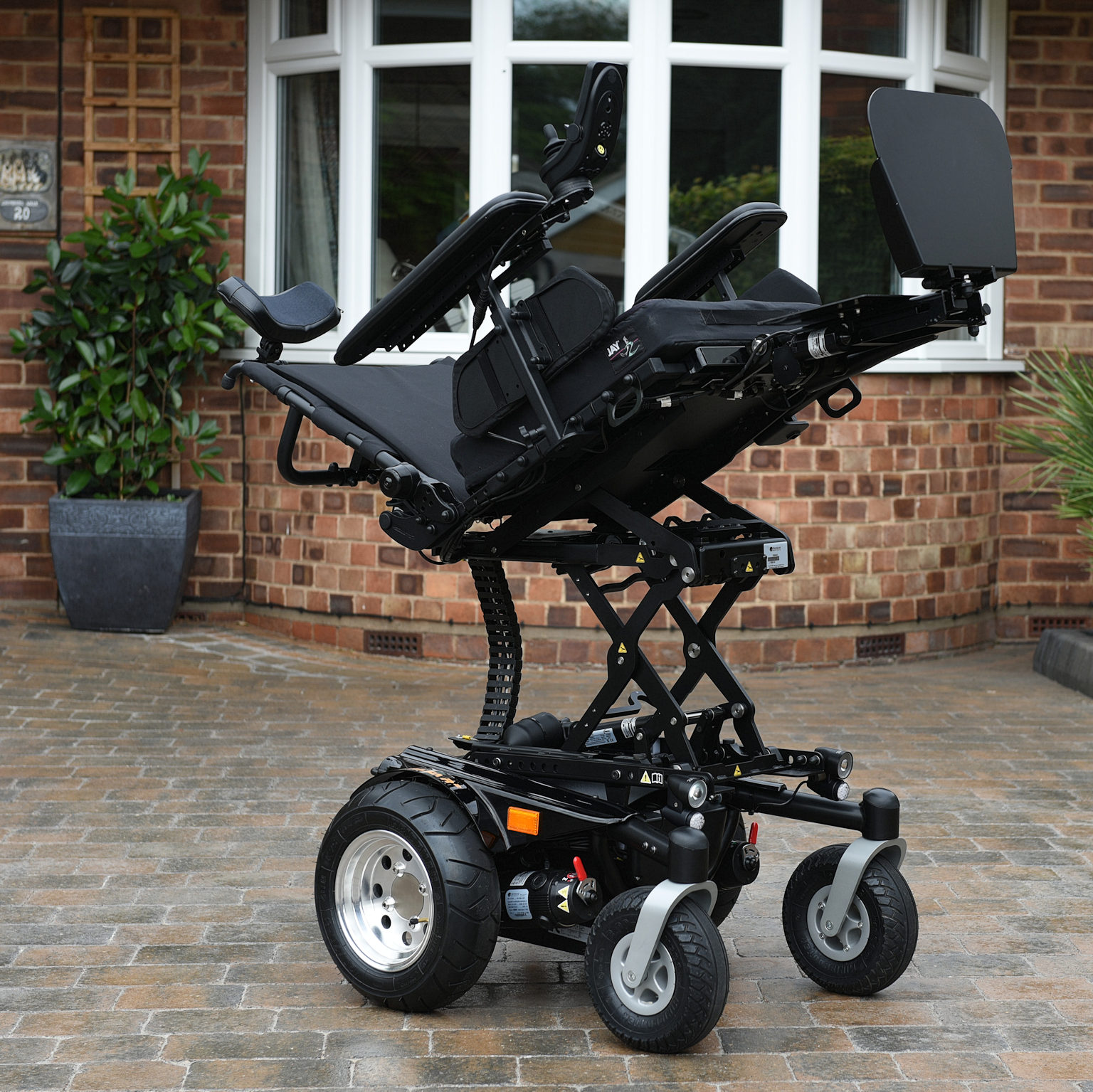

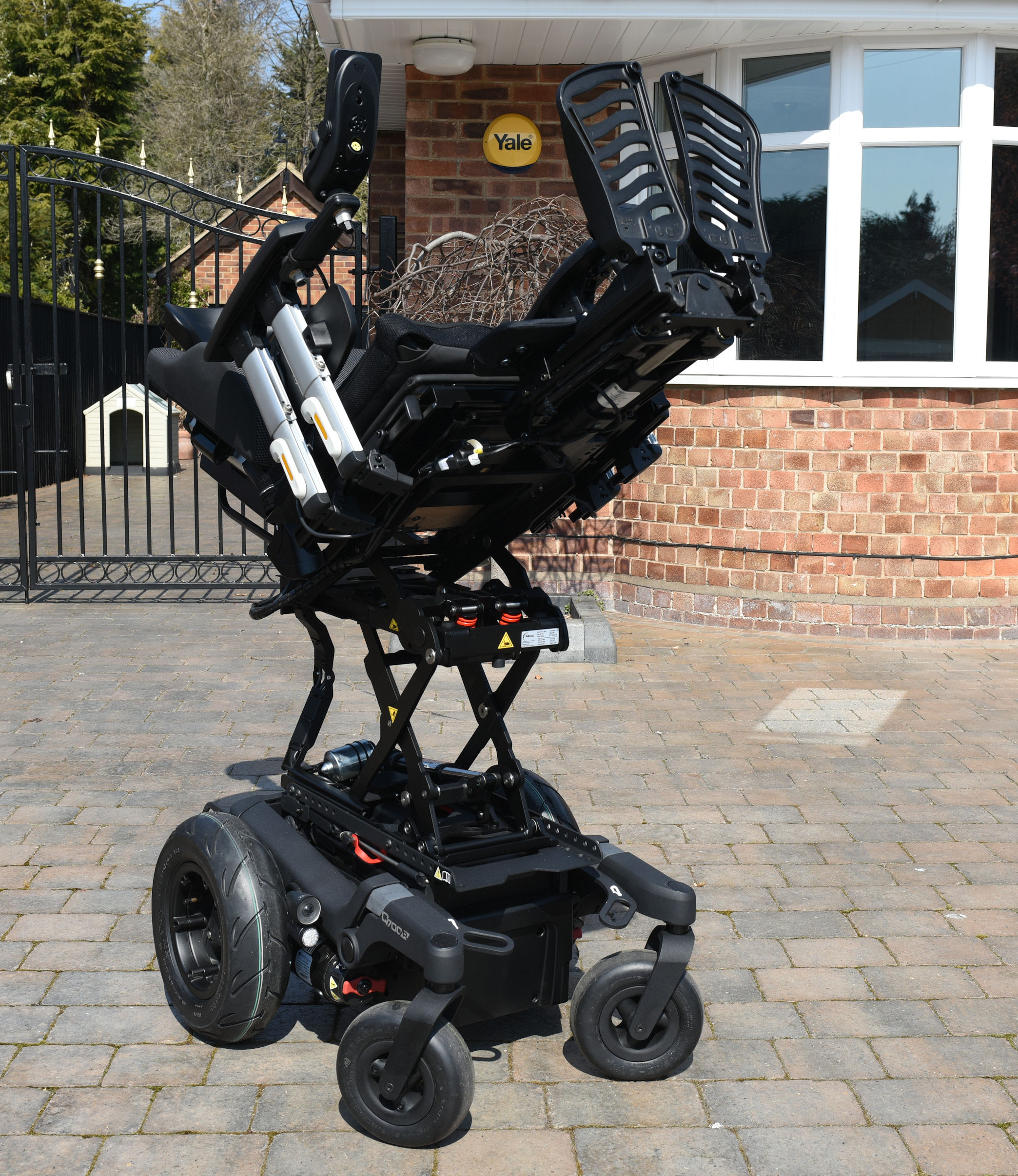

With recline too then its different. Q700 isnt an issue but it still scares me! Salsa is a bit close to tippy... But if you extend legs, which are heavy then its OK. I wouldnt feel safe doing recline and tilt with seat elevator up as well on the salsa! I do do it, but only when theres a bed, or the bar behind me. It takes a gentle push to make it go...
So to fix on the salsa I could do what I did on the Q700. Instead of setting the whole lift/tilt module to say 6 degrees dump, I set it at zero. Now I use larger rear tyres, and smaller front tyres on the Q700 so that the whole chair/seat module leans forwards about a degree or so. On the salsa you can set it minus 1 or 2 degrees. Now in both cases the lift module moves you forwards instead of backwards in inch as you get higher. This is why the Q700 is more stable whe lifted. Now you need to fit spacers under the 4 seat mounting bolts. 2 small ones at the rear. 2x 40mm ones at the front to restore seat dump and actually increase it a little.
This does nothing when you are seated low. But theres less risk if it tips. Its not as if I havent fell out a few times... But I dare not do that while high.
