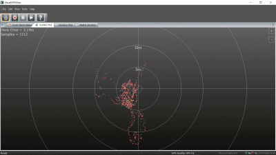

GPS is or can be VERY accurate, but not over short distances and phone aps only display full numbers anyway. Why? Because GPS is only accurate for position, over many samples. Averaged over a period of time.
Take a look at this. This is much more info than most GPS aps will show you on my PC. This is a STATIONARY computer and GPS tool.
It is connected to both GPS and Glonass systems. So two lots of data and two different averaged points. This was over about 10 mins or so.
If the GPS system was actually accurate all these points would be in the same position. And averaged over say 2 or 3 mins they give an accurate position. Remember I am not moving. And after a few mins, those two green circles are the AVERAGE position determined by GPS and Glonass. The rest are every sample, position.

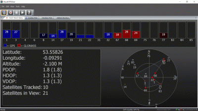

Postby Burgerman » 07 Oct 2021, 10:56
Number of sattelites etc:

Postby Burgerman » 07 Oct 2021, 11:14
Data, raw, averaged, etc. Over time. Remember accurate position is ESSENTIAL to determine speed. The longer the distance covered, the greater the accuracy because it averages all the errors. If you drive 100 meters a 10 yard position error is now a small percentage. (10% error). So 1mph becomes 1.1 or 0.9 worst case.
