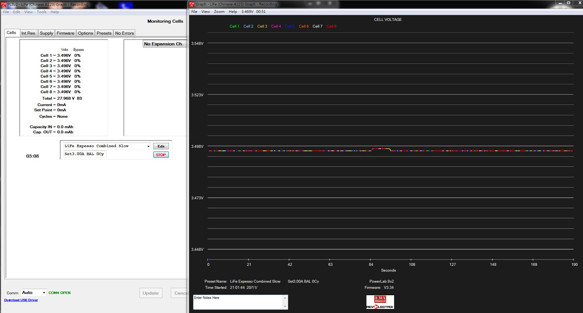

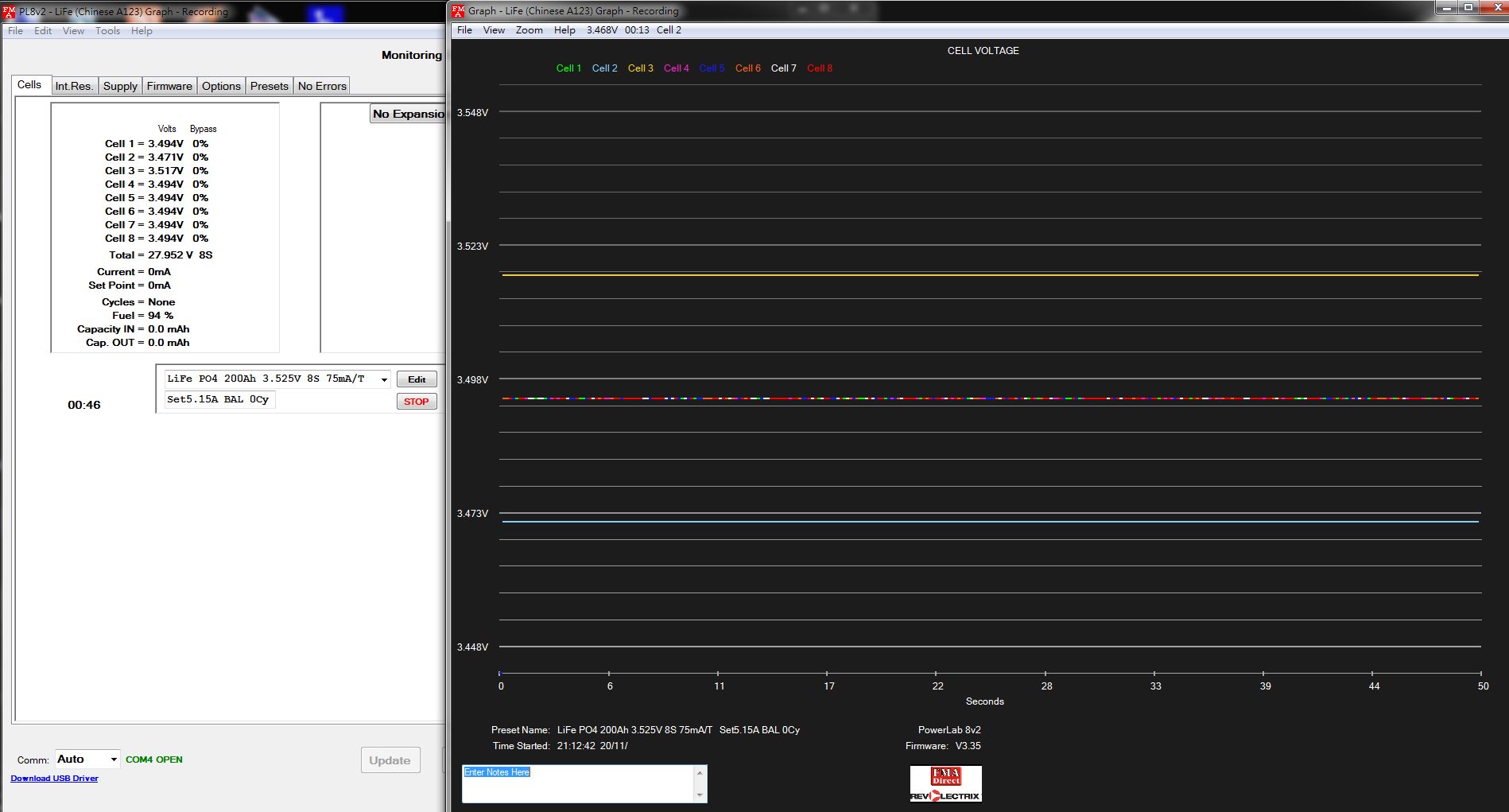

Postby shirley_hkg » 20 Nov 2021, 14:28
I really wish you were right , but sadly it itsn't. banghead
The other PL8 shows the right things.
Want the contact for repair.
Anyone has it ?
Posts: 4656
Postby shirley_hkg » 20 Nov 2021, 16:27
The magnitude of the voltage differences are the same , Δv +/- 23.
Maybe a cap /resistor of that 2_3 node has changed value .
Could be a simple fix for someone familiar with electronics. :wave:

Postby Burgerman » 20 Nov 2021, 17:21
If we knew how it could be calibrated in software. But its not supposed to change. Its plus/minus 3mV as stock according to the manual. Which is pretty much increadible if its true.
This is one of the reasons I dont trust a BMS that tries to correct voltage all the time. If it reads voltage at say 3 to 10mV wrong, which it probably does, then it will spend all day long UNBALANCING the pack.
But even your 23mV is perfectly safe above 3.45V. It may mean your 3.600V cells have one thats just 3.023 low or higher. Thats so tiny it doesent matter. Its just 0.02 of a volt! Far more accurate than almost every volt meter is.
Posts: 71096
