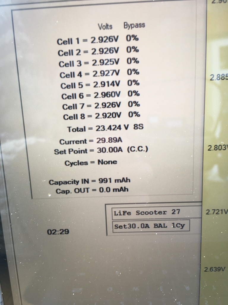

I tried recharging the whole pack again in the scooter, but the PL8 faulted out again just after 3 mins.
Photo just prior to PL8 tripping.

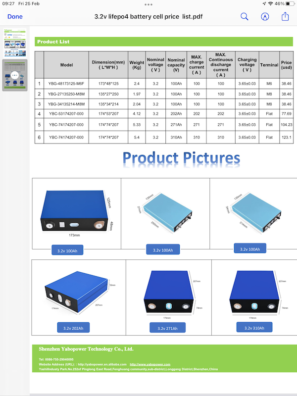

FishinJunkie
Hi, I'm guessing 207mm is the height? 8 cells would fit in my scooter. It has 2 battery trays either side of the seat post, so 4 cells in each tray.
Battery Size:
174*53*207mm
Is this how they arrived? And the M6 studs are actually welded into the terminals? They look good and I like the way they protected the threads with what looks like a piece of heat shrink sleeving.
NB: If I can't rescue my existing pack then I'll email the lady for a GBP price.

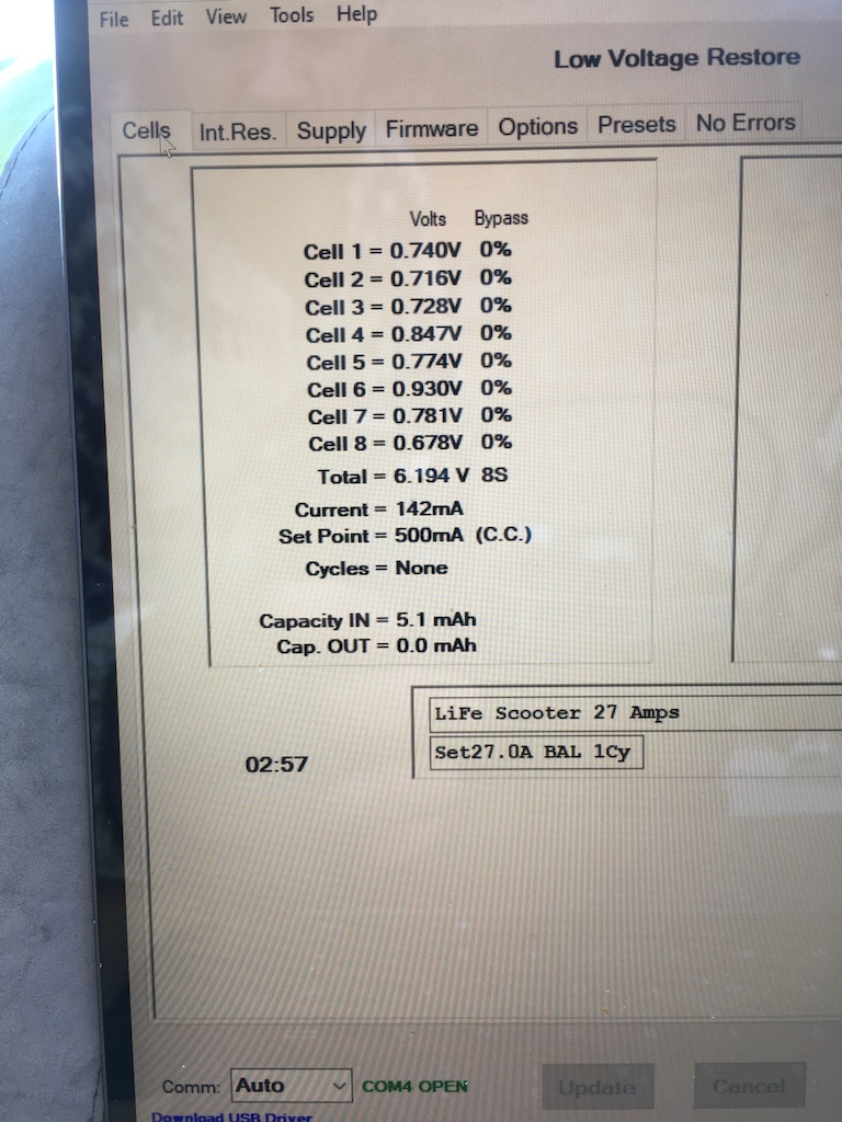

Postby Scooterman » 25 Feb 2022, 14:05
Well they're charging which is good.
Just have to see how it goes cheers

Postby Burgerman » 25 Feb 2022, 17:08
That looks promising. Cant really have been at 1v?

Postby fishinjunky » 25 Feb 2022, 21:06
Scooterman wrote:FishinJunkie
Battery Size:
174*53*207mm
Yea they came with the studs welded. And packed well.
The 207mm is without studs I think 224mm with studs but ask the lady to be sure
They came with heat shrink on the terminals
I'm happy with them

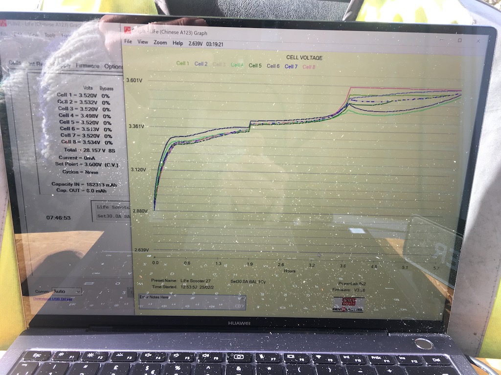

Postby Scooterman » 26 Feb 2022, 12:44
Burgerman wrote:That looks promising. Cant really have been at 1v?
Hi BM, yes they were you can see in previous photo here:
Yesterday I they took 182Ah and the IR readings was good. But they took a long time to balance and when they all finally came together the charge terminated early at about 2.5A? I don’t know why, but it late (9pm) and dark and I was knacked, and had had enough so I took a couple of amps out of the pack to pull the voltage down and packed up. I’m going to finish charging them again today at 10A and see if they come together again and stay together for 30 mins or so (horizontal wiggly line) and terminate at set TC.
(Terminated early yesterday 9pm.)
Postby Scooterman » 26 Feb 2022, 13:35
I'm happy with them
Hi FJ, I emailed the lady and she gave me good price and sent this. Looking at the photo some look to have welded studs and some don’t. Are yours in this photo?
Postby fishinjunky » 26 Feb 2022, 14:32
Scooterman wrote:
I'm happy with them
I think they will weld m6 studs on the any of their cells if you specify that's what you want

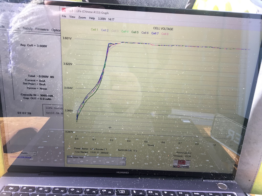

Postby Scooterman » 26 Feb 2022, 15:42
Part 1: CV timeout was set to 2hrs, that was why.
Part 1
Part 2: TC didn't seem to want to go below 1A so switched off pack manually.
Part 2

But surprisingly my cells which I thought had gone terminal hanged
Have managed to recover and take a charge. I've not tried riding the scooter yet but will see how it goes. If I break down at the roadside I'll email the lady sharpish :computer
But all the time they last I might as well go on using them. It's not just the expense, I'd rather not have to physically rip out the old pack and build and install a new one. The scooter is too big and heavy to get on a bench which means have to some of the work sitting/lying on a cold hard floor which isn't fun! Especially when I can't find my 10mm spanner cos I'm sat on it!
Postby Burgerman » 26 Feb 2022, 18:44
Bcause high internal self discharge? Check balance by topping up in a few days.
