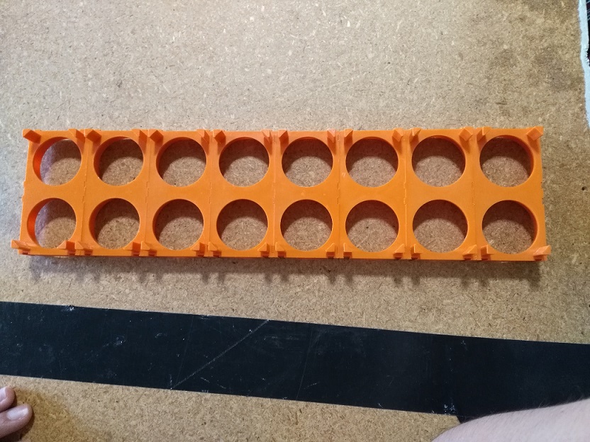

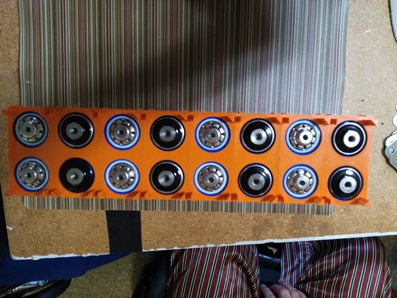

Pics have been deleted by mistake

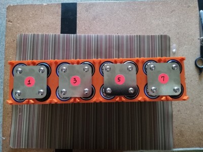

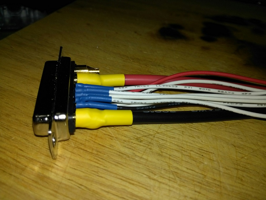

here they are - if any one interested -

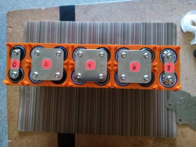

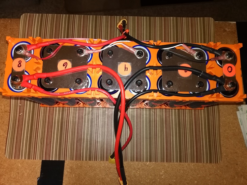

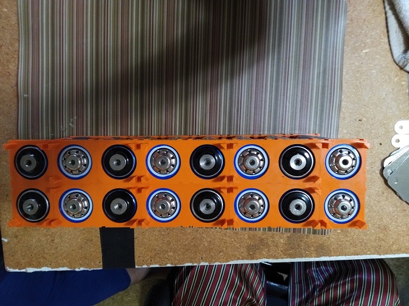

Re: PINNED - ADD ON PACK Step By Step 30ah Pack build / pict
Postby expresso » 22 Oct 2022, 03:54

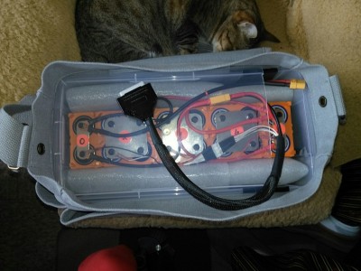

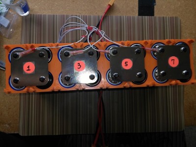

more

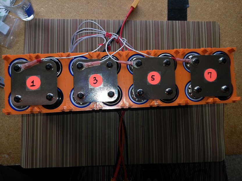

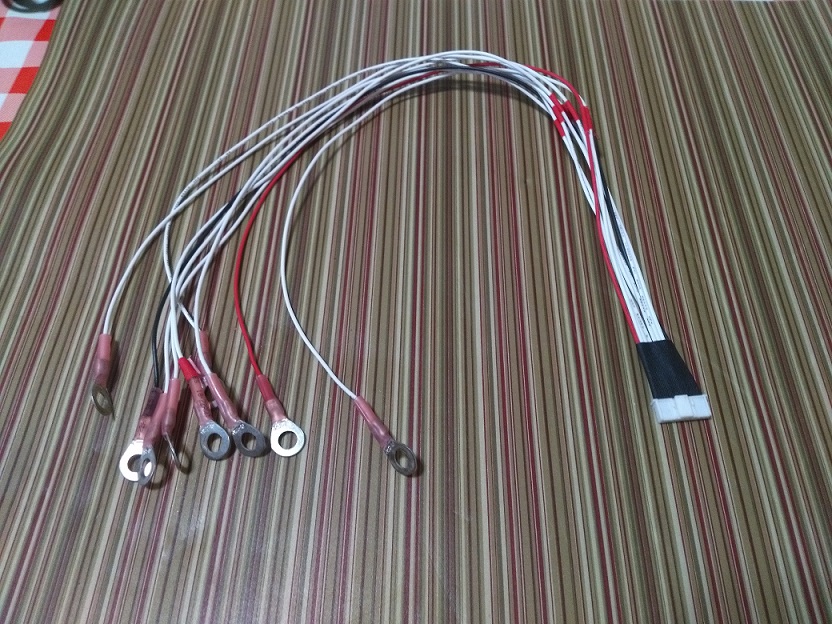

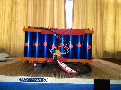

more

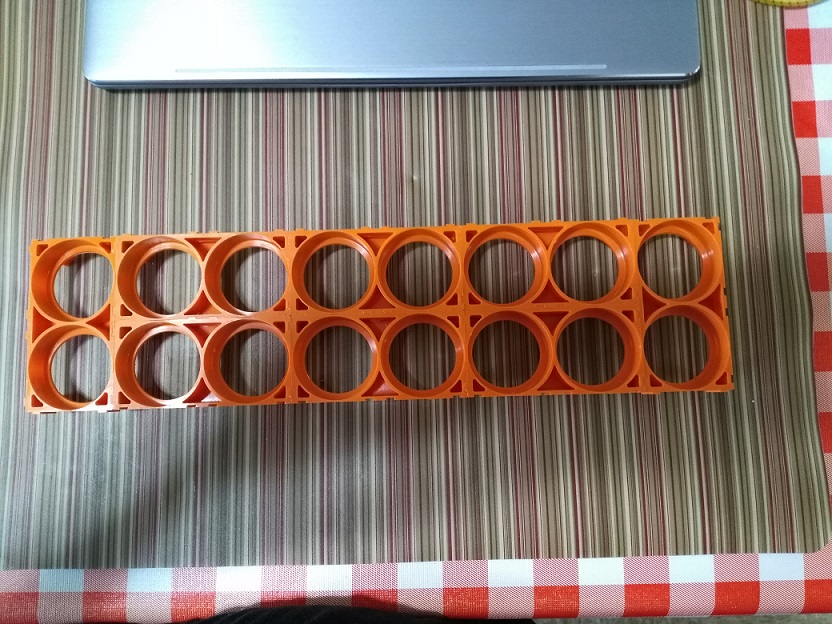

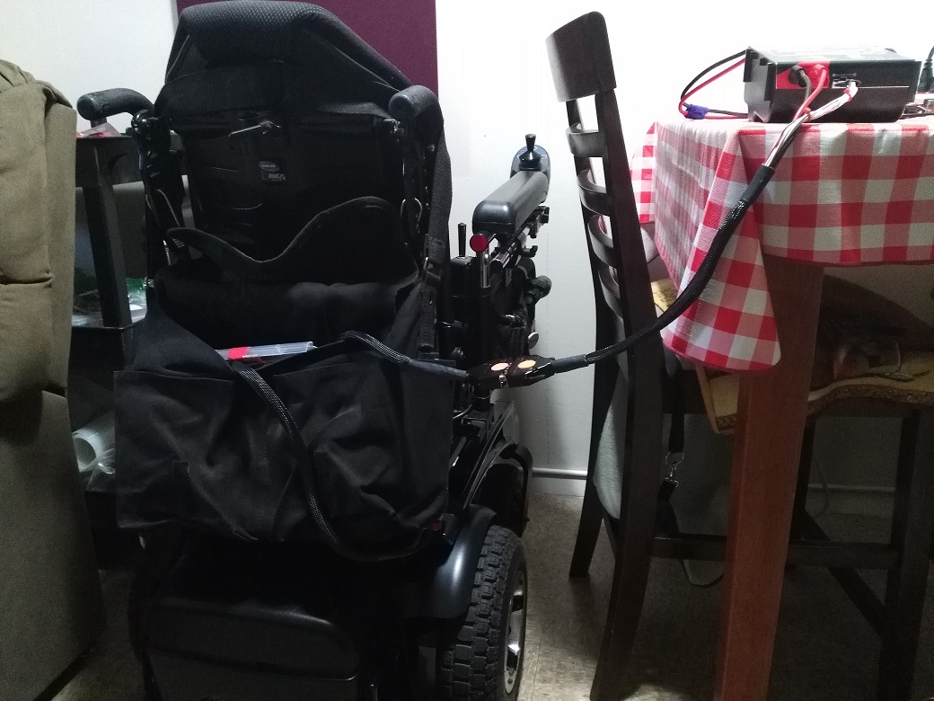

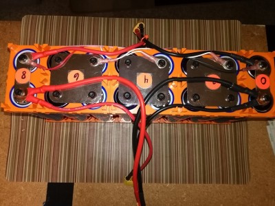

more
