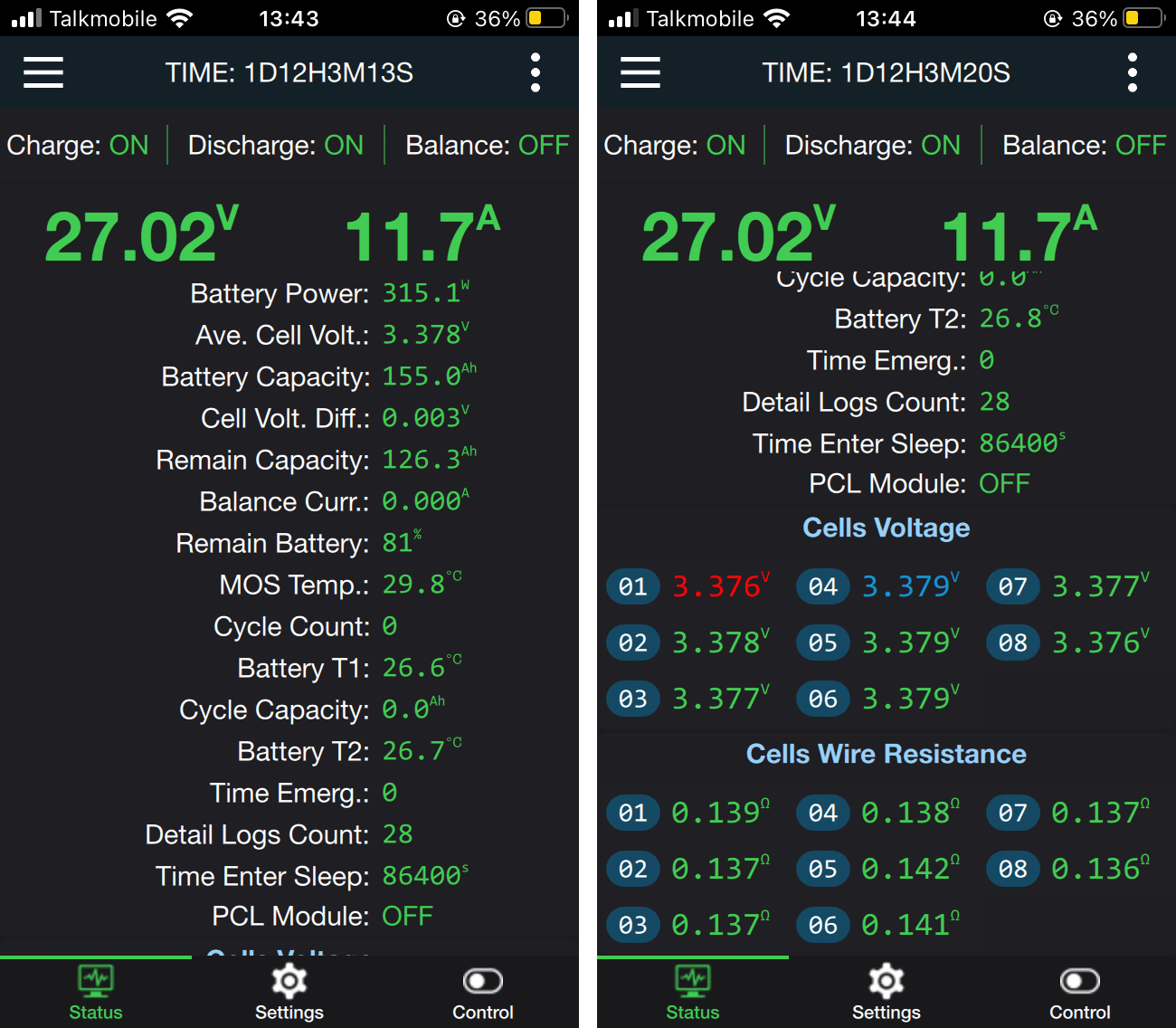

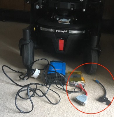

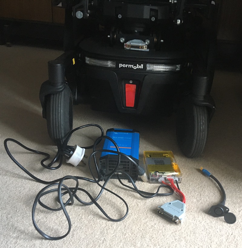

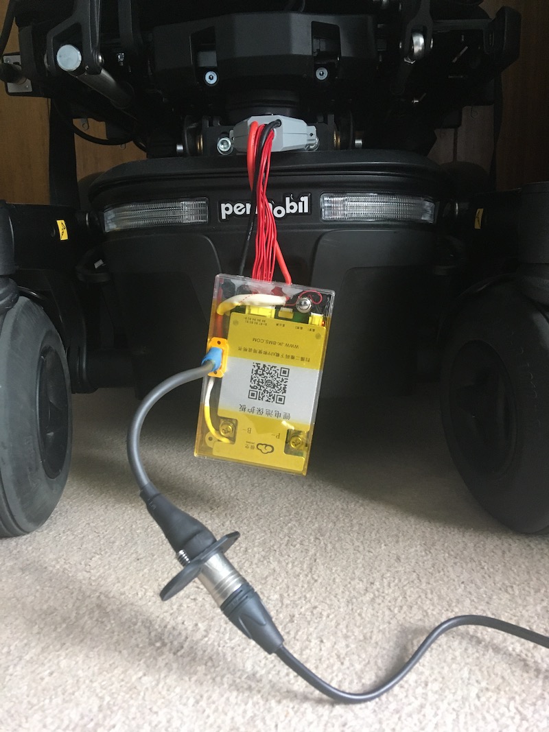

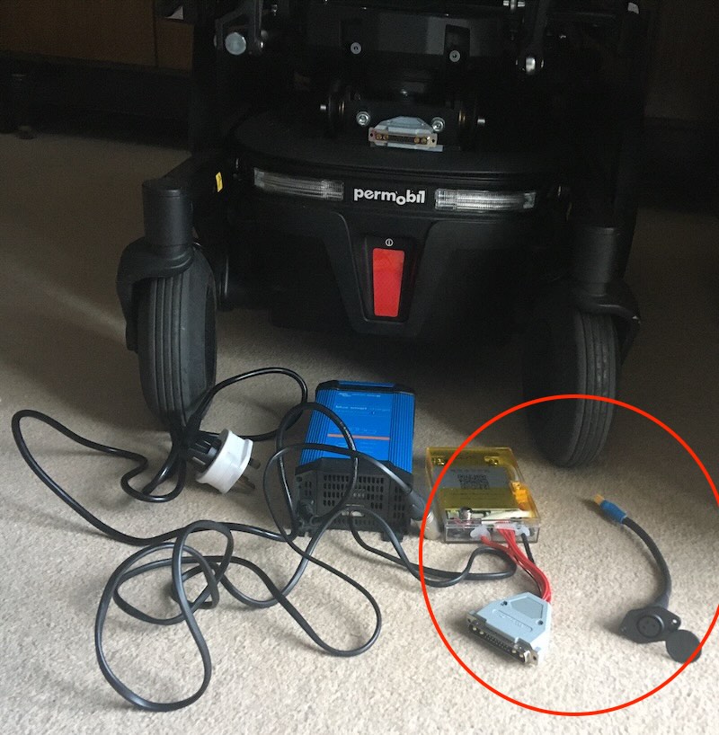

He made one for me and it seems to be working well. It has an app for the phone to monitor the charge via bluetooth. I've been testing it with my Victron IP22 bluetooth 24V 12A charger which has a "power supply" mode which I've been using, set to 28.4V.
The IP22 is relatively small and light and the bluetooth is nice to see what it's doing. Adding the BMS and cables is a bit more to carry on a trip, but of course it's much less heavy and bulky than a PL8 and power supply.
It's great that for a day trip I don't even have to think about charging with the 160Ah pack. And with this I can safely charge overnight on longer trips. I guess in theory, if I charge 6 hours while sleeping it could put back about 70 Ah. I'll post some more details and screenshots from the app over the next few days.

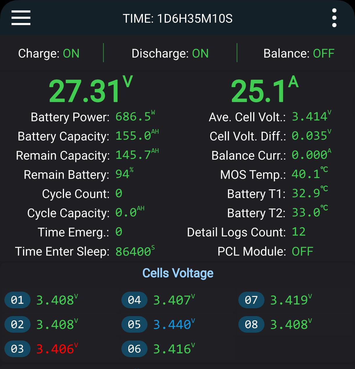

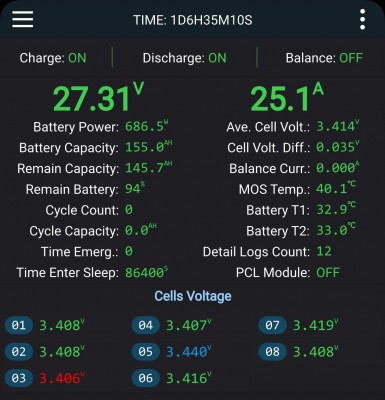

Here's a screen recording from my iPhone showing the charge after it started to balance.
In the individual cells view I'm not sure what the different colours mean; blue, green and red.
youtu.be/RamlHfE1XoA

Postby Burgerman » 12 Nov 2024, 17:08
The balance "looks" great at that low 3.46V per cell level, at this ow voltage point.
Its decieving though because while they are all very close together in voltage, they may be quite far apart in actual capacity. The cells only just begin to show a difference at this voltage level. It works to a degree but it really needs to be balancing at 3.550V. (Or according to manufacturer 3.6 to 3.65V with a BMS). At the top of charge. Its better than nothing, but you ideally should use the PL8 as well every few charges with full balance at 3.550V or 3.600V.
It will allow a "safe" charge however. Albeit slow.

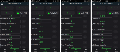

Postby jefferso » 12 Nov 2024, 18:30

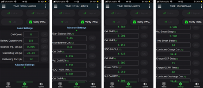

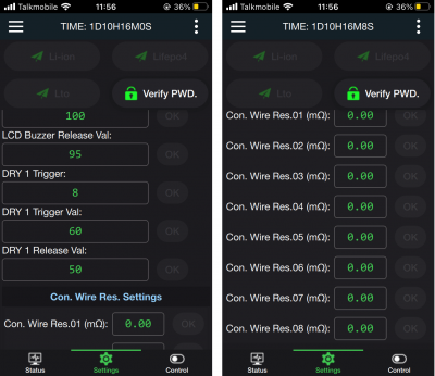

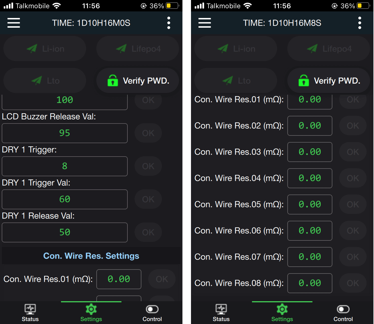

The device has a lot of settings in the "Advance Settings" section. My phone screen is small so it takes a lot of screenshots to show them all. I guess it would have kept going higher if I'd left it on longer. It does seem pretty slow at balancing. Seems good for travel anyway. I definitely prefer the speed of the PL8 when home so hopefully that will keep it balanced most of the time.

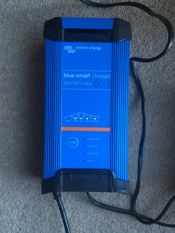

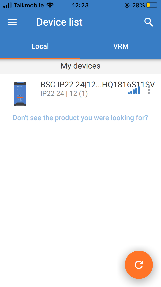

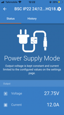

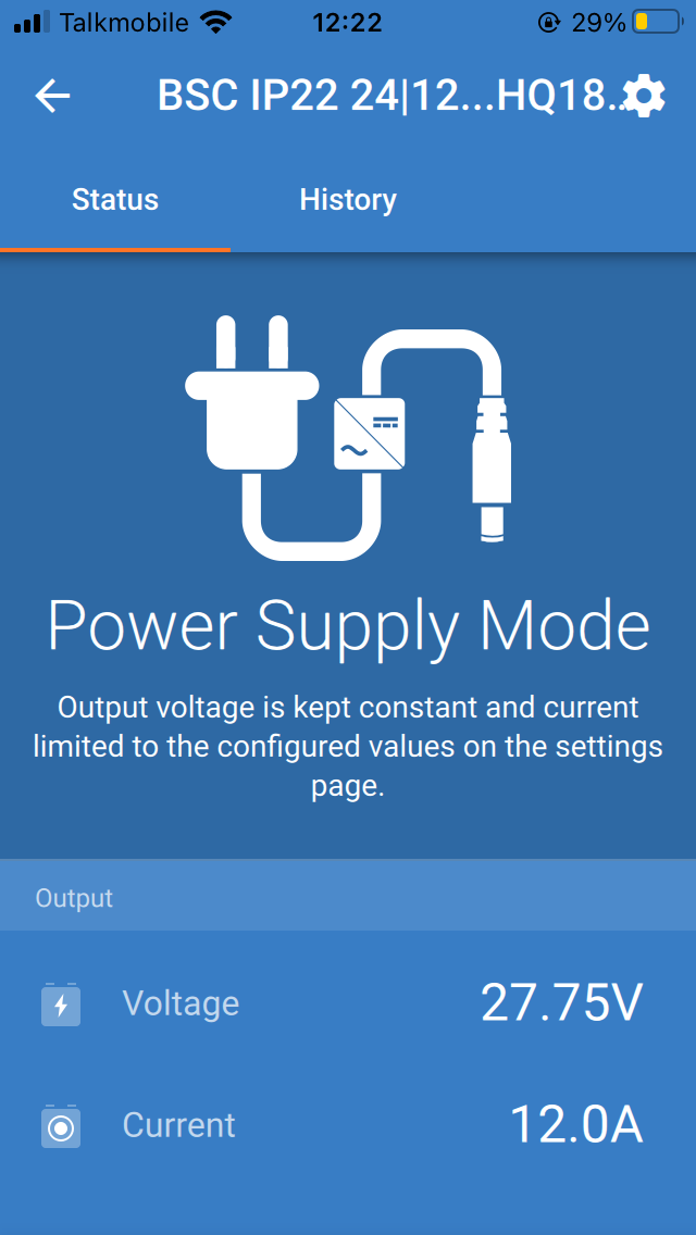

Below is how the Victron IP22 shows up in my phone in Power Supply mode in the Victron app.

It looks like the IP22 doesn't come with an output cable. I've got a couple of the IP65, It has an two wire output cable that I cut off the end and connect an XLR plug cable.
How does yours work?? Also, where did you find the XLR cable? All I could find basically was very small wire microphone cables. I've been buying cheap used wheelchair chargers from ebay and just cutting off the cable.
Thanks for any info.

Postby jefferso » 14 Nov 2024, 00:36
wes4dbt wrote:Jeff,

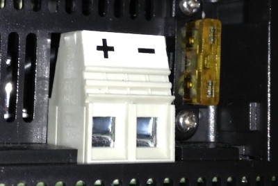

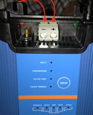

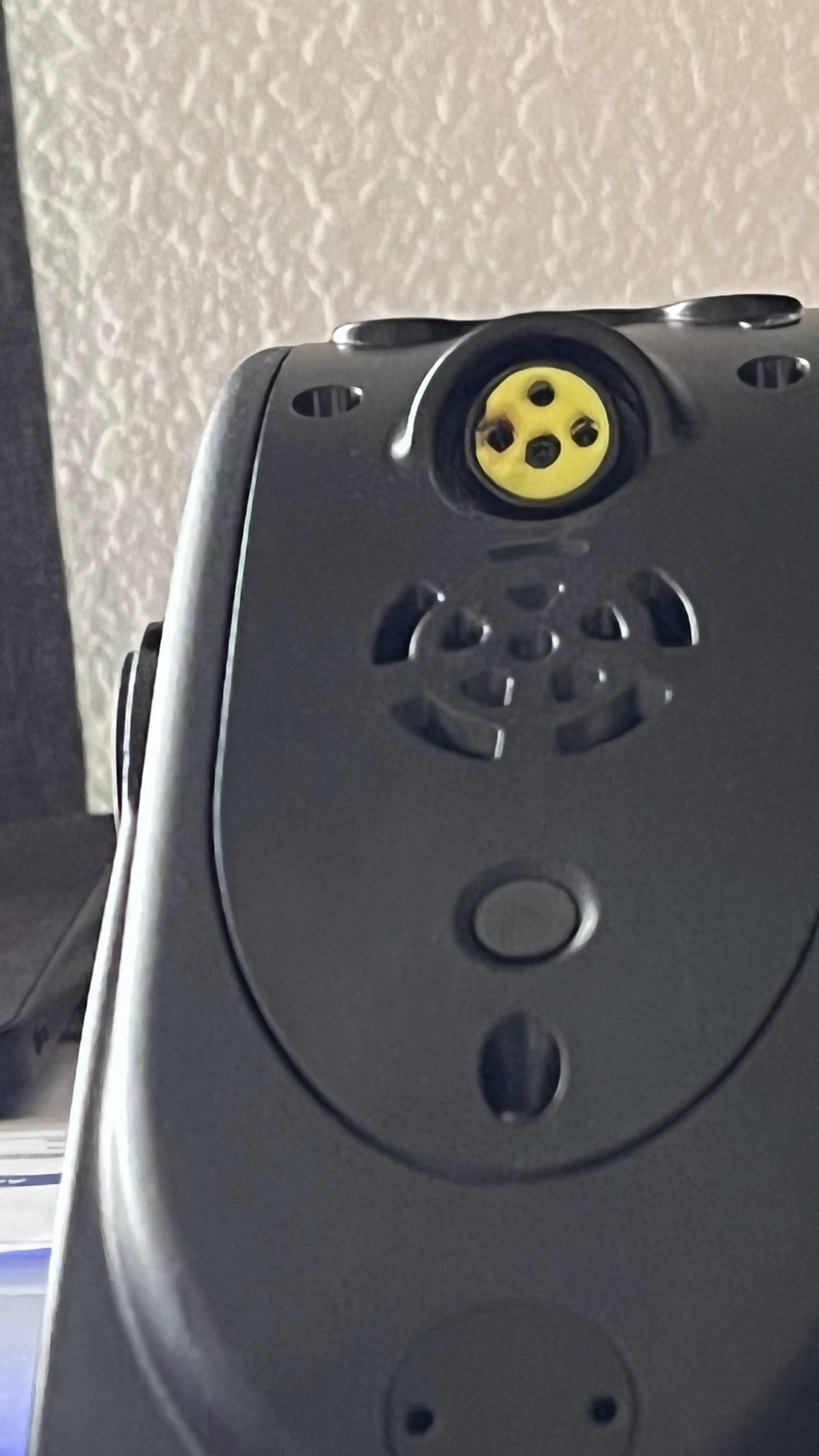

Here's a post with a photo:
https://www.wheelchairdriver.com/board/ ... 16#p134916
I think I ordered some cable, or possibly cut one from a broken charger, then soldered an XLR plug from ebay to it with the help of my partner. It was one of her first soldering jobs. I know it seems incredibly easy once you're experienced, but especially if you don't have a very good soldering iron, it can be difficult if you've never done it before. It actually stopped working because the soldering wasn't very secure and had to be resoldered. It has been fine for years now though it probably doesn't look very pretty inside.
The IP22 has some weird terminals with screws on top which cause metal plates to squeeze together. The bare ends of the XLR cable are twisted and folded over between the metal plates then tightened down with the screws. It has a little plastic cover which snaps over the fuse holder and the access to the screws.
Once someone picked it up by the XLR cable and one side slid out while I was on a trip. I was worried it was broken but we found it had been pulled out. Just had to twist the bare end of the cable again, loosen the screw, slide it in and tighten it down well again and it's been fine since. It's useful to have a multi-tool while traveling.
I've trained most people who help me to not pick things up by their cables but you never know what someone will do when they're in a rush.

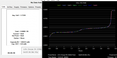

Postby jefferso » 04 Jul 2025, 19:10
I went on a 4 day trip via Eurostar train to the Netherlands and then Stena overnight ferry back to the UK. I used the BMS with Victron IP22 charger once overnight on the third night at 6 amps. I guess it put back about 40 Ah, which was good because a full charge after I returned put back about 120Ah, so without the BMS charge, it would probably have fully discharged the 160 Ah capacity of the pack.
40 Ah is an estimate based on the BMS software showing it was charging at about 5.75 amps (Victron charger set to power supply mode at 6 amps) for about 7 hours. I couldn't figure out if the BMS software shows the total Ah added to the pack anywhere.
It was so great to be able to go wherever we wanted without having to think about "can I sit next to a socket at the cafe and charge while we eat…" or "will it charge enough tonight for all of tomorrow?" I actually forgot about charging for the first two days. That never would have happened with the MK batteries. Charging used to be on my mind all the time.
Full charge on return:

Postby Burgerman » 04 Jul 2025, 20:52
Would the 230Ah (244 actual) cells have done the whole trip without charging? Presumably yes. Shame those didnt fit.
Recharge looks perfect. Those are Docan eve cells are they not?
It good regardless. When you consider that you only get around 35Ah if you run a set of GRP 24 lead batts until the thing stops... And return about 40.
So you returned roughly THREE complete charges for sets of grp 24 lead batteries! (120Ah) when you got home. Or 4 sets of batts overall if you include the single 40Ah charge.

Yes, 230 Ah would have easily done the whole trip without charging. I still wonder if there is a way to fit them…
Burgerman wrote:Recharge looks perfect. Those are Docan eve cells are they not?
Yes, Docan EVE 160Ah solar grade A cells.
Burgerman wrote:It good regardless. When you consider that you only get around 35Ah if you run a set of GRP 24 lead batts until the thing stops... And return about 40.
It would have impacted the experience of the trip to have to charge MK gels every night. And a late night with an early start might mean a not quite full charge, and I'd have to think about whether I'd use the vent on the back of my chair which uses the chair batteries, or my usual nighttime vent with its external batteries and think about how much charge is left in them, etc.

Since the cells are spot on, stay in perfect balance, you could actually charge without any BMS or anything at all, as long as you dont put back all the Ah. So if it gets above say 3.4V per cell, stop.
That would likely lighten the travel load, some.

Postby jefferso » 07 Jul 2025, 16:56
The extra load to bring the BMS shirley_hkg put together is pretty low (see circled in photo) so it's nice to have the option to do a full charge and monitor the cells' individual voltage.
But it's good to know if the BMS got lost/stolen/broken, or I had an unexpected trip, I could charge with an ordinary XLR charger as long as it doesn't go too high.
