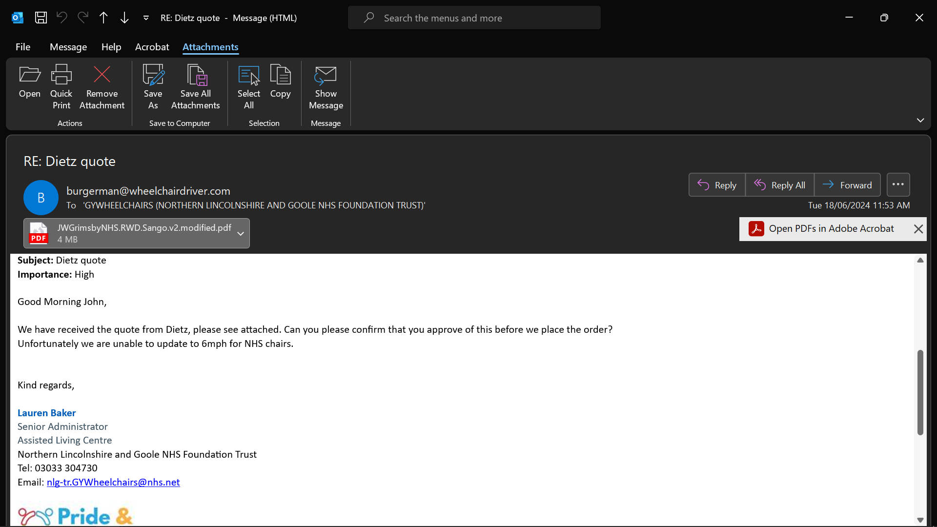

Postby Burgerman » 14 Jan 2025, 20:13

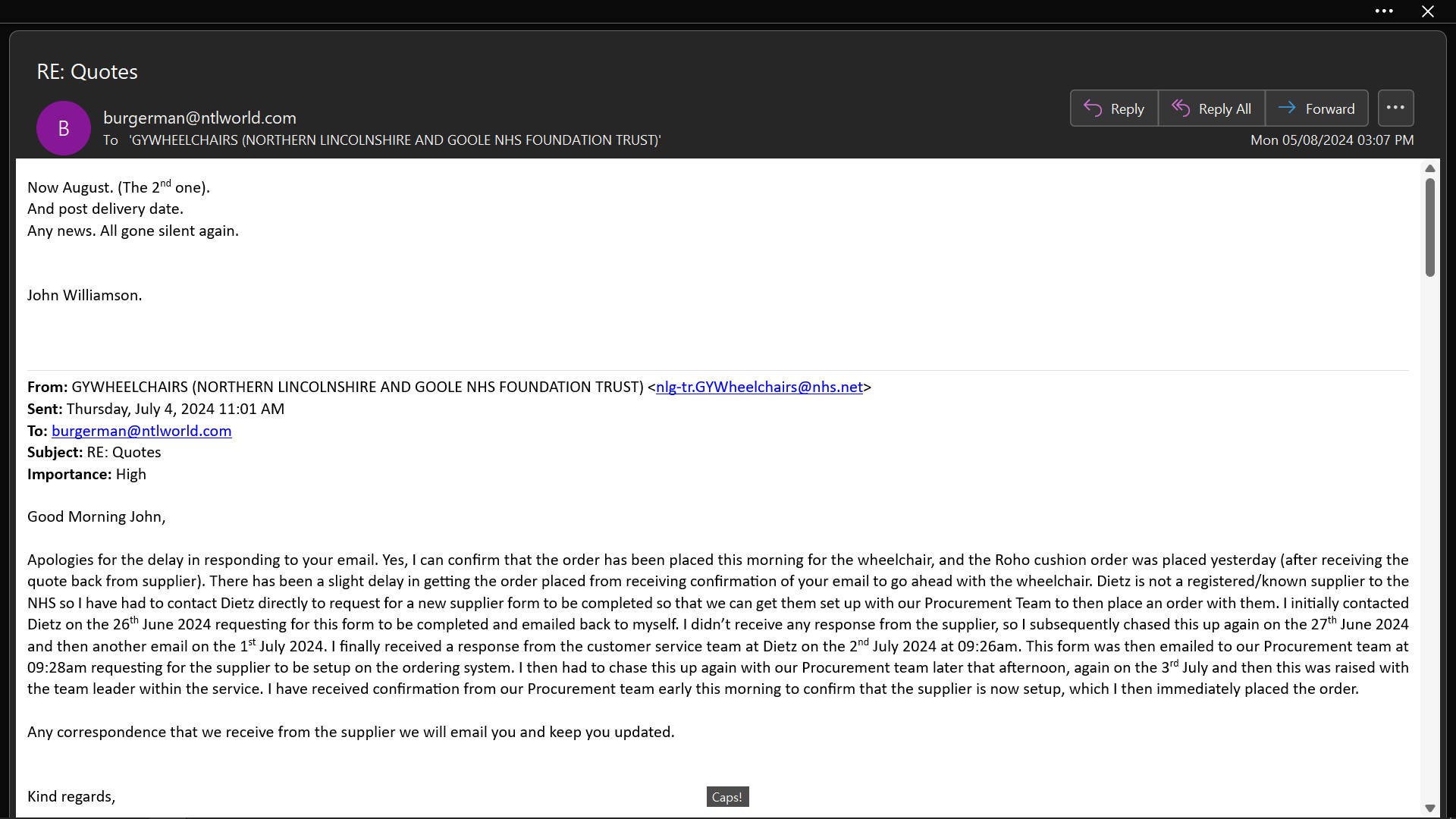

And the reason that they sent me the order form rather than atempting to do it themselves is this:
From: GYWHEELCHAIRS (NORTHERN LINCOLNSHIRE AND GOOLE NHS FOUNDATION TRUST)
Sent: Monday, June 3, 2024 10:04 AM
Subject: RE: Personal Wheelchair Budget
Good Morning John,
Please see document attached. Can you please confirm that you approve of the specification in the document attached so that Louise can then get the rep to generate a quote.
REPLY
The thing you attached is basically a TWO of lines of text. Its not an order form.
An Order form, or a prescription order form, looks like the one that I have attached ON THE REPLY as an example. I have ordered many chairs, and can accurately fill out a real order form and know exactly what I need/want.
In this case the example one I have attached its for sunrise Q 500 chair.
THAT is a proper order form.
If you want to get the order right, since you seem to have forgotten the two separate, 2 hour long sessions with you and the various company reps, (which was the entire point of them being there) with all the questions and detailed answers we already did. Complete with my own printed data sheet I handed you, then lets strt again and bring a proper order form around for the Dietz chair so that I can go through it in detail and fill it in correctly.
Or if you are going to attempt to make all these decisions yourselves, then it will be your problem when its incorrect.
They decided that it wasnt worth the argument... So once I revised the prescription order form, of which I have a copy if you need it they ordered it.
They WILL try and do this in the background, without having any idea what the hell all the options mean or work together to justify their existence. They really dont like me! But if you dont bully them, and force them to get off their asses literally nothing happens month after month. The consequence of a socialist NHS.
Posts: 71095

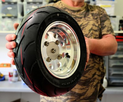

Postby shirley_hkg » 23 Jul 2025, 11:59
Which rim width to choose for 110-80 tyre ?
3.5" / 275" ?
They sell 110/80 with 2.75j rim below.
I think they are right, especially when we deliberately inflate it low pressure for comfort .
Posts: 4656

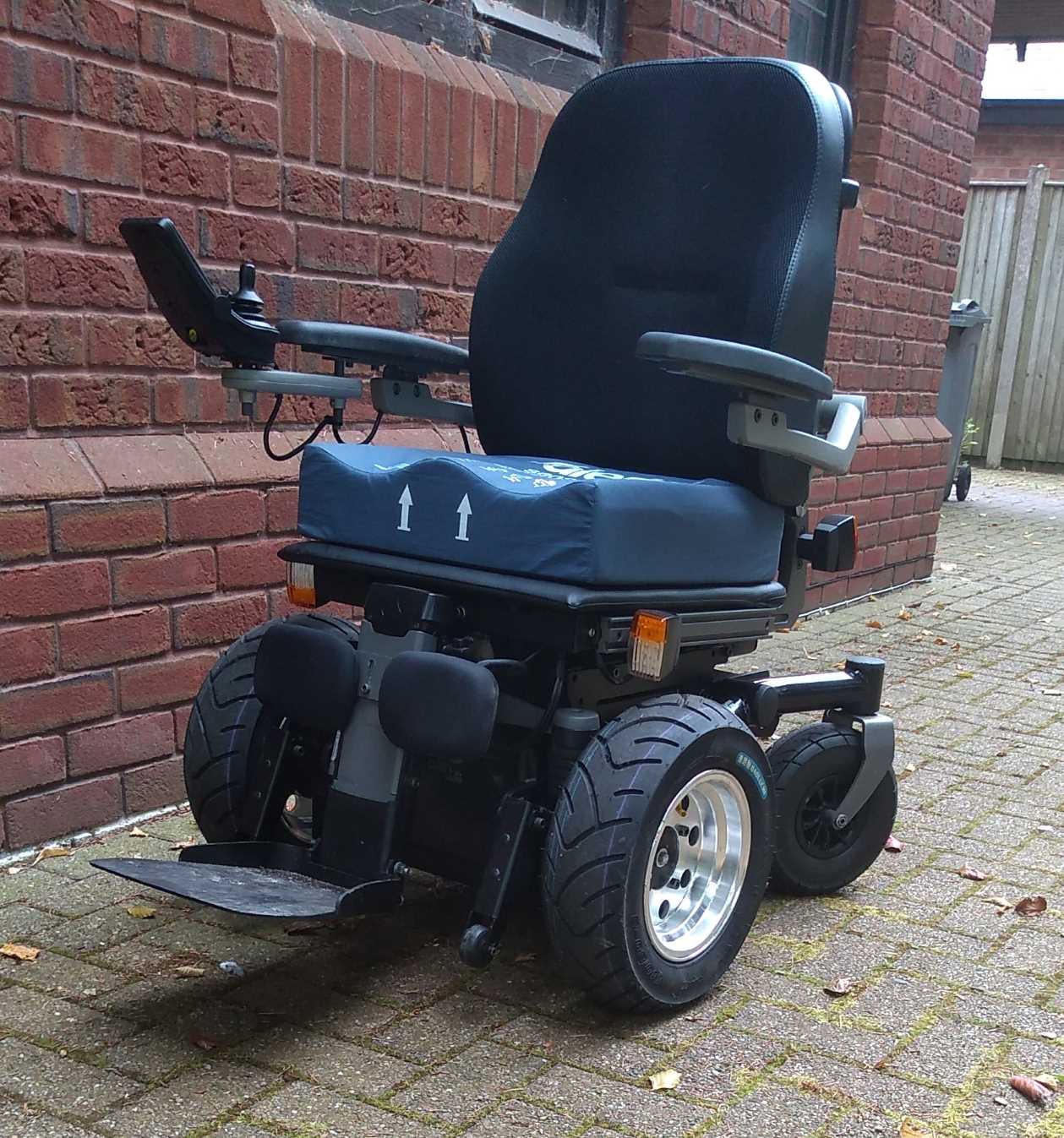

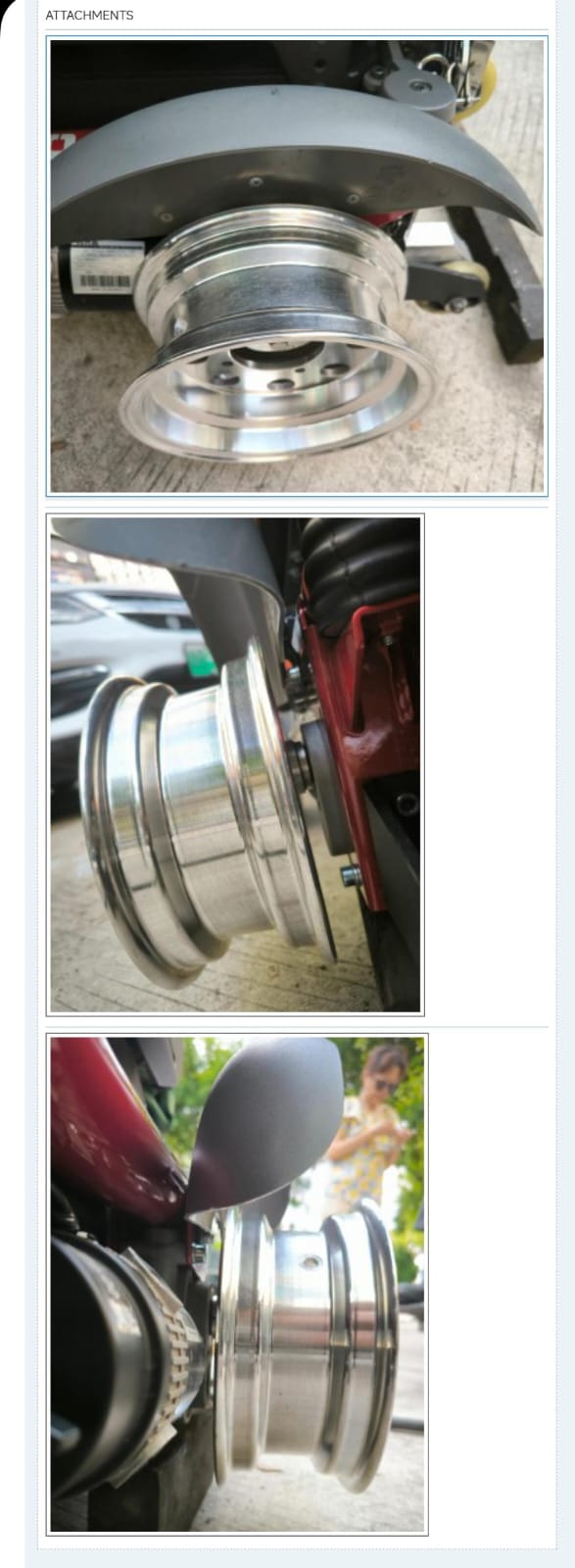

Postby shirley_hkg » 30 Aug 2025, 13:25
110/80-8 tubeless on a Dietz finally.
Posts: 4656

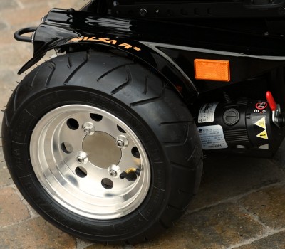

Postby Kande_ian » 30 Aug 2025, 15:39
Very happy with Shirley's adapters and the wheels :D - this week will hopefully see a "downgrade" from teeth rattling solid castor tyres to tubed. T/L would be nice if anyone can recommend suitable hubs - I nearly lost the will to live searching for some and decided we might as well try tubes first.
Failed to add a small mp4 of the happy owner getting some fresh air and feeling useful as the autumn leaf fall arrives early, so here are a few stills instead. I can't understand why a drawbar isn't a standard fitment.

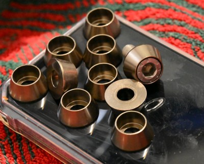

Postby Burgerman » 12 Oct 2025, 07:54
It, she, the rims, tyres all looking good! But no centrecaps!
Is it a WCS chair?
Measure diameter
deduct 1 mm.
Order 2 stainless steel disks cut from 1.5 or 2mm thick (measure I dont remember!). laser cut - many places online.
Drill 8mm hole in centre or order them cut this way...
Use the load spreading washers (M8 and M8 Stainless allen bolts) to hold these and rims on, ebay etc. 5 per wheel.
Heres some - as yet unpolished disks - as they arrived.
And the Salsa chair doesent need a centre bolt. So no need to drill a hole...

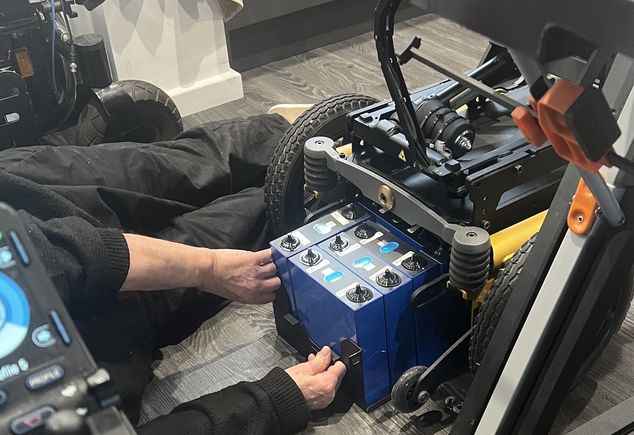

Postby sparkerted » 12 Feb 2026, 00:25
Not sure if anybody has done the lifepo4 install to the Dietz Sango Advance RWD, but we have just done a dry run with 8 Amy 230A cells and they will go in, we believe with a clearance of 10mm without trimming the stud.
