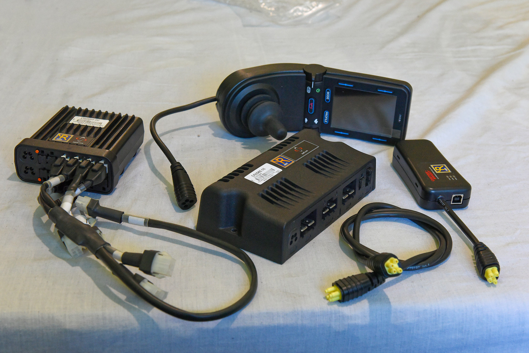

Postby Burgerman » 10 Oct 2025, 23:10
You literally swap 3 things
These three things...
This is a FULL rehab chair system. Everything. For a chair with up to 6 seating actuators, and any DC motors/brakes.
Shows the:
JOYSTICK and its cable...
120A POWER MODULE
SEATING ACTUATOR for 6 seating functions and lights. And a loom.
(The 4th thing is the R-Net programmer dongle.)
Theres £125 joystick (new)
£45 power module (as new)
£45 seating module (as new)
OEM Programmer was £350 delivered many years back!
I have 5 power modules, 4 seating actuators, 3 CJSM2 joysticks, 2 CJSM1 joytics, 2 LED joysticks... And a box of cables! All bought for silly low prices.
THIS is everything needed for a high end rehab chair.
