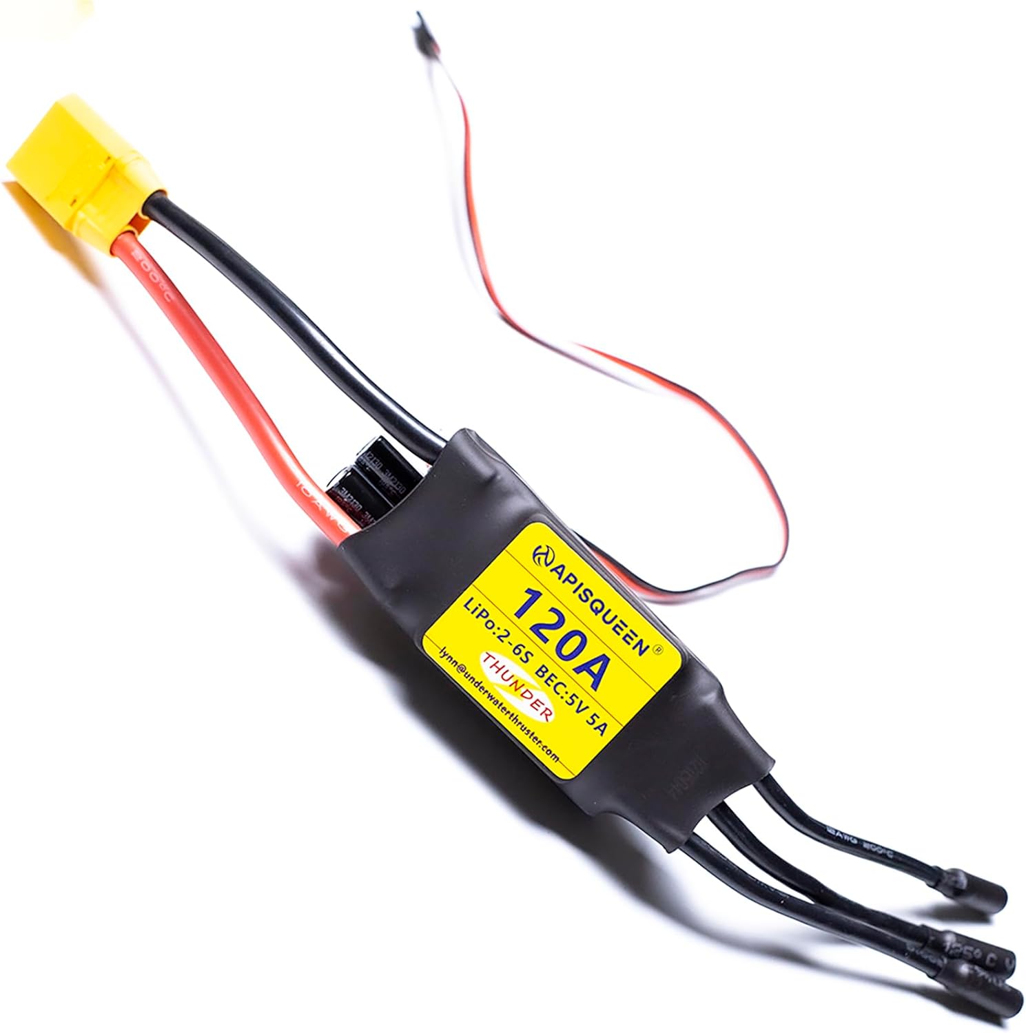

Did the same on a RC plane speed controller in my bedroom. Usually used 6S lipo packs and wanted to test something. Saw a LiPo on the banch, grabbed it plugged it in. It was a 10S heli pack. The speed controller capacitors literally exploded off the board. Very loud. Scared the crap out of me. When I looked closel it was a 2 to 6S speed controller and it really didnt like 42 volts.
