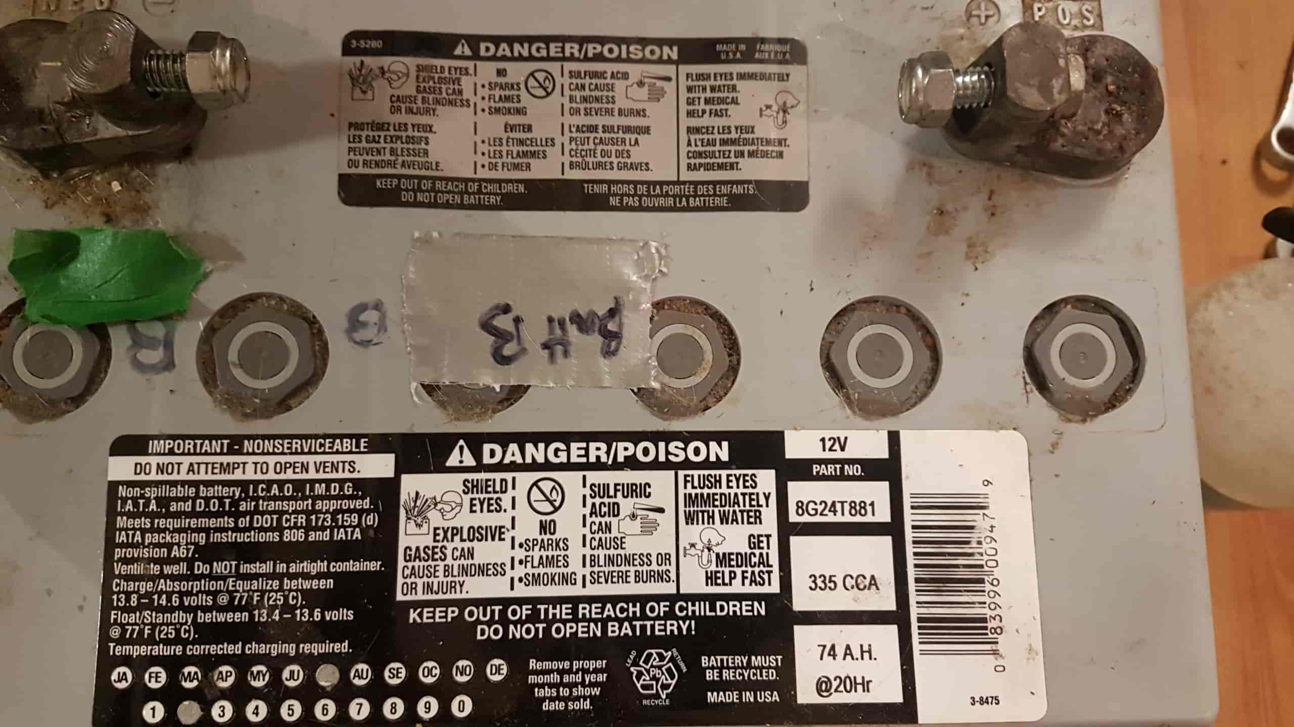

It has Mk batteries that came with it . The joystick horn works but batteries are probably empty since it does not move. They might have some life left enought for me to roadtest the chair without having to transfer my current batteries so I would give them a try. I have couple questions about the battery setup.
8g24t881 written on the batterie . googles leads me to a page where it is written MK Powered 12 Volt 73.6 AH Deep Cycle Sealed Gel Battery 8G24T881
1)Is there a way to confirm they are real gel and not agmgel?
2) I have a victon ip65 bleu smart charger set to gel already. Is it worth it to charge them individually( for the first time since probably 4 months or more )OR charging both at the same time is ok? how many hours?

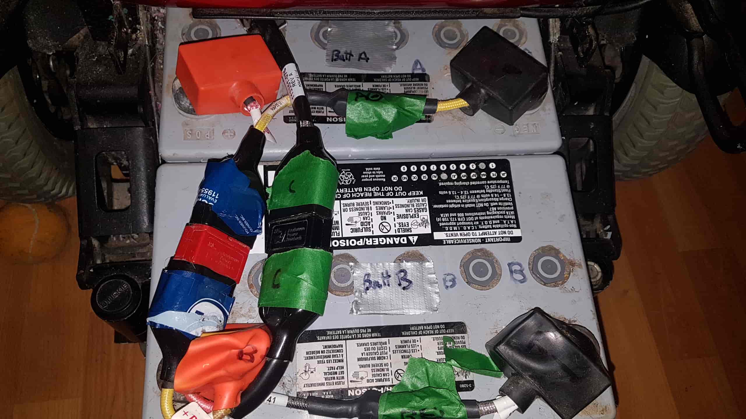

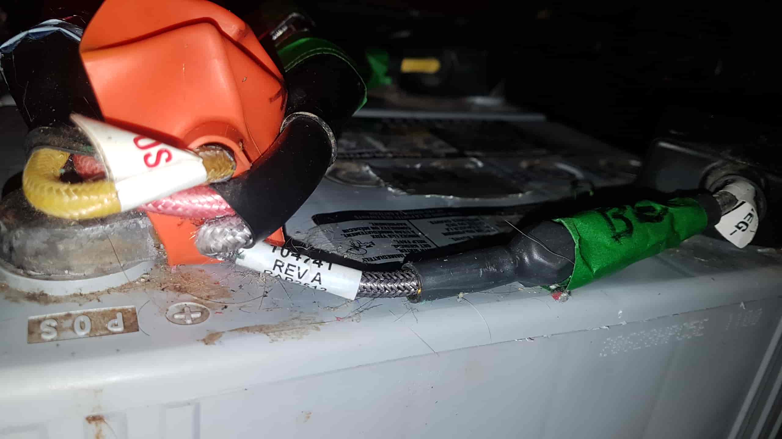

3) I marked where the terminals are going to be sure to reconnect them the same way but I wanted to show you the way they arrived . It is different from what I have seen so far (the place the connectors go and there are 5 cables not 4 ). I would like to know if it is a safe way what the previous user did. Because I could always use the anderson connectors from another chair if it is advised to avoid using this 5 wires pattern of linking the batteries together.
Yes. I can absolutely garantee that those batteries are gel.
I have no idea where your 5 wires go...
All that matters is that you connect 2 batteries in SERIES for 24V and that this 24V goes to the chair...
