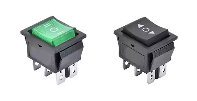

Theres many types of switches.

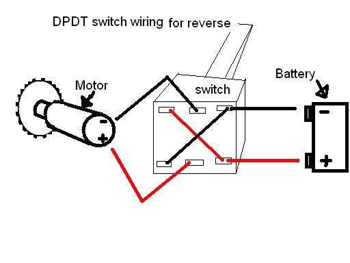

Those shown are 3 POSITION MOMENTARY. Meaning they return to the centre on their own. They are also double pole too. Each one can control an actuator up/down with no electronics at all. Or 2 or 3 actuators at once.
So a box with 4 tiny switches in it, DIY or a reused CTRL5 box, can already do Tilt, Lift, Recline, Power foortrest. And the 5th one cold do maybe a combination of tilt/recline/legs.
To do that you need one 10 core cable to your switches. And a soldering iron.
So a box with 5 tiny switches in it, DIY or a reused CTRL5 box, can already do Tilt, Lift, Recline, Power foortrest. And a 5th one cold do maybe a combination of tilt/recline/legs.

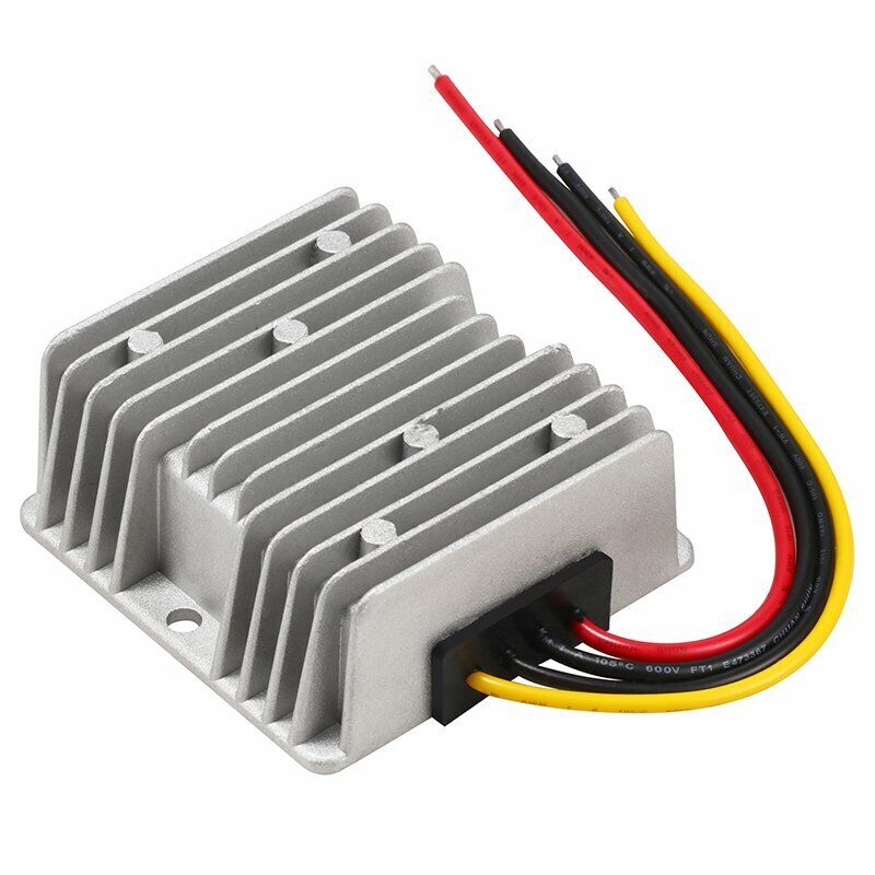

48V in. 24 or 12V 10A supply, depending on what you need out. You need one anyway for roboteq for brakes etc. So will already have 12 or 24V to connect up to.
