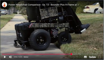

It's a good idea the user being able to temporarily switch off the annoying clicking brake
Looks like your van BM.
youtu.be/UKD5pO47b-A
Posts: 2948
Postby Burgerman » 26 Oct 2025, 18:54
Thats a newer version than mine.

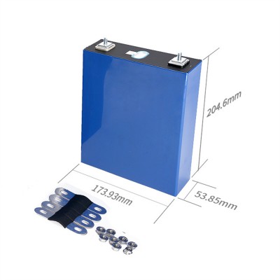

To fit a grp 24 box it must be 54mm thick max.

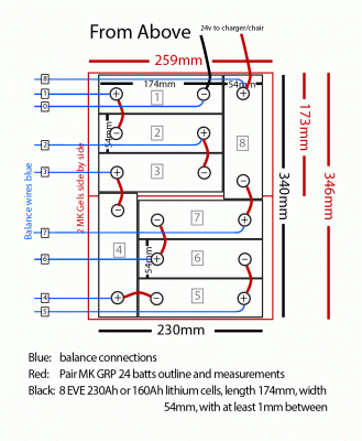

Take a look here:
A GRP 24 is 210mm inc terminals tall maximum (190 in practice).
And 168mm wide. And 260mm long.
And usually fitted side by side.
Giving this as the only possible arangement that will fit a 160 or 230Ah (244Ah) cells x 8.
There isnt another arangement that fits.
