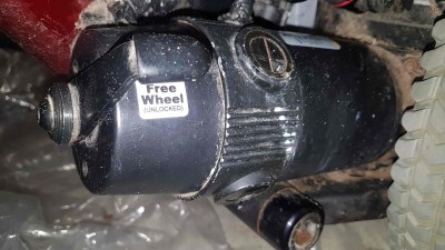

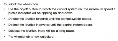

Postby yeshelp » 20 Nov 2025, 23:27
Thanks Burgerman,
the trick forward backward worked! I guess when disconnected for a days the joystick goes in lock mode because juste unplug and replug 5 min did not lock it.
I made the road test outside and it works well , just has a small pull to the left when trying to go straith but I can live with that, I tell it to share the info .
I made 2 small videos indoor with wheel in the air to show the sound it makes.
The right motor make a louder noise . It is the video where there is a yellow- black tool on the floor. https://imgur.com/EAaUbDh
The left motor does less noise but seems to do 2 types of noise. https://imgur.com/w87IPsX
can you hear the sound well?
Ideas about what it means ? maybe the noise indicates brushes to change or else?
I dont aim at having a chair in perfect condition. It has some mileage on it but not a lot of rust. I just want it to be safe and do what I can to prolong its life. I Imagine that the motors are the priorities. Not knowing its past I guess It is better to open the brushes right?

Postby Burgerman » Yesterday, 17:25
Your camera is the wrong way around...
The motors sound like a set of typical motors. The first link sounds a bit worse and the rim doesent run straight.
The ONLY way to find out what is going on would be to completely disassemble them, and examine all the parts, and replace all wear components. And throw away any parts that are worn.
Since only bearings and brushes are actually available then the question is why do it? I might, because I like to know. And to me its not difficult.
IF I did, I would strip and clean all parts. Check wear on commutator, armature electrical continuity and resistance (all sets should be the same and not open or low resistance) magnetic flux strength (not simple, you would need a set of new ones to compare) check brush housings and balance of armature. Check for gear backlash, etc. Examine and clean all brake parts. Or replace. Then replace motor and gearbox bearings, rubber cush drive coupling, brushes, and repack gearbox with grease. Also examine woodruff key and output shaft for wear or fretting. Repaint parts, reassemble with new bolts.
If any parts are not servicable, worn, and unavailable, bin. Replace with new motors. Thats normally the best option.

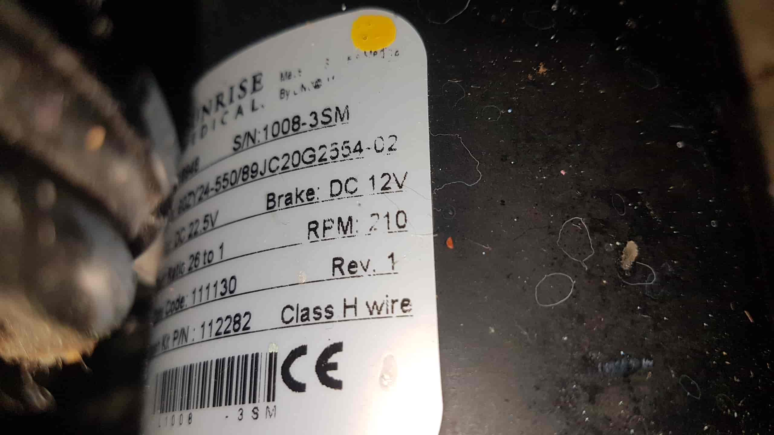

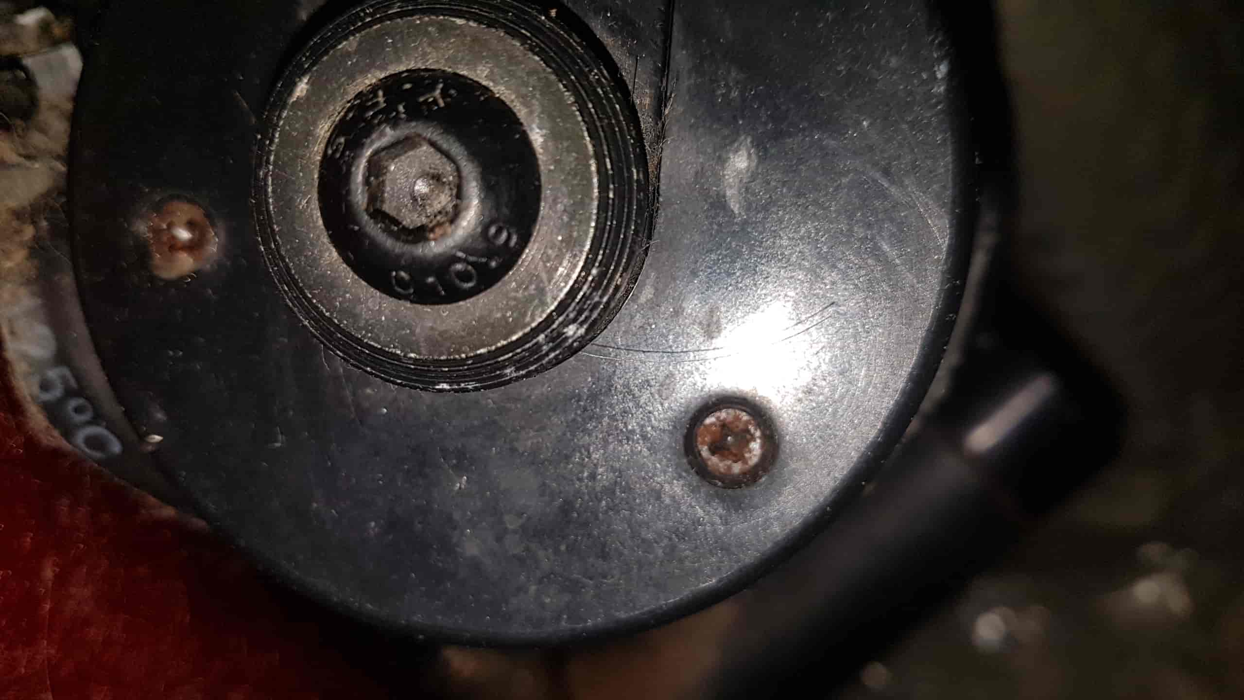

Postby yeshelp » Yesterday, 18:37
Hi
when you say the camera is the wrong way around , what do you mean?
I dont think I can do all the things that you would do about the motor. Verifying the brushes and changing them if needed seems to be accessible and to be done from times to times anyway. I took a old brocken motor and was able to remove one brush so Im confident I could do it. I have seen a video of someone removing the cap of a wheelchair motor to look at the armature the brushes touch. His where black, I plan to order a fiberglass to clean mine if need be.
When trying to buy new brushes from sunrise , they tell me it would be 150 dol for 4 of them which i feel is absurd. As you say there are probably brushes available that fit that i can order at lower price. I asked the sunrise guy while I had him on the phone what was the sizes of the 3 screws that hold the front cap of the motor since they are not showned in the manual and he said that he has no info on them. I am not 100 pourcent sure that i should try to remove them. Do you think once out it is possible to identify them to replace them with stainless ones or at least with new ones? If I could order them in advance i would like that.
I am a bit wary of stripping those 3 screws that hold the front cap. Would adding some anti rust penetrant before help or i should avoid puting that on since it could make the screws's x more slippery for the x screwdriver head hence more chances of stripping?

Postby Raro » Yesterday, 20:00
If I were you, I wouldn't touch anything. From what I've seen in the photo, they're four-pole motors; you'll only be able to remove the two outer brushes without removing the motor. I would just grease everything as much as possible to prevent corrosion.

Postby yeshelp » Yesterday, 21:03
Yes they are 4 pole motors.
They don't have the ball and levers at the top for the freewheel on the gear box so they should be easier to remove either by removing just the top nuts of the motor or by removing the bracket which I now have the tool for (and successfully loosened 3 out of 4 bracketbig bolts from 2 very rusty chairs. I dont think it would be a big issue to remove the motors.
Aren't the noise of the 2 motors a concern to ear? It does not sound normal . Between openning all the motor parts and doing nothing wouldn't it be wise to at least look at the brushes and change them if need be? I already created a tool out of a sacrificial knife with a angle grinder to fit the plastic cover of brushes all their lenght. Maybe the noise comes from brushes only.
I have no clue if the brushes are end of life or not. From what i remember checking the motor brush is kind of the most important thing to do yearly and it migt have been a while that they have not been changed. Apparently that could cause more serious problem to roll with brushes that need to be changed.

Re: received new used 646se with a pair of batteries inside
Postby yeshelp » Today, 01:02
And all the top of motor bolts easily loosened at first try without lubricant.
8mph linix motor as used on the Jive chair, same as yours.
Part 112281 Motor brush kit for 4 - pole motor 4 pcs./pack £ 6.00
So £12 total. Plus delivery. Sunparts website.
Again you are showing that you have no experience.
First of all those are not available to buy seperately, they come as part of a complete motor/brake assembly. So a dumb parts guy wont have a clue.
I can tell you without looking that they will be common metric threads. So can only ever be M3 or M4 in that situation.
I would take one out. Use my micrometer to see thread diameter (3 or 4 mm) then measure bolt length, and order a box of STAINLESS bolts that size as a box is usually not much more than ordering say 8 or 10. And would use cap screws, (thats allen bolts to the man in the street!). And GREASE!
You cant. Remove, measure, throw away old ones. Order replacements.
Spray with WD 40, leave it a day.
Use a CORRECT SIZED and CORRECT TYPE of screwdriver, (probably posidrive no2?) and hold it and use it correctly. The THREAD will snap before the X in the head slips. If that doesent happen then read this sentence again!!!
Before you snap the thread, stop! Use the max safe force only. We are back to experience again. Stop looking for sprays on Amazon...
What is the point of removing that cover?
You first ned to remove the MOTOR. Then strip everything completely. If you cant do that then leave it alone before you cause yourself a lot more problems.
