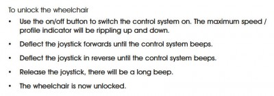

3 things:
1. CHECK VOLTAGE while it is turned on.
2. CHECK FREEWHEEL LEVERS are both fully off/in gear/brake on.
3. AND:
Posts: 70280
Re: received new used 646se with a pair of batteries inside

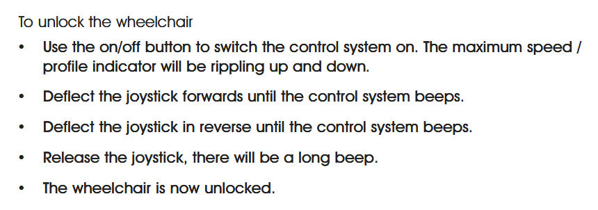

Postby yeshelp » 20 Nov 2025, 23:27
Thanks Burgerman,
the trick forward backward worked! I guess when disconnected for a days the joystick goes in lock mode because juste unplug and replug 5 min did not lock it.

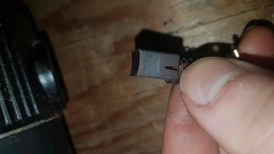

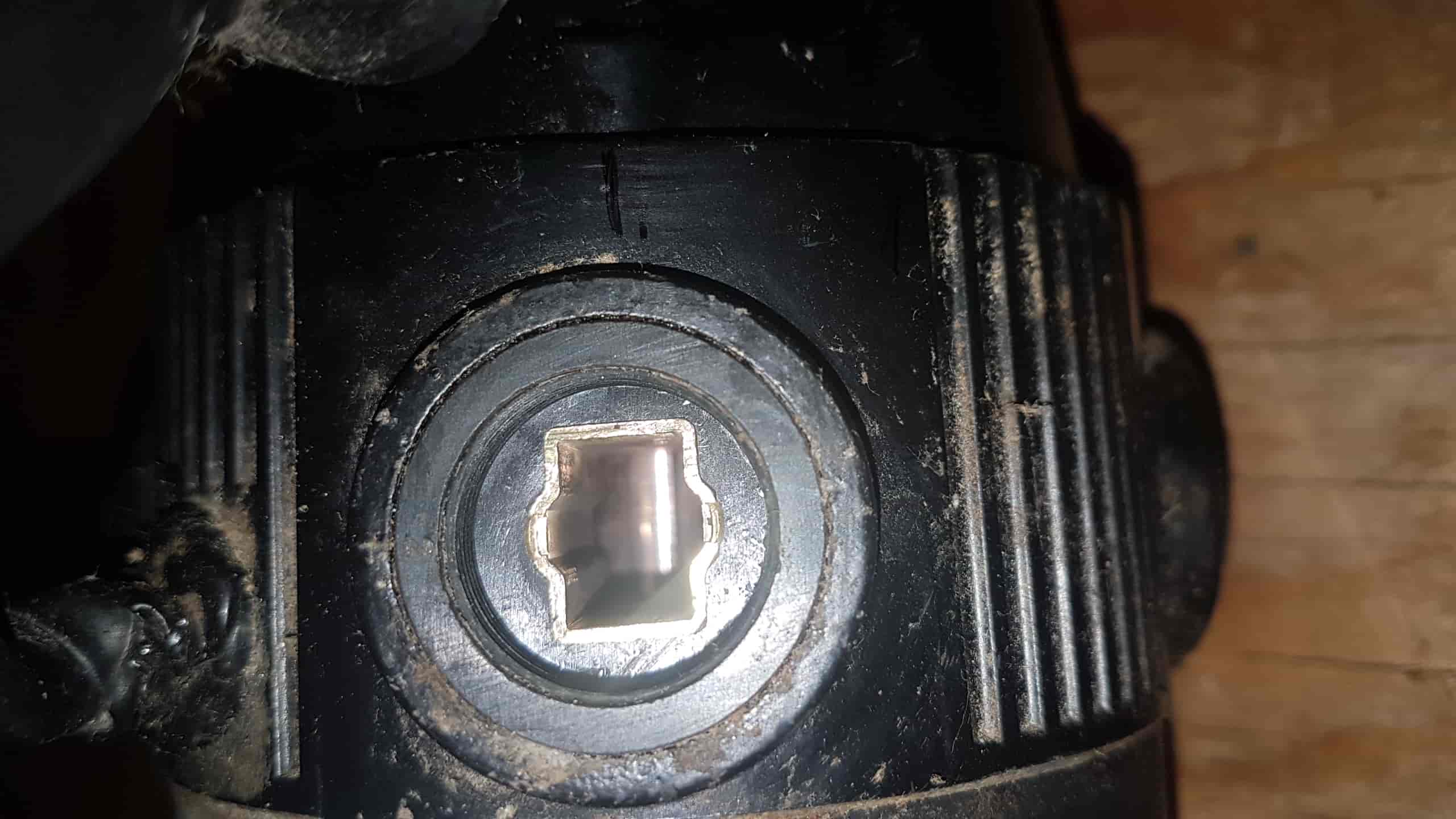

The motors sound like a set of typical motors. The first link sounds a bit worse and the rim doesent run straight.
The ONLY way to find out what is going on would be to completely disassemble them, and examine all the parts, and replace all wear components. And throw away any parts that are worn.
Since only bearings and brushes are actually available then the question is why do it? I might, because I like to know. And to me its not difficult.
IF I did, I would strip and clean all parts. Check wear on commutator, armature electrical continuity and resistance (all sets should be the same and not open or low resistance) magnetic flux strength (not simple, you would need a set of new ones to compare) check brush housings and balance of armature. Check for gear backlash, etc. Examine and clean all brake parts. Or replace. Then replace motor and gearbox bearings, rubber cush drive coupling, brushes, and repack gearbox with grease. Also examine woodruff key and output shaft for wear or fretting. Repaint parts, reassemble with new bolts.
If any parts are not servicable, worn, and unavailable, bin. Replace with new motors. Thats normally the best option.

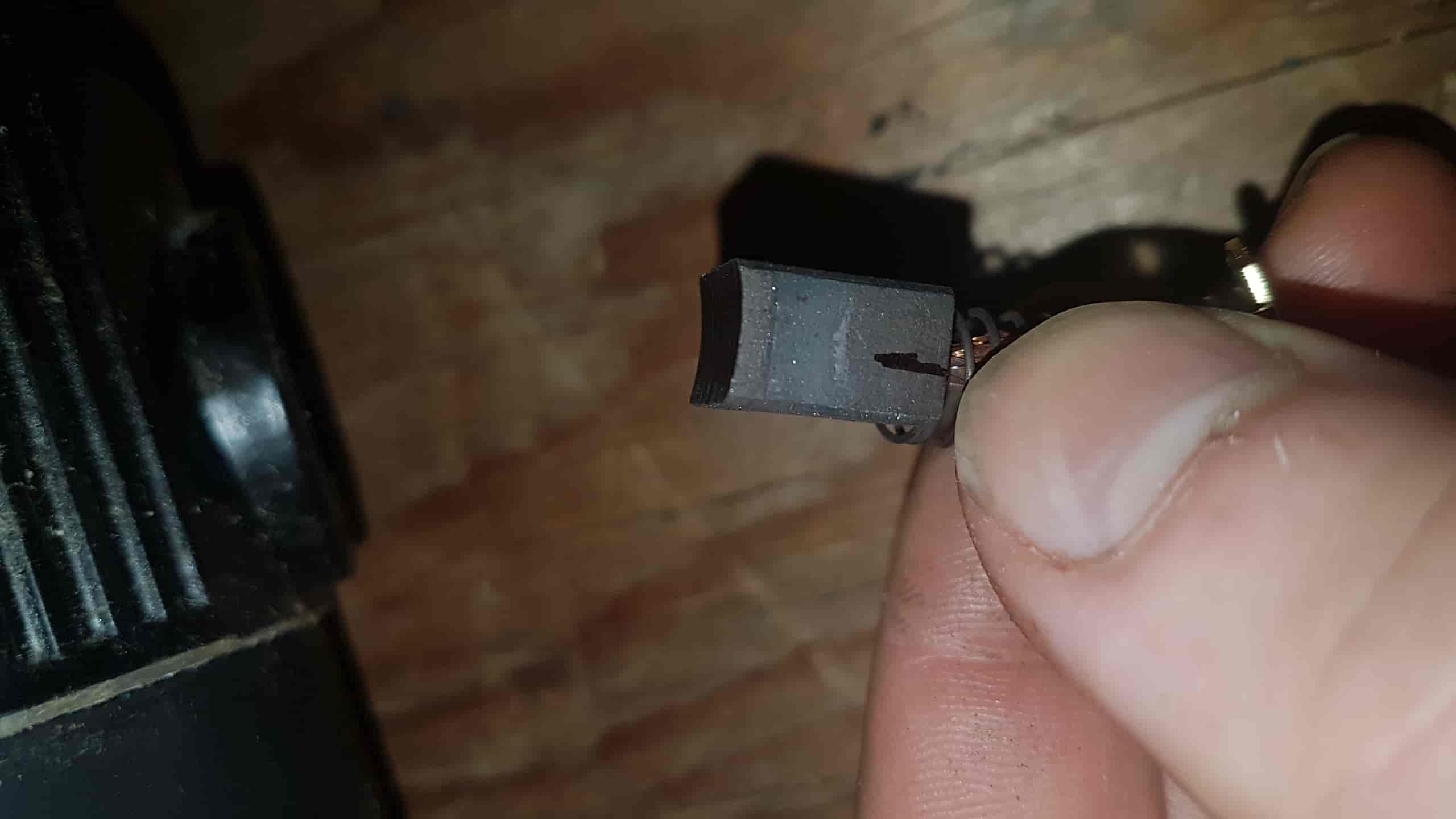

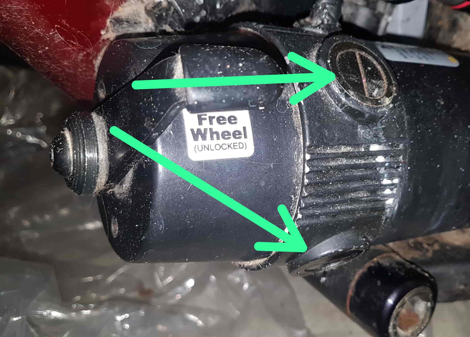

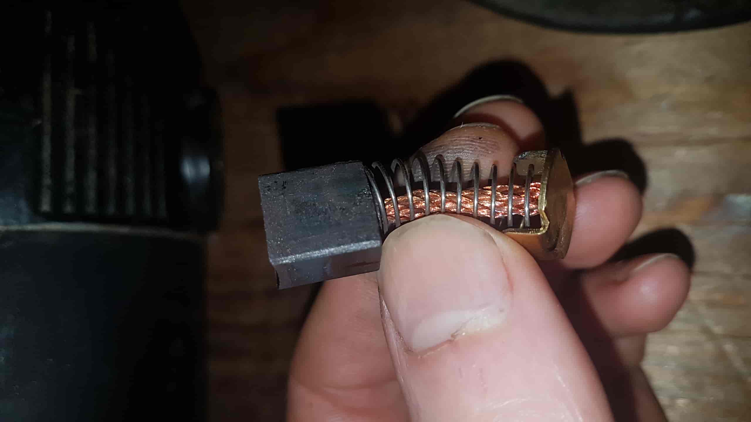

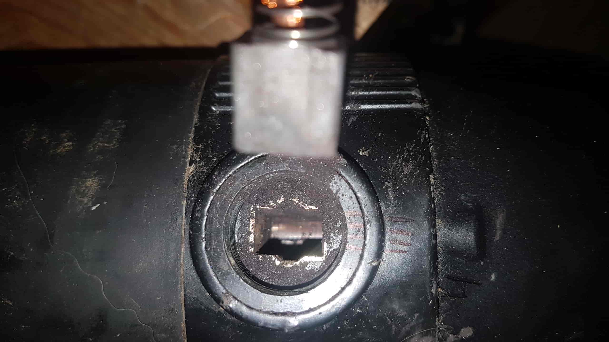

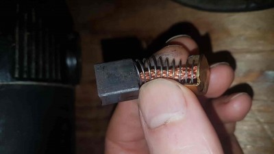

I dont think I can do all the things that you would do about the motor. Verifying the brushes and changing them if needed seems to be accessible and to be done from times to times anyway. I took a old brocken motor and was able to remove one brush so Im confident I could do it. I have seen a video of someone removing the cap of a wheelchair motor to look at the armature the brushes touch. His where black, I plan to order a fiberglass to clean mine if need be.
When trying to buy new brushes from sunrise , they tell me it would be 150 dol for 4 of them which i feel is absurd. As you say there are probably brushes available that fit that i can order at lower price. I asked the sunrise guy while I had him on the phone what was the sizes of the 3 screws that hold the front cap of the motor since they are not showned in the manual and he said that he has no info on them. I am not 100 pourcent sure that i should try to remove them. Do you think once out it is possible to identify them to replace them with stainless ones or at least with new ones? If I could order them in advance i would like that.
I am a bit wary of stripping those 3 screws that hold the front cap. Would adding some anti rust penetrant before help or i should avoid puting that on since it could make the screws's x more slippery for the x screwdriver head hence more chances of stripping?

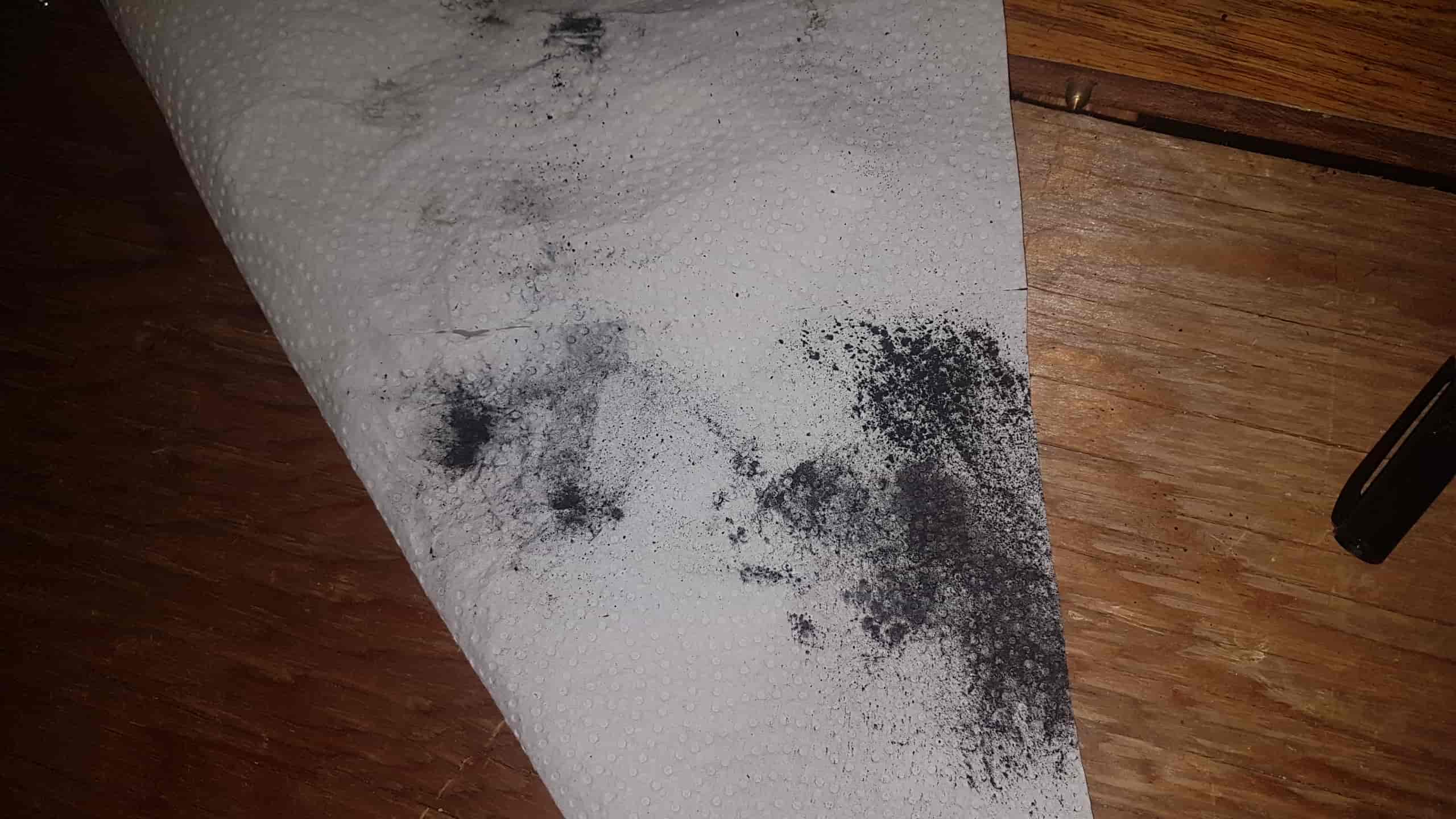

If I were you, I wouldn't touch anything. From what I've seen in the photo, they're four-pole motors; you'll only be able to remove the two outer brushes without removing the motor. I would just grease everything as much as possible to prevent corrosion.

Yes they are 4 pole motors.
They don't have the ball and levers at the top for the freewheel on the gear box so they should be easier to remove either by removing just the top nuts of the motor or by removing the bracket which I now have the tool for (and successfully loosened 3 out of 4 bracketbig bolts from 2 very rusty chairs. I dont think it would be a big issue to remove the motors.
Aren't the noise of the 2 motors a concern to ear? It does not sound normal . Between openning all the motor parts and doing nothing wouldn't it be wise to at least look at the brushes and change them if need be? I already created a tool out of a sacrificial knife with a angle grinder to fit the plastic cover of brushes all their lenght. Maybe the noise comes from brushes only.
I have no clue if the brushes are end of life or not. From what i remember checking the motor brush is kind of the most important thing to do yearly and it migt have been a while that they have not been changed. Apparently that could cause more serious problem to roll with brushes that need to be changed.

And all the top of motor bolts easily loosened at first try without lubricant.

How do you know the chair is locked, notfaulty parts ?
Posts: 4542
Postby Raro » 22 Nov 2025, 12:28
What I mean is that the chair works fine; I wouldn't touch it. I'd focus on keeping it as clean and lubricated as possible. By the time it needs brush replacement, the motor will probably need to be replaced entirely. If you still want to check something, remove any accessible brushes, blow or vacuum the carbon dust off, and then simply put them back in the same position you removed them from.

Brushes are here, NOT at the back.
Posts: 4542
Postby Raro » 23 Nov 2025, 13:11
Those two, yes, but what about the other two?

Postby Burgerman » 23 Nov 2025, 13:15
4 equally spaced around the perimeter every 90 degrees...
On a 2 pole, theres just 2 and those are at 180 degrees spacing.

Postby yeshelp » Yesterday, 01:05
Hi
I took the left motor out without complication.
I have been able to remove 3 brushes out easily. They look all 1.1 cm long approx and all have a small circular form at the end and everything is symetrical. I can see the metal of the armature at the end that is shinny.I did not turn the armature since I dont know if it is necessary or possible with just 3 hole acces. Writing this i wonder if putting the motor in freewheel and turning the axle would have the armature turn.?
There was a bit of black powder in one of the brush hole see picture.
There is one brush I could not take out. The metal part of it comes out pushed by the spring but it is like if there is something in the way of the brush that blocks it from coming out. I could have pulled harder but that risks of breaking the copper wire attachement to the outer metal part. I took a needle and was able to push the brush a bit(1 or 2 mm) toward the armature in all 4 corners. So it moves but does not want to come out . Is there a trick to take it out?
On the paper towel is most of the black powder that came out all holes combined.
In the replies of this post someone suggest to blow air to remove the black powder. I have a air blower.
Since there is no obvious escape for the black powder i wonder if I have to blow air in the holes or maybe the air blowing is to be made only if we remove the front cap of the motor or other parts. Idont know .

other pictures

Postby Burgerman » Yesterday, 10:01
Hi
Yes turn the motor. Look with a light/torch. Look at all of it to make sure no damage.
It should come out the same way as the rest. If its not damaged, or the holder melted or something.
You need that one out. That may be the only one thats a problem. ALL of them look pretty worn. Look also for soot, burning, and any chips missing near the ends. That curve has "worn in" to fit the copper commutator that it runs against. They wear in together so if you replace them make sure you fit them the same way around.
The dust comes out of the other 3 holes. TURN the motor as you blast air in. The dust can be in the whole motor can. It takes a while. Do all 4 holes...
If it was me I would replace all of those with new. As long as the rest of the motor looks healthy and no gearbox backlash or noise.
Clean all the dirt and dust out of the rectangular part that the brushes fit into with a small stiff nylon brush to be sure the brushes move freely.
