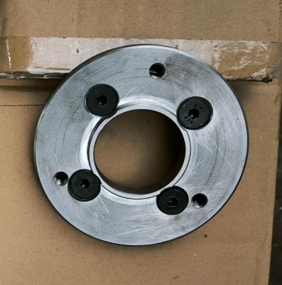

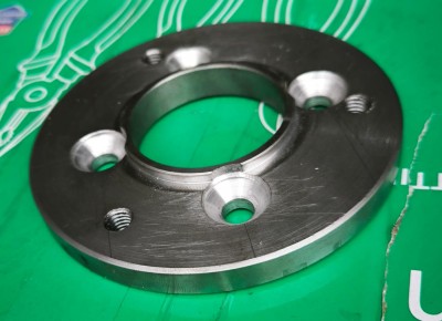

Shirley,
I wouldn't bother with bolts to attach the disc to the wheel, just the bolts through disc and wheel and into the motor flange. Clamping force should keep the whole assembly together, but if you want some extra protection you can use some epoxy between the outer disc and the wheel so that "buttons" of epoxy fill the outer set of holes in the wheel. If really fussy you can use scotch brite to remove Al oxide before smearing on the epoxy.
Posts: 5794
Re: 13x5 rims for Bounder
Postby shirley_hkg » 26 Nov 2025, 02:48
Understood.

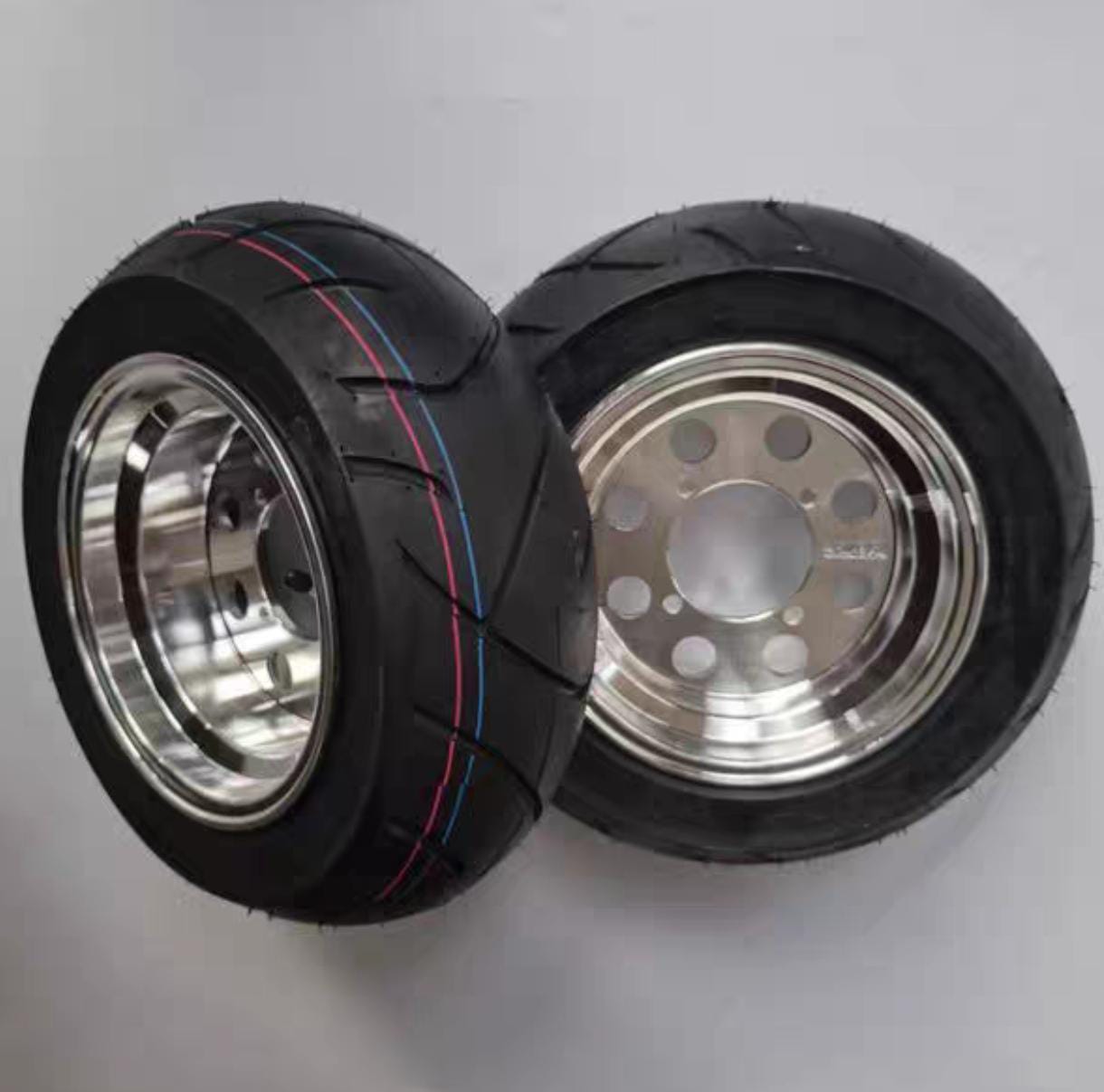

Postby shirley_hkg » 26 Nov 2025, 03:36
Tyre and rims are £30 per set here.
Postby shirley_hkg » 26 Nov 2025, 10:08
I might have been in the wrong way.
He wants knobby tyres for rough terrain. All those aggressive tyres are to fit
6" wheels.
Postby Burgerman » 26 Nov 2025, 17:11

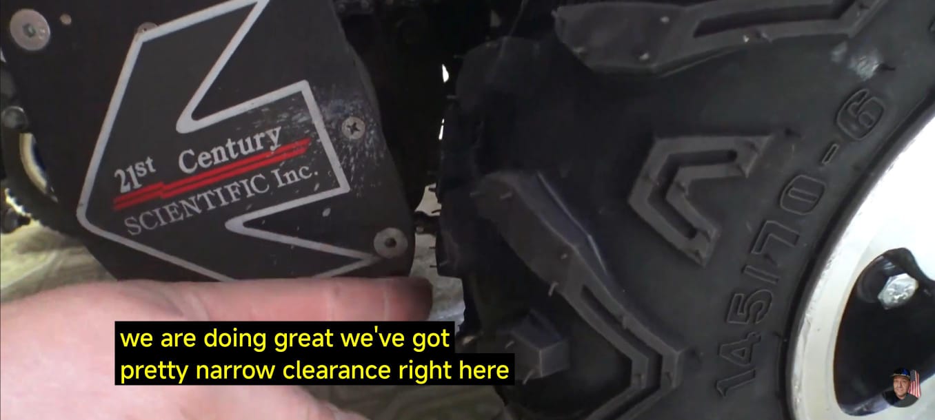

What he is worried about is that bounders use pretty small 13 inch rear wheels.
But most of the tyres we all fit tend to be 14.5 to 15 inches. But the difference isnt great because while a 13 inch wheel is 2 inches smaller than a 15 thats only a ride height difference of a single inch. Which is barely noticable.

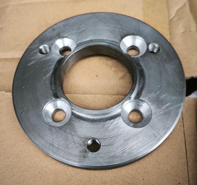

Postby fishinjunky » 26 Nov 2025, 17:26

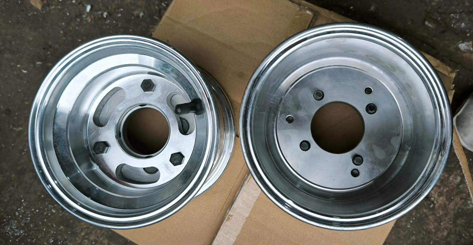

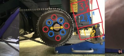

Brilliant. A disk on the outside.
Flat head bolts to secure the outer disk and wheel first.
Another set of holes on the disk 4 ∅5/16 THRU PCD ∅2.75" to match the drive hub.
Centre hole matches the hub to share load too.
Do you have a picture example of the disk? I'm thinking about doing this to my Bounder. And where online could I get the holes cut in the disk. Or could you find the disk an have it modified there and be shipped with the rims?
Postby shirley_hkg » 27 Nov 2025, 02:58
Burgerman wrote:What he is worried about is that bounders use pretty small 13 inch rear wheels..
It says 145/70-6.
So we should be getting 6" rims, instead of 8.
Like the one belows.
Postby shirley_hkg » 27 Nov 2025, 07:29
Would anyone reassure the measurements are correct please ?
Gonna get a rims and fabricate a adaptor disk .
