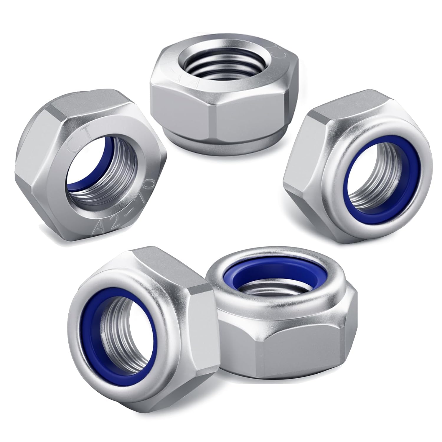

When assembling everything together what does everyone use for the nuts on the batteries? The nuts that are provided, nylon locking nuts, or regular nuts with lock washers?
wchl25
Posts: 99
Joined: 01 Jul 2020, 22:53
Postby Burgerman » 19 Nov 2025, 19:24

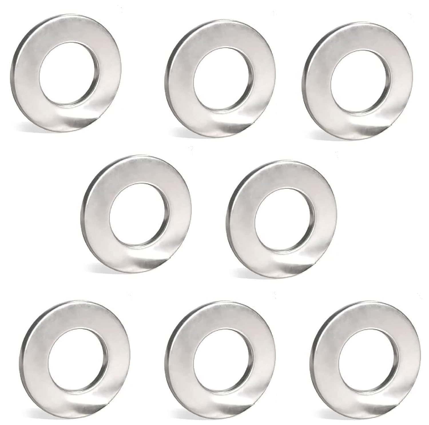

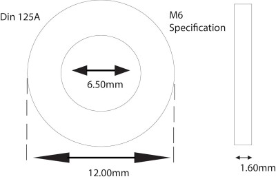

In this order.
Ring terminal for current. Soldered!
Ring terminal for balance. Soldered!
Quick squirt of switch cleaner.
Stainless thin flat washer.
Stainless nyloc nut.
Plastic nut cover.
Why?
Because a thin flat washer allows the rings to turn if knocked without loosening the stainless nyloc. Anti shake or locking washers or serated nuts will also turn the nut when you yank on a cable.
And the switch cleaner like De-Oxit puts a conductive anti corrosion "wetting" agent on contact surfaces and keeps it that way.
And stainless as it doesent corrode...
And nyloc as it will not come loose.
And a nylon/pvc/rubber nut cap as it stops metal shorting anything out...

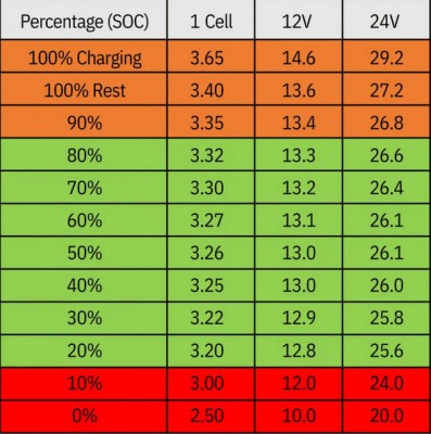

Charging Cells or packs:
Voltage levels: See CHART!
100% charging 3.50V to 3.65V (preferably 3.50V) And you can balance!
100% at rest 3.40V ish balancing here is not effective. And may unbalance the pack. Balance only above 3.450V.
90% 3.35 balancing here or lower UNBALANCES the pack. :thumbdown:
80% 3.32
70% 3.30
60% 3.27
50% 3.26
40% 3.25
30% 3.25
20% 3.20 time to charge! Lower than this frequently = shorter battery life. :thumbdown:
10% 3.00 and as low or lower than you should ever go in use :fencing
0% 2.50 Never go this low unless for capacity testing in controlled conditions. Or in emergency. hanged

Postby Burgerman » 24 Nov 2025, 18:00
Remember that
1. That chart varies depending on brand.
2. that all those in green where you will be using the chair are so close in voltage that they vary more by temperature than by actual state of charge. So its a rough guide!
3. Your BMS accuracy per channel has a spread that is only around 5 to 10mV and its calibration to voltage may be as much as a 10th of a volt out anyway. And that most multimeters are anything up to a couple of tenths of a volt out...
Since theres only a fraction of a volt difference between these green voltages its EXTREMELY hard to know what the real state of charge is based on reading its voltage.
Posts: 70424

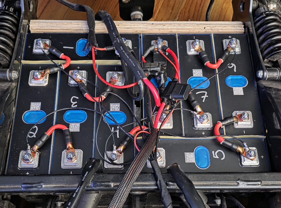

Postby wchl25 » 01 Dec 2025, 00:33
They are in and wired!
ABS sheet on the bottom, and around the sides for isolation. I used the epoxy sheets in between them. Two thin sheets of plywood in the back to take up the gap and they are nice and snug in their new home.

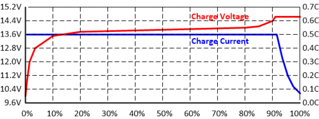

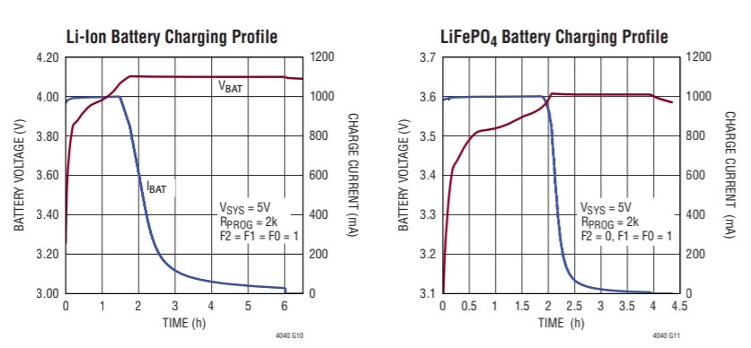

You are correct. Again, that is basically the same result when you charge a single cell. I am trying to show you that it doesent make any difference what termination current you set here. On ONE cell.

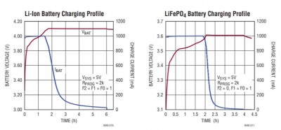

As you charge at say 20 or 30 Amps then the voltage climbs very gradually from 3.2xx to 3.3xx over most of the usable charge at say 20A for 10 hours. And then voltage shoots up suddenly when full in a couple of mins. It doesent really climb at all much until the cell is basically 99% full and then it shoots up in a matter of a few mins to 3.55, 3.60, 3.65 or 3.8 and well above in seconds if you let it. In seconds. To stop that a good charger drops the charge current to whatever it takes. Or terminates charge.
Right up to this full point it will stay solidly in the CC stage at your fixed 30A. The flat part of the current Amp curves below. The difference between 11A, 5A, 2A etc end tail current is all irelevant. That cell is basically full (+99%) at their 3.65V level at this point whatever the current.
If you look at a charge curve for just 1 cell, or bunch of ALREADY balanced cells then you will see that the current basically stays at 30A or whatever you use, then drops off down like you rode a bicycle off a cliff. So 11A (or any) cut off current here results in a full cell. In order to keep that voltage at CV, you have to set a much lower cut off current. Guestimated at 800mA ish for 230Ah ones. (PL8.)
Look carefully at the CURRENT curve shape.
If the cells are
a) all balanced (so no long CV stage needed)
b) charger set to stop as soon as it sees the current drop to any low level (like in this case the 230ah cells suggested 0.05C).
Then it pretty much makes no difference at what point you cut off charge! When its full, and when CV stage occurs, its pretty much fully charged.
But if its not yet balanced you cant turn off the charger! Since the voltage will rapidly "settle" and drop and go below the point where balancing works at all.
So you need the following logic to fully charge and balance a pack!
End charge when
a. all cells are balanced at 3.550V (less voltage is better for cells, but needs a little longer at CV.) Cut off at 11A, bad as this balancing hasnt yet happened!
b. final cell to reach (climb) to 3.550V needs some extra time at this lower voltage (to stop its voltage "settling" more than the other 7 that have been at CV for long time). And because of low current.
Why low current? A balancing charger, or a BMS will not allow the full cell(s) to exceed 3.550V and so in the case of a good hobby charger as soon as the first cell sees CV voltage it reduces the power (Amps) to enable the cell balancers 1A to keep that cell below the limit. That means that we are now at 1A charge while the rest catch up. If you set it to stop at 2.3A or 11A that also stops the other cells balancing or catching up. Depending on logic on charger/BMS.
Do you see this?
Same! Look at how fast its falling away. Actual current here doesent matter.
When its full its full.

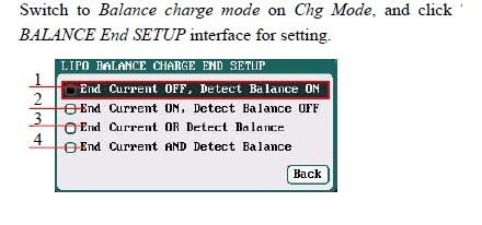

So I am going to charge it up for the first time. I will be using my Junsi X8 charger, with ZXD for power.
These are the settings I'm thinking are good?
20A charge rate
3.45 start balance
3.55 cell voltage
2.5% end current 5.75A (Junsi is %) or should I go lower?
The charger should be set both to end current and balanced

Postby Burgerman » 09 Dec 2025, 11:16
All OK except
Set it less for initial charge, and watch it. Maybe 1 or 2 A.
It may take a long time for initial balancing and may take a couple of charges to end up with a fully balanced pack.
Note the current that it is at as it gets to balanced Voltage and low balance current, + say 30 mins. And then set THAT as your termination current.
Then adjust it so that it ends charge when the cells are all balanced, plus around 30 mins at 3.550V after the next few charges until its right. Thats then going to be perfect. We cant know that final figure until you charge it in use for half a dozen times. Let me know what it is for my own interest!
You wont get it perfect as it varies a little charge to charge too. Is not critical at all so dont worry as long as it turns off as intended and they are all balanced. An extra half hour or just 15 mins is OK. Just monitor it and fine tune a bit at first.
Depending on how well balanced/matched your cells are and depth of discharge it will vary. At 3.55V compared to the 3.65V you can spend more time safely without hurting them anyway.
Trying to achieve this with a BMS is much more difficult. But again its not critical. Since charging 100% full isnt needed all we really want is all cells at say 99 and balanced. That extra bit after balance is just to be sure the last cell sticks, so it doesent drop away a bit faster than the others when you stop charging.

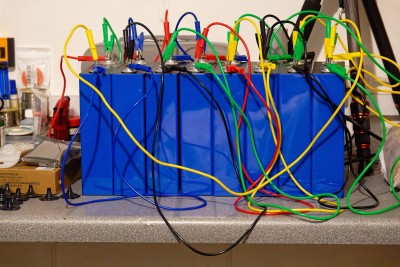

Postby Burgerman » 16 Dec 2025, 23:04
To level all the voltages I connected all the POS terminals together, and all the NEG terminals together. They took 2 days to get within 3mv (3/1000th of a volt). all the pos:1 to 2, 2 to 3, 3 to 4 etc. And then 1 to 8. Same with the Negs.
They took 10 days to get to exactly 3.3431V resting for each cell, once all the cables were removed, a day full later. All are now sat at the same exact voltage measured with a calibrated fluke 289 meter. That means all are identical to 1 ten thousandth of a volt!
When I connect a PL8 which are pretty accurate, it shows a 3mV spread. When I connect a BMS it shows 8mV spread. Those figures are good enough for charging. But these cells are showing as unbalanced! The PL8 would try and balance them. The BMS would try and balance them much more to level that 8mV.
If I were to charge 1 cell by just 8mV with a PL8 to simulate what a BMS would try and do to that pack, what would it show? Well it takes about 14Ah to achieve that new voltage point. So if you were to allow it to balance at this 3.3431V point it will actually unbalance the pack by about 14Ah.

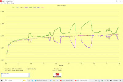

Postby Scooterman » Yesterday, 09:20

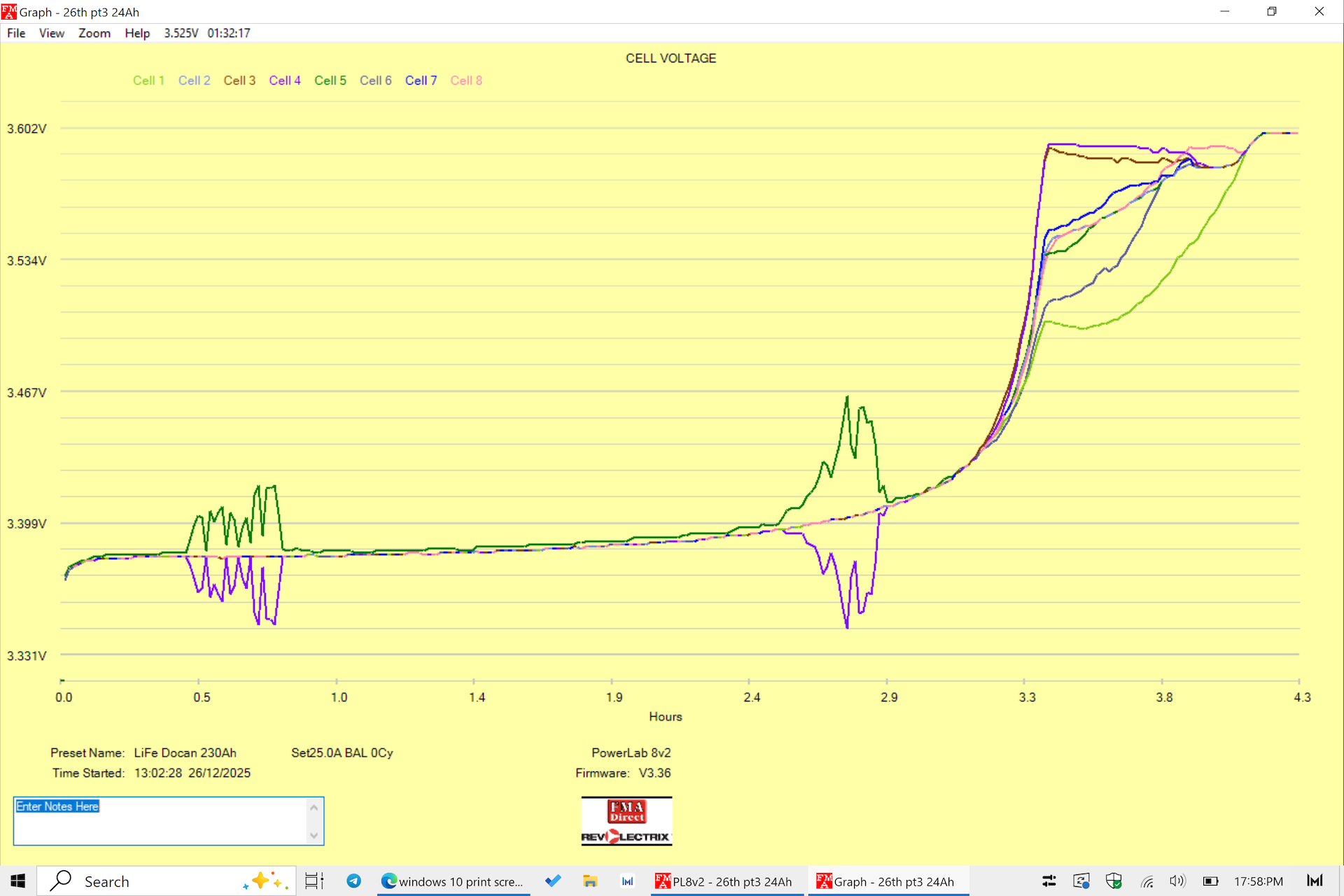

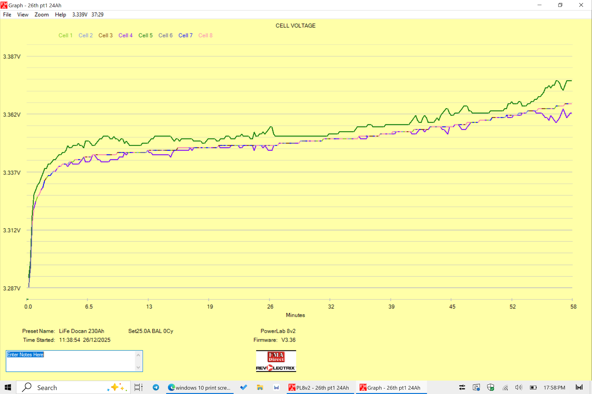

Strange Graph?
Cells charged in cold garage.
Started charging and graph looked slightly odd so stopped charge and restarted charge twice. Graphs 1 & 2
Then I noticed PL8 was charging at 3.55v due to 50mv compensation due to less than 10 degrees.
So I thought as the cells had probably warmed up a bit I'd turn off cold weather comp and allow pack to charge at 3.6v.
But still got an odd graph, see Graph 3.
I'm guessing it's due to cells being cold?
TC was set to 700mAh, so have now set it to 650mAh to see if it gives me a slightly longer CV balance phase next time I charge them.
3.55v
3.55v
3.6v TC 700mV

Is everything soldered?
If not then theres the problem.
If it IS all soldered, then you have something loose on an interconnecting strap, or maybe a balance wire connection.
Either way theres a bad connection somewhere. Likely cell 4 and 5.
