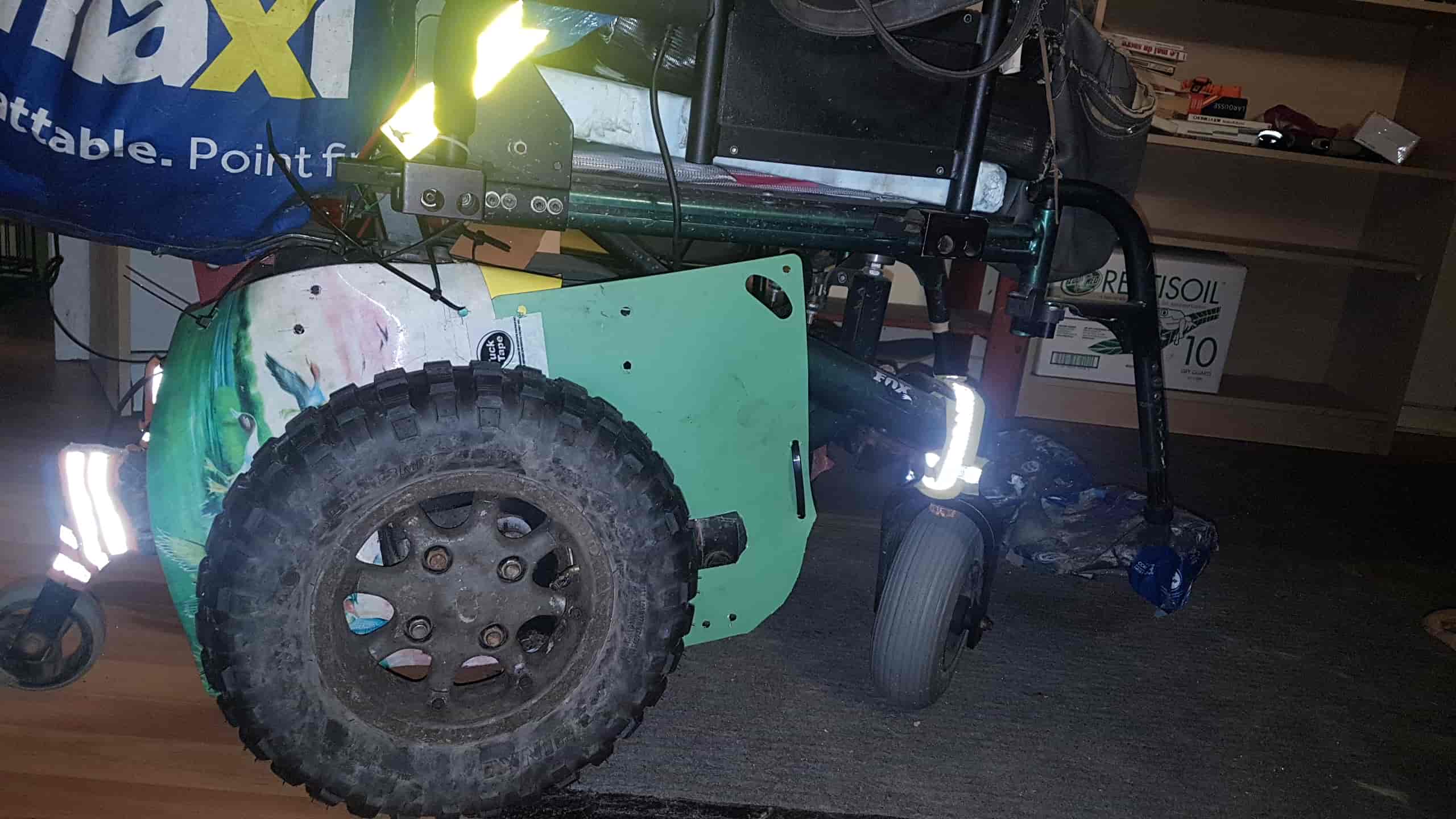

Hi everybody!,
Yes grease is necessary.

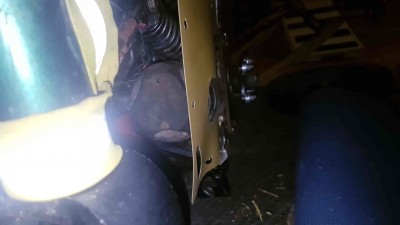

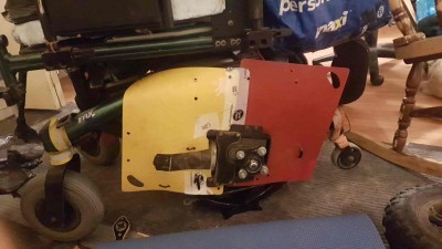

Preventing the salt to reach the metal made sens to me so I constructed a sort of wall between the wheel and the motor Area.
It is made from 1 mm kitchen cutting board. Flexible but still can hold itself.
I did cut a rectangle in the plastic to have the motor come out since otherwise the tires were touching the plastic board .
So far it looks like it works well. I bring back a lot less snow to melt indoor.
Do you have Ideas of how I could improve the desing or others ideas? Because I will have to do another version with black cutting board to reduce the home made visual aspect of it in the eye of public transport inspectors which usually feel that if it does not come from a official provider, it is not safe. The problem is that they could refuse me access if this anti splash looks too much home made to a chair with already unusual esthetic. So using black may be more incognito.

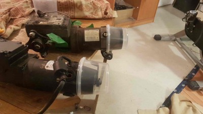

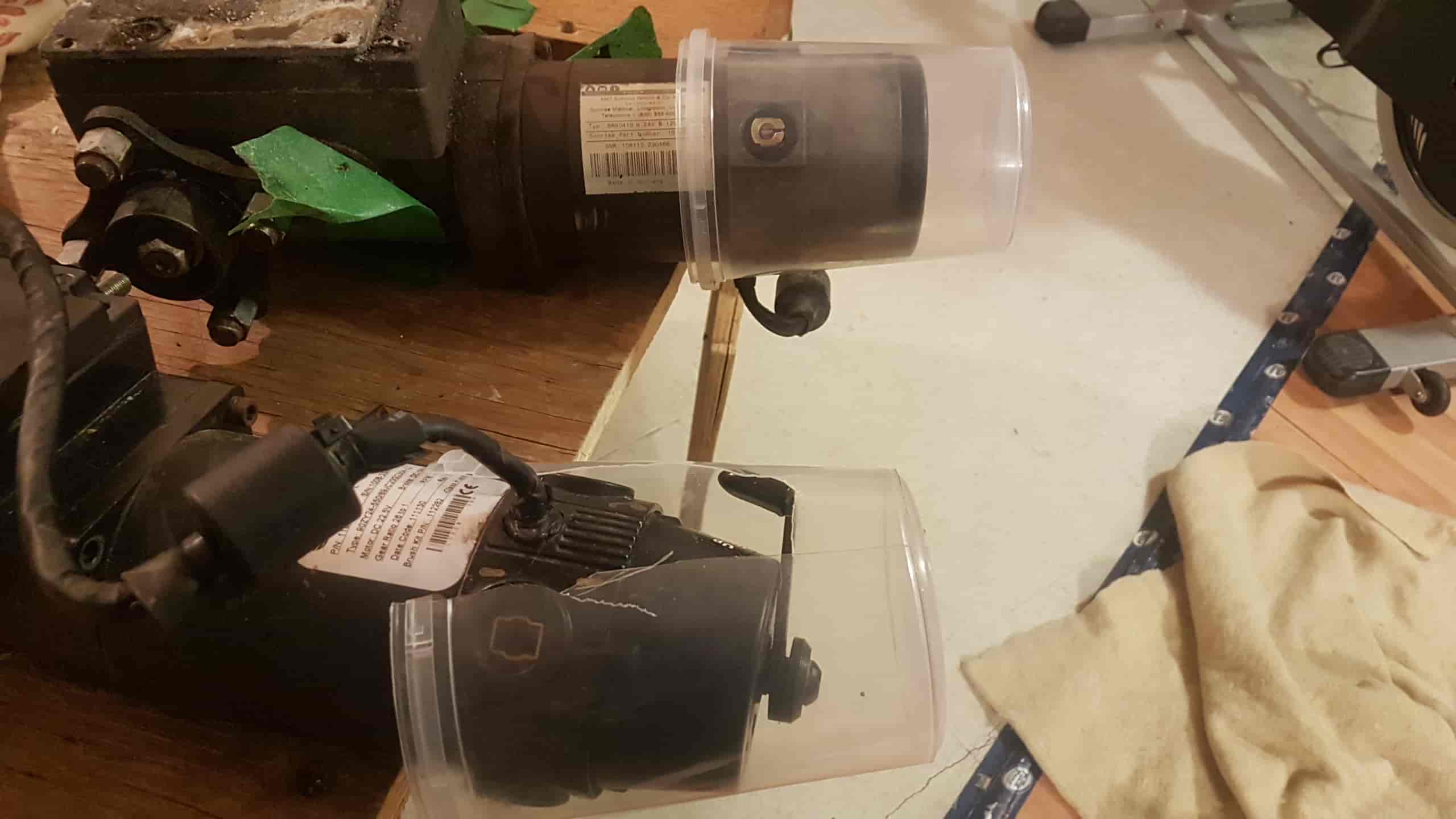

The previous message shows wall protection from the side but the reality is that I have to drive through some snow barricade and cars splash me and the chair sometimes so snow comes from the front and back and has access to the motor and more. One of the motor on the picture has the freewheel in front so it makes it even more important to protect.
Also the front casters themselves pull salty water up directly in the face of the front of the motor.
So to reduce the impact of those 2 things I thought of placing a plastic pot on the front of the motor and would make it stay there with velcro or tie wraps.
I have the choice of thoses 2 sizes of pots as seen on the picture and I could also use a 2 liter coca cola plastic bottle to cover even more of the motor ...
But is completely covering the motor a good Idea in the firts place? If i use a long 2 liters bottle I am wary that I would create a micro climate around the motor reducing its cooling capacity. I guess with the smaller pot on the picture it would not create a micro climate. What about the longer pot on the picture? Do you agree ? What do you think?
Feel free to let me know of things I might not be considering or even other ideas for protection from salty water.

Postby Burgerman » 25 Dec 2025, 07:38
I dont know where to begin.
I would remove all that plastic because it will likely get just as wet under the plastic anyway as water and snow will run everywhere. And now it cant dry out easily or be rinsed with water and so the salt is trapped. It will not stop anything rusting or corroding. May even make things worse. The casters will throw salt up the other side of that "wall" and cover everything...
As for the bus driver, its non of his damned business... Tell him so.
CLEAN white snow will not make anything rust. Its actually helpful. Its just water. It helps remove the salt.
It is the SALT in the melted snow - the wet surfaces you roll on - on the road, and on footpaths that is just water/salt spray that corrodes metal. And it gets everywhere.
For the 3rd time...
Get some spray oil! And coat everything from the seat down once a week when the chair is dry. Until it looks wet. It will penetrate all the places you cannot get to, every nook and cranny that the salt gets into, and protect everything from corrosion. It stops salt corrosion.
When you arrive home rinse the bottom half of the chair with a hose pipe before going into the house to get the salt and road muck off. You will see all the black salt/road muck leave a dirty puddle.

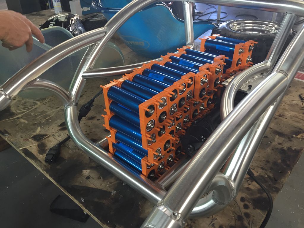

If I didnt move I would build a replica set of parts and all of it in stainless steel. Including all bolts, spacers, washers, frames, rims, etc. Then even without paint it will last and look new, decades later.
Cant do that with motors, so would re-build those from scratch when new and grease everything, replace all bolts etc with stainless steel, and replace every 2 years.
Posts: 70424
Re: any ideas how to improve my creative anti splash salt ?
Postby Burgerman » 25 Dec 2025, 22:52
Stainless frame...
This is aluminium, easy to make something in stainless instead.

Burgerman wrote:I dont know where to begin.
HI which plastic do you refer too? the kitchen cutting board or the 500 ml pot on the end of the motor or the 1Liter pot lightly open ?
I will add some paper easy to spot when wet for my next outing but it seems that the cutting board are doing a very good job at not allowing snow nor water to go on top of the motor gearbox area from the sides which also reduce the amouth of water soaking the entrance mat since no snow has collected there. I dont know if the pots would be enough to stop the water from the front caster though.
I remember that you said to wash the chair but as I had answered, I have no garage nor place to wash the chair in winter unfortunately. Oil will be sprayed yes but not every week. On cars people put fluid film once per year and have seen it was enough even for the undercar exposed. So If I put once per month in winter with some physical way to reduce the amount of salty water lifted, I think it will be good . The cutting board and aspiring caster water protection is an addition to the protection.
About the coca cola 2 liters plastic bottle not showned on the picture, would such a long bottle reduce the capacity of the motor to be able to coo itself? Maybe i could just place a hanging rectangle in front of the motor to block the caster's water splashing.
ALL. Its a a waste of time. May even make things worse and keep it all wet and stop the fresh water/snow clearing the salt. And yes it will hinder cooling but thats not going to matter in those conditions.
Even WD40 which is crap, is better than nothing at all. Bits of plasticc sheet or coke bottles wont stop any rust.

Postby Raro » 26 Dec 2025, 11:22
Burgerman wrote:Stainless frame...
Nice frame. Do you have a link to the manufacturing of that chair?
Raro
Posts: 382
Joined: 17 Feb 2024, 20:56
Location: España

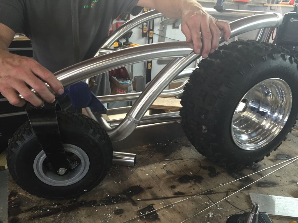

Postby Burgerman » 26 Dec 2025, 11:53
Not manufactured, made in a users home (cars garage space) of a man I know.
You can buy stainless bends. And straight tube. Just weld it together, and copy say an F55 type tube frame. Make a clone, change it as you wish.
If you also only ever use stainless steel inc all bolts, spacers, axles etc then you coud dump it in sea water for a year and it wont rust or even change. It will get dirty, but it will just wipe/wash off...
Found a stainless cap screw (allen bolt) on my BBQ/patio the other day. From 1997 when I dropped it there when building an F55 chair. I saw it happen, coudnt reach it. Saw it occasionaly over the years. My carer found it and brought it into my bedroom a few months ago. He though it had fallen out of my chair. Said it was "new" looking. Because it just hadnt changed... Still shiny.

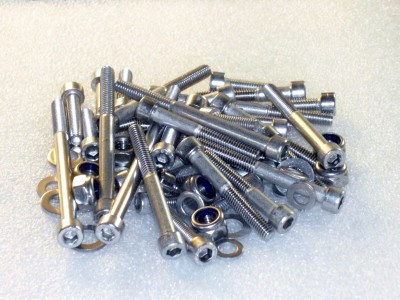

Stainless steel 316 metal bolts or parts have a little chromium added (16 to 18%) and some other metals that prevent corrosion. Even in sea water, this is almost 99.9% free of corrosion or rust.
Its not "chromed" its the same metal all the way through.
It never does this:

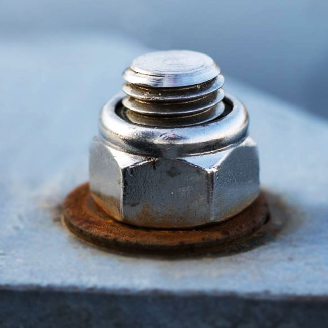

This is what happens if you forget to use a stainless steel washer!
Stainless steel bolt/stud? Yes.
Stainless steel washer? NO!
Stainless steel nut? Yes.
This is why you build a chair with:
a) grease on all threads and a THIN layer on all surfaces, AS YOU BUILD a chair coating every part, every hole, every thread, every seam and edge INDIVIDUALLY as you build it up.
b) stainless steel axles, bearings, bolts, nuts, washers, screws, and coppergrease.
IF you care. Thats the ONLY way to do it properly.
THESE look like this after a decade of use. And if GREASED on assembly will come out as easily as the day they were fitted.

You MUST use some type of grease (like plain old lithium grease) or anti sieze (copper grease) or Loctite on any stainless steel bolt. NEVER use them clean and dry without one of these compounds.
Stainless bolts with stainless nuts or threadded parts can friction weld to each other seemingly for no reason. Thats why you need to understand the above!
Grease of any type is fine in almost all aplications. If you need to use something to prevent it vibrating loose or on say a brake caliper, you can also use blue Loctite as this also prevents siezing and corrosion too.
