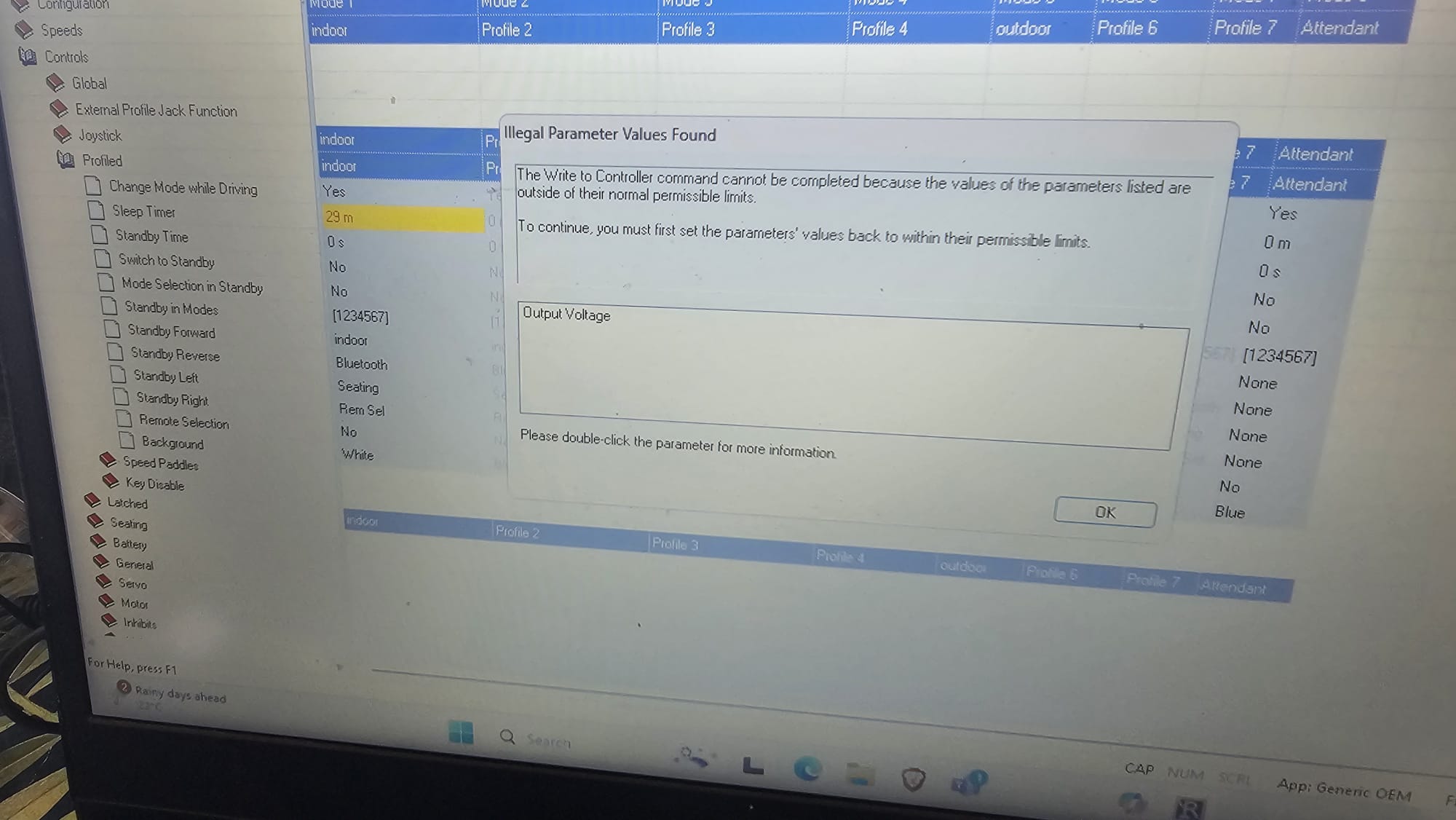

I have 2 wheelchairs one is a BM style wheelchair with 8 mph motors and an R-net system like your BM1, with a lithium battery pack. If I read from the controller, and then try to write it straight back again I get this error message. If I do the same with my wheelchair I don't get the problem, so it must be a problem in the programming specifically to do with this chair?

Postby Burgerman » 27 Aug 2025, 16:08
What are the two power modules from? A permobil by any chance?
And the generic programmer you are using has some strange options that are not relevant to most chairs too.
What version of the programmer too?

Postby Mr TT » 27 Aug 2025, 17:15
The title on the zip file is uploads_Setup_OEM_Generic_6_1_2-902762832. Do you need me to open it or Pandu a screenshot of the about page?
I don't think the power module is permobile, But I would have 2 open the wheelchair up to be certain.
Where can I download the most regular one?

Postby Burgerman » 27 Aug 2025, 17:44
Its not about regular (I dont actually know what that would mean?) its about using the brand that the power module was intended for.
Many companies have modified firmware extensions. The permobil one is an example. It has things like their own gyro brand settings and algo in it.
And their own seating, joystick brands too. So you can come across situations where you are trying to write settings for a module hat doesent know about hem. Or has restrictions set up to prevent certain things.
I found a few similar issues trying to use the generic versions. Especially the newest ones. They have settings fpr steering servos etc built in for e.g.
I get very few issues with the sunrise versions - maybe because I have about 7 such power modules. It works great on Dietz, Sunrise, permobil (cant do their oddbal branded stuff but no errors).
In this case it seems it doesent want to allow you to write the "output voltage" to the module. What did you set here?

Postby FelipeOliveira » 29 Aug 2025, 04:13
Mr TT wrote:I have 2 wheelchairs one is a BM style wheelchair with 8 mph motors and an R-net system like your BM1, with a lithium battery pack. If I read from the controller, and then try to write it straight back again I get this error message. If I do the same with my wheelchair I don't get the problem, so it must be a problem in the programming specifically to do with this chair?
Good evening!
Which parameter are you trying to change and are getting an error? And what value do you want to set?
I have the file you attached here open

Postby Burgerman » 29 Aug 2025, 08:43
His "error" is that one of his power modules wont accept that he has set the motor output voltage higher than its firmware will allow. I think!
Its in his screenshot.
If you set that parameter too high the PM wont allow it. Some will not allow it to be changed at all. Many of the software versions do not even include this field.
Sunrise ones allow this, up to a certain voltage. But some dont. Some will only allow figures that are safe for lead based cairs. Default is around 21.5 to 22V. With lead higher means less control. Less headroom as voltage drops during load and discharge.

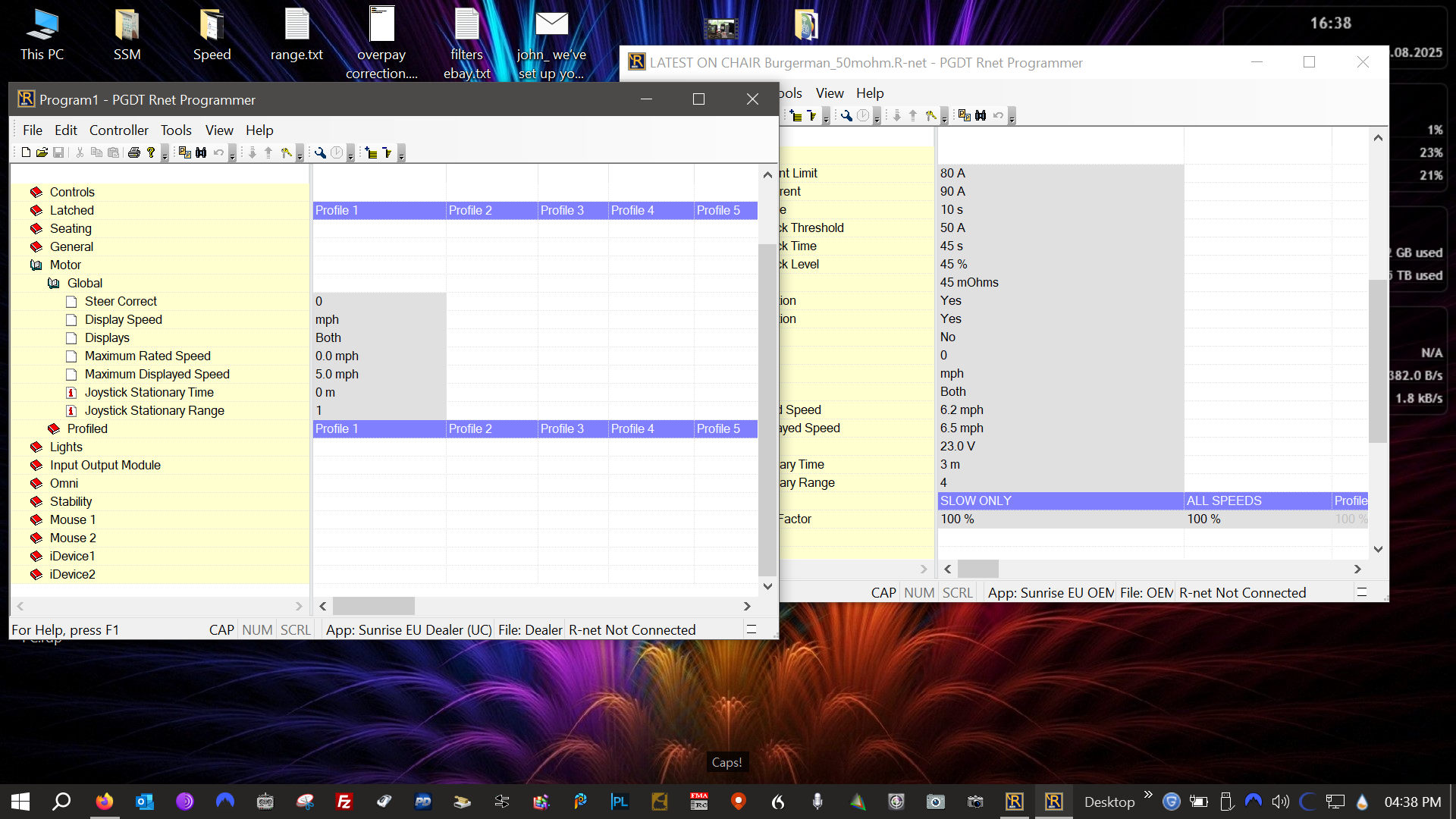

Postby Burgerman » 30 Aug 2025, 16:48
For those that dont know
This is a comparison between dealer and OEM versions.
Here on the left several headings are completely missing.
When they are not, then many of the items inside those heading have lots of parameters missing...
Here for example I opened MOTOR on both versions.

Postby emilevirus » 08 Sep 2025, 23:38
If I set voltage too high, it'll just revert back to the default 22v. No error, nothing. On Sunrise, the limit is 26v. On my magic one, I set 31v and it saved just fine. Some companies hard locked it in the firmware.

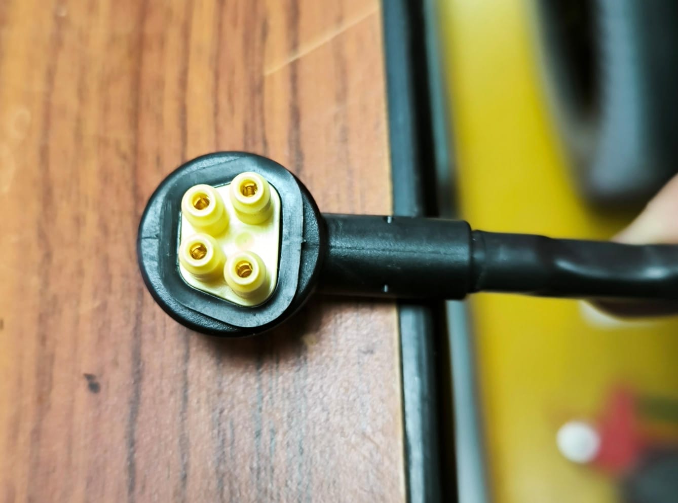

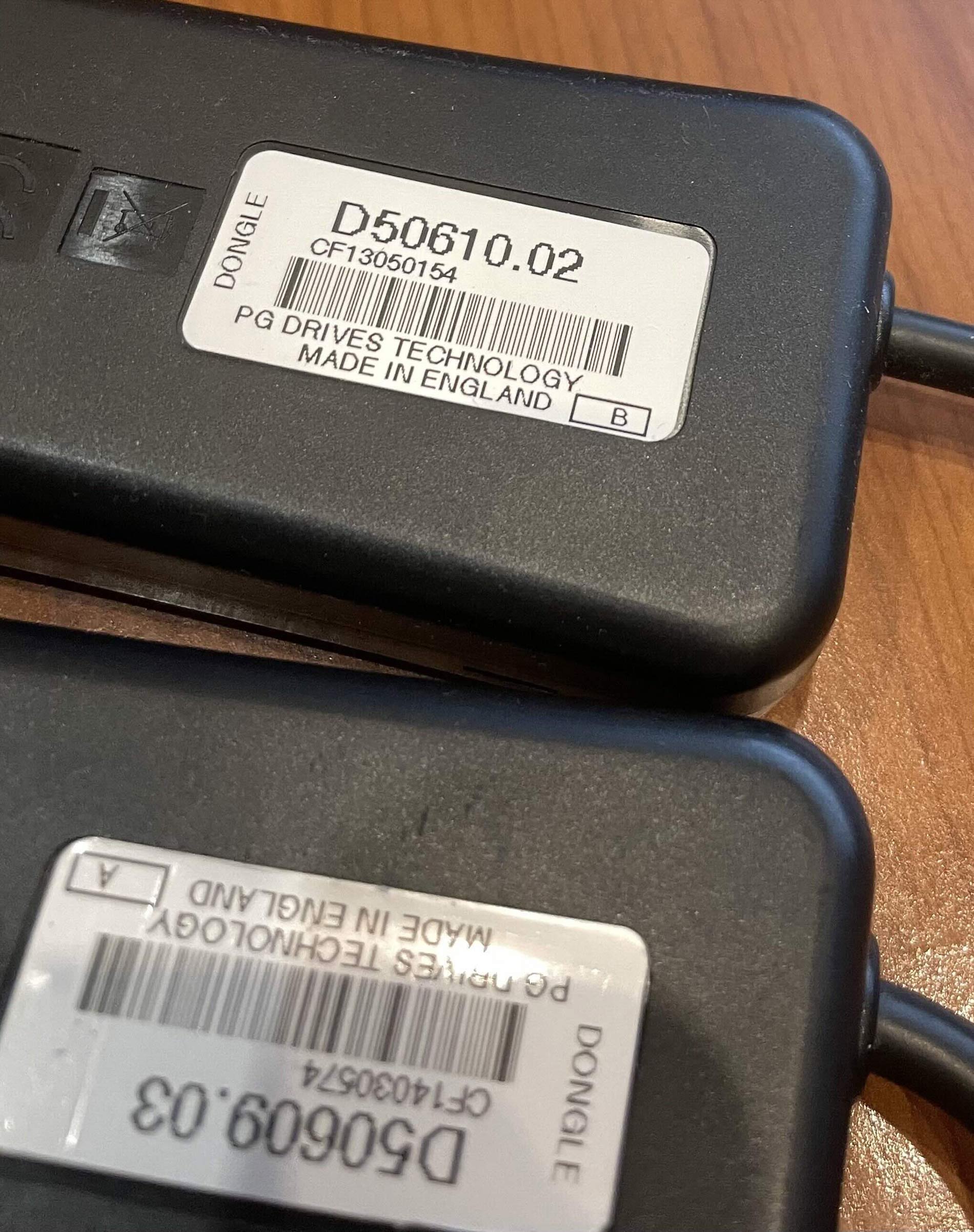

Postby sergey0 » 21 Nov 2025, 13:17
[quote="snaker"How to detect if a Rnet dongle is true OEM?[/quote]
Look at the picture. OEM on top, Dealer on bottom
OEM/Dealer

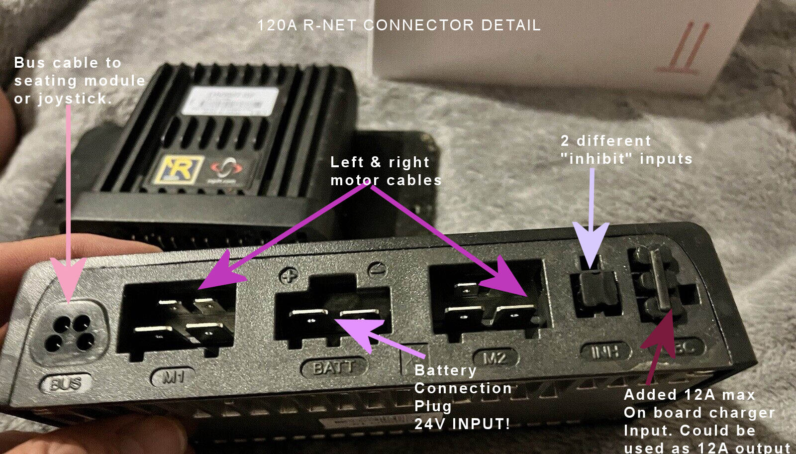

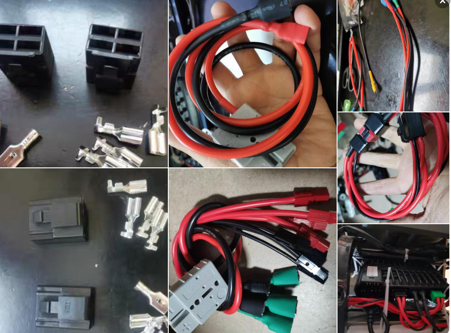

Postby CPguy » 04 Dec 2025, 00:35
I have a question regarding the R-Net battery connector on the A120 power module. Is that a generic connector (will an "Anderson SB 50 grey" fit?) or do I need a special connector on the power module side?

Postby Scooterman » 04 Dec 2025, 01:21
CPguy wrote:I have a question regarding the R-Net battery connector on the A120 power module. Is that a generic connector (will an "Anderson SB 50 grey" fit?) or do I need a special connector on the power module side?
Nope. Anderson SB50 definitely won't fit r-net controller module.
Btw I always find the connectors difficult to pull out and put back in as they're so close to each other and cos of the plastic tabs.
Re: PINNED - R-Net for dummies
Postby emilevirus » 04 Dec 2025, 01:23
Here: https://www.wheelchairdriver.com/board/ ... 22#p213536
