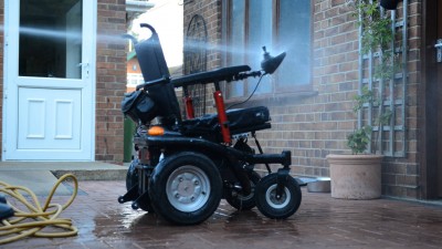

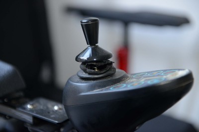

Heres a very old chair that is only used for dirty jobs. It has holes in the rubber boot. The case top/bottom rubber sealing gasket was thrown away years ago. This chair has been left outside all winter for 2 years. It doesent seem to mind a bit of water. Washed for 5 full mins.
DONT TRY THIS AT HOME, ME I DONT CARE! I washed the joystick to prove a point.
I know It will dry out later even if it stops working. But it doesent stop...
MOVIE Rinse off salt with hose:
https://www.wheelchairdriver.com/gopro/hoseshorter.mp4
Pics...
Hole... + old masking tape where button fell off! No seal. No problem!

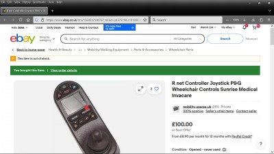

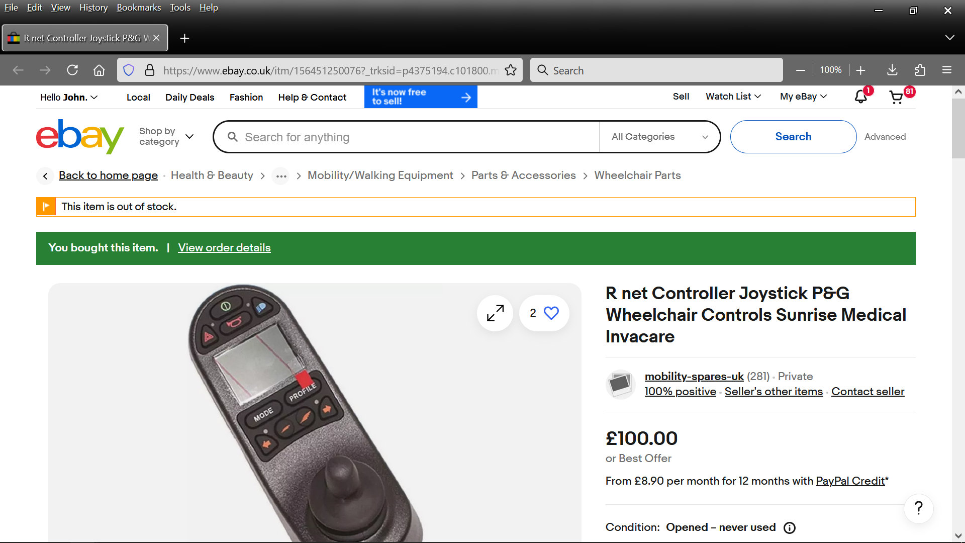

Unknown. But I got 3 new ones over a 12 month search from tom kilmore, eBay, and Rover on here. 125, 125, and £150 all with factory screen protectors and never used. So theres also other ways.
I recently got a cjsm for £80 on an offer. That was the going rate last year for brand new ones on eBay. Many were for sale. Mine was offered at 100, I paid 80.
Be patient, and fish carefully and make offers!

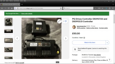

Also got a 120A power module, and a seating module, and 2 bus cables, all in one go for £50 recently...
So a full colour R-net system with 6 channel seating/lights etc, ready to fit for 80+50 = £130!
