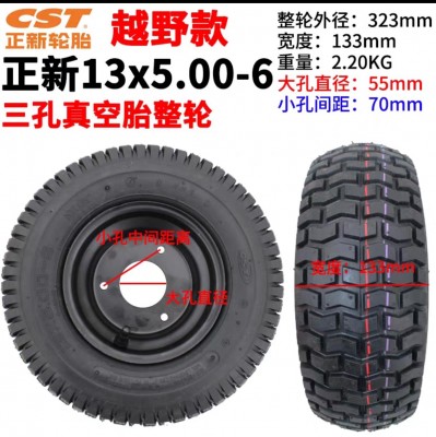

What size tires fit these rims?

13x5, 13x6, 14x6, 145/70 They're 4.5" wide.

All of them will fit I think but those are not tyre sizes so I cant be sure what you mean.
Its normal to find a tyre thats the overall diameter you want/need. Then choose the width you require. Then see what profiles are available and the best type of construction and tubed or tubeless and then decide if that better suits a 5, 6, or 8 inch diameter rim. And depending on tyre size which would be the best rim width. And if it need be tubeless.
You can fit a fat tyre to a narrow rim, it looks bad, and needs higher pressure. Or you can fit a skinny tyre to a rim thats either too narrow or too wide and that tyre will then sit on the rim differently. Theres no correct. It depends what you are looking for.
"NORMAL" needs would dictate a rim a small amount narrower than the tyre size/ So a 5 inch tyre would go on a 4 inch wide rim. Give or take half an inch.
figurs like 13x6 is not a tyre tize. It means nothing other than a bad description of a complete wheel.
A 15 x 6.00 - 6 is a tyre size. It is an IMPERIAL (UK old style measurement) sizing that means:
15 inch OUTER DIAMETER. 6.00 TYRE SECTION WIDTH. 6 INCH DIAMETER RIM.
(And a 4.5 or 5 inch rim is fine. As this is about an inch narrower than the tyre.)
A 145/70 - 6 is a METRIC sizing system like your car. 145mm tyre SECTION WIDTH. With a 70% tyre sidewall HEIGHT (70% of that 145mm) and so you need to add the numbers up to find the overall diameter. And it fits a 6 inch diameter rim. I will do the maths. 70% of 145mm is 101mm. Theres two sidewalls, one at the top and one at the bottom. So 101 + 101 + that 150mm (6 inch) wheel rim. So its 101 + 101 + 150 = 352mm overall diameter. Thats 14 inches and a bit... But tyre sizes are NOMINAL and most 145/70-6 tyres are about 13.5 inches and a bit small and so grip worse.
In both cases a 4.5 rim is fine.

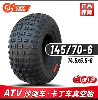

But that's what I struggle to understand. 145/70 is supposed to be smaller but not the ones I bought. They're borderline too big. They're almost 15". Err.. After checking, the site says 145x70 not 145/70. So they're actually 14.5" x 7".

Postby emilevirus » 29 Mar 2026, 14:47
No! See: https://www.micperformance.com/products ... uMwoyvT9Iu
Title says 145/70. Description says 145x70. That explains why they were so easy to install tubeless. If you get a 13x5 there's no way you can mount them yourself. You have to go to a shop.

Postby Burgerman » 29 Mar 2026, 19:31
Product title: Pack of 4 tires KENDA 145X70-6 2PR SCORPION K290
Says 145 section width, 70% profile. 6 inch diameter rim. They have used an x instead of the / because they dont know what they are doing.
Either way that fits a 6 inch rim. There are no 145 imperial tyres. That may be a 6 x 4, 6 x 4.5 inch rim etc. Te correct way to write the rim size is rim diameter then rim width. With a J. Which means between rim beads.
So those tyres can ONLY fit a 6x4.5J or a 6x4J rim etc. Its not possible to fit a tyre that wants a 6 diameter rim to a 5 inch wheel!
2PR means equivelent to a 2 ply tyre. So weak. Flexible.
You also cannot fit a 6 inch tyre on a 5 inch rim. Its impossile. And you cant fit a 5 inch rim tyre, to any 6 inch rim diameter either No matter what tyre shop you go to.

@shirley_hkg what is the price for the rims with knobby 13x5.00-6 tires and shipped to the U.S?

fishinjunky wrote:@shirley_hkg what is the price for the rims with knobby 13x5.00-6 tires and shipped to the U.S?
He just ships the rims. Tires would cost way too much to ship. Just get them on Amazon.

Postby shirley_hkg » 30 Mar 2026, 12:57
£25 with alloy rims, excluding shipping.
Posts: 4649
Re: 13x5 rims for Bounder
Postby shirley_hkg » 30 Mar 2026, 13:22
Good brand name £20 with steel rims, excluding shipping.
