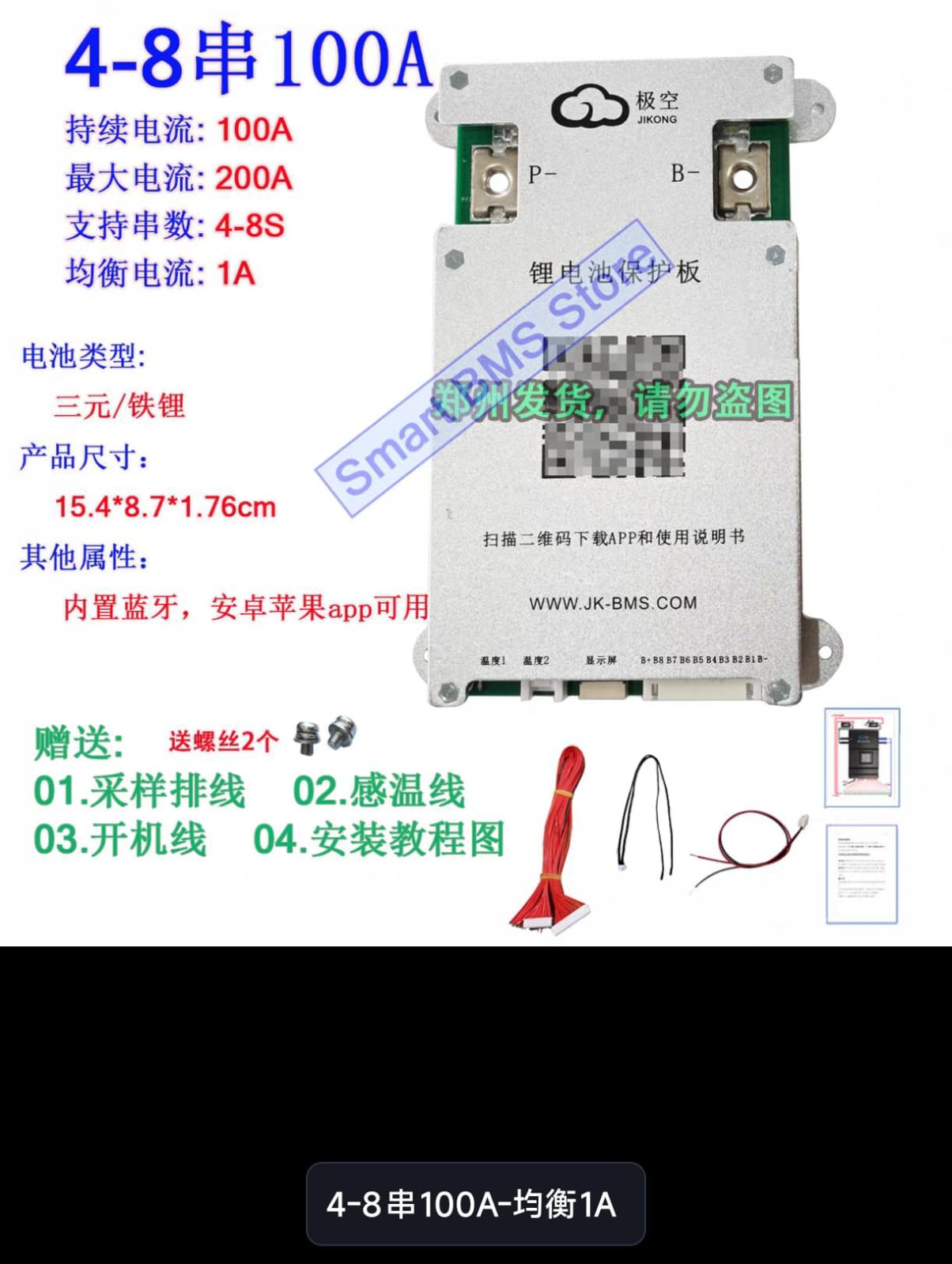

Although I can supply decent used PL8, I also recommend BMS.
Modern programmable, bluetooth connected BMS, with 1A~2A balance current (as below), will do a decent job .
You can charge it via any charger if you don't mind long charging time. You may charge it with a more powerful psu, like ZXD2400.
Burgerman wrote: a BMS does many things you dont want in a chair, like chopping off power completely every time it decides to... Which is dangerous to the control system, and you.
And they do a crap job of charging too...
Therefor, we use BMS for CHARGING ONLY.
Power your wheelchair from lithium battery DIRECTLY.

He charges via a PL8 normally.
When on holiday, PL8 lots bigger as it needs a power supply as well. So he uses a BMS but not on the chair. Theres little space to fit one. So used externally, with a power supply. You can do that with a ZXD supply too.

I replaced the batteries on my 2022 Permobil F5 with lithium batteries using JK-BMS. I was able to install eight 105 Ah EVE cells.
