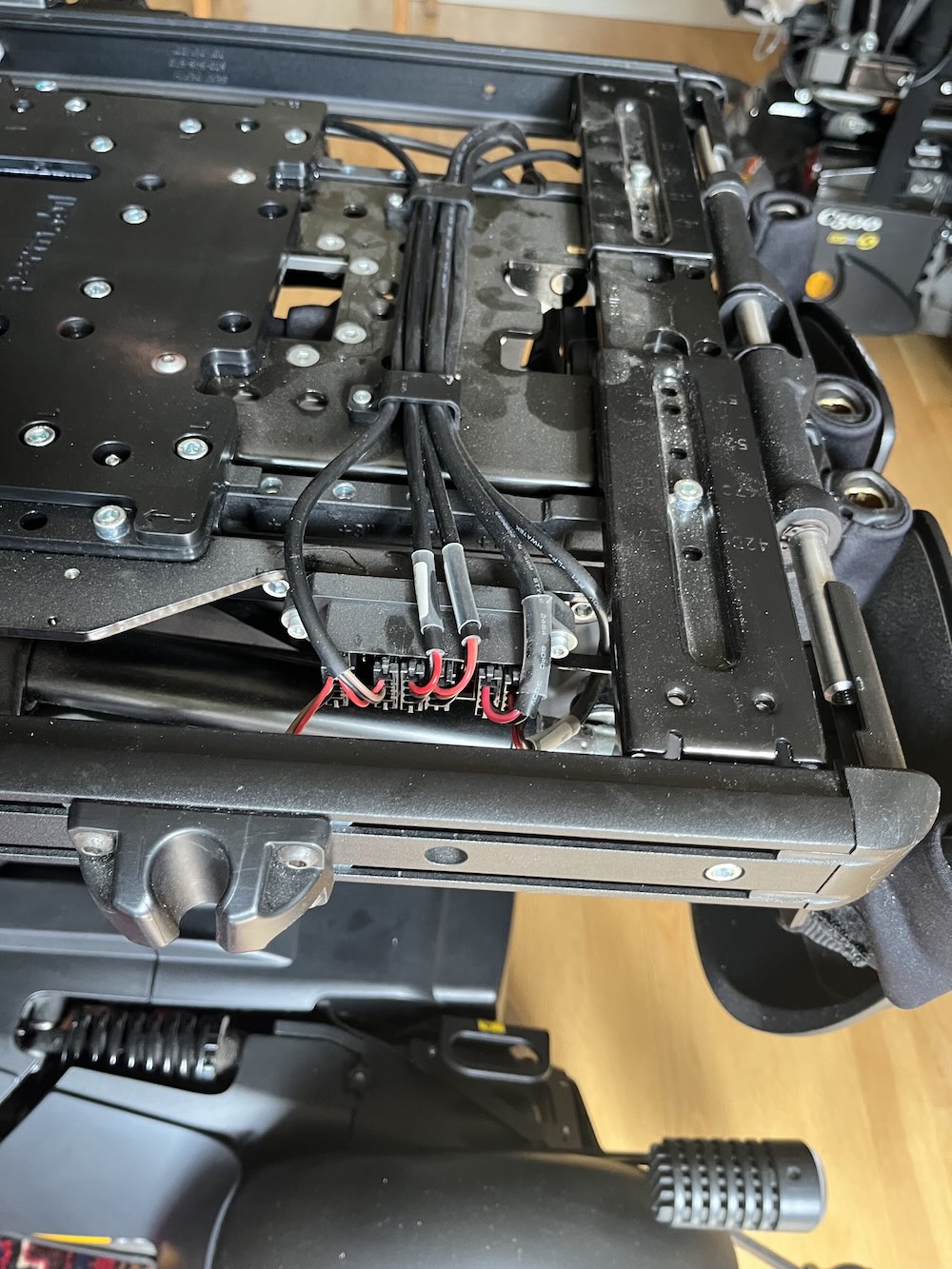

Postby jefferso » 10 Apr 2026, 17:55
swalker wrote:I went on a 14 mile ride 3 days ago and about 1/2 mile from the end The LCD display indicated a PM error for a Bad Cable (7F00).
I monitored this over the next day and noticed I was getting both PM and JSM Bad Cable 7F00 errors. This would be displayed every 5 seconds for 1 second, often alternating between the two different errors. The wheelchair was still functional, but it was throwing these two errors.
My ride was only 5.5 miles but it went over some pretty rough bumpy paths with lots of vibrations and I only got JSM Bad Cable 7F00 errors (I think) and not PM errors. It seems like the joystick cable on my 2022 F5 is one long cable from the Joystick controller all the way to the back and down inside into a junction box just under the plate the cushion rests on. A couple of the plugs there seemed loose (not sure which ones) and were pushed in firmly.
The error was showing up sporadically, so I can't be sure it's gone, but so far it hasn't appeared again since the re-seating of the plugs.

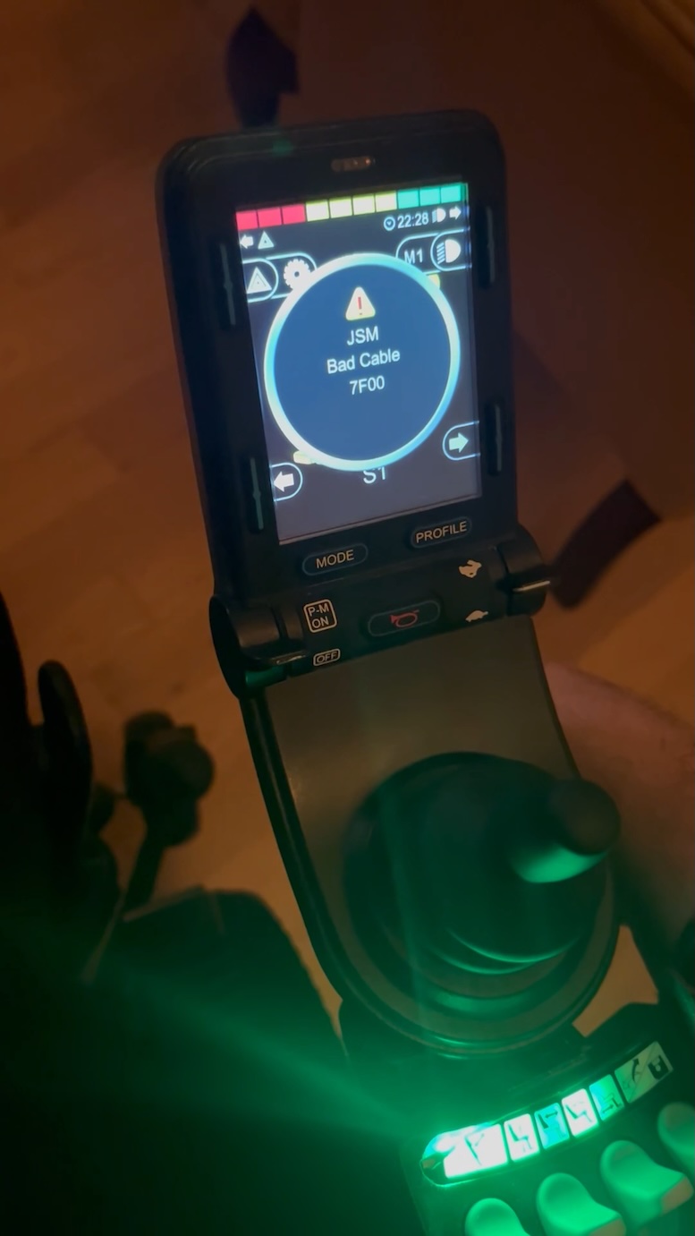

Postby jefferso » 11 Apr 2026, 00:09
Got the error again, so the slightly loose plugs were not the issue.
I had to have that cable replaced in September 2023, so maybe it's worn out again.
I'll have to see if I can figure out a way to test it.

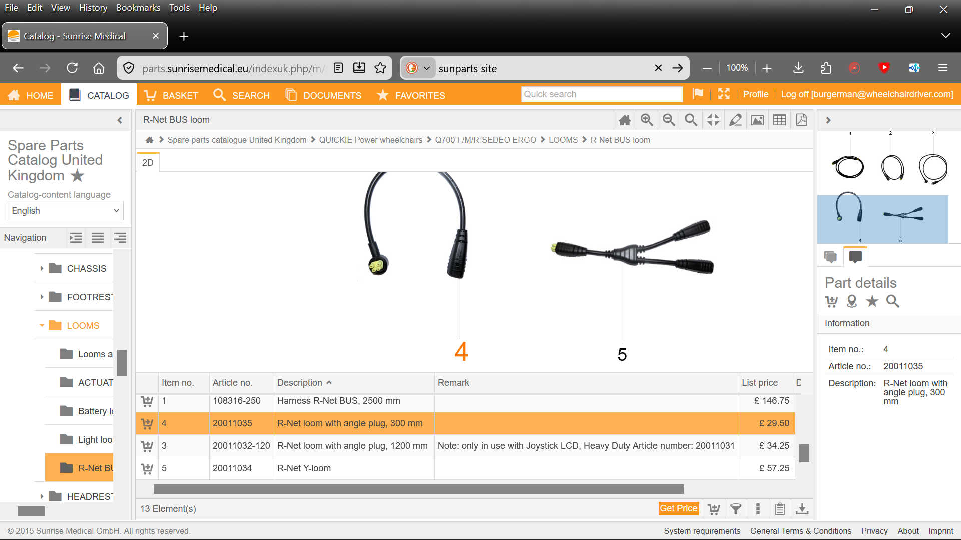

Postby Burgerman » 13 Apr 2026, 23:47
You can get a short one as used on my chairs. With right angle connector. Then it uses a longer one from the arm to wherever the power module is.
Its much better that way as lifting off a controller pod / arm or adding a programmer in the loop is all at your arm top.
Those short ones you can get from a sunrise dealer.
Or MAYBE here.
https://www.ebay.co.uk/itm/157328053007
And every length between 10 and 30 quid.
Bought a box of cables - all lengths a couple of years ago. Maybe 15? for 30 quid... Job lot.
Long cable plus part 4:

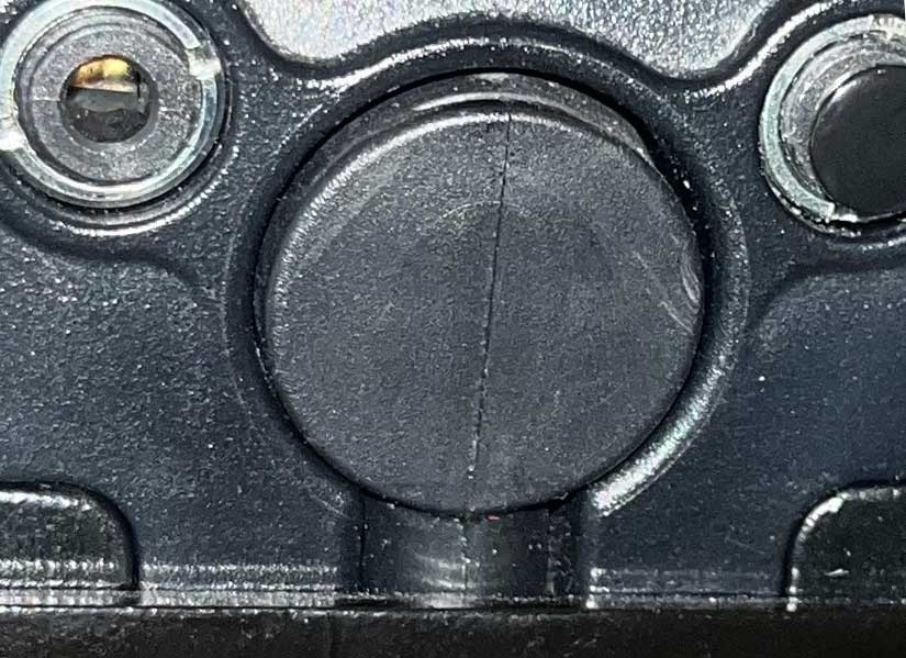

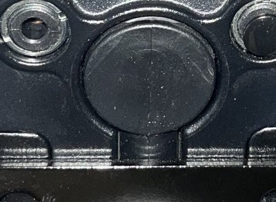

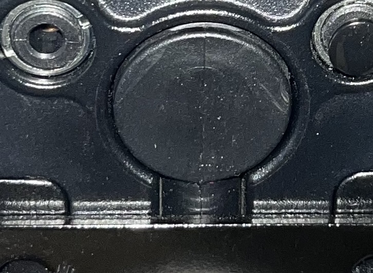

Postby jefferso » 14 Apr 2026, 19:14
Hopeful post # 2. While trying to measure the length of the cable from the joystick to the junction box on the back of the chair, it seemed like maybe the cable plug under the joystick could be a little bit loose. After pushing in the plug firmly, no messages yet, but it hasn't been a few days yet. I would be very happy if that was the fix.
The cable seems to be about 112cm long from the joystick to the junction box. So it must be this cable listed on Permobil's parts site:
22.1 1831274 614692 CABLE, PJSM CONTROL PANEL R-NET, 1.5m, 90°
Maybe I won't need to replace it yet. But it would be nice if it was two cables, instead of one, with a plug easily accessible without having to use tools.
Before being pushed in, cable plug in bottom of joystick controller
After being pushed in, cable plug in bottom of joystick controller
