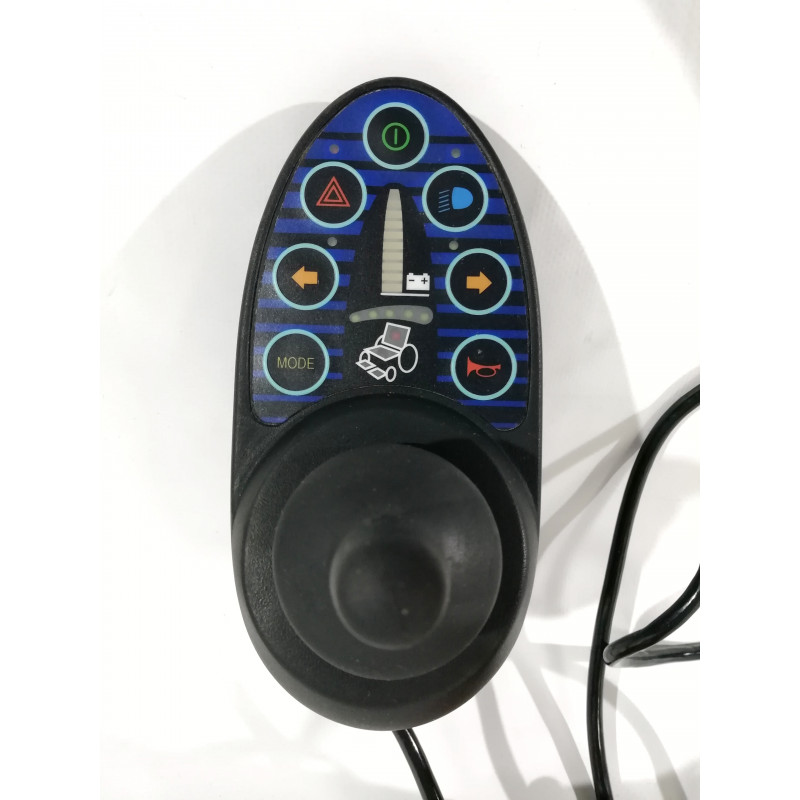

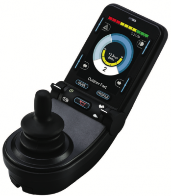

Hello everybody! Please tell me, if I set all the values in the settings of my new Permobil F5 stroller to the same as in my old Permobil C400 stroller, will it be controlled as well? Driving my Permobil C400 is perfect for me in everything. There is one day access to the OEM Generic programmer 6.1.2 program and the Rnet key level (b) for setting up the new Permobil F5 stroller, so I would not like to waste time. Remote control for Permobil C400 PG-DRIVE J3095400 for Permobil F5 CJSM2.
If not, please tell me which values are better to set. Thank you.

I would also point out that if the photos Guma posted were the joysticks of the two chairs then you have two entirely different control systems. One photo, I'm guessing from the C400, is a Pilot+ joystick, and the other is Permobil's modified R-Net Joystick....
While Pilot+ and R-Net were both made by P&G, they are totally and completely different electronic systems, that are configured using different cables and software and are not in anyway interchangeable other than by swapping over EVERYTHING between the batteries and the motors (and any actuators)
How much the settings on the C-400 will be able to get copied over to the new chair is marginal at best - the R-net hardware has a lot more setting options, and many are slightly different, even before trying to deal with the way Permobil has diddled it...
I could be wrong, but I suspect that your C-400 was not locked down or changed from standard Pilot+ hardware to any great degree. I haven't ever heard of a "Gyro Module" for Pilot+, but it does have a setting in the programming software for FWD or RWD which slightly changes how a char handles...
