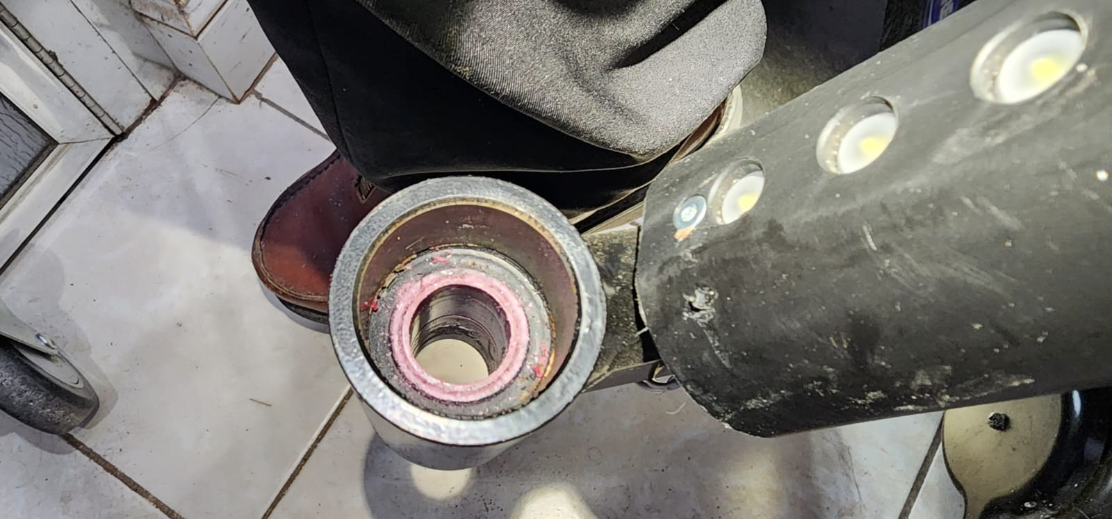

The most shocking discovery I made about my Invacare Aviva Storm RX20 made my eye twitch :shifty:
The chair has been lightly driven about 25 miles mostly indoors over tile and laminate flooring. From day one the chair just does not like to turn. It felt jerky and like the front caster too tight. Its making crunchy noise coming from the stems and not the wheels.
Now it makes sense. There are NO ball bearing in the stems. They rely on one bronze washer. This washer already developed grooves on both sized as its being grinded down as fork rotate. You can see the amount of dust fell out. I am in disbelieve of how such a design continued into production.
Any recommendations what to do?
Thank you in advance.

Postby Burgerman » 12 Feb 2025, 00:31
Even if that was true, if it was GREASED correctly on assembly then it would still be fine. Plain bearings are used all over the place.
But what I see here, and the pic of the bottom one below the C clip, look just like bearings to me... With a spacer/sleeve in between top and bottom.
It LOOKS llike polyurethane bush inside a bearing.

Postby Flagmax » 12 Feb 2025, 01:47
Are you talking about something like this? https://hvhindustrial.com/sub-category/plain-bearings
Nothing spins inside the headtubes. Perhaps it seized up. All the load is on that bottom small bronze washer and a thin wave washer on top of it. All the rotation is happing here. The bronze washer is being destroyed.
Depending on user weight this can go bad quick. This might be the problem Jay is having. https://www.wheelchairdriver.com/board/ ... ilit=aviva

Postby Burgerman » 12 Feb 2025, 11:33
That pic appears to show a rubber bush as used in a car suspension, like you can buy from any motor parts store, or a replacement better polybush. And no bearing. Even with the vertical load being a phosphor bronze washer, if it was greased when assembled it should still work. The bronze bit doesent see any flexing or angles as the whole centre part moves in that bush.
But its still a crappy way to do it. And with no lubrication (grease) it will not work.
Take out the C clip. Remove bush by using puller or whatever from the bottom or a drift and hammer from the top. Then replace with proper bearings that fit the casing and the caster stem. Use a taper roller on the bottom one. Or an angular contact one. Use STAINLESS bearings, Grease, assemble, forget future troubles. And while apart fit a GREASE NIPPLE!!! Couple of strokes every year will make it work indefinitely. You will lose the marketing "suspension" it never really had though... And will never be able to tell.

Postby martin007 » 12 Feb 2025, 18:22
You have two options.
1º- Apply lithium grease.
2º- Replace the current one with bearings.
I would start with 1º.

Postby Burgerman » 12 Feb 2025, 19:35
I would replace rubber bushing wih bearings.
These are used in lots of places. Like they locate the axle on a car. But a useless way to add "suspension" on the cheap! :thumbdown:
Looks like 2 short ones and a spacer were used.
Remove, bin, add 2 bearings.

Postby Jay_x » 13 Feb 2025, 17:47
Hello, I have the same chair and guess what...? Exact same issue. Or at least I had the same issue. FINALLY they replaced the entire arm on both sides, under warranty. Apparantly this is a known issue and they have a fix for it. I would contact Invacare and demand they replace it, its new it should work great.
My chair now...FINALLY...is working great, turns smooth, casters flip properly, etc.
Seriously, call Invacare and demand they replace this UNDER WARRANTY, no charge to you. They are well aware this is an issue and they have a fix for it.
