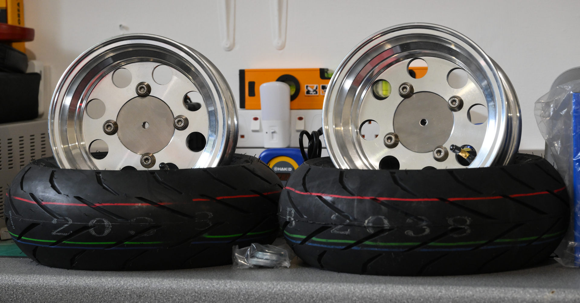

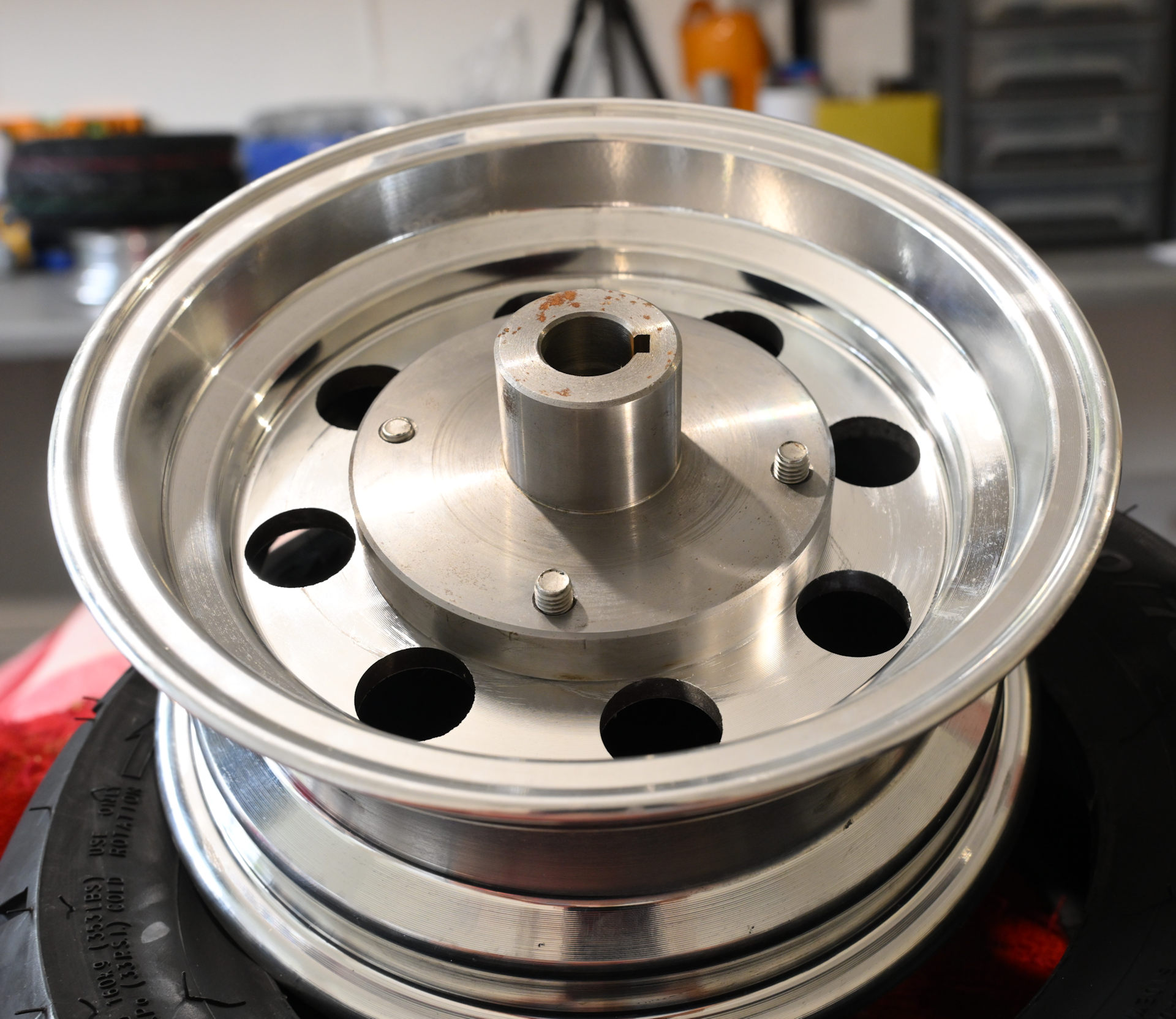

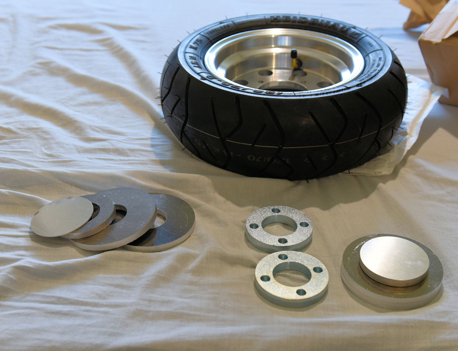

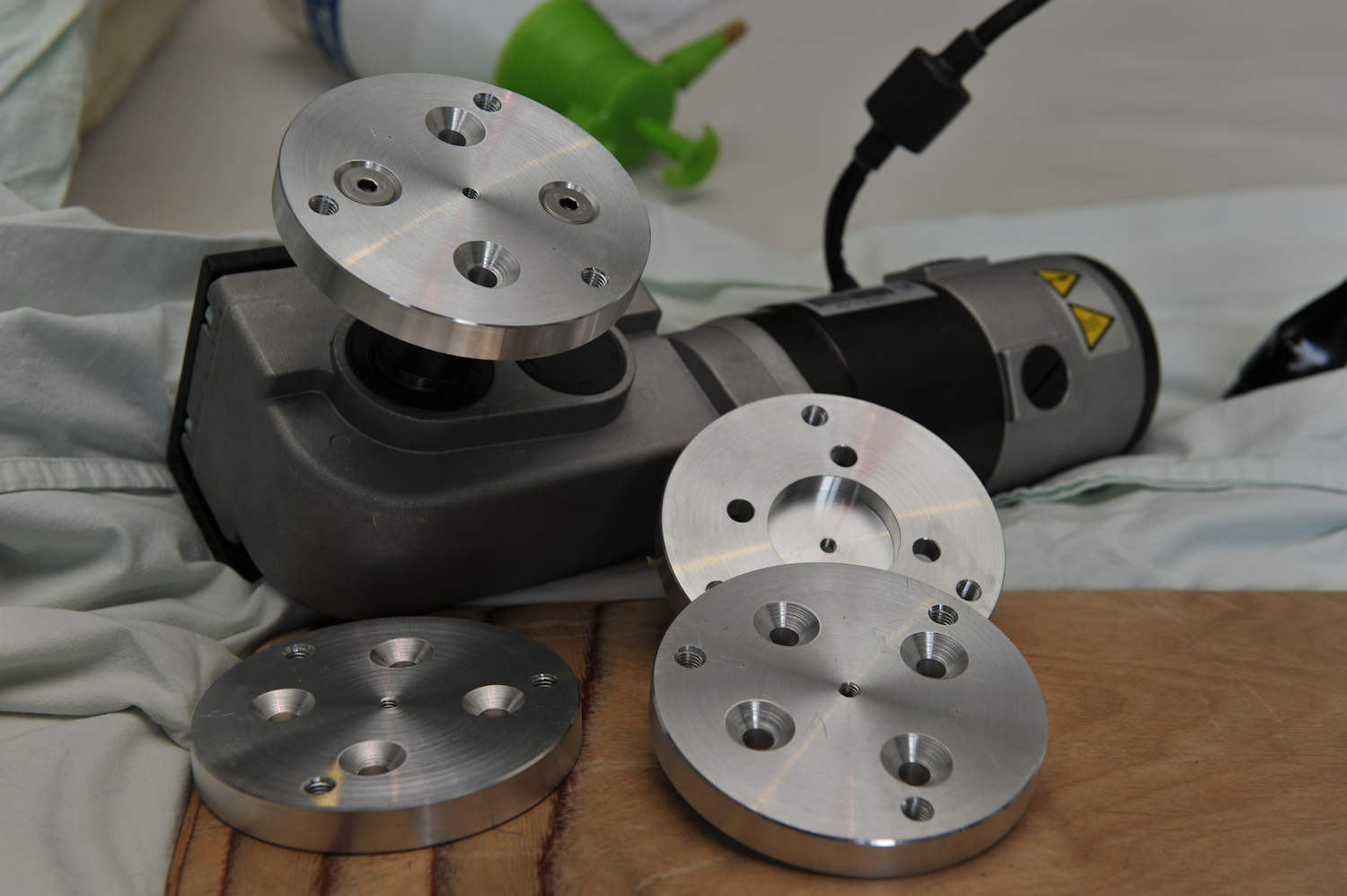

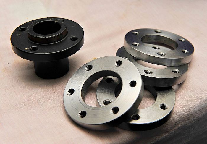

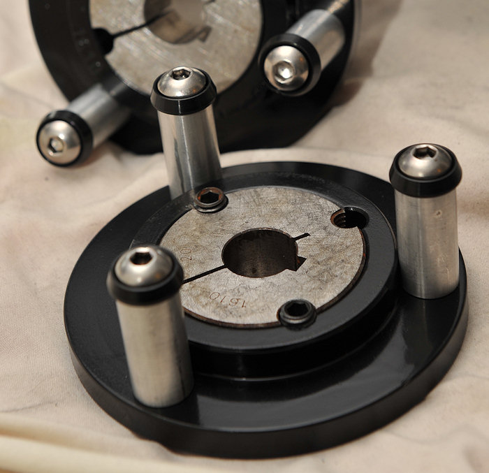

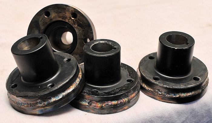

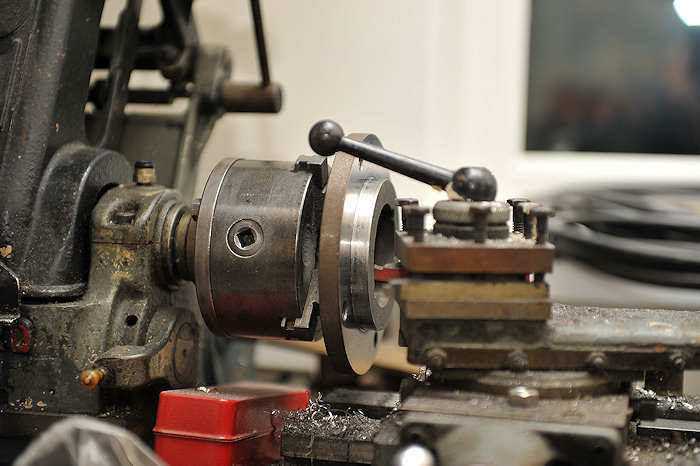

I fitted non stock rims to every chair I ever had. Always quite easy really. You can make adapters by ordering blank laser cut disks and drilling/countersinking a few holes for e.g.

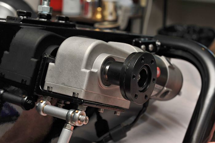

Heres some shirley hubs, for the rear drive Dietz chairs.
Heres some I made for the salsa. BM2, BM3, other chairs and rims...
by ordering disks and drilling/tapping on my bed... Or whatever.
made on my lathe as a bolt on adapter
ordered alloy disks and drilled tapped on my bed...

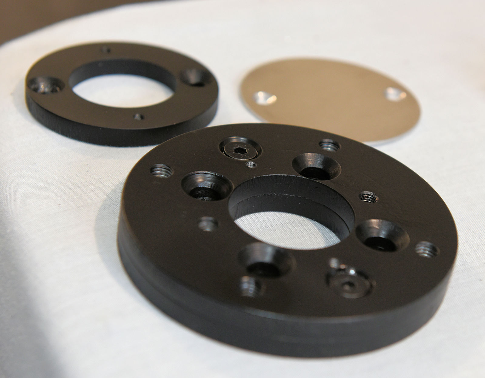

Made by ordering steel "rings" online and drilling. Tapping. Then welding to existing hubs at college...
Now welded
Now fitted and painted.
Machined from TAPERLOCK pulleys on my lathe
That end up like this!
Laser cut disks before drilling etc to make adapters.

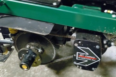

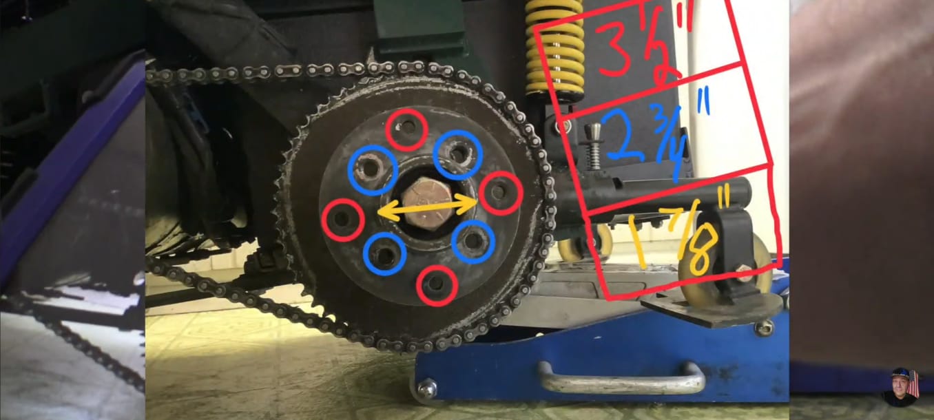

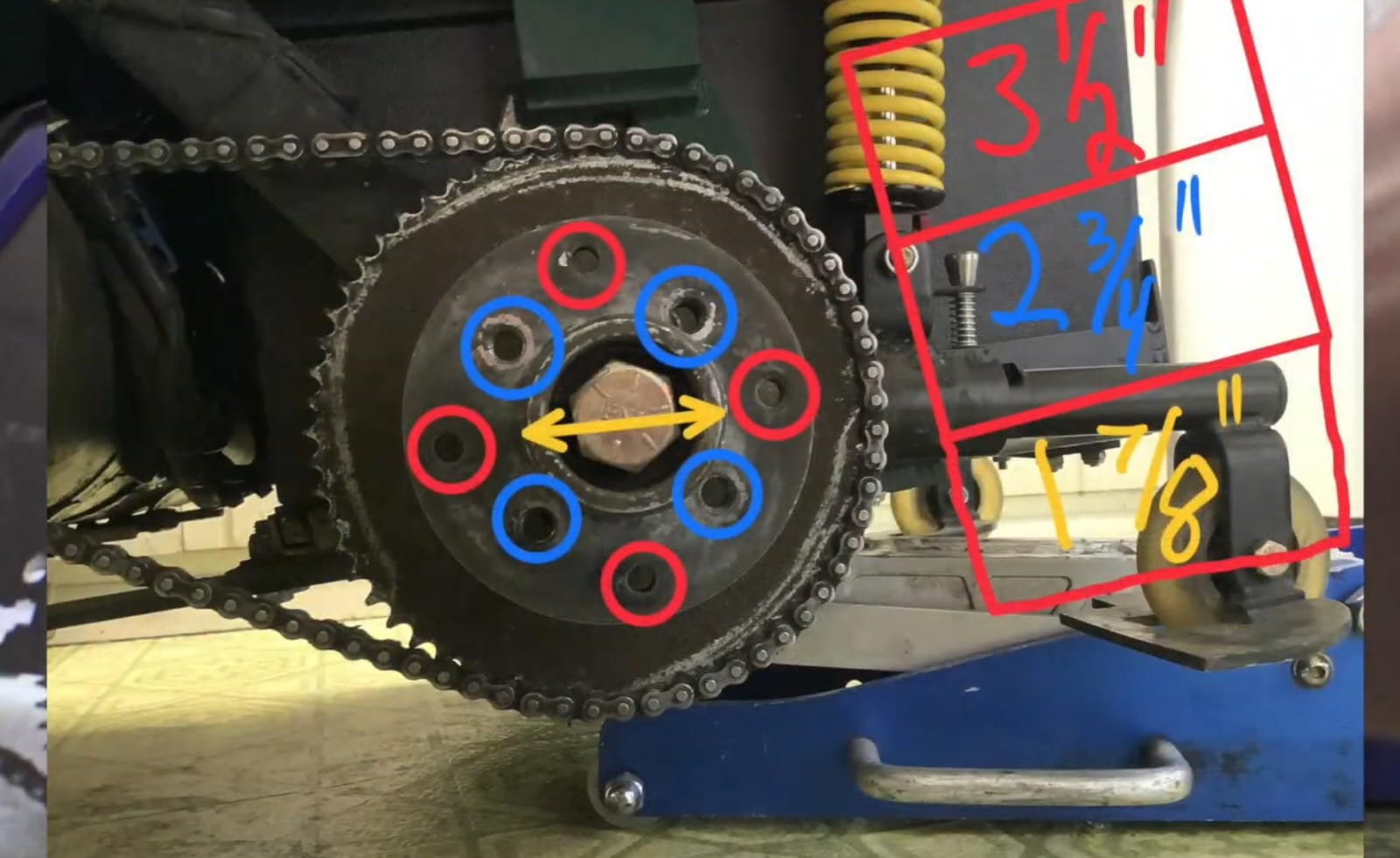

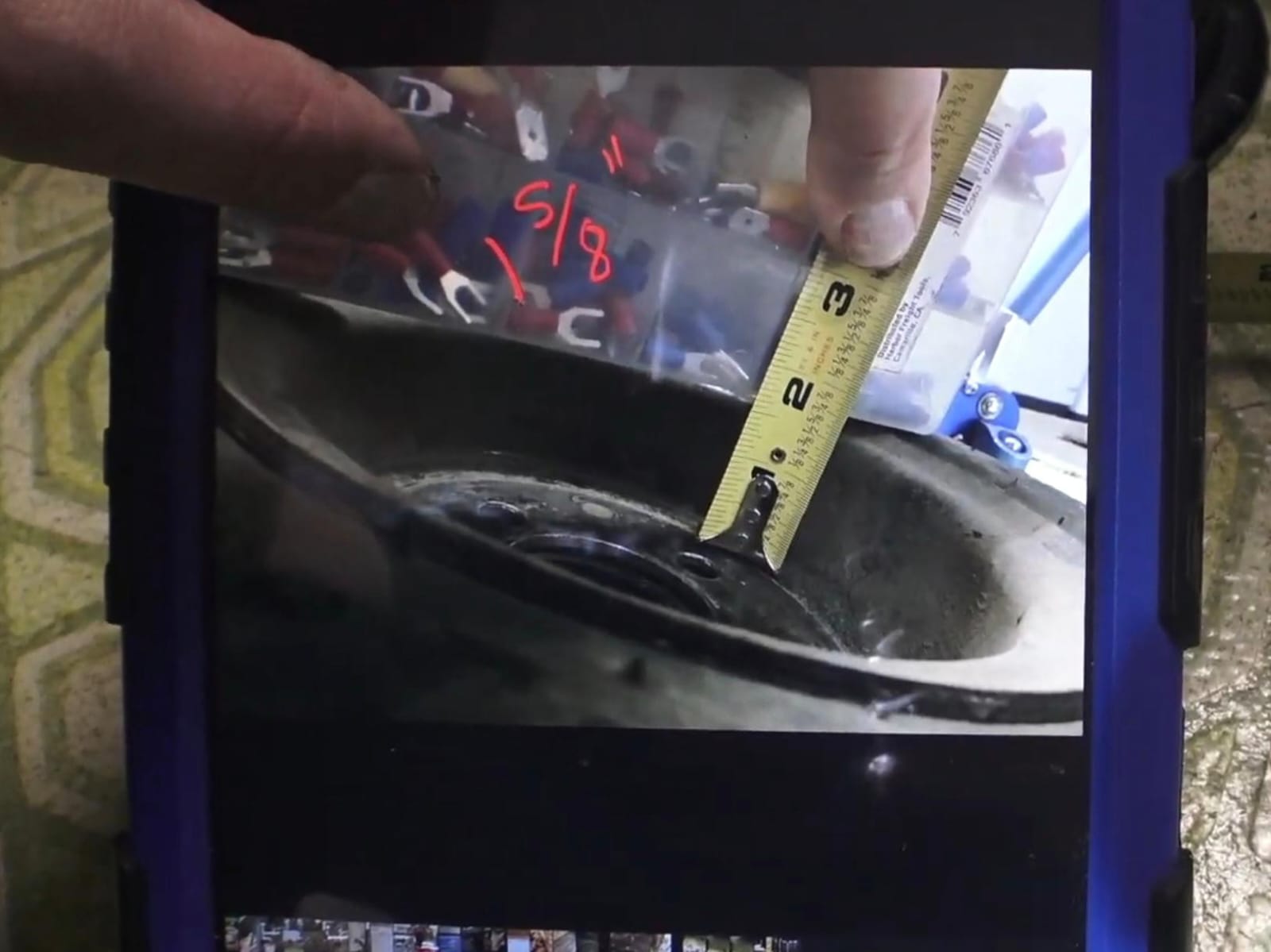

Postby shirley_hkg » 23 Nov 2025, 05:19
Here are the measures from volgger Totally Normal.
The depth from top to mounting face is 1-7/8" need to be addressed.
Need rims have offset around 60mm in order to accommodate a transfer plate added.

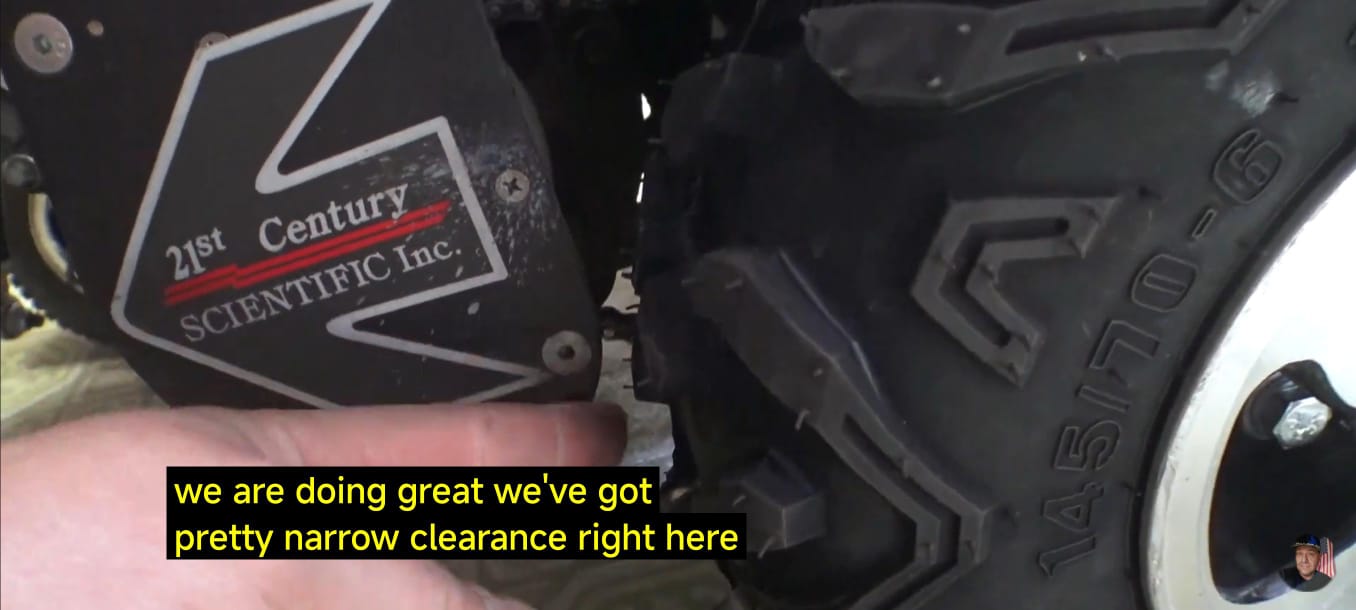

Postby shirley_hkg » 23 Nov 2025, 05:31

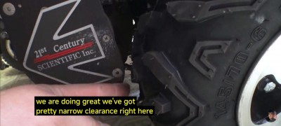

One more thing to note. Spoket cover is sticking out, that limits the diameter of tyre.
Re: 13x5 rims for Bounder

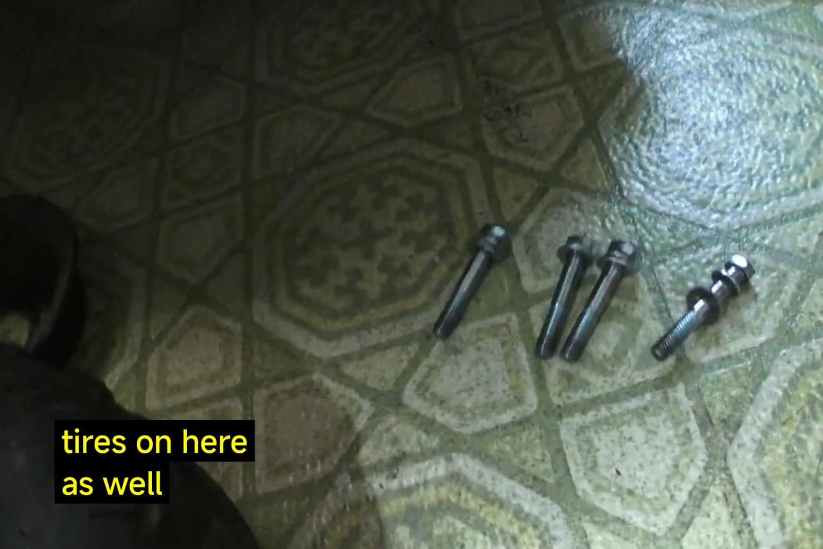

Postby shirley_hkg » 23 Nov 2025, 05:46
And wonder the sizes of these bolts too, 5/16" or M8.

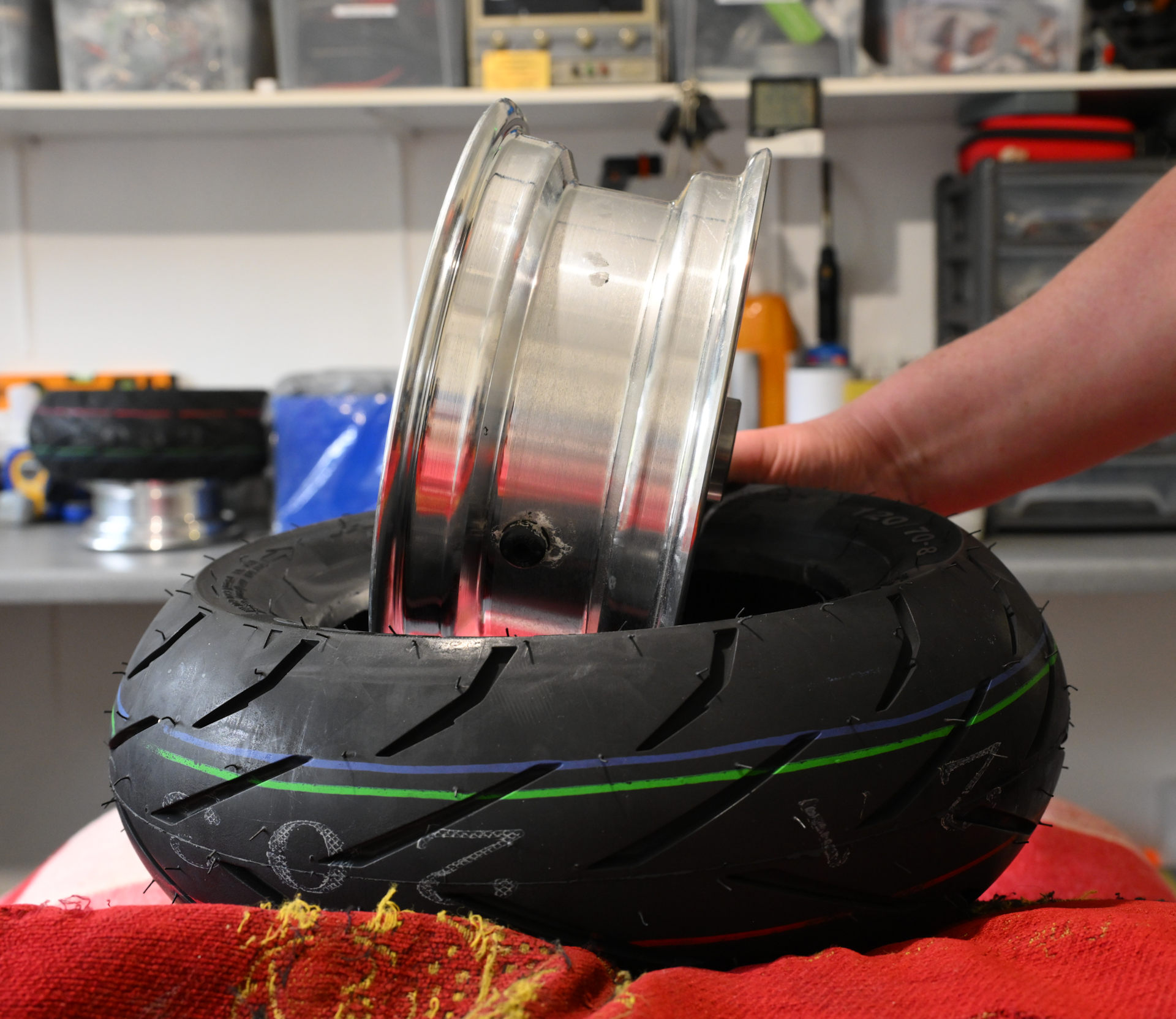

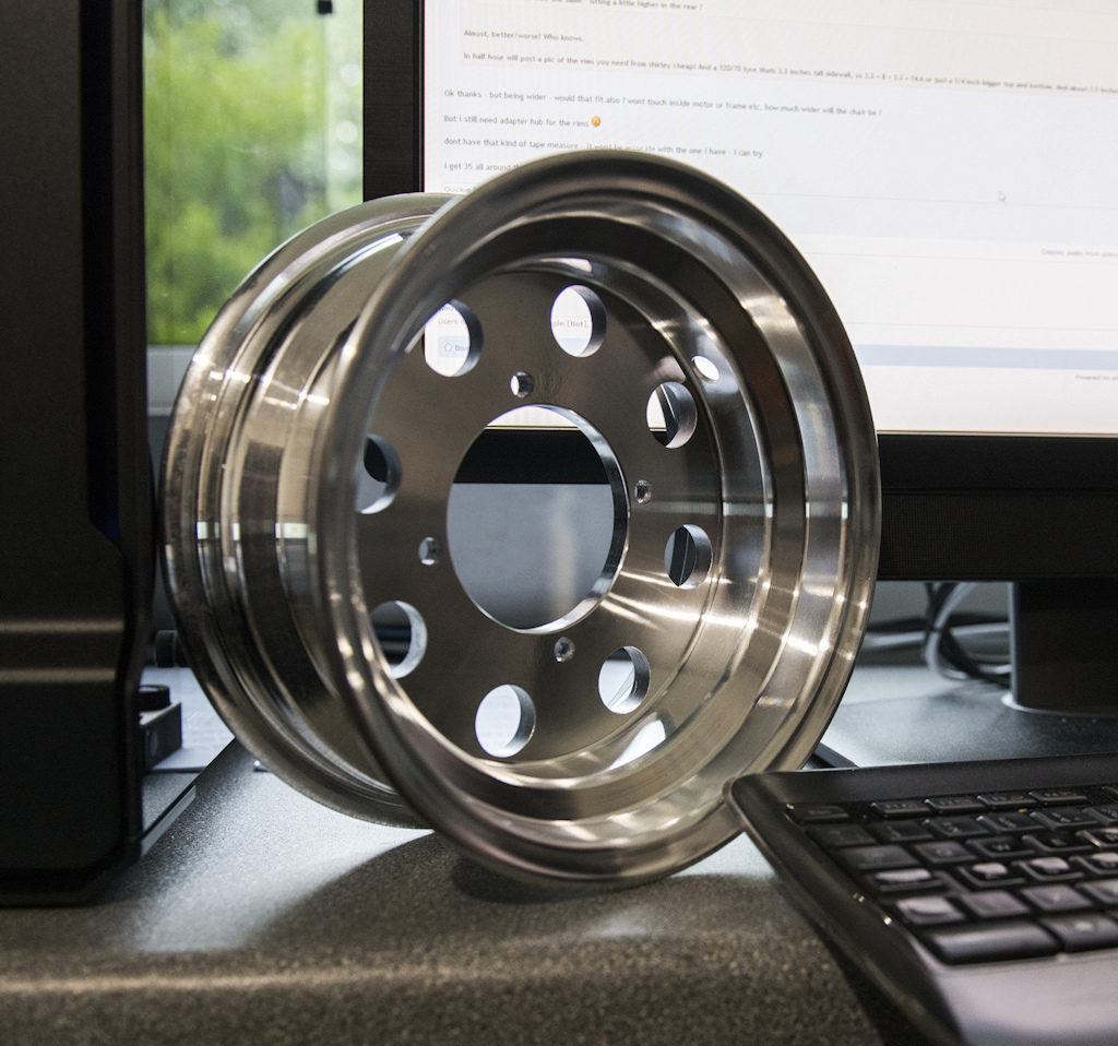

Postby shirley_hkg » 23 Nov 2025, 06:12
I found this rims seems feasible.
3 mounting holes @78mm eye to eye.
Centre hole 54mm.
145/70-6 tyre will measure 34cm big and 14cm wide, inflated @28psi.
Please advise and all inputs are welcome. cheers

Postby Burgerman » 23 Nov 2025, 10:18
Rims are measured in inches. diameters are full inches and refer to the "hole" in the tyre across the bead.
Rim width is measured in J meaning the gap the tyre beads sit inside so a 4.5J rim is probably about 5 inches wide overall due to the thickness of the metal where the tyres sit.
145 all terrain tyres should be about 8 psi?
What is the actual rim diameter in inches? Is it intended for 6 inch tyres? J Width? You need:
Width
4.5 inches for 145/70 - 6 tyres (about 14 inch or a fraction less)
5 inches for 15-6.00 - 6 tyres like the kenda reinforced ones or turf tyres.
3.5 to 4 inches for 120/70-8 tyres.
Posts: 70459

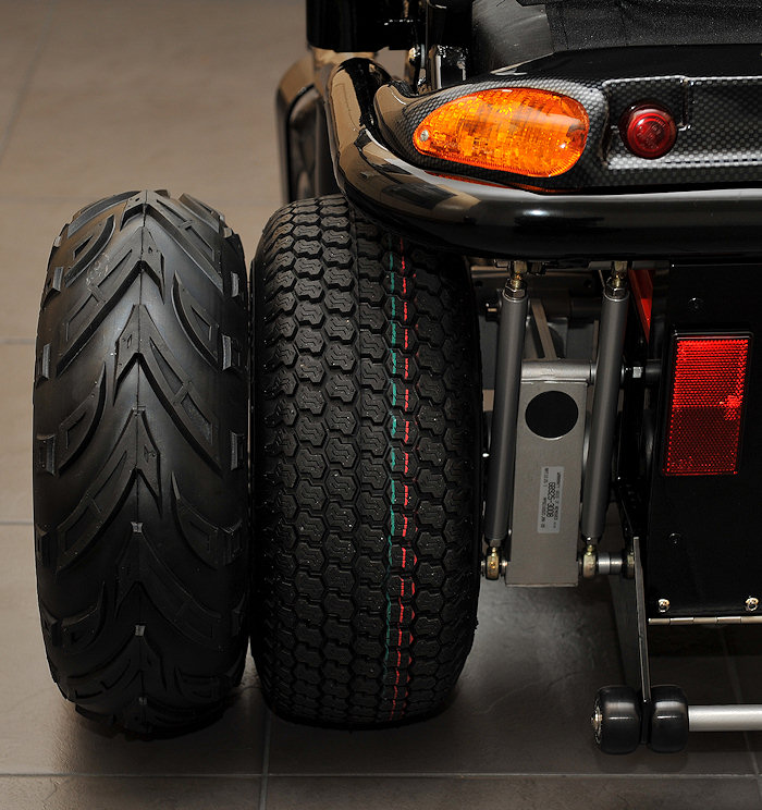

Postby Burgerman » 23 Nov 2025, 10:33
The problem with 145/70-6 ATV type tyres is that they feel "bobbly" as you roll. Which you learn to ignore.
But they last me around 1 month rolling in summer on hard surfaces like roads and footpaths. After 3 weeks they look like smooth lumpy balloons!
Thats why I swapped to the Kenda turf tyres that seem to last forever. At least a few years.
These last a month.
Feel lumpy!
Look great...
145/70-6 all terrain.
Posts: 70459

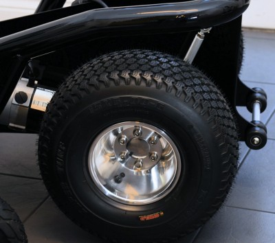

Postby Burgerman » 23 Nov 2025, 10:47
These can fit the same rim.
Last forever.
And are puncture proof.
These are
LEFT Kenda K500 K Shield 15 x 6.00 - 6 tubeless.
RIGHT any old 145/70 all terrain tubeless tyres...
Posts: 70459

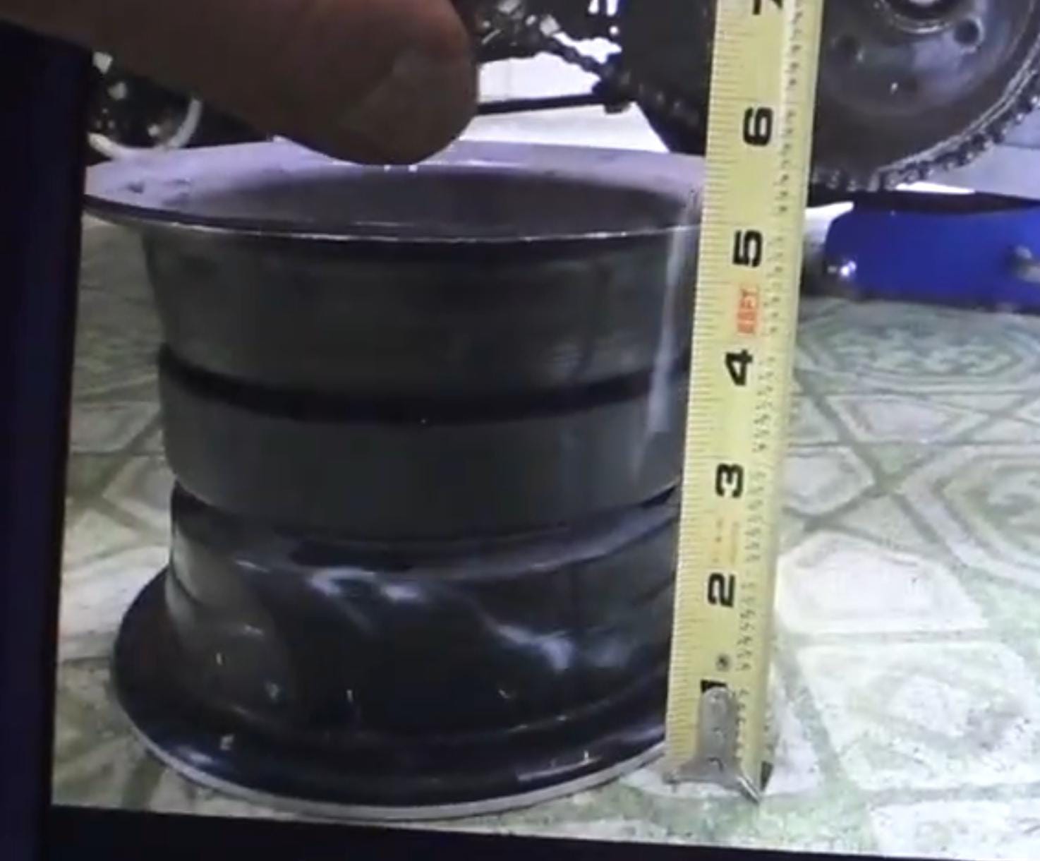

Postby shirley_hkg » 24 Nov 2025, 03:41
emilevirus wrote:So Shirley, would it be easier for you to find 8" rims?
You need a depth of 60mm from top to mounting surface (including transfer plate 8mm--10mm thick), or you will have to extend the track width.
Burgerman did me a favour to measure a 3.5J rims, which is 40mm only. So we are 20mm short, each side. 4.5J could be more than 40mm, but I am not sure.
Asked a dozen sellers about it, but no one answered.
May have to spend CAD $30 to find out ourself.

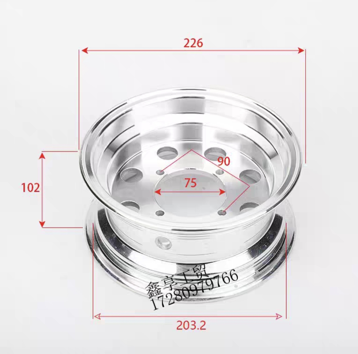

The whole hub looks.
Postby shirley_hkg » 25 Nov 2025, 13:47
Good news. A seller replied the depth of 4.5J is
50mm, very close to that of the original Bounder one.
It seems no transfer disc will be needed. Just need another set of holes, which match the stock ones, 4*∅5/16 THRU P.C.D. ∅3.5"
However, rims centre hole is 75mm. New holes are very close to edge.
If a 10mm transfer disc were deployed, track width would be another 20mm added up.
Postby shirley_hkg » 25 Nov 2025, 13:59
Really need advice of you guys expertise.
