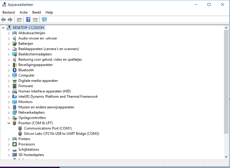

The USB/CAN device works and is reported as installed as COM3.

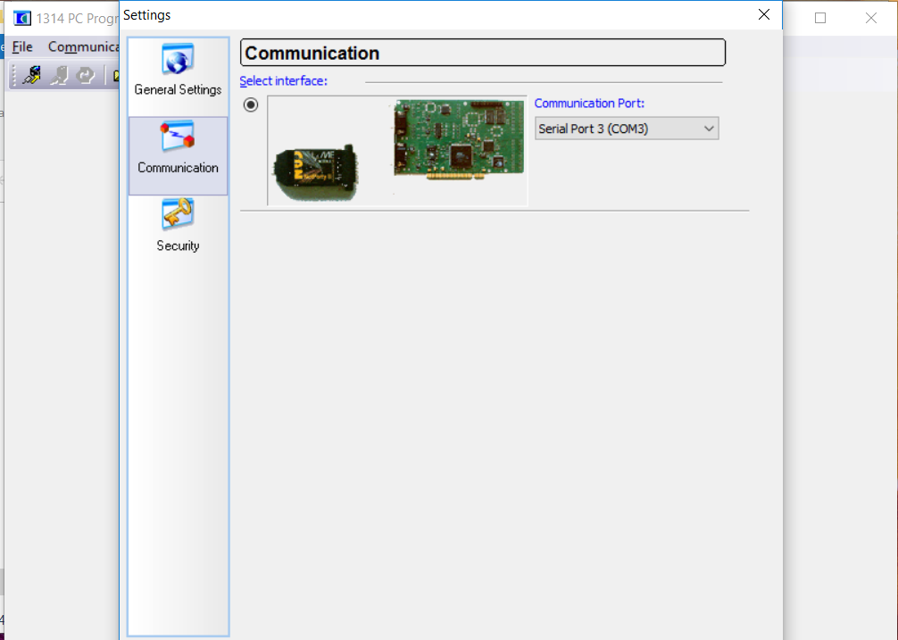

The Curtis SW seems to set the comm parameters.

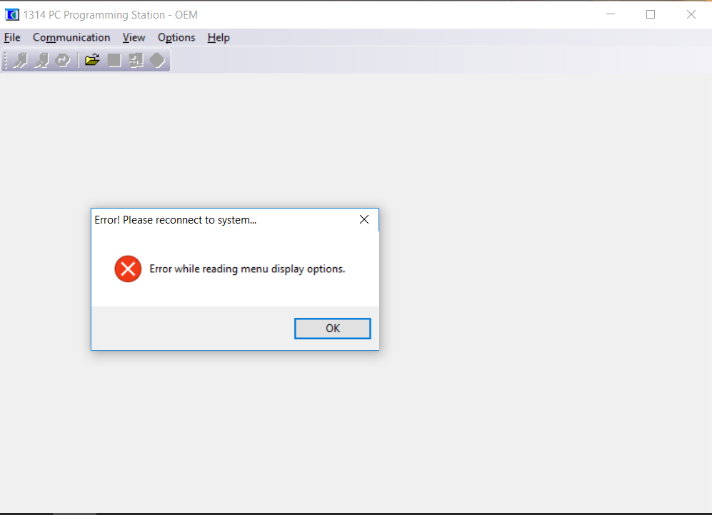

Connecting CAN H/L wires the wrong way around leads to "unable to find device" or something along those lines. With the CAN wires connected correctly I try to connect and get this message.
Is this the problem you were referring to woodygb?

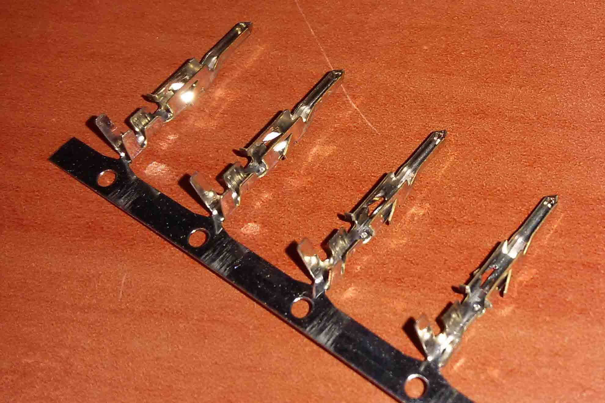

These are the pins I used.

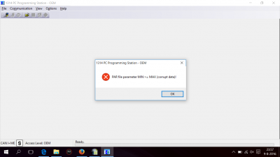

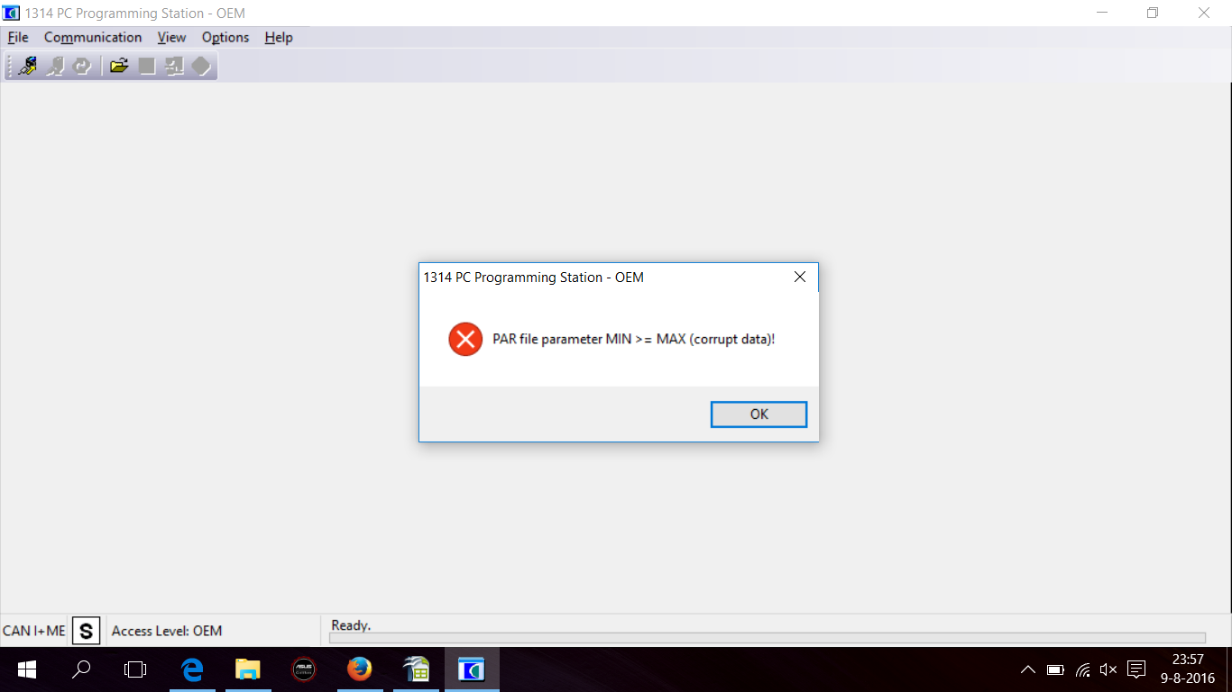

I saved the settings of my C2000 into a .par file using the 3.12 sw. While I can understand that the new sw does not want to communicate with my C2000 without the original cable, I was not prepared for what happened next. When I try to load the .par file into the new 4.6.7 software I get this error.
Any ideas what it could be? There are 17 pages of parameters to check!

Postby ex-Gooserider » 10 Aug 2016, 04:56
Guessing here - but what it seems to say is that some setting has a minimum value greater than what the maximum is supposed to be, so it assumes this means it is a corrupt file....
Two thoughts that occur....
1. Try down loading the file several times, see if you get the same size each time - if you do, run a checksum on each and see if they are the same - it is possible the file you tried IS corrupt....
2. Can you open and edit the file in the same version of the software you used to download it? It seems possible that the file formatting is different between the two software versions which would make the file produced by one version incompatible with the other version....

I have tried the newest (4.6.10) and oldest (4.2.0) version of 4.x software I have been able to find and effectively have the same problem as with 4.6.7. As soon as I try to connect I get a pop-up "Error while reading menu display option".
At the bottom of the screen it says "Building device menu of Powerbase 2AL". What is this "Powerbase 2AL"?
I connected again using 3.1.2 and it says I have a 1750-4403 unit installed. I googled 1750-4403 and could only find it mentioned in a Curtis document regarding RoHS compliance. In this document the full description of the unit is "1750-4403 POWERBASE 2AL". That is interesting! The 4.x software must have been able to connect to, and read from, my chair in order for it to know it was trying to build the device menu for the Powerbase 2AL!
@Woodygb: Do you think this is interface/cable related or could it be something else?
