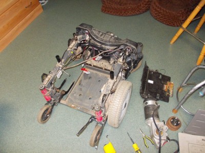

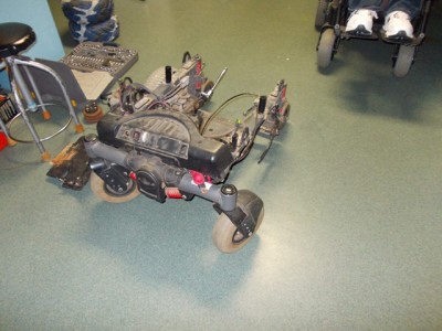

My first question is on solid mounting the motors. I know Burgerman eliminated the "suspension" parts and solid mounted his motors on his builds, but I'm wondering if there's any negative consequences to doing that? Will it put extra stress on the gearbox housing?
I've attached a pic to show how my motors were originally mounted, they have a single bolt pivot mount & a little gas shock that connects to the frame. The anti tip wheels are part of the same brackets. I was planning to solid mount the motors with some new brackets. & eliminate the suspension & add anti tips similar to burgermans.

Thanks for posting this, I always wondered how they were put together because back in the day it was touted as the mother of all powerchairs. I haveto say that I'm not impressed with that frame at all. Why are going to solid mount the motors?

rustyjames wrote:Thanks for posting this, I always wondered how they were put together because back in the day it was touted as the mother of all powerchairs. I haveto say that I'm not impressed with that frame at all. Why are going to solid mount the motors?
No problem! I wish I had more photos of the complete chair and the tear down process. I'll post what I have. It was touted as the mother of all chairs & was the reason I ordered it. It turned out to be nothing special. It was a decent chair, it never let me down or left me stranded in 10 years. I did like the independent front suspension and It was fast at 8.5mph, compared to any other chair I've used. But it was a pig on batteries, if you got into too much soft ground & tried to power through it, it quickly tripped the thermal protection & cut your available power in half & you'd end up stuck. It also had the finess of a WWI tank. But I now realize that was mostly the terrible programming & setup of the chair from the supplier. The seat frame was mounted as far forward as possible, very nose heavy. Wish I knew then what I know now! Would have saved a lot of walls & door frames, & my one & only face plant on a cement walkway! Lol
Well I need to lower the motor mounts to gain some ground clearance. Solid mounting the motors would simplify everything & eliminate the factory anti tip wheels & mounts. Not sure they'd even fit once the mounts are lowered.

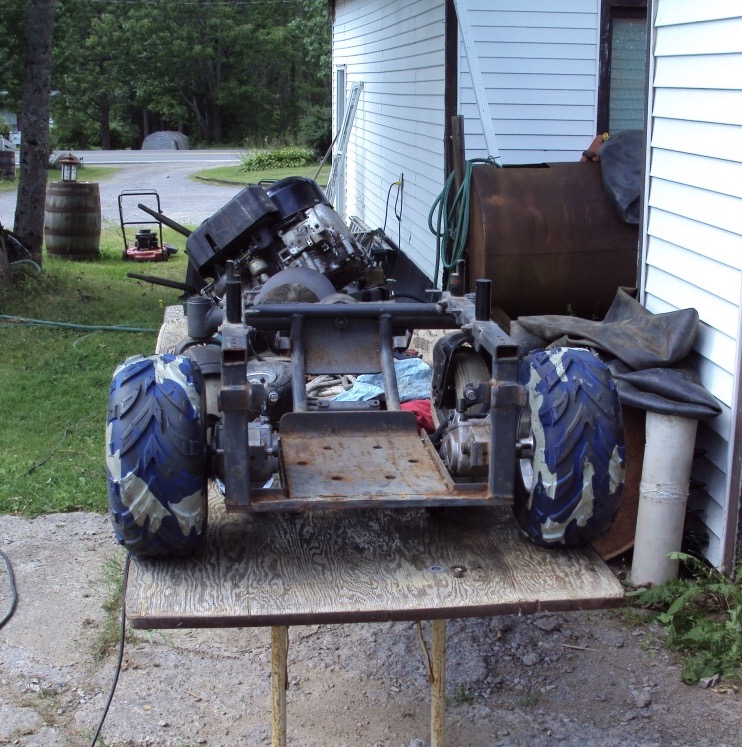

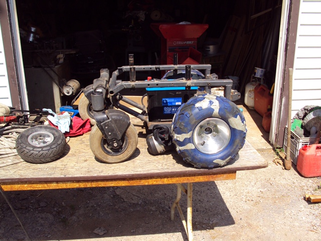

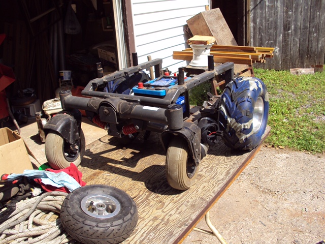

Here are a few pics of the wide atv tires & aluminum rims I had done about 5 years ago.

Postby Burgerman » 01 May 2017, 01:52
How wide is that?
Posts: 69903
Re: Quantum Blast 850 modification & rebuild
Postby hotwheels_75 » 01 May 2017, 02:10
Burgerman wrote:How wide is that?
Faaar too wide to fit through anything but a barn door. Lol around 32 inches with the wide tires, But it was just a test fit before cutting started. I have more pics of the modifications, but having trouble shrinking those ones down to meet the posting requirements. They're on my iPad, I managed to shrink the others, not sure what's wrong.
It should be under 27 inches when done.

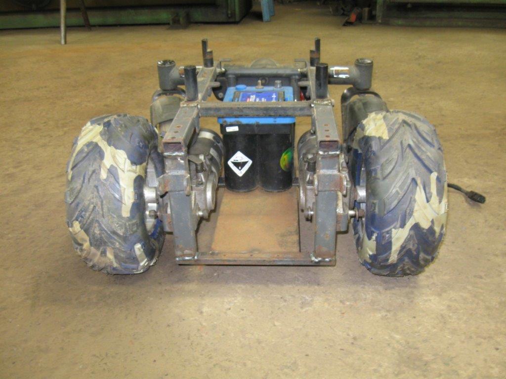

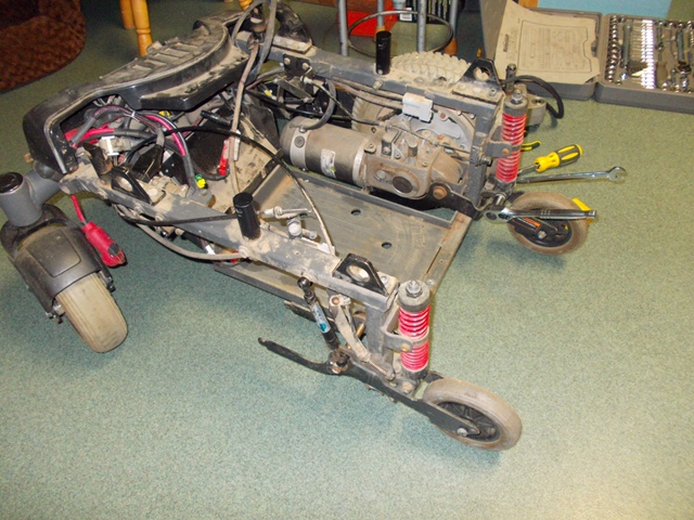

This is the result of narrowing the frame & extending the battery tray. The wheel width is just a hair under 27 inches. There's a bit of room to move the hubs closer to the motors & gain about 1/2 an inch.

Nice work, I like how you reoriented the battery area to make the chair more narrow.
Also, you should be able to stuff a good amount of Lithium in there now. :)

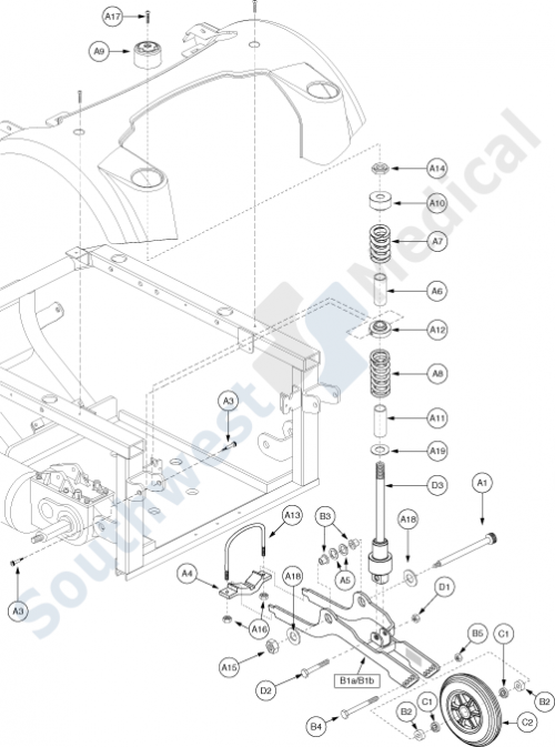

that's what southwestmedical is for.
http://www.southwestmedical.com/replace ... -blast-850

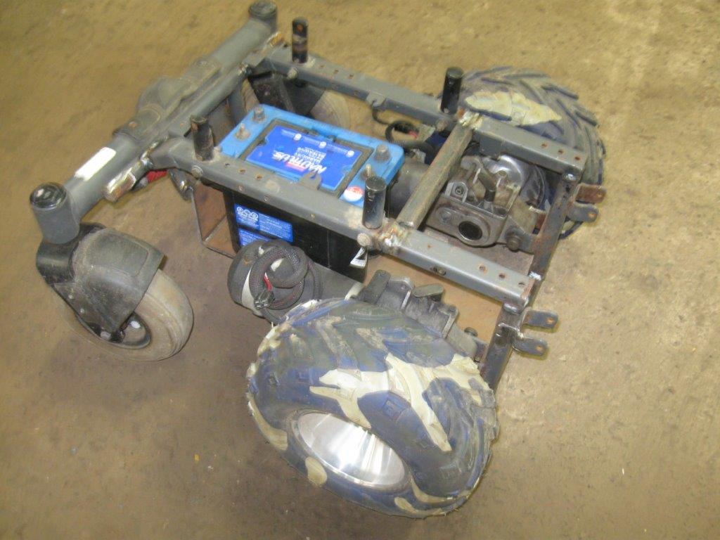

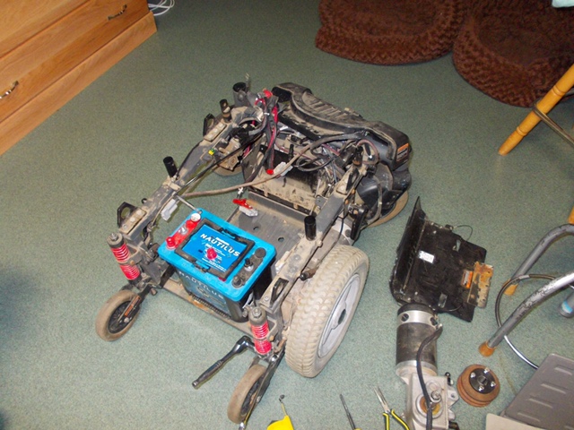

Here's some pictures of my frame modifications and new battery box
Note in this last pic the chair only has this stance because the motors are tipped down touching the floor & the back end is propped up. In order to maintain this stance the motor mounts need to be lowered which means I'll likely have to solid mount them & eliminate the factory rear suspension & anti tip wheels. Does anyone have any input on this?

Postby Burgerman » 02 May 2017, 21:28
Cant you get longer shox or extenders like https://www.google.co.uk/search?q=shock ... 88&bih=558
Posts: 69903
Postby Gnomatic » 02 May 2017, 22:19

Postby hotwheels_75 » 02 May 2017, 22:21
Burgerman wrote:Cant you get longer shox or extenders like https://www.google.co.uk/search?q=shock ... 88&bih=558
It's not those mounts that would be an issue. There's a bracket that attaches the whole anti tips to the motor & gear box & I don't believe there's room for them to go lower without hitting the back end of the frame. Hard to explain. This picture shows. Those atv tires are an inch shorter than the originals. So I lose an inch of ground clearance which only leaves about 2.5".
Would there be problems if I solid mounted the motors and eliminate their ability to pivot?

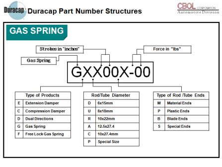

I think I ust figured it out thanks to Woody's post earlier, can't believe I missed it when I looked before.
Part Number DD1-.97MM-100... "D" Dual Direction, "D" 6 x15mm rod tube diameter, 1-.97 should be stroke in inches... bud that doesn't sound right, MM is steel shaft & rod ends & 100 is 100 lbs force. Definitely a lot further ahead now. But having a difficult time finding a supplier with anything close to that that ships to Canada. McMaster Carr does only for businesses & schools. I knew Mark developed the Blast, never thought of contacting him, will definitely keep that in mind!

Postby woodygb » 11 May 2017, 00:07
DD1- .97 MM - 100
I'd suggest that the hyphen denotes a break as it does before the force in pounds.
So ...stroke = 0.97 inch?
