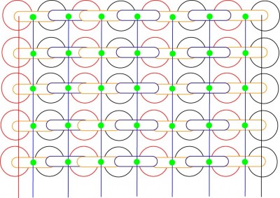

Postby steves1977uk » 19 Dec 2015, 00:47
This is my balancing wires diagram that I had to give the guy who helped to build my pack...
This is a 8s 5p pack, the green dots are the solder points for the balancing wires. Obviously each second one is on the opposite side. The yellow buss bars are on the top side and blue at the bottom.
Postby Burgerman » 19 Dec 2015, 00:55
You soldered them?
I just fitted ring terminals.
But that diagram would certainly confuse me! Its easier if you start simple as in my link, so you can see and understand where they go yourself.

Postby steves1977uk » 19 Dec 2015, 01:02
Yes, I thought that was the best way at the time so that the balancing wires couldn't come loose. But I agree your way is much better :)
