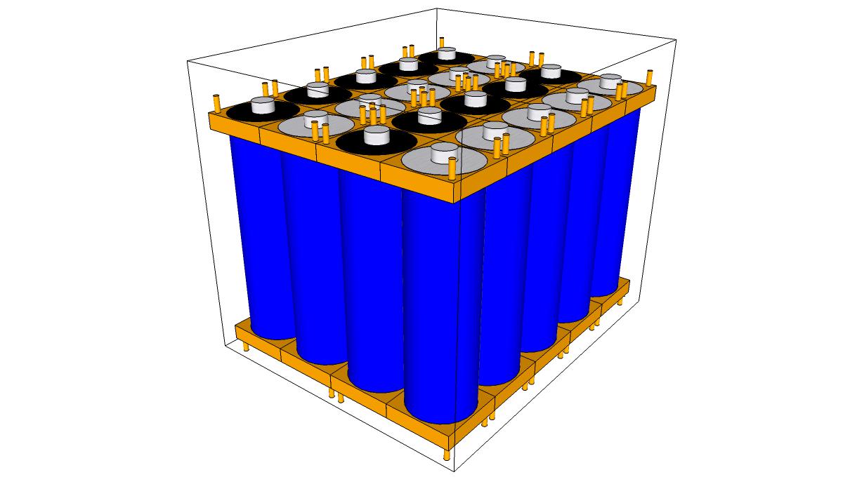

i though i needed - 15 buss bars to make this pack - like this - and if i want to add another 8 Cells to make it a 36ah pack - instead of two rolls - 3 rolls of Cells - then i would need 23 buss bars -
is that correct - ? because i may just have to place another order if i need more buss bars -
i am confused now - how do i need more than 15 buss bars ?

You are missing some of the bars on the other end of the pack pictured.
I counted again. The double row is 2P, 8S. Each of 8 Parrallel pairs requires 2 buss bars (one on each end)... That's 16. Assembling the series requires 7 more buss bars additional. Which means 23 buss bars total for the double row. The double row will require 8 orange blocks.
(Double row 2P, 8S requires a total of 16 cells, 23 buss bars, 8 orange blocks)
To build a 3 row 3P, 8S. That will require 8 more cells, 16 more buss bars, 4 more orange blocks. You reuse the 7 series bars from above.
(Total 24 cells, 39 buss bars, 12 orange blocks)

OH - I think i get it now - both rolls of Cells top and bottom get connected with the buss bars - thats 16 bars - - then in series 3 extra bars on top and 4 on the bottom - Red marks in the picture show -
making it 24 buss bars - so i am short buss bars even if i get the shipment from EV - which means i have to place an order for just buss bars from the other site here in the states - but should wait to see if EV ships it out or refunds me -

you know what - i will just order the normal 2 hole buss bars - i have 19 - i need 24 ? i can order a few extra also - and a few orange blocks for the 15Ah Cell - i want to check my box with those just to double check - i will post pics later - i checked my chair last night -
Short story - 6 x 6 12ah cells - CAN Fit if you do some work and then NO ROOM for Wiring etc, - its very very tight - i will show the pics later - so i think best bet may be the 15Ah Cells - one large flat pack -like Scollard suggested -
giving me 90ah - a little less - but i have the room on top to connect wires and be able to slide the tray in and out easily - will sit in the same tray as the MK are now - and be neater i think than it is now -
i show the pics - i spend a few hours last night - checking and looking and trying - i am sure YOU BM would make it fit - cut this or remove that etc, - but i cant get too much into modifiying things that way - i am luck i can the ADD on done with help here - never mind the whole pack with work being done to the chair itself
but i show you in a few - thanks for the update on those plates - and EV is shipping it UPS now - i may get it next week - PayPal worked - :) they offered me $38 off the next order - its not alot - but well see - i will close the case with paypal once i see the tracking as shipping with a due date - till then i leave the case open - they got on it fast once i started the case with Paypal
