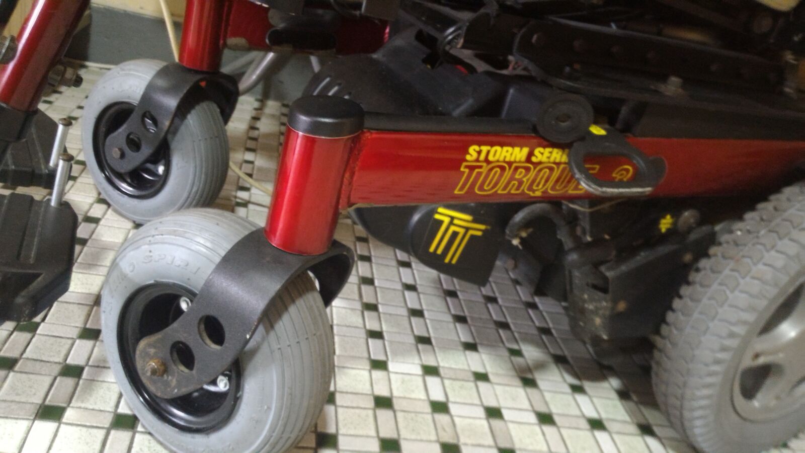

Postby snaker » 22 Jun 2016, 01:32
expresso wrote:but also the bigger front tires may hit my foot rests ? thats another thing i cant know for sure -
My chair have 10inch casters. I can see some advantages when climbing up curbs or slopes. But they also cause troubles. The casters hit my heels when moving backward. And the chair is harder to control in narrow spaces. Maybe 9inch casters are more suitable for my chair. Unfortunately, the chair's front height is not adjustable, changing casters will require some modification.
Posts: 1259

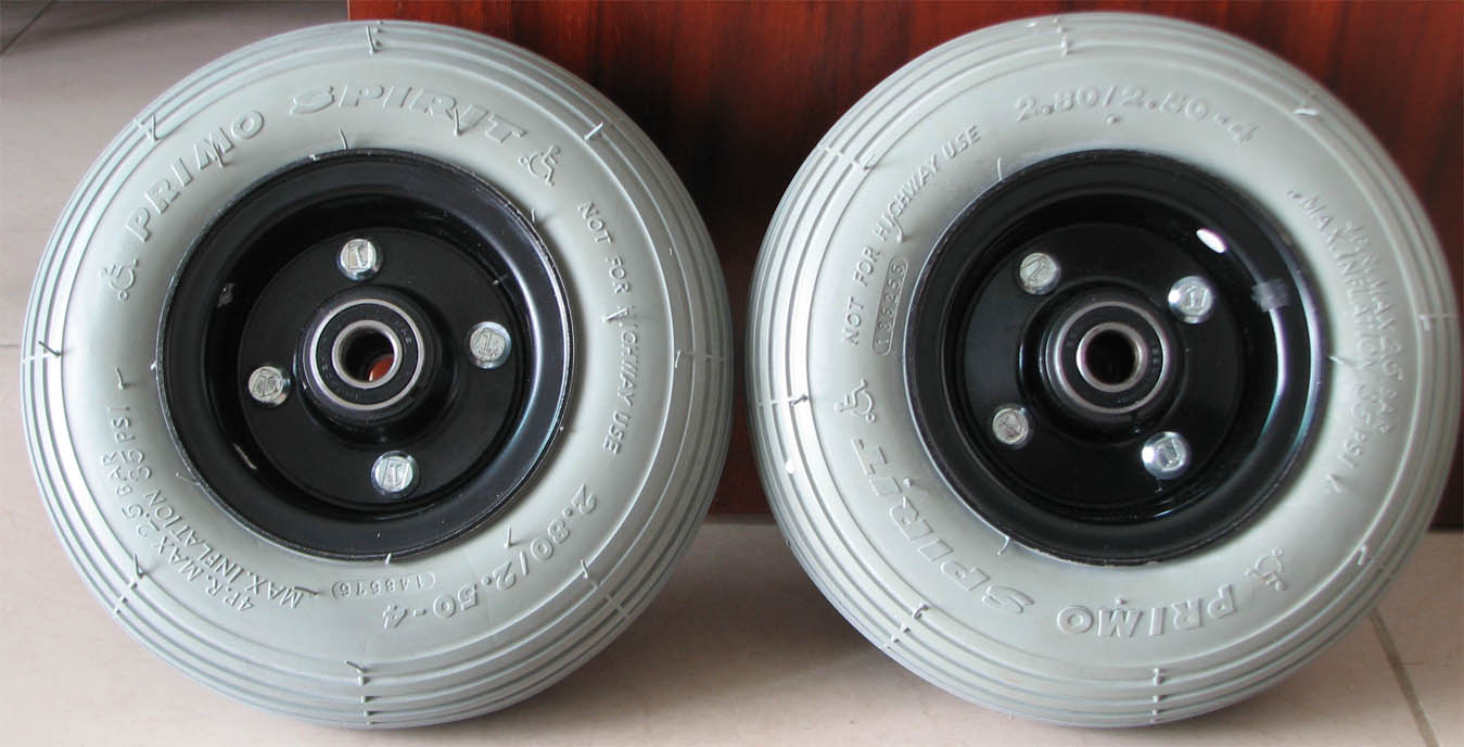

Postby shirley_hkg » 22 Jun 2016, 02:45
:D I'd recommend 2.80/2.50 - 4
Most of us find this adequate for urban use.
Posts: 4657

Postby Burgerman » 22 Jun 2016, 06:52
Not enough sidewall for my liking!

Postby expresso » 22 Jun 2016, 16:00
Yes your right snaker - they will be too large on my chair and will hit my footplates - etc, - as it is now - its close - not much room left to use larger casters - even the original 9 x 3 from sunrise may be a issue - but those would be the ones i would try if anything at all -
invacare chairs may be different and BM dosnt use swing away footrests etc, - to its not a problem for that type of setup - also BM will make it work one way or another with modifications - which its not going to be the case for me -
i dont even think if i find the groove model casters would work for that reason - too large will hit footplate - i am just exploring the options - not sure if its worth investing in that chair - curious to see how it would feel - - i will try to start the process for a new chair - which i can the get the 10 x 3 caster with 9 x 3 tire - and try that with out the suspension forks - -
i kinda of feel that if i change this pilot chair to the fixed fork - larger tire - it may get rid of that banging noise coming from that side fork - maybe - at the same time i can try the larger tires - with Air ?

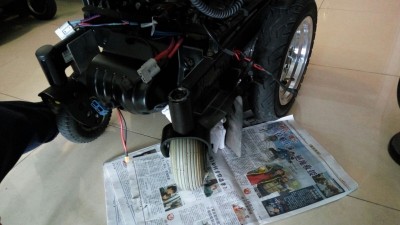

Postby shirley_hkg » 23 Jun 2016, 02:47
expresso wrote:
i cant have a Air fill tire alone with inner tube - i will get flats for sure - and will be Long way from home - during my trips - i see the bikes riding - carrying extra inner tube around there neck body in case they get a flat -
Looks like you didn't explore your chair much, though you have been on wheels for over a decade. :lol:
Do yourself an experiment. Drive your chair on sidewalk to attend the curbside at an angle, so that you stick one caster out in the air. :P
Rock your chair and see if it holds in position on its 3 other wheels.
Mine's does, and BM's does, because it is designed to carry load on the drive wheels, not the casters.
That demonstrates you can round the world with ONE caster. :lol: Why worries can't go home with a flat front caster ?
Experience told me that you wouldn't notice a flat caster for days. However, you will be alerted of that when you attend turns at speed. The opposite drive wheel will lift a bit, and you feel loosing traction.
I didn't recall I had 2 flat casters in one single trip . Do you have one to share , BM.? :o
Posts: 4657
