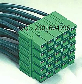

Postby Burgerman » 13 Jan 2016, 16:46
http://www.connector-techals.com.au/dat ... rsonr1.pdf
12V - Yellow
18V - Orange
24V - Red
36V - Gray
48V - Blue
72V - Green
80V - Black
96V - Brown
120V - Purple
144V - White
I use grey for everything. That way I can charge chairs from cars, vans, vans from chairs, power mowers, inverters, from chairs/vehicles, start vans, run my drill, swap batteries, join batteries, connect to solar system, or any so far un-thought of combination as and when needed. EG When we had a power cut as they were resurfacing the street, I plugged my electric bed into my power chair directly, and ran an inverter to power my bedroom lights from my spare batteries just by plugging in. Right now, I am using a 12V soldering iron, directly from my chair.

Postby Burgerman » 13 Jan 2016, 16:56
The single PP75 ones are NOT the same. You can connect a blue to a red etc. But it still identifies it.
The PINS (contacts) are exactly the same so use either. But I would use a 50 because you cant plug it in backwards...

SB50, black and grey are compatible with each other, that you can plug them together at least.
Red does not.

Postby Burgerman » 14 Jan 2016, 11:17
PP75 connectors can be connected to any alternative colours (can be useful or dangerous depending on user and usage) and are much easier to connect and disconnect for some reason compared to the dual SB50 ones... But are also less secure. They are very easy to knock and undo if a cable gets pulled for eg... I use a small cable tie if its mission critical/out of reach.
