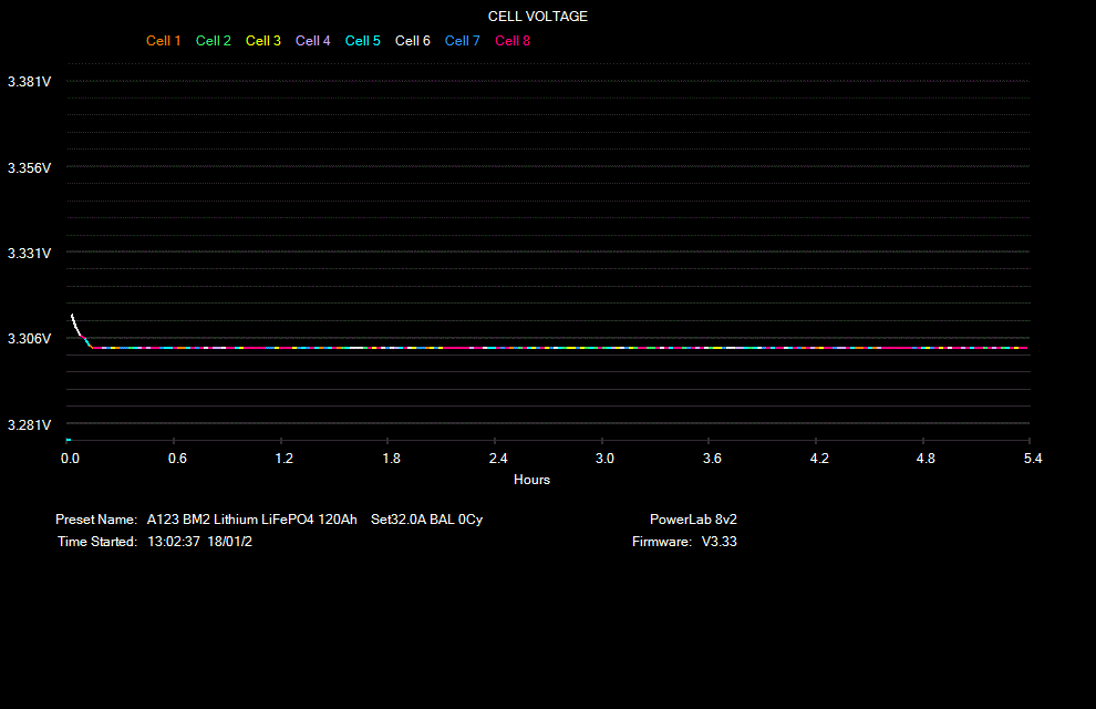

For all those that want to know why you cant measure state of charge by measuring voltage...
This graph shows a powerchair pack being discharged for five and a half hours, at 4 Amps continuously on my PL8 hobby charger... So far.
Its already had a previous 10Ah removed, and during that time the voltage sat at 3.305 Volts exactly, across all cells. Now, another discharge session for a further 5.4 hours so far shows it is STILL at exactly 3.305V per cell. And showing no sign of dropping yet. Nor will it for another 5 hours at least. Then it may drop by 0.001V or not...
Voltage CANNOT tell you how charge a LiFePO4 call is.

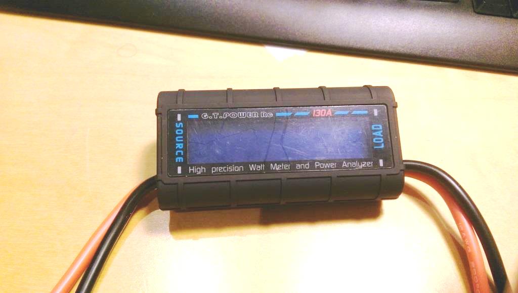

Postby Irving » 18 Jan 2016, 20:34
Two of these turned up today, at just over £6 each inc P&P it seemed silly not to. Will get some Andersons put on them. They are the same as the Turnigy ones but branded G.T.Power, took 6 days from China.
Postby Burgerman » 18 Jan 2016, 20:39
I have a few. Some on solar panels, some on powerchairs. Very enlightening. You need an extended cable or two, so you can watch as you drive. If you put one on a motor cable you should see a massive Amp difference.
I use my clamp meter. Motor amps read 100 while the battery reads 40 at low/stall speed. On a hill its the other way around.

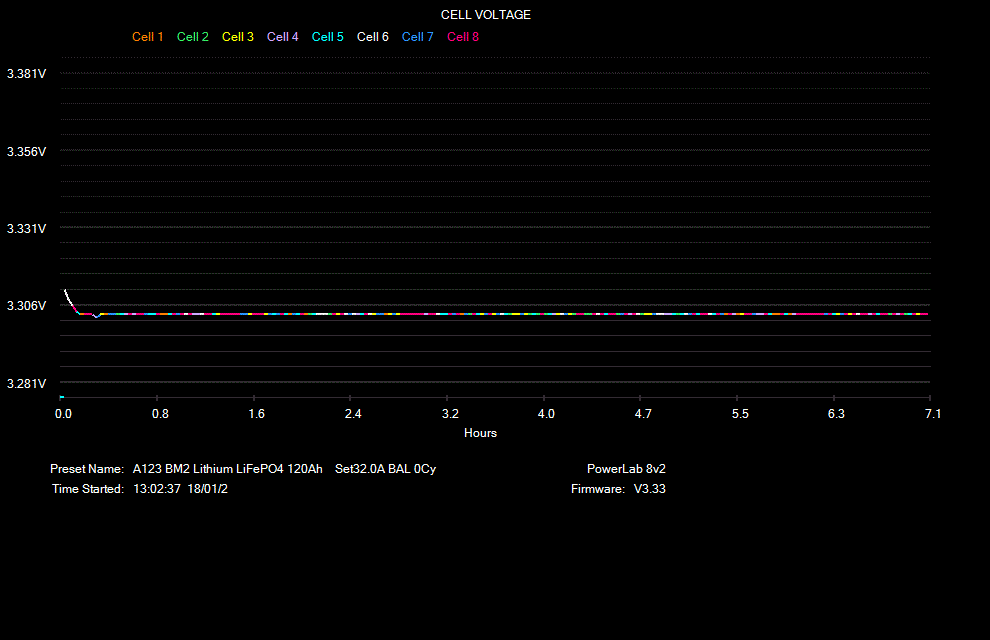

Postby Burgerman » 18 Jan 2016, 21:26
7.1 hours and still no change. 28Ah out (plus original 10Ah) and still no voltage change.
