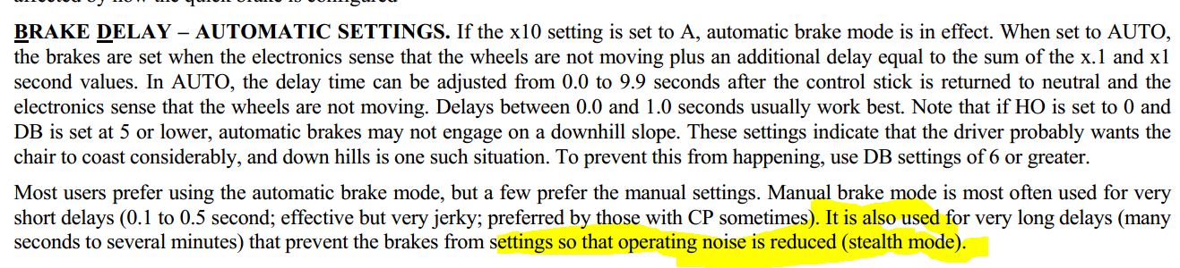

Postby Frank » 25 Jan 2021, 15:30
I mean delay of the brakes on the motors. This can be useful for indoor use to avoid a lot of clicking noise.
Frank
Posts: 94
Joined: 09 Sep 2020, 11:17
Location: Malta
Postby rover220 » 25 Jan 2021, 18:52
Frank wrote:I mean delay of the brakes on the motors. This can be useful for indoor use to avoid a lot of clicking noise.
less useful on a steep hill outside

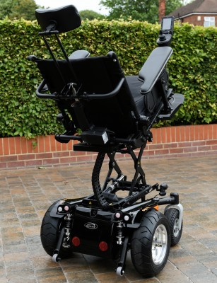

Postby ex-Gooserider » 26 Jan 2021, 01:49
Looks nice...
Rather than anodizing the silver arms, have you looked at powder coating? Might be less... Or take them to your local autobody shop and get them hit w/ 2-pack paint.... Or there is always the 'instant anodizing pen' - better known as a "Sharpie" :lol:
One question about the smaller casters and bigger rear tires - it looks like this has made the caster barrels have a bit of a rearwards tilt... Is this going to cause a problem? In general how big of a concern is a few degrees of tilt forwards or backwards in the caster barrels? I know the ideal is vertical, but is less than say 5* likely to be a problem?
Postby Burgerman » 27 Jan 2021, 16:57
Its hard to see. Maybe 1.5 to 2 degrees? Cant tell at all when in use just drives normally. Dont think its very critical. Doesent stay at 0 degrees anyway its front suspension moves around.

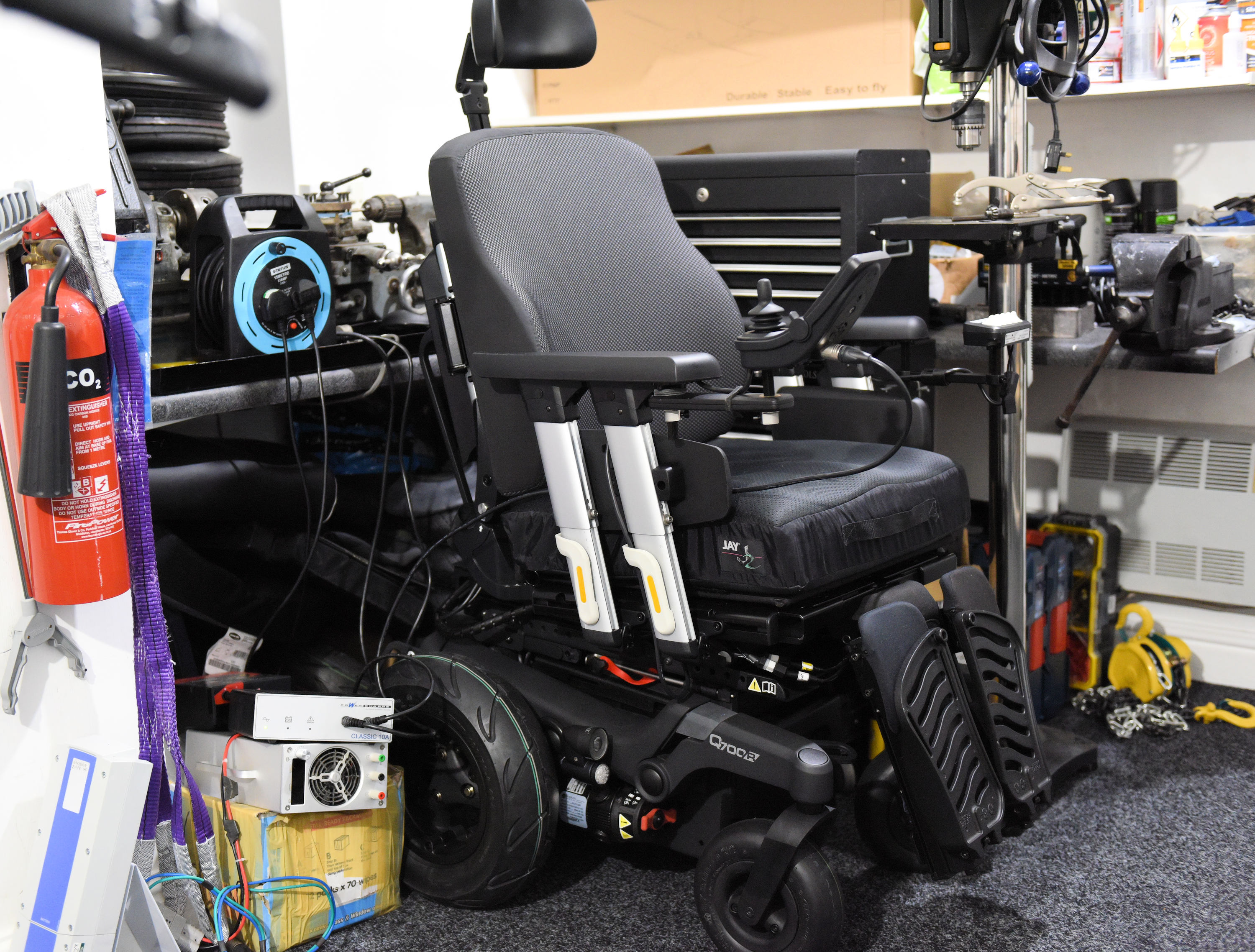

Postby greybeard » 02 Feb 2021, 17:32
Hi BM,
I'm having problems getting the adjustment of the centre power footplates right on my WCS Q500. I recall you mentioned that for various reasons you also prefer to drive with no tilt. Have you found a way of doing so on the Q700 without the footplate bracket or the bottom of the chrome tube hitting the ground? Ideally I would like the seat bottomed out and almost parallel to the ground but to do that the footplates need to be sticking out the front farther than I would like. Am I missing an adjustment somewhere I haven't noticed?
Postby Burgerman » 02 Feb 2021, 17:58
I havent looked at a Q500R other than in pictures.
Can you send a GOOD CLEAR bunch of photos?
Seat angle. Do you want any seat dump when its at its lowest tilt angle? I like mine around 5 to 6 degrees. So I lowered the tilt completely, and added the seat dump I needed by undoing the 4 bolts that hold the seat on and adding 4 spacers. 2 very short ones and 2 whatever length you need to get the angle you prefer. Is that what you mean?
Did you remove the tyre guard/fenders and fit the smaller 8 inch front tyres?
If you do then everything should work much better than the swingaway ones. If your seat cushion and seat length adjustment is like mine 20 inches. If its shorter you mah need to move the seat forwards from the rearmost position.
Posts: 70440
Postby Burgerman » 02 Feb 2021, 17:59
What chrome tube??
Look closely at this.
Seat is at the rearmost position, 4.5 inch thick cushion.
Footplate angle and height, and seat dump angle is exactly how I drive it.
Seat tilt angle is shown at it most downward position. And seat lift at its lowest. Footrest angle is correct and doesent touch tyres at any position. Theres at least 4.5 inches ground clearance on lowest point of footrest, maybe 5 inches. I am 5' 10".
download/file.php?id=14813&mode=view
If you need greater seat height, you can raise the mounting at both ends on the seat tilt/lift module. All this stuff should be done for you by WCS...
Posts: 70440
