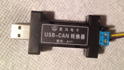

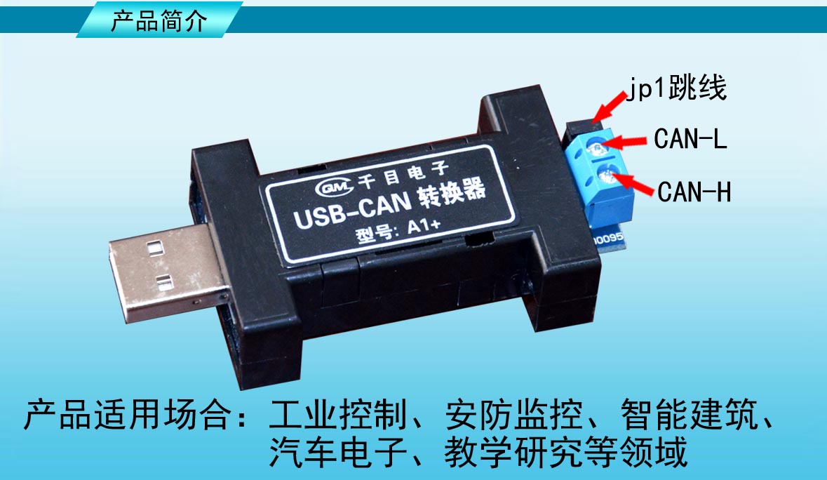

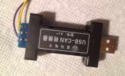

Hi woodygb thank you for every thing,
You mentioned there are two versions of USB-CAN, can you find out what kind mine is from the pictures attached?
Or how to find out it?
Best
Adam

Postby woodygb » 11 Nov 2017, 13:52
Original QM type ..see logo just above the word USB.
This requires the original QM_USB.dll
LMDZ Version ...this requires the LM_USB.dll to be used ..download ... https://1drv.ms/u/s!AkMTZUw5KF1egimcMDZXrJjPRJ5x and rename it QM_USB.dll

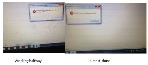

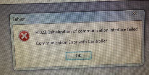

Hi woodygb thanks,
My USB-CAN is the second one, and I renamed the DLL, installed SETUP.EXE and copied the dlls, then hook up the two wires to the chair, when I used the 1314-4402, which may have no complete install? at least it's Options has much less items see pic.1. but the 4402 did some thing when click connect, see pic.2. almost done but stopped at any reason see pic.3 please.
As 1314-4401 has a more formally menu look like, but never do any thing and just say initialization error see pic.4, can you help what's wrong I am doing here?
Sorry the bad pictures.

Postby woodygb » 11 Nov 2017, 21:33
Have you followed this guide for the 1314-4401 and selected ALL the correct Coms options?
viewtopic.php?f=2&t=1965&st=0&sk=t&sd=a&start=216#p26731
With the 1314-4402 you will need to select the correct serial port number and MASTER MODE in Communication

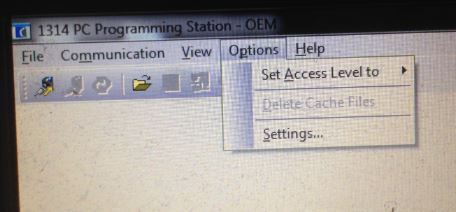

Hi woodygb thank you,
Your word is a miracle, the device manager set the com 5 and the 1314 cached com 5, just no work before, now works after reset them.
I attached pictures here, can you tell me what should I do next to:
1. download the software to my computer;
2. overcome the red 'STOP LIGHT' on my joystick, some one said can ignore the tilt?

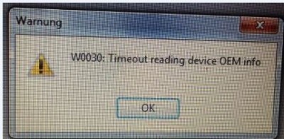

The last post is just hook up the power module, without the Advanced Actuator Module, here are pictures with AAM see picture conn_3 .
Seems I can't do much, I clicked [system/device parameters], it run a while and then error window out. see picture conn_5.
what can be the reason?

Re: Q logic/Curtis Cable end
Postby woodygb » 11 Nov 2017, 22:58
Not sure.
Can you save and send me the par file?

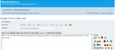

Postby woodygb » 12 Nov 2017, 15:11
BTW ...You can take screenshots by pressing shift and Prt Scr together on your keyboard...then pasting the result into M.S. Paint and saving....like this.

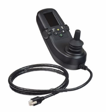

Do you know the 6 pins wire out of the Q6 joystick?
Best
Adam
q6 joystick.JPG (19.78 KiB) Viewed 9202 times
