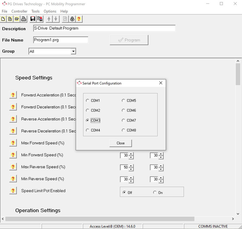

Hi guys, I’m trying to troubleshoot my Pride Pursuit XL. I’ve replaced the S-Drive controller and it still doesn’t work. I’ve made a USB FTDI programming cable, downloaded the programming software and FTDI driver, verified that the computer is seeing the the cable in Devices, Bluetooth & Other Devices as ‘TTL232R-3V3’, in PC Mobility Programmer I’ve selected COM3, I have the other end of the cable plugged into the S-Drive 200 amp controller and the scooter is turned on, there is a solid power indicator (not flashing codes). At the bottom RH corner of the screen it says ‘COMMS INACTIVE’ and the read/write arrows are grayed out. I’ve tried using a 33k resistor, a 47k resistor, no resistor and have not had any luck so far. The cable is a TTL-232R-3V3-WE from Digital-Key, the diode is a 1N4007-T and I’m using the Molex Jr plug wired per the drawing posted. Any help on this would be greatly appreciated.
Chikinhed
Posts: 10
Joined: 01 Aug 2020, 08:41
Location: Vancouver BC
Re: Programming cable specifically for S-Drive controllers
Postby woodygb » 09 Aug 2020, 14:33
Difficult to say from here ... BUT ...it will not be the PGDT Software.
It could be the FTDI Driver installation.... you seem to have eliminated that.
You could try a direct connection to the 4 pin Molex ..with just TX , RX and GND. ( try swapping over TX and RX if you do not get any luck )
Postby Chikinhed » 09 Aug 2020, 19:18
Thanks so much for the advice Woody, I’ll give it a go this afternoon.

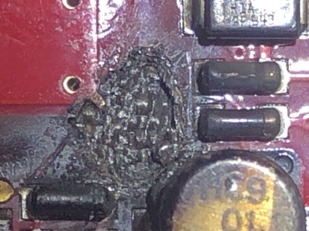

Postby Chikinhed » 09 Aug 2020, 23:05
The original S-Drive controller had a burnt spot on the PCB through a couple of layers.
Postby woodygb » 10 Aug 2020, 11:52
I suspect an internal inhibit fault ( inhibit pin shorted to GND ) as the S-drive powers up and the mobility scooter will not drive AND it is not possible to communicate with the controller ... NOTE that comms is via the inhibit pin of the 4 pin MOLEX.
Stick a multimeter between the Inhibit and GND see if you have a short.

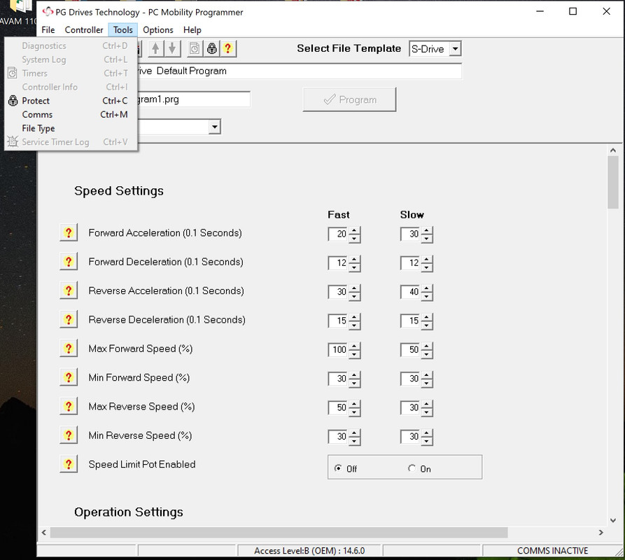

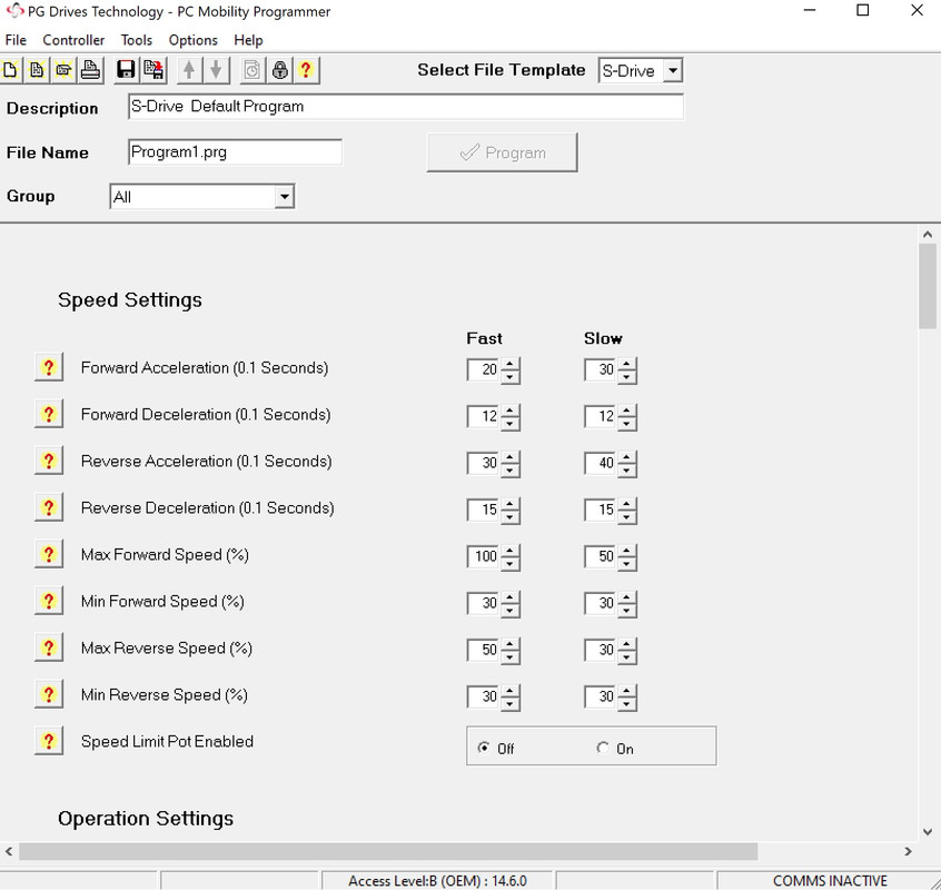

Postby Chikinhed » 11 Aug 2020, 21:00
I got the scooter going. I had to disable Inhibit 3 and invert the throttle. This is with a D51448.06 S-Drive II 200 amp controller instead of the D51460.07 that was in it. Thanks guys! :clap
