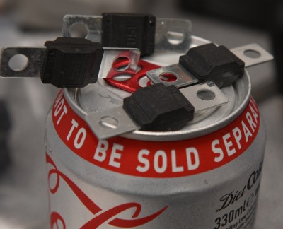

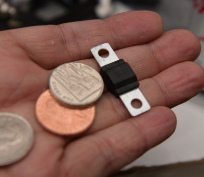

Postby Burgerman » 06 Jan 2016, 14:47
These are the very small 150A fuses (also in 40, 60, 80, 100, 125 etc) that I ue on charge leads, and also on battery looms on powerchairs.
They can be bolted. 5mm hole. But they need drilling slightly in most cases to 6mm. Takes a second to do. Why use these small ones? Because its also extremely easy to solder them. And because they fit into a bit of heat shrink in say a charge loom, and take up little space.
These are 150A ones:
http://www.ebay.co.uk/sch/i.html?_from= ... E&_sacat=0
