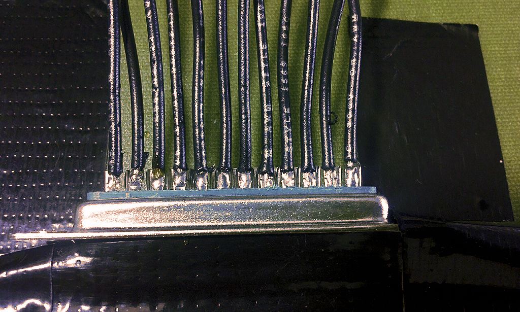

Postby expresso » 10 Mar 2016, 22:16
Back at it today - two more connectors - back on my computer desk - i find it better here then my table - not sure if its an improvement today - cant say its worse - nor too much better - i feel better at getting the first row of wires on -
not perfect but feel better doing that - its when i have to do the next roll behind the ones i did already - hard not to touch everything - and mess it up
here as some pics - what do you think ?

Postby Burgerman » 10 Mar 2016, 22:59
Perfectly good. Try the bigger wires.. They are slower and need more solder and heat but same principle. Your bench is starting to look pro!

Postby expresso » 10 Mar 2016, 23:19
i still feel its not good enough - i am worried when i have to do the row under the top row - i feel i can get the first 5 wires on top done - more practice but i feel a bit better to do that part now - i worry the last 4 wires under the top 5 - so close together -
the iron i have kept at 750 degrees - seems good but i do have to wait a moment to get it melted - not just a touch and its done - could be me also where i am touching etc, - i think i be better with the larger wire - i can take my time to tin it first etc, - no rush - will use a different iron tip and hotter setting -
adding the solder to the large cup - shouldnt be a problem either - right now - i feel the problem is more the 4 wires under the first 5 on top roll - and heating the cups to get the wire in there - i find it better to hold the wire with my hand -
just that its the same side i am holding the iron also - will do a few more - next week - during the week - i will try to secure it better also - so those pictures - would any of them have been good enough to really use ?
i will heat shrink over for a few reason - i feel it holds it together better - i feel safer knowing its not touching also - besides covers my messy work :)
one thing - when i do the real deal - should i be checking the wire before i add the heat shrink etc, - just in case ? and how do i go about checking it - in detail steps please - :D
