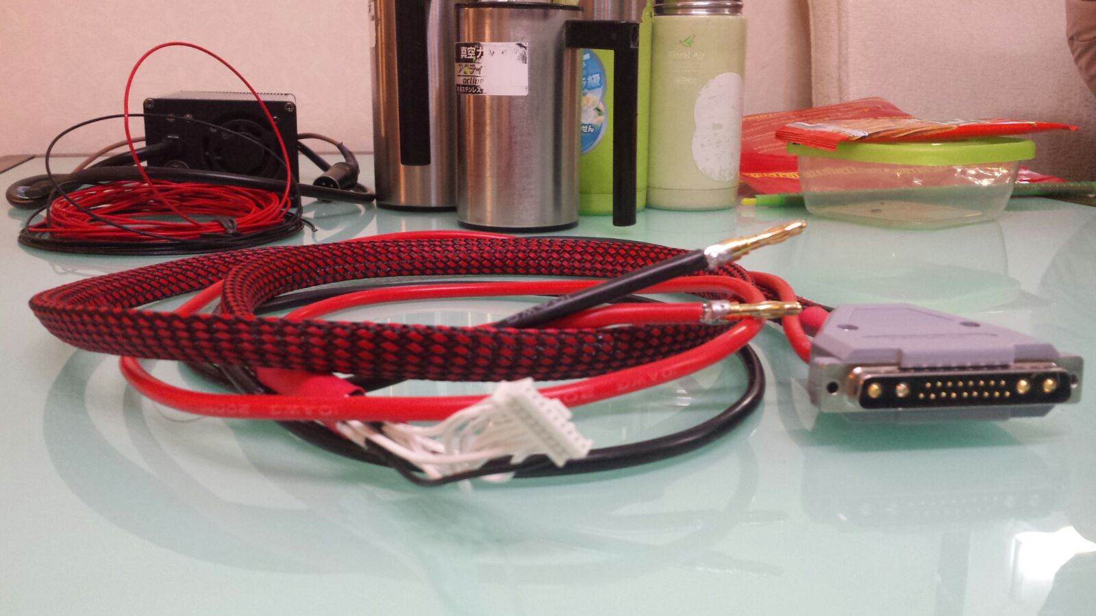

Postby shirley_hkg » 21 Jan 2017, 11:48
Finally , the first charge lead is made . It was very much time consuming than expected .
Postby steves1977uk » 21 Jan 2017, 14:13
Why didn't you use the safe banana plugs you can buy on ebay... http://www.ebay.co.uk/itm/291550725763? ... EBIDX%3AIT as these would be better. :)
You get lots faster! And neater. I did 4 now. Can do one in about 1 hour. Preparation is key! Or it takes all day and is frustrating.

Postby expresso » 21 Jan 2017, 16:34
shirley_hkg wrote: Finally , the first charge lead is made . It was very much time consuming than expected .
Looks nice and you got nice 10 AWG wire also - i just did another one finally as a spare just in case - its consuming thats for sure - 4 hours for me - i double check everything and slow to make sure - mines came out a bit shorter than expected - i must have extended the power wires on the first once i made to match the 36 inch balance cable -
this one i cut the balance cable to match the length of the power wires with the bananas -- which results in the cable being only 2 foot long -
