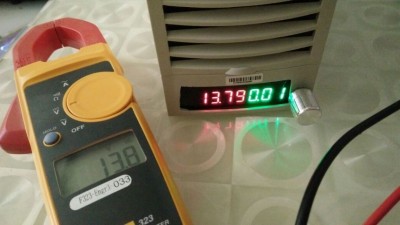

Postby martin007 » 05 Jun 2018, 00:01
You will need some ring terminals, to connect more securely at the rear, some cable, and anderson connectors etc to charge above 12A.
OK.
And you need care.
The Fluke multimeter will help me.
The volts in red and the amps in green?
Posts: 4033

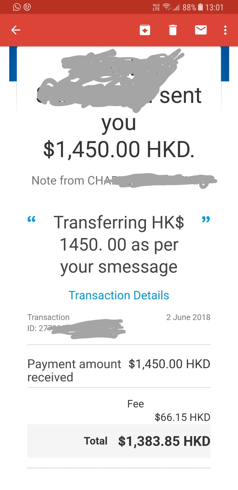

Postby shirley_hkg » 05 Jun 2018, 02:40
Paypal eats away 4.6% from every transfer . :fencing

Postby shirley_hkg » 05 Jun 2018, 03:30
It's calibrated and is pretty accurate for our jobs.
What BM means is to avoid messing the preset up inadvertently . So better take a glimpse of volt and amp before connecting to chair .
Doesn't need a Fluke .It's not rocket science . :dance
