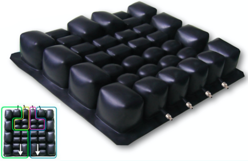

Does this type of cushion's material allow inflating while sitting on it?
I'm asking because for example, Roho's recommendation is to overinflate and when you sit on it, then release air from cushion to accommodate your needs.
I was lying on an alternating air mattress in hospital for two months and was a lifesaver because not all nurses know how properly turn quadriplegic. To avoid potential skin shear and pulling and various nurses turning skills, with alternating mattress I could be lying longer periods of time on either side with zero redness on the skin.
What I didn't like about alternating mattress is when you finally find a comfortable angle to fall in sleep, chambers take inflate/deflate cycle and my body totally change lying position + sheats are slippery on that kind of plastic rubber material.
And yes, the buzzing of compressor/pump drives me insane, especially in the night when everything is quiet.
Driven by logic, if the mattress is good then why can't be a cushion.
After flap surgery on left coccycyxcyx in 2016, I still have a great danger to destroy skin if I would sit 10 days for 12 hours. Now I'm sitting 6 hours max.
I have high Roho but tied down 4 cells to avoid direct pressure. The hole is filled with 5-6 cm of memory foam to prevent negative pressure to that area. For now, it works.

Very much. Its not about pressure at all. As long as its high enough to support your weight. Its about MOVEMENT. Its about supporting your weight on different points. Allowing the other areas, to have no weight half of the time. So that blood can circulate to those parts every few minutes providing oxygen and keeping the skin healthy.
You need enough pressure. But thats very low.
You need the supporting cells to be split into 2 groups. And these alternate allowing blood to get to the deflated half. Every few mins.
Pressure not at all critical.
What is critical is the time period. The more frequently they swap over, the better for your backside. Anything from 1 to 15 mins seems to work fine. Faster means more battery drain. Slower means more time on the high pressure bits, so more likely to cause sores. Its a balance. But my pump, has 24 hour capability so at 10 min interval, it can go for longer than I can stay awake.

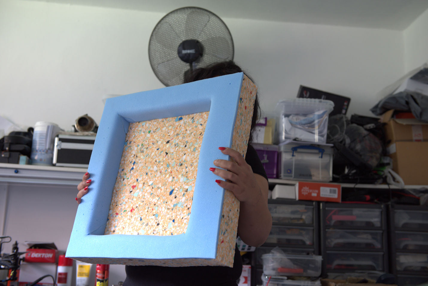

This is a portable digital, quiet, pump. Its not cheap. It is reliable, lithium powered, and quite small. It allows varied timer, and adjustable pressure, and runs for a day.
https://www.healthandcare.co.uk/pressur ... shion.html
Alternatively, buy this complete, throw away the hopeless foam part and make your own as I did in the right size from hard conglomerate foam made from glued particle or fragmented foam sheet.
https://www.healthandcare.co.uk/alterna ... shion.html

Yes. It works. Nothing else did. Way overpriced. I made my own cushion base as the one they supply is a joke. Read all thread.

Postby Burgerman » 09 Aug 2019, 15:31
Pics...
download/file.php?id=8874&mode=view
Get cut like this
download/file.php?id=8970&mode=view
Fix togetherLike this.. Blue is 6 to 8mm medium. The widest bit (front left nearet camera, is the front, under legs)
3 bits of foam.
Base 1 inch, hard foam.
Middle 2 inch hard foam, with cut out.
top, blue medium foam thinnest layer you can easily buy.
