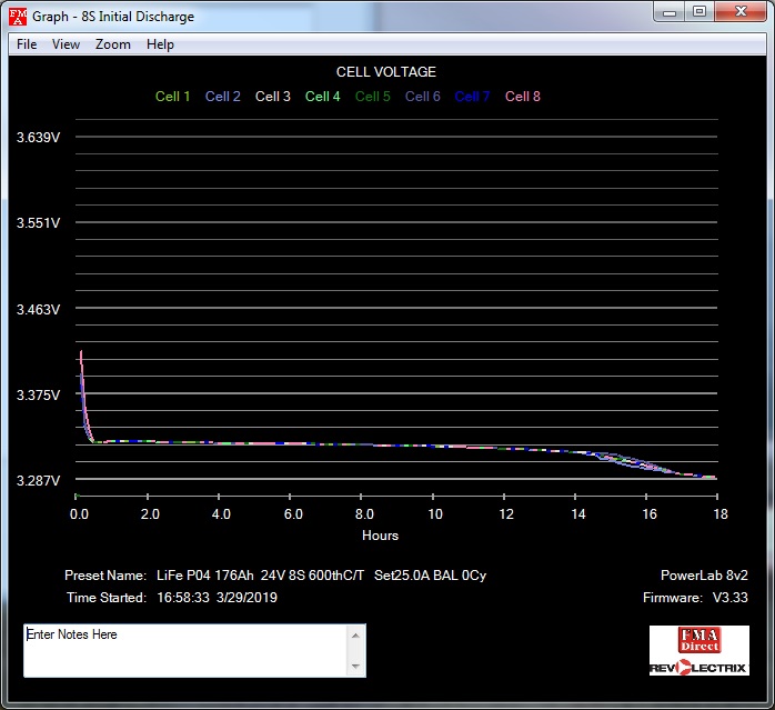

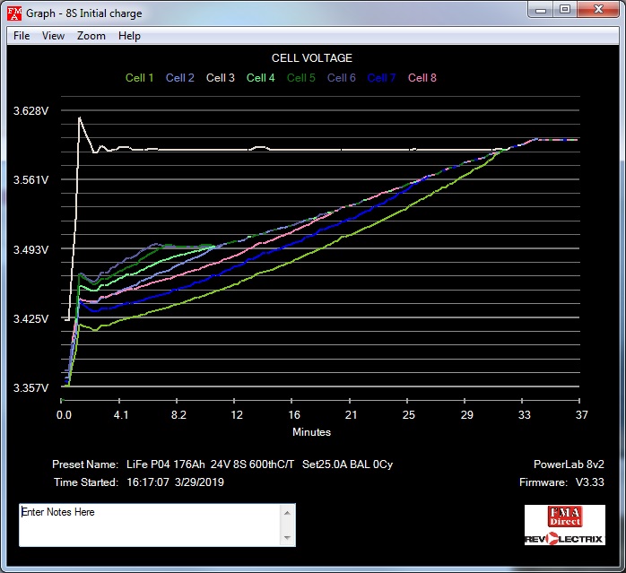

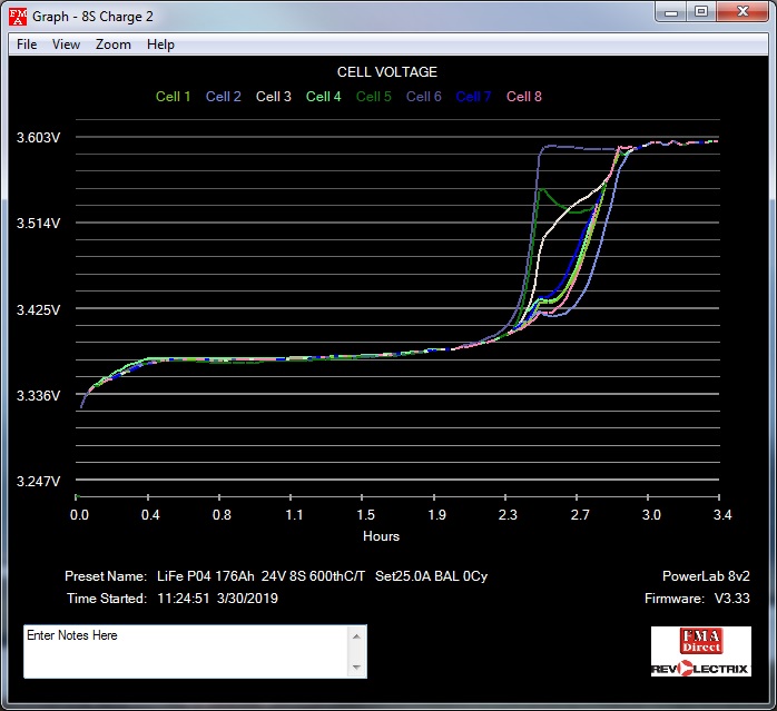

Here are some charts of the initial charge of the 8S pack (note that each cell had been fully charged before the pack was assembled), a discharge of 62 Ah, followed by a full charge.
Second full charge - put in 65657 mAh in 3:26:20
Discharge from Full - Took out 62956 mAh in a bit over 18 hours
Initial Charge of 8S pack - put in 0.678 mAh

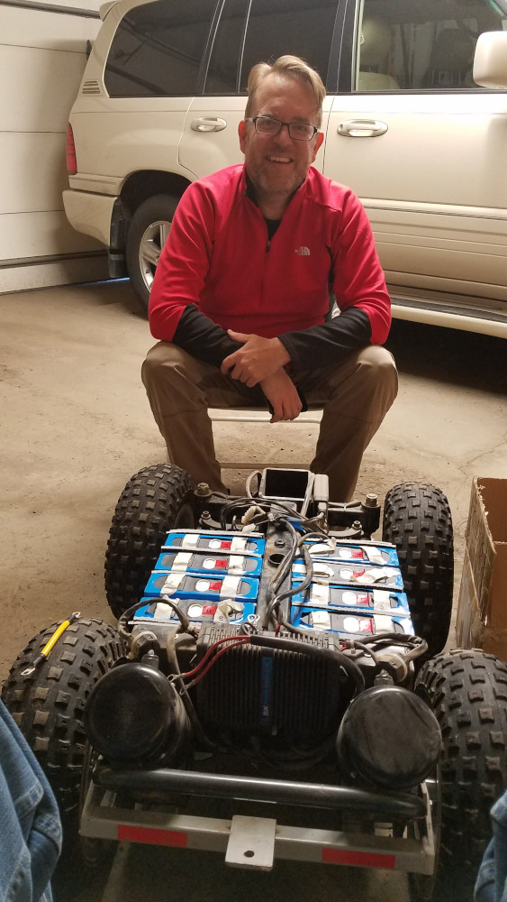

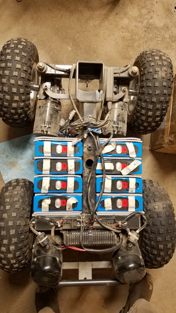

It has been an exciting day. My friend Greg came over this evening to install the LiFePO4 battery pack into my Magic Mobility X4 wheelchair.
We just wrapped up and I am pleased to report the X4 passed the first test drive, which was limited to my garage because of the winter weather we still have here. My wife's car is currently banished to the elements.
We probably ran into some pretty typical issues. There seemed to be too many wires for the space available. Rerouting the circuit breaker from between the two 12 volt batteries so that it is on the main positive lead was a bit exciting. We still have not figured out where to put the cell monitor or how to route the wire to it. But, it lives.
Accessing the battery boxes on the X4 requires removing the seat, removing a support beam, and then removing the shroud. Putting it back together is quite fiddly and took longer than expected.
The actual install of the batteries went very well. Needless to say, I could not have done any of this without Greg. He has been a great help in many things and was there pretty much every step of the way since I first started thinking about a lithium battery pack.
Here are some pictures of the install.
Greg looking over the installed cells

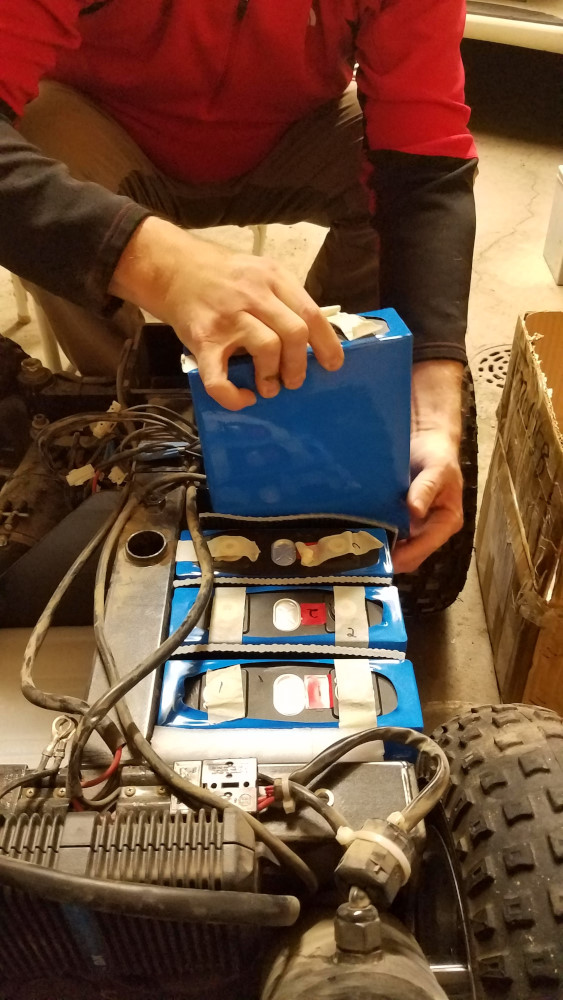

Greg installing the third cell
Greg as he test fit the first 2 cells. It was a relief to find that actually fit!

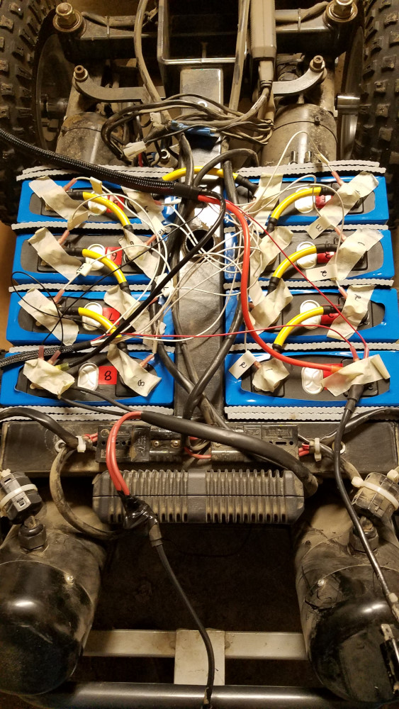

More Pictures of the install.

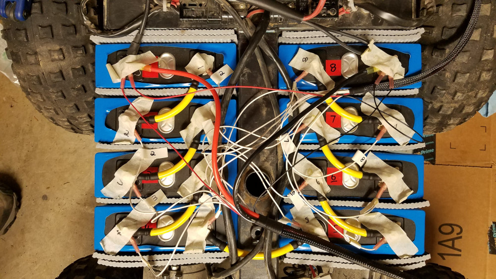

The cells with all wires attached, but without the wiring cleaned up
Closeup of the wiring
The cells all nestled in the battery box without wiring

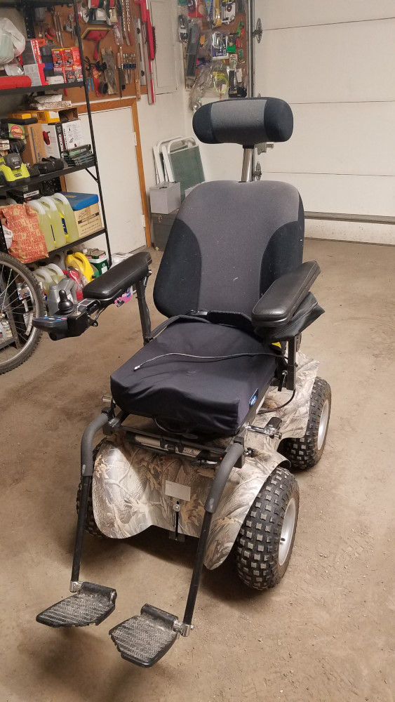

The reassembled wheelchair

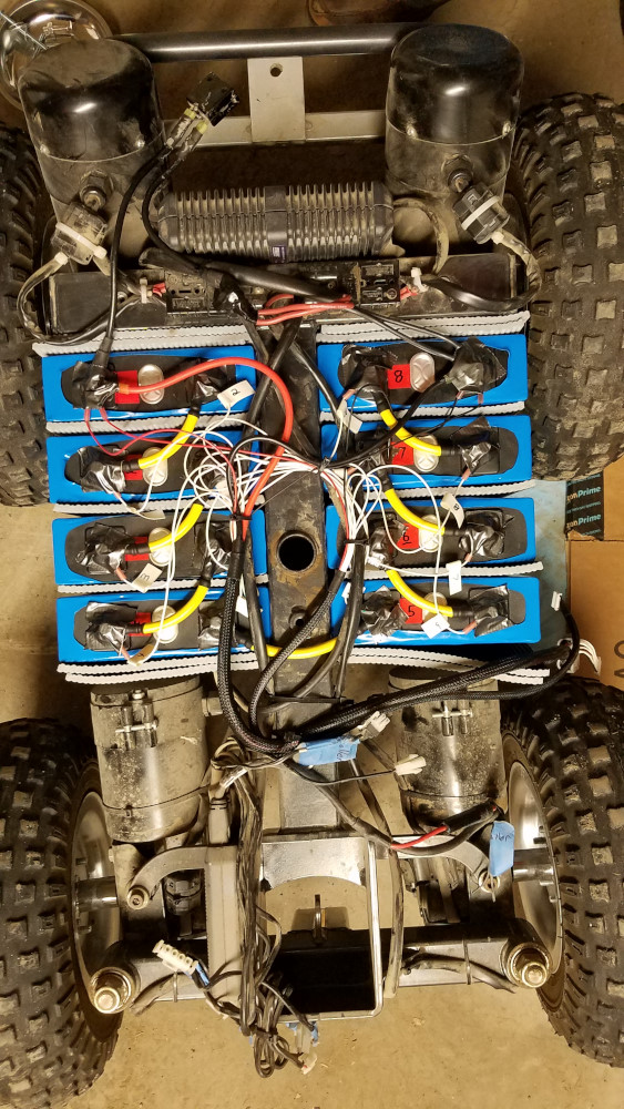

The installation with zip ties installed to clean things up.

Very good. A few tiny cable ties might tidy up all the wires. Did you test?
Posts: 69889
Re: Lithium Build for Magic Mobility X4
Postby Scooterman » 31 Mar 2019, 10:26
This isn't a criticism, what you've done looks really good :thumbup:
But I was wondering whether you could have got away with thinner series links between the cells? What I've learnt from feeling cables during charging is that (for the same csa) it's the longer cables that get warm and shorter cables stay stone cold.

You should insulate against the centre beam too. :fencing

Scooterman: I could have gotten away with smaller wires (for the yellow wires connecting the cells in series). In the worst case (a failure condition), those could have to carry the fully load. I calculated that 10mm2 would be appropriate. Unfortunately, in the US it is impractical to buy 10mm2 cable. The closest would be 7 AWG, which is also impractical to buy. So, I went one size larger, which is 6 AWG, or about 13.3mm2. Fortunately, those larger wires did not cause any wiring or space issues. Other wires sure did!
Shirley_hkg: You are right. I should have added insulation around that beam. There is not much space, but I could have at least wrapped that beam in an insulating layer, perhaps something 0.25mm thick. The next time I have the chair apart I will do that. For now, each cell has the original shrink wrap that came on cell, 0.25mm thick electrical insulation paper (fish paper), and 0.25mm thick PVC shrink wrap. I think that will be enough, but still should have wrapped the beam. The foam you see between cells is non-conductive EVA foam, whose primary purpose is to fill the gaps between the bulged cells and make sure there is a secure fit in the battery box (which is quite a bit longer than needed for a group 24 battery).
Scooterman: You are very right. There is not much space at all between the cells and that beam.
Expresso: Yes, I have one set of balance wires for charging and another set of nine 22 AWG wires for a cell monitor. This wheelchair is primarily for outdoor riding, though it has been indoors a time or two. I use it extensively in the winter because I live in a place where it snows a lot. I also use it for back country adventures in the summer both around where I live as well as in national parks such as Yellowstone and the Grand Canyon. It has been spectacularly useful in that role, even though its range has been limited to a paltry 4 to 5 miles with lead acid batteries. I am hopeful the LiFePO4 pack will extend that range to at least 12 miles. It uses a LOT of energy.

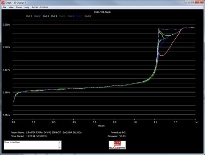

Postby swalker » 01 Apr 2019, 02:47

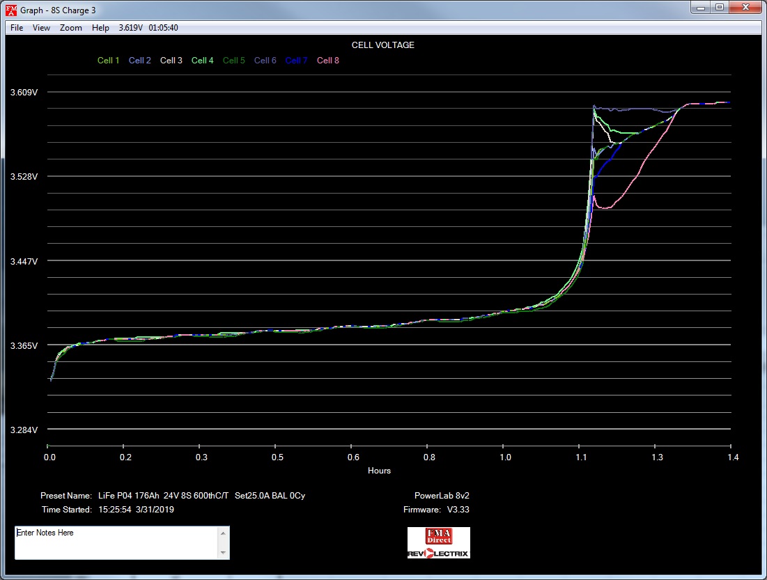

The charge finished and here's the graph.
The charge had a duration of 1:25:57 with a Capacity IN of 28908 mAh.
I don't want to get too excited, but... I figure that I can safely use at least 140 Ah from the 176 Ah pack. If I was able to go 5.2 miles with 28.908, there is some potential I could go 25 miles using 140 Ah. That would far exceed my expectations. I was hoping for at least 12 to 15 miles.
Looks like I have more endurance testing ahead of me:). Snow is predicted here for most of the next 10 days, so the endurance tests may have to wait a bit.
Charge after first ride of 5.2 miles
Postby expresso » 01 Apr 2019, 03:30
nice - i bet you can do it also - and maybe use more than 140ah - you should discharge test it - if you want to know how low it go safely
would take a long time if full - using the pl8 alone - or did you do that already ? discharge it down to 2.9v or 3.0v to be safe - and see what the Volt is when it stops -
you can have an idea more or less - not accurate- cell monitor better for the alarm feature at least - going from 5 miles to 25 miles is a HUGE jump - down the line if you have to redo it- maybe can even find 200ah cells that fit or more -
Postby swalker » 01 Apr 2019, 03:40
Expresso,
I have a cell monitor for the pack and thus can stay informed of the cell by cell voltage during my excursion. I have tested that cell monitor against the readings output by the PL8 and it appears to be accurate to within 20 mA or so. Of course, the cell monitor results should only really become interesting as the cells start to get low.
On one cell, I did a test of fully charging it to 3.6 volts and then discharging it to 2.9 volts. That took out about 167 aH.
For all the cells (including the one I did the more thorough discharge/charge on) I charged them all from their initial condition of about 3 volts to 3.6 volts. That took a similar amount of time for each cell and resulted in a similar Capacity In for each cell. I subsequently discharged each cell by 20 Ah, which again, took a similar amount of time for each cell.
Based on this, I have some indication that all of the cells behave roughly similarly and that I should be able to use about 165 Ah when I discharge the entire pack from 3.6 V to 2.9V.
So, I am hoping that my target number of 140 Ah available for practical use in a full pack is conservative. I am excited about doing some real world endurance tests.
