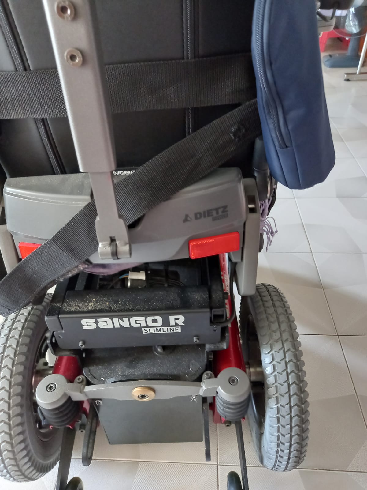

Note that the one steve has is a slimmer version. I dont know why. But it has a smaller battery space. Smaller Ah. And thinner wheel rims by the look of it. All to keep wheel track width to a lower level.

Want to know how to access battery box , and its measurements .

The non slim one has grp24 batts.
So at least 260 x 171 x around 220 or more tall. per battery. So 260W x 346L x 220H. How to access no idea!

steve does not have the slim line version, he has the advanced which is grp24
the slimline version is still available with 14" drive wheels and is the most common size fitted. can be fitted with 12" to get it to 51cm width and a lower seat height if required.

I was sure it was the slimline one, from the pic above somewhere?
Found. download/file.php?id=15733&mode=view

yep that is a slimline but steve has a black advanced version.

Ah. So the one in the pic above is the one shirley is interested in? And that has a smaller batt area.

Yep.
