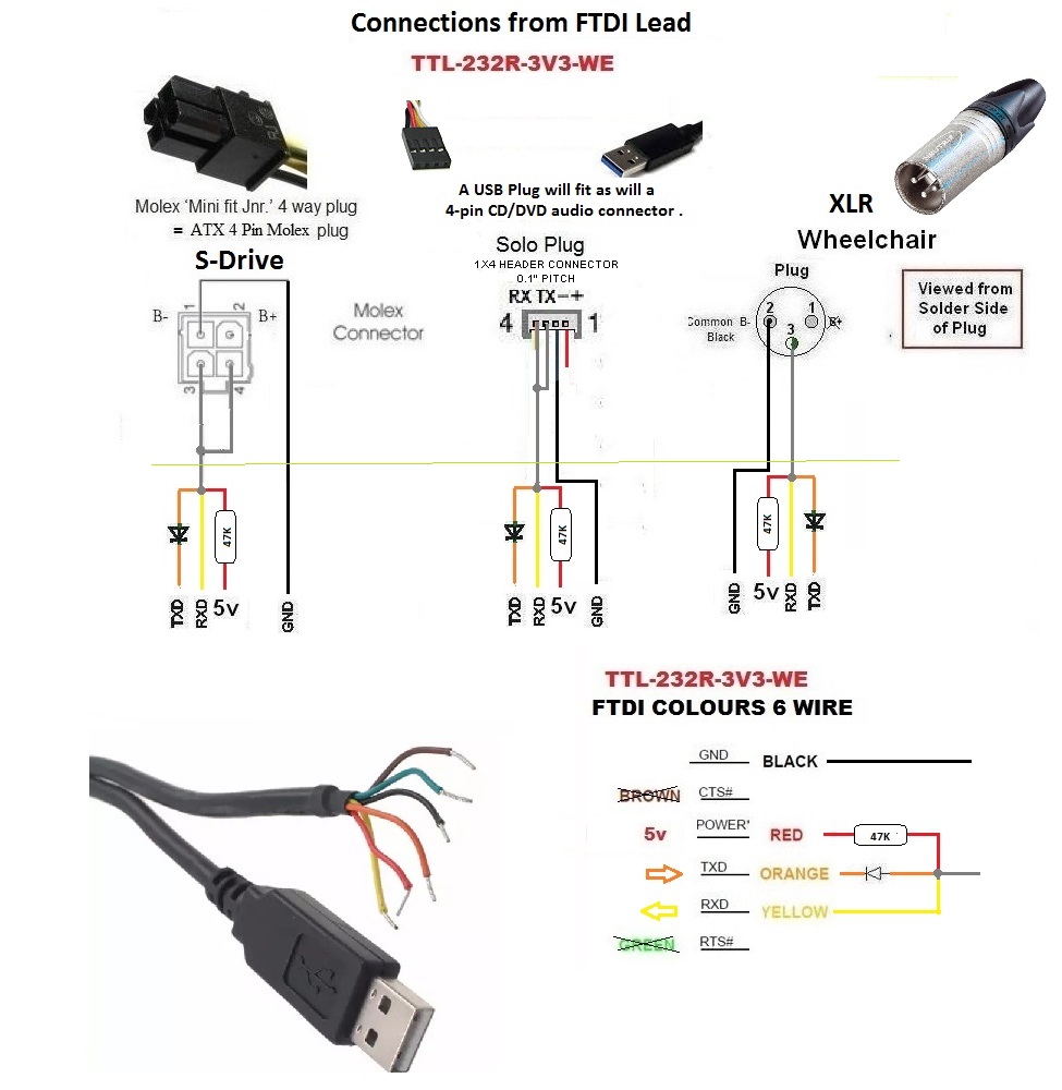

Let us start with the cable build.
Could you take a pic of the connections that you have made inside the 3 pin XLR and upload it here.

Try checking your cable build with a loopback test .. note that your RX and TX is already joined .

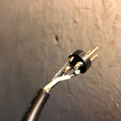

Postby funchairguy » 28 Nov 2018, 16:40
woodygb wrote:It's difficult to diagnose remotely.
Oh...and can please you add a general location to your profile.
Here is a pic of the XLR connector. I tested it with a meter when I wired the FTDI chipped USB adapter. I checked for shorts between the leads and the correct pinout. The shield wire was already soldered to the case. The XLR cable was robbed from an old charger and I didn't remover the shield wire solder joint. The other end of that shield wire is not connected to anything.

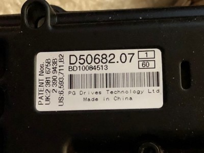

Here are pictures of the VR2 controller and joystick. They are new. The others are in a recliner that I built. Those were borrowed from a hoveround technique using the VR2 joystick and controller. Location is Odessa Texas. I just updated my profile with that info.
Thanks gcebiker

The Black wire in your pic is connected to the XLR's ground pin and the White is connected to the programming pin which is a combined RX & TX .
I'm not sure what your doing as you pic doesn't show the FTDI lead connections or the resistor and diode.... ( I put mine inside the XLR body and was expecting to see them ).
So ...could you take a pic of the FTDI /Resistor /Diode connection .
but when I jumper the TX/RX pins together at the XLR connector, I cannot type anything in the terminal.
As I previously stated the RX and TX are already connected ( IF you have made the cable correctly ) so you just type on the hyperterminal for a test without any additional mods....which begs the question what are you connecting together?!

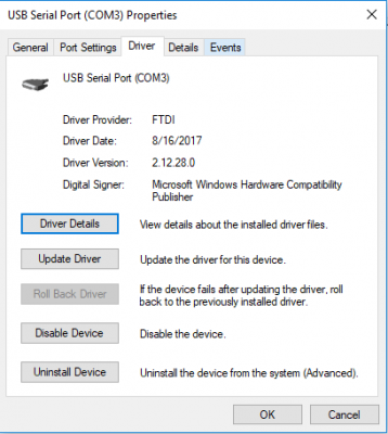

O.K.... The test would suggest that the cable is working fine....which sort of leaves me stumped as to a reason for the non active connection.
Note that I run Windows 10 and have no problems with the software.
FTDI Driver version 2.12.28.0

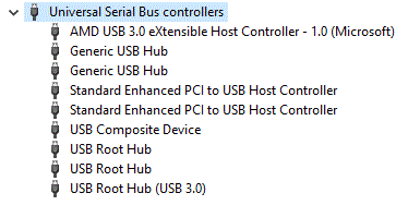

What 'generation' USB port are you using FCguy? Long shot, but I have heard of problems when people try to use USB 2.0 stuff on USB 3.0 ports - they are SUPPOSED to be backwards compatible, but aren't always....

Looks like my oldest computer has (2) of the USB 2.0 ports and (1) of the USB 3.0 ports. I've tried all the USB ports on this computer.

What range of resistor values is ok? I had assumed I would need to find an exact 47KΩ.

Postby woodygb » 05 Dec 2018, 12:08
I really do not know what the exact range is ...but as I recall someone used a value of around 50k+ successfully.
Re: PINNED - Info on PROGRAMMING PGDT and others
Postby foghornleghorn » 05 Dec 2018, 12:26
Good to know.
^ Looking at the photo on my screen the two resistors don't look the same. Not seeing violet on both - might even be a 17 and a 12?

Postby woodygb » 05 Dec 2018, 13:55
It's possible that the values are 20k and 27k.
