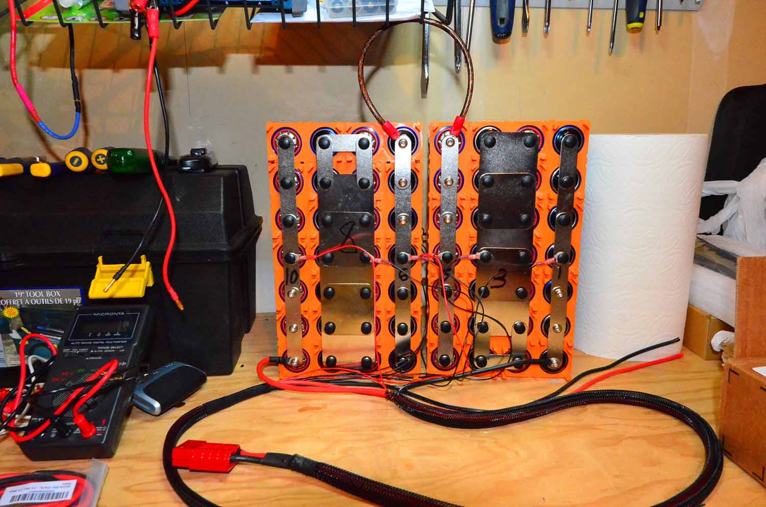

Burgerman wrote:steves1977uk, you are supposed to have all the parallel ones linked with a bar. And only need each series sets linked with one bar. As it is, any difference in cell resistance will mean a different voltage per cell under load, and those thin balance wires will be trying to balance a x amp load... That's probably why it never looks very balanced as you charge.
BM, you are really paying attention.
That is not a proper setup.
You should do parallel connection first, then in series.

This is a classic case of not ordering enough busbars and just trying to make due. That tiny red wire is the parallel connection and is much too small to be used in that way. The balance wire is actually a much larger wire that you can see on the top row of cells.

Postby Burgerman » 23 Feb 2016, 10:01
All the horizontal ones need to be vertical. Only 3 need to be horizontal in that picture to give the series connections.
It needs more bus bars too.

Postby steves1977uk » 23 Feb 2016, 11:50
Yes, that would explain why it takes a while to balance. As I understand it from what shirley said, it needs to be parallel first and then series? I do have more 2-hole buss bars, but was unsure where they'd go. I should be getting this pack rewired with thicker balancing wires, as I believe the engineer only used the wires from the OBD cable that I use for the balancing plug.
Scollard, can you show both sides of your built pack please? Then I can show the engineer how it's supposed to be built.

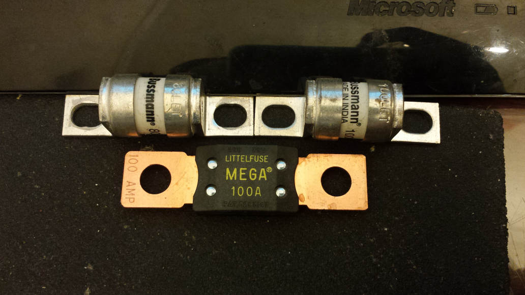

expresso wrote:Steve - you had a fuse on both pos and neg wire ? what amp fuse did you use - why both wires ? why add a fuse if the chair has a fuse also - ?
besides the fuse on the charge cables -
I used a 150 amp fuse as this chair never had one when it was used with lead batteries. The only sort of fuse it had was a 2 pin plug that is moulded in bakelite material, and that was prone to keep falling out unless the pins were bent inwards slightly to give a tighter fit.
Postby Burgerman » 23 Feb 2016, 12:41
It should be connected the same as both end parallel blocks are.
So you have rows of vertical bus bars. Then you just need one horizontal one in the middle, that goes where you have 5 now...
Then you can get rid of all of the thin red interconnecting wires.
To save time, you could just add a connector in every place you now have a thin red wire now instead. Both top and bottom.

Steve , ring terminals may have better quality than those connectors.
All it need is a thicker wire ; 12AWG /1.5mm square etc. ;)
646-SE has a 100A CIRCUIT BREAKER . Too large a fuse means no protection. :cry:

Postby Scollard » 23 Feb 2016, 21:06
Thanks,
Front:
Back:

Postby steves1977uk » 23 Feb 2016, 22:36
Scollard wrote:
Thanks,
Front:
Back:
Thanks for that Scollard, most helpful :)
