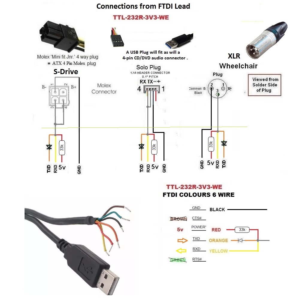

woodygb wrote:It's possible that the values are 20k and 27k.
The value of the resistor pair is 48.4k ohm (measured) which is within 3% of the recommended 47k ohm value.
I believe I have found the problem(s). I will verify with my other joysticks when I get back into town.
Stay tuned for the solution....

Postby funchairguy » 11 Dec 2018, 01:30
Problem fixed!
Just a quick recap:
I was struggling to get the PC Mobility Programmer software to communicate. I always had “COMMS INACTIVE”. I’ve tried 3 different VR2 modules and 3 different joysticks, 2 FTDI cables, 2 different versions of the PC programming software, and 4 computers. Also, with the help of this Forum, we tried many other fixes to get the communication to work.
Finally, I went to my friend who had all sorts of oscilloscopes and testing equipment. I took him my oldest and most beat up joystick which works, but never been used for programming. With the TTL-232R-3V3-WE cable, XLR cable, and resistor+diode mod, we monitored the cable signal. We found that the PC Mobility Programmer software was initiating the communication, but there was no response from the VR2 module. We eventually discovered that there was a broken TX/RX wire within this joystick cable. Can you believe that? However, that doesn’t explain why the other joysticks and modules wouldn’t communicate. We made a quick and dirty fix to the joystick cable and tested. We got “COMMS ACTIVE” and verified with the oscilloscope that the communications were going both directions, but the communication link was extremely unstable. The comms status in the software GUI was constantly switching from active to inactive.
We then played around with different resistances and found that 47K ohm is right on the very edge of degrading the communication signal to the point of instability or not functioning at all. My resistor pair was 48.4k ohm and was unstable with the old joystick. It would not function at all with the other joysticks and module combinations. We had a test box with different common resistor values to select such as 22k ohm, 33k ohm, 47k ohm, 68k ohm, etc… With this box in place of the programming cable resistor, we switched to 47k ohm and communications failed. Switching to 33k ohm worked with no instability. 22k ohm would not work. We also noticed that the rising edge of the signal was degraded with higher resistance which is likely the reason for the communication failure. Lower resistance made for a faster rise time and a solid digital signal. I went and tested the other joysticks and modules using the 33k ohm resistance in the programming cable, and they now communicate perfectly.
In conclusion, I believe that 47k ohm resistance for the VR2 is right on the very edge of having an unstable signal and may not function at all. Adding additional cable between the resistor and the XLR connector along with possibly dirty or corroded connections on either the joystick connectors or the VR2 connector may magnify the problem by adding resistance. I recommend a lower value resistor such as a 33k ohm.
To get a better idea of what value more suited for this purpose, I recommend someone perform a test. Use a potentiometer with a 22k ohm resistor in-line to prevent accidentally running the resistance too low. Then with the programming software running, slowly adjust the potentiometer until the comms indicator starts to switch between inactive and active (unstable). Then pull the potentiometer out and measure the resistance for both the bottom limit and again for the upper limit.
It has been a huge headache, but I just couldn't let this one defeat me. I wan't to thank everyone for quick responses to help. :thumbup:

Postby woodygb » 12 Dec 2018, 00:44
Thanks for the update on the resistor values... I'll start using and recommending 33k.
B.M. your cable is an old original that uses a different cable model and PL2303 chip set and didn't use any additional components.
The big draw back was that it was impossible to recommend a specific manufacturer , only that a generic KPG 4 programming cable should or could work.
The problem was exacerbated further by the various KPG leads having no colour standardisation for the wires... I had one where RED was used as GND! ...plus the Prolific chip drivers were and still are a PITA... thus the eventual change over to a readily available consistent cable type.
Postby woodygb » 12 Dec 2018, 00:47
New drawing using 33k resistor.
Postby foghornleghorn » 12 Dec 2018, 10:53
So is it 33k for everything now or just the VR2?
When my hands are feeling good enough I want to make something to talk to Pilot+, and hopefully a VSI joystick/power module all-in-one too.
33k or 47k?
Posts: 707
Postby woodygb » 12 Dec 2018, 16:10
33k for ALL.
