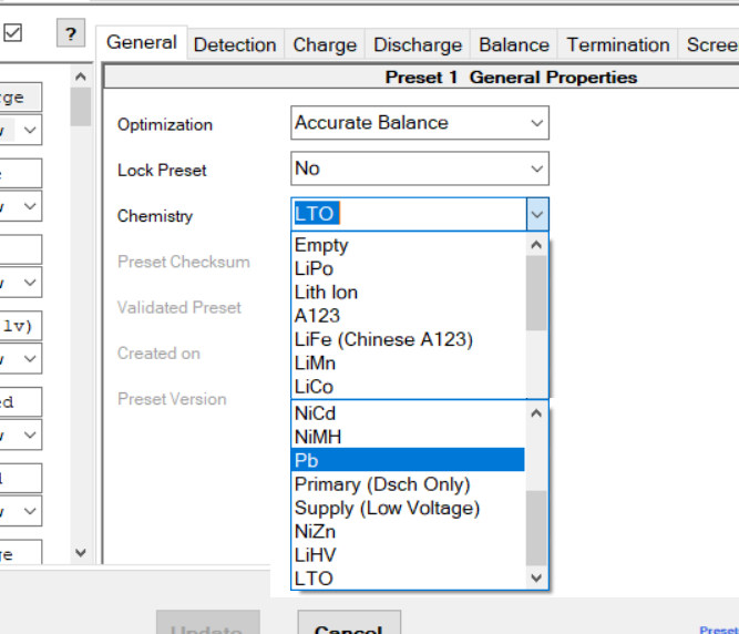

Postby Burgerman » 22 Feb 2020, 21:56
LTO cells were added.
Note that THESE are all the different chamistries it can now charge.
Posts: 71117

Postby Burgerman » 22 Feb 2020, 22:17
Empty... No chemistry!
-LiPo = Lithium Polymer. The explosive powerful hobby packs.
-Lith Ion = Lithium Ion, the generic lithium ion cells, from older times. Often charged to a lower 4.1V per cell. Burns...
-A123 = A123 branded LiFePO4 cell. Because the guy that wrote the software didnt understand that A123 was a LiFePO4 cell... Still doesent.
-LiFe (Chinese A123) because it was written by an american that thaught A123 was a chemistry... Its LiFePO4 - same as the A123 above...
-LiMn = Lithium Ion Manganese. Another light variation on the LiFe cells.
-LiCo = Lithium Ion Cobalt cells such as your laptop cells or the generic 18650 cells. Can be a bit explodey.
-NiCd = Nickel Cadmium. The rechargable cells you USED to put in everything...
-NiMh = Nickel Metal hydride. The rechargable AAs you now put in everything.
-Pb = Lead based, gel, AGM etc.
-Primary (discharge only) = for testing your non rechargable batteries for capacity.
-Supply (low voltage) = Amps, low volts, for hot wire cutting etc.
-NiZn = Nickel Zinc batteries. 1.6V AA rechargables! High capacity. They use CC/CV rather than CC/Delta V for charging. Dont mix them up!
-LiHV = Special new LiPo batteries with a higher charge voltage. Instead of 4.200V 4.250 or 4.300 or 4.3500V are used for added power and Ah. Dont try this on any other type of lithiu battery or it wont end well!
-LTO = Lithium Titonate (microcrystal) cells. TIT-onate :D
