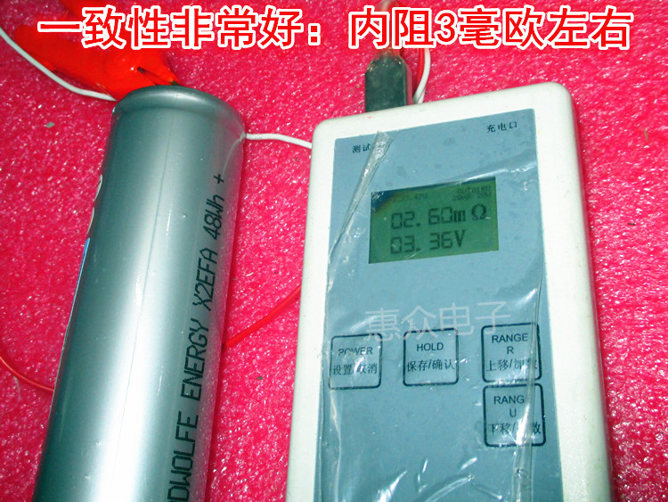

Postby shirley_hkg » 01 Jun 2016, 12:58
Found these 40152 15Ah dated @ 10C .
Taiwan made . :D
New old stock . ;)

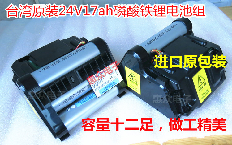

Postby shirley_hkg » 01 Jun 2016, 13:08
Sweetest thing is just @ $8.00 USD :o
Bought 80 pieses for another Invacare GB . :idea:
Of course , in my old fashion way . . . . B M S . . . . with 20A . . 28.2V . . . dumb charger . :twisted:

Postby steves1977uk » 02 Jun 2016, 17:23
Attached is the spec sheet for those Goodwolfe Cells. Might be tempted to build a pack out of these. Don't know where you can buy them though.
LiFeBATT15Ah.zip
(95.7 KiB) Downloaded 257 times
Postby Burgerman » 02 Jun 2016, 17:30
They are same spec as headway 15Ah cells. Remember though that the cheap ones are old. May have been stored badly or allowed to discharge fully over time. You may get exactly what you pay for.

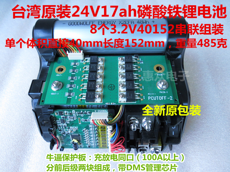

Postby shirley_hkg » 03 Jun 2016, 02:36
Cells are made in Taiwan, and may be even better than Headway.
The battery is made for a French robotics company . The 100A BMS is well designed.
May be too sophisticated, the entire lot was returned, and ended in the hands of recycle sellers.
They are unused, rated @15Ah 10C , and actual tests show 17Ah capacity.
