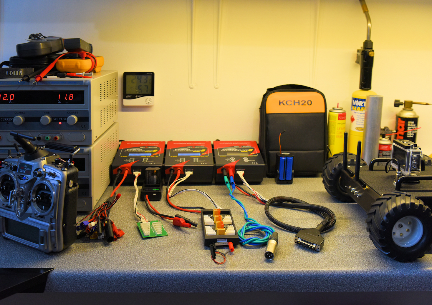

You cant have too many PL8s. Theres 3 on my bench, for chairs, hobby stuff, camaras, mower, etc. And a 4th one, a BT modded version that I use all over the place daily. Currently in my kitchen charging a couple of powerchairs via BlueTooth.
So hopefully they will be back in sock in the future.
Note all the connectors!
starting on left charger 1, theres a huge multi connector that fits every damned thing. Then a balance connector that does 2S up to 8S. Then a nikon camera battery holder.
Charger 2 is a high power 40A parallel charger board that inc balance for 2 to 6S hobby packs 4 at a time. And a 9V PP3 battery connector. Thats used for 9V batteries and to connect AAA and AA battery holders. And charger 3 has the connector for the wheelchairs. Lithium, and XLR for LEAD.

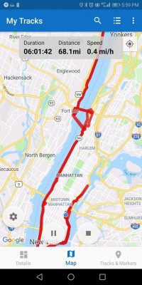

You should get around 1 mile for every 2 to 3Ah.
For e.g with 170Ah and some remaining afterwards, expresso got 68 miles in a fast heavy bounder chair around new york.
